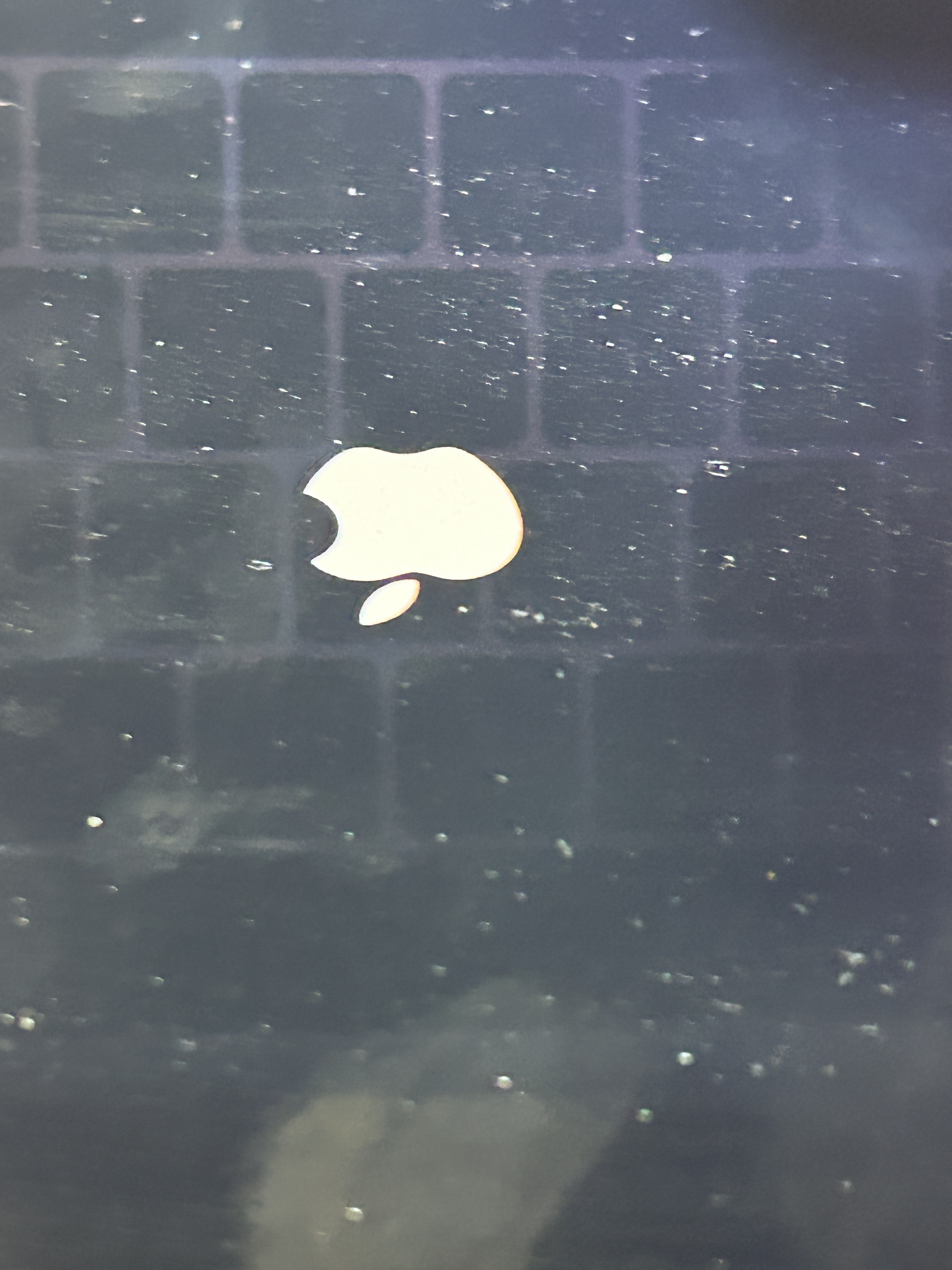

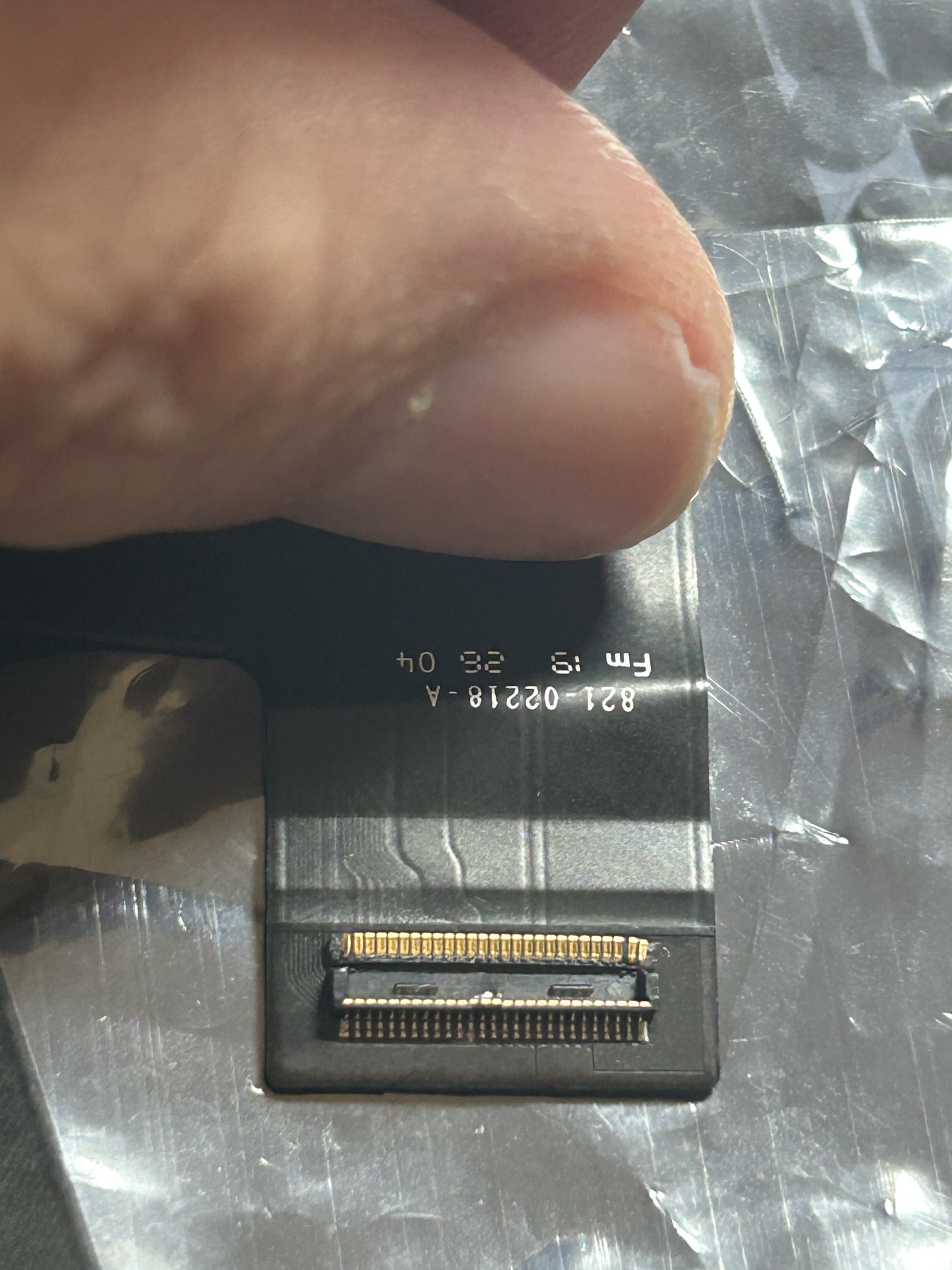

    Hi Everyone. I have a Mac for a topcase replacement. I have completed the job however the Mac will boot and I get the startup chimes but not pass the Apple Logo, not even a progress bar. After a few seconds the fan spins fast. The board is 820-01598-A. I have disconnected everything except the USB ports and display and the issue persists. I am drawing 20.42v and .461A with just the screen connected so it looks like it is booting. I have looked over the board with a scope and I do not see anything that appears wrong. I can not get into diagnostics, NVRAM reset or DFU. The only issue is the topcase is used, but excellent condition however the Trackpad cable was damaged on the connector and stupidly I did not notice until I tried to connect it. I had not power or battery attached atthe time of course and the connector on the Logicboard is perfect. if anyone has any ideas that would be good and I appreciate your help.

    Touchbar would be my first suspect.
    Hi, thank you however the issue happens even if the touchbar is not connected.

          Review the trackpad and trackpad cabling. Be sure the trackpad cable contact pitch is suitable for this model’s connector. There are sensors in the trackpad assembly that must be visible during the OS boot using smbus communication. If absent, there will be a high fan spin.
          Measure the voltage to ground of each smbus pin on the trackpad cable.
          Respectively, the trackpad must be connected and working to boot.

            OK thank you, I have replaced the trackpad cable and reassembled and it now boots, thank you all for your support. Great forum, great techs

                The job was a topcase replacement. I sourced a used by good condition topcase but as I was re assembling I noticed the track pad cable was damaged, see attached. I put the Mac back together minus the trackpad and it would not boot. I did not realise that the trackpad needed to be connected until mon2 told me. As soon as I replaced the trackpad cable it booted.
