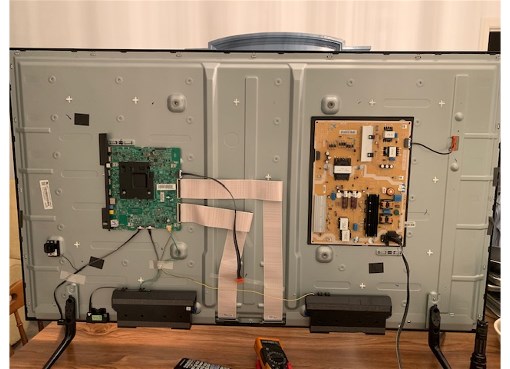

    I am new to this forum and I am looking for some help and guidence. My neighbor gave me a Samsung UN58MU6100FXZA tv, saying if I can fix it I have a tv. I have searched on the internet and I am unable to find a service/repair manual for it or any schematics for it.
    When I received it the tv did not turn on, nor did it have a standby light. I purchased a used, supposedly good board that was removed from a tv with a cracked screen off ebay. (The seller had a 100% feedback score, but I know thast is not a guarantee.) I installed the board and now I get a standby light and the tv turns on. The screen flickered shortly after powering on and then went black. I then did a factory reset and I updated the software. After a few minutes the screen starts to flicker and then goes black. It takes a couple minutes longer before it starts to flicker after the reset and software update. There is still sound when the screen goes black.
    If I put a flashlight next to the screen in a room with the lights off I can see images on the screen and hear sound. If I remove the cable from the power board to the main board the led backlights stay on with no flickering. I am thinking the main board is bad too, but before I replace it I am looking for your help and guidence in case I should be doing something else first. Thanks.
    Re: Samsung UN58MU6100FXZA - Screen flickers and then black
    "If I remove the cable from the power board to the main board the led backlights stay on with no flickering."
    If that is true then the power supply and backlights are OK.
    Can we see the pictures of the whole backside of the TV showing all the boards?

      I will get a photo. There are two boards, the power board and the main board. There is no separate T-Con board.

        Photo - back of tv
          Mainboard there https://www.shopjimmy.com/samsung-bn...rsion-da01.htm

                Just to let you know, I replaced the main board and the tv is working. Thanks for all your help.
