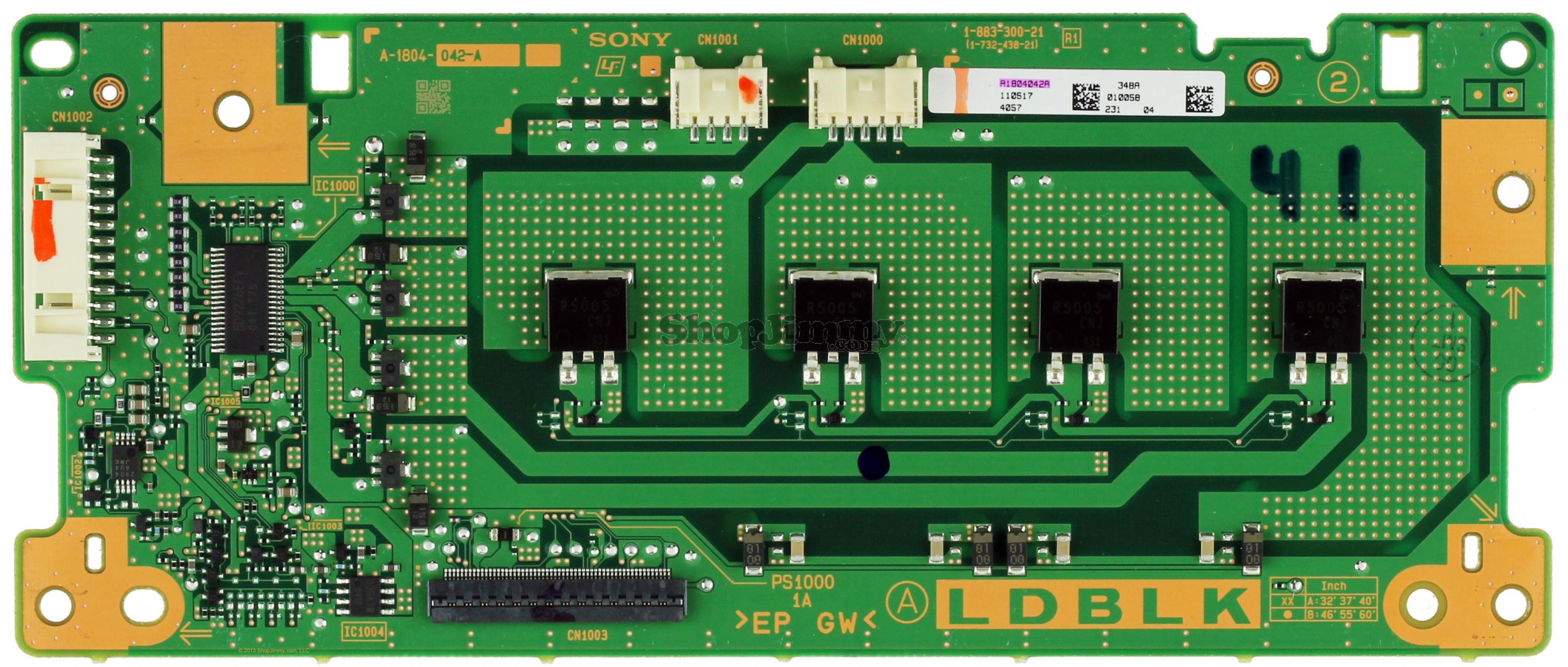

    Can someone please tell me what JL means, such as JL6109, JL6108 etc?

      I can't be 100% but it could be jumper location, just a way to reference a board location to the schematic. JW means jumper wire
      And NO YOU CAN NOT jump pins 4 and 26 of the ic, it will not end well

          JLxxx are just the pads that can be used as test points.
          For example: LED driver bd, see service manual page 44 and look at the PCB drawing and the picture here for example: https://www.shopjimmy.com/sony-a-180...blk-board.htm#
          Pictures provided by shopjimmy.
