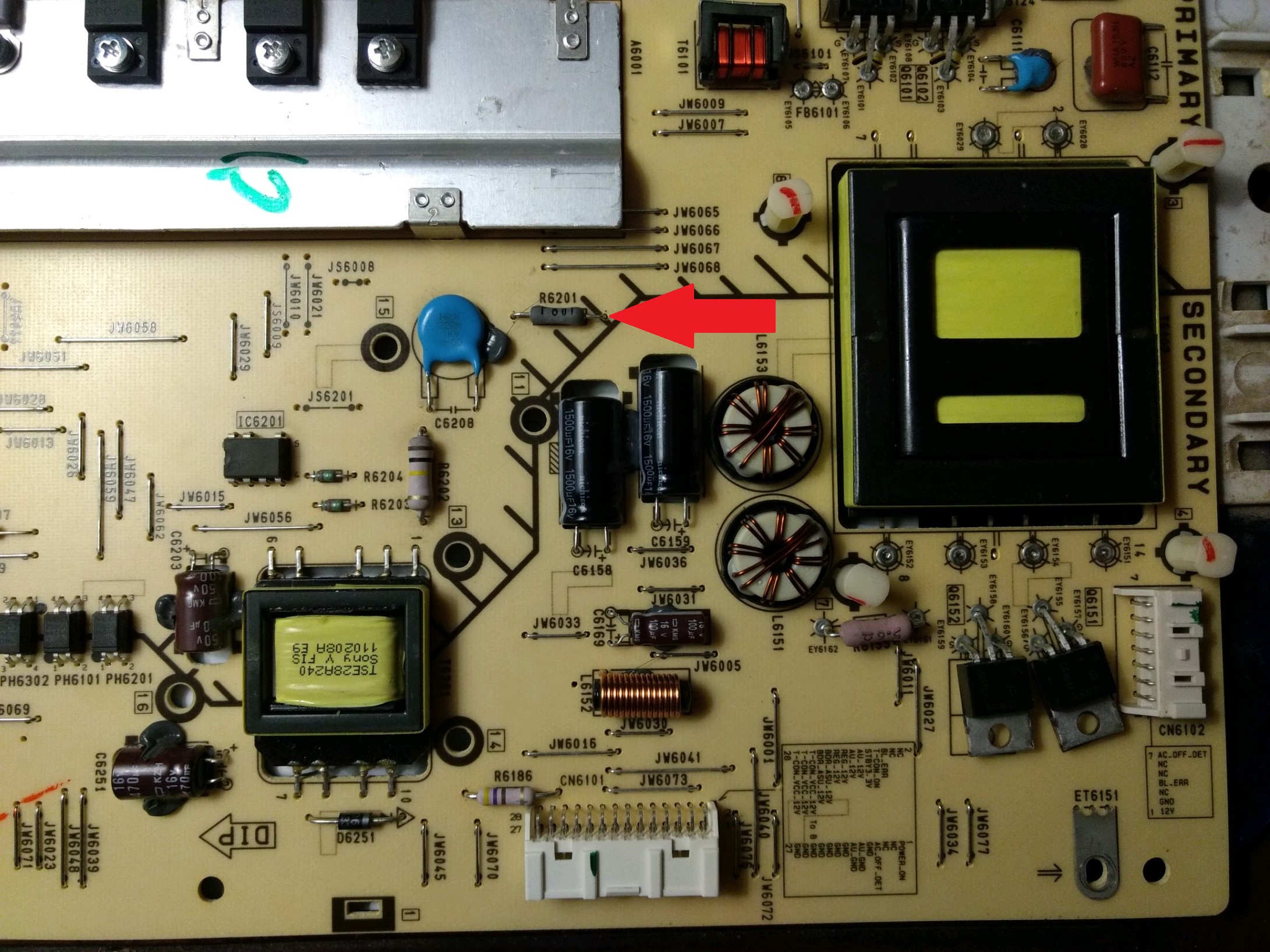

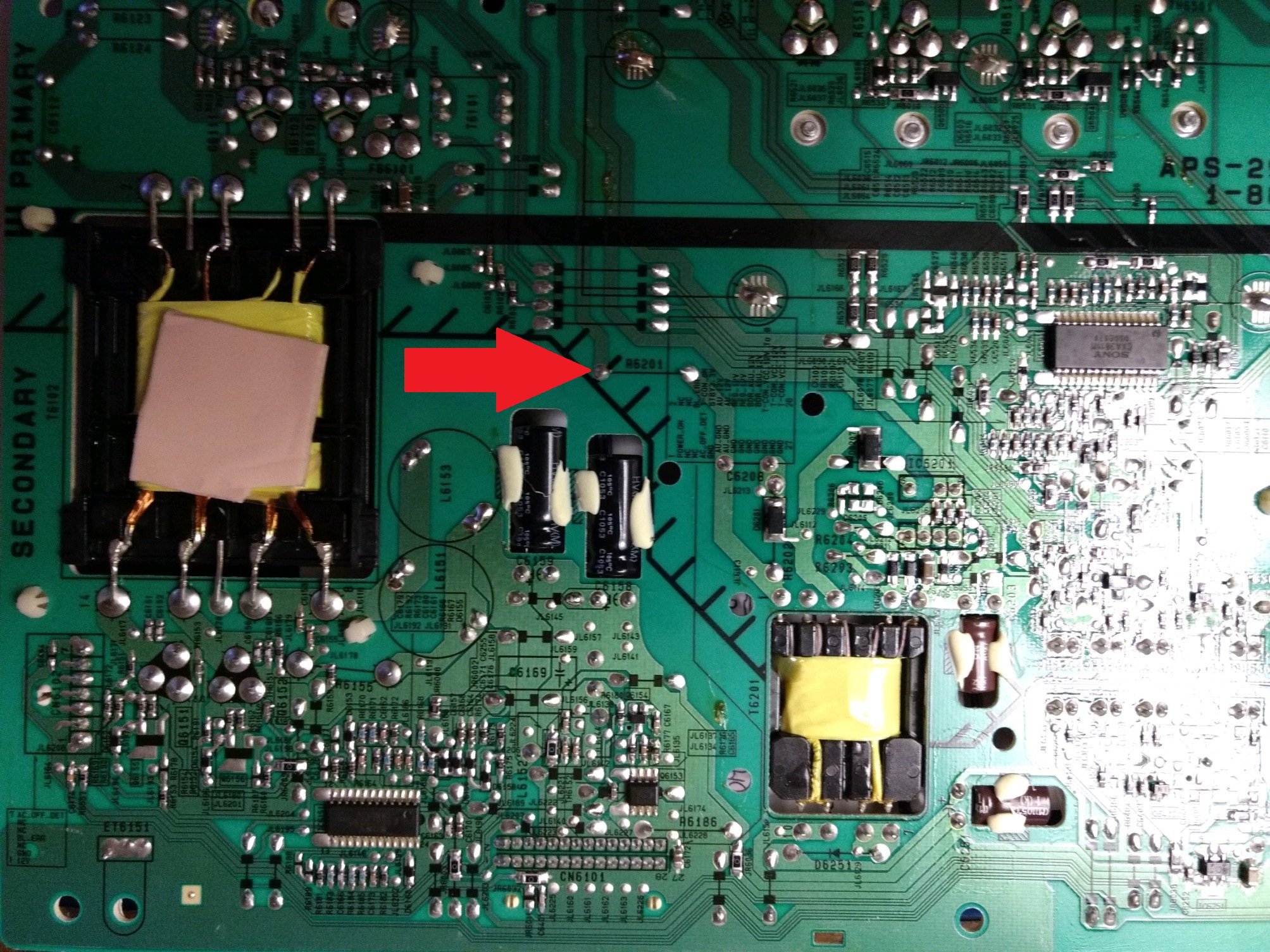

    I bought this TV today with the complaint of appears dead, confirmed. I removed the back and tested the A/C in fuse which was OK. Main cap voltage at 165V. After further testing it looked to me like the whole secondary side of the board was dead with no 3.3V stand-by present.
    I pulled the PSU and had a look, nothing obvious showing, so I went to ShopJimmy and looked for a PSU repair kit which they had, here is the link: https://www.shopjimmy.com/sony-1-474...repair-kit.htm .
    I checked the components the kit called for. None of those transistors checked short ( I could not locate Q6123 and 6124) and all of the resistors were OK save for R6201 which checks open in one direction and very high resistance in the other.

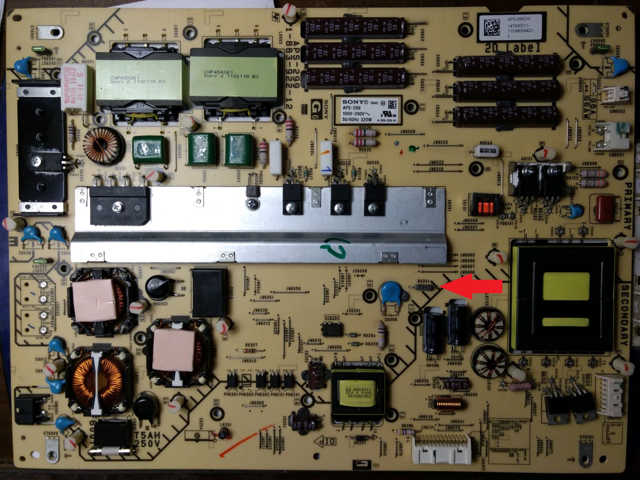

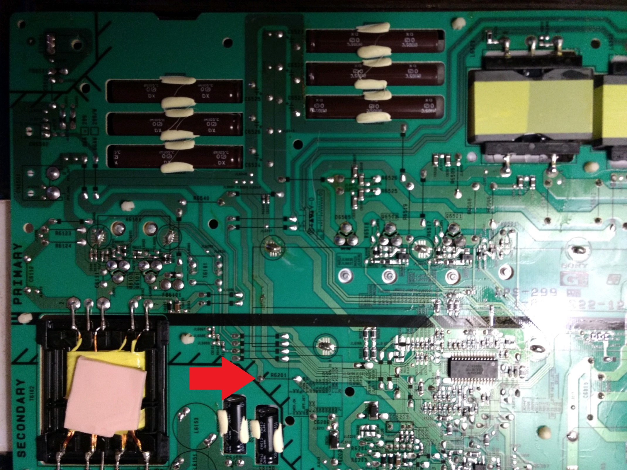

    When I look at the trace it appears voltage comes from the main caps, goes through R6201 to what appears to be a 12V transformer. When I trace the circuits off of R6201's circuit it looks like they all wind up at that transformer.
    Based on what I see it looks like this single resistor being open will result in no voltage to the transformer down range and the secondary side of the board?
    Can someone have a look at the pix and see if you draw the same conclusion? I put arrows on R6201 to make it easier to see.
    Thanks everyone!

    Re: Sony KDL-55EX620, no stand-by volts from one bad resistor?
    It looks like part of this circuit ties in to the drain pin of IC6201 which ties in to the SB 3.3V regulator. Picture of pinouts and schematic for IC6201, number MIP2H2:
    They call me......."threadkiller"

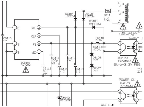

      It is fusible resistor, low Ohm, it will go open circuit if the SMPS circuit shorted out.
      Check the resistance between S and D pin of the SMPS IC to see if it shows low resistance reading.
          The resistance across S and D is 170ohms. Seems low?
              That does not look good. I would replace that IC.
                    budm, do you think there could be more damage on circuits leading away from that IC? I suppose that IC could tap out on its own?
                    EDIT: If I de-soldered that IC and tested resistance across the bare pads S and D with the same ohms value I'm guessing I need to look further?
                    You can check the resistance of the two IC legs once you remove it from the board..

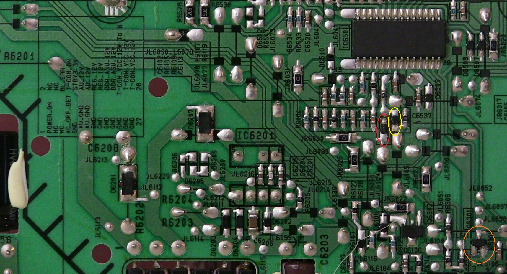

                      I thought I'd post this pic of a couple suspect items near the suspicious IC. In the red circle, at the top solder joint of this resistor? it looks more like a solder ball than a solder joint. Right next to it circled in yellow appears to be a capacitor with a scraggly looking solder joint on the bottom. Circled in orange, down and to the right there's a transistor that also looks like it has scraggly solder joints.
                      All of these are making me wonder if there was some kind of over-voltage event on the A/C side?
                      Does anyone have an opinion about these items?

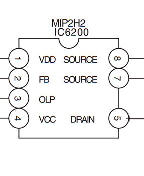

                        I successfully de-soldered IC6201. The low reading follows the chip. Testing across the pads on the board shows infinite. There's no shorted caps or resistors nearby, but the cap between pins 1 and 8 (VDD and SOURCE) tested short...until I removed IC6201. This short follows the IC as well.
                        Could the no stand-by issue simply be a bad IC6201 and the fusible resistor R6201?
                        Also, the transformer isn't 12V, it is for the 3.3V stand-by circuit?
                            The ic is shorted, replace it and the open resistor
                                  It should be a 10Ω 1/2 watt fuseable flameproof
                                  Here is digikey page of a few https://www.digikey.ca/products/en/r...=1&pageSize=25
                                  If you check page 30 of the manual (post#4), it is listed as [R6202] as the diagram is slightly different
