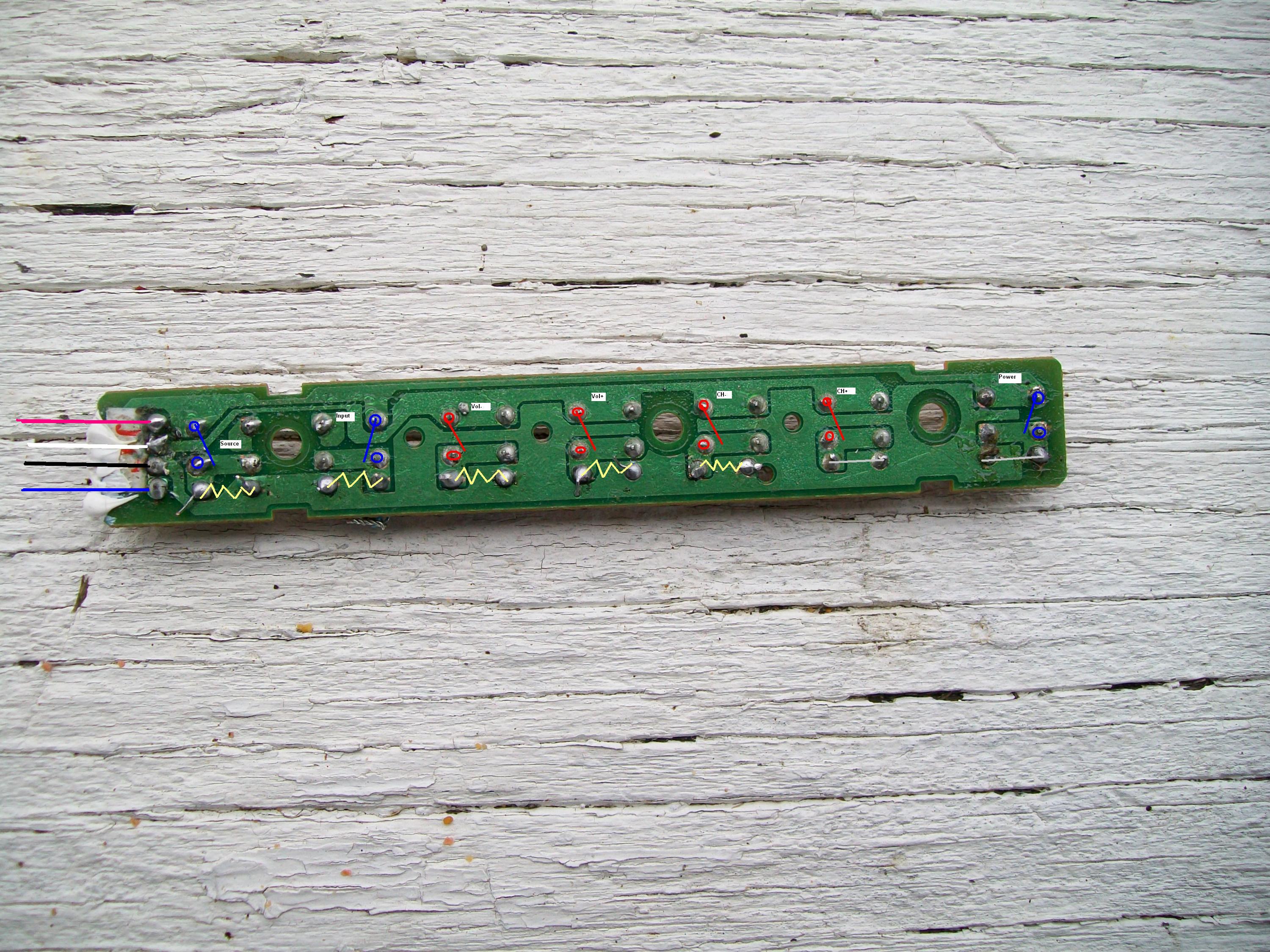

    Re: Jensen JE1907DC 12v RV TV

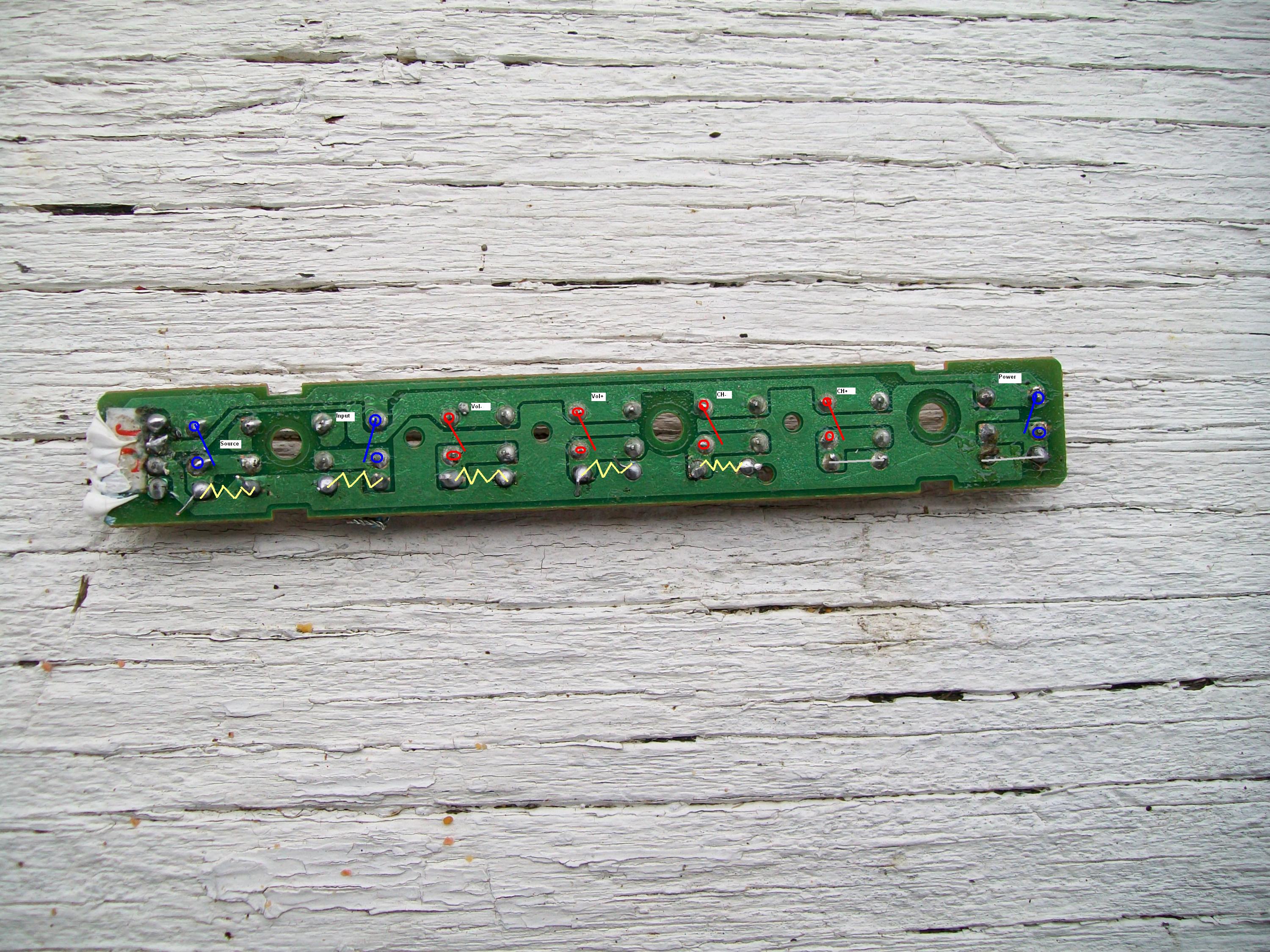

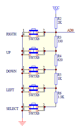

    The way those button ladders usually work is one line is ground, one is at supply (3.3 or 5v) and one is the output line.
    Yours seems to have one ground and two seperate circuits one for Power, Source & Input and the other for ch+,ch- and Vol+,vol-
    the top pin in the picture is not used, second from the bottom would be ground

      I'm not sure what else to do.
      If the button board is needed for the TV to work is there a way I can "trick" the TV into working without the board?
      Could I ad up the values of the resistors on the board then put together a set of resistors to equal that value and connect it to the cable that goes from the button board to the main board then use the remote to turn the TV on?
      thanks

                  #48
                  If you look at the button board, with none of the buttons pressed it will be the same as nothing connected,
                  looking at the picture, common or ground is the second pin from the bottom, so there should be infinite resistance between that common pin and each pin on either side of it unless a puttonis pushed (or bad)
                  The top pin looks unused. Is this how the wires are connected?

                    #49
                    yes that is how they are connected.
                    I'm pretty sure the problem is something to do with the main board from what I've read online.
                    The thing I don't get is why would heating the button board make the TV stay on?

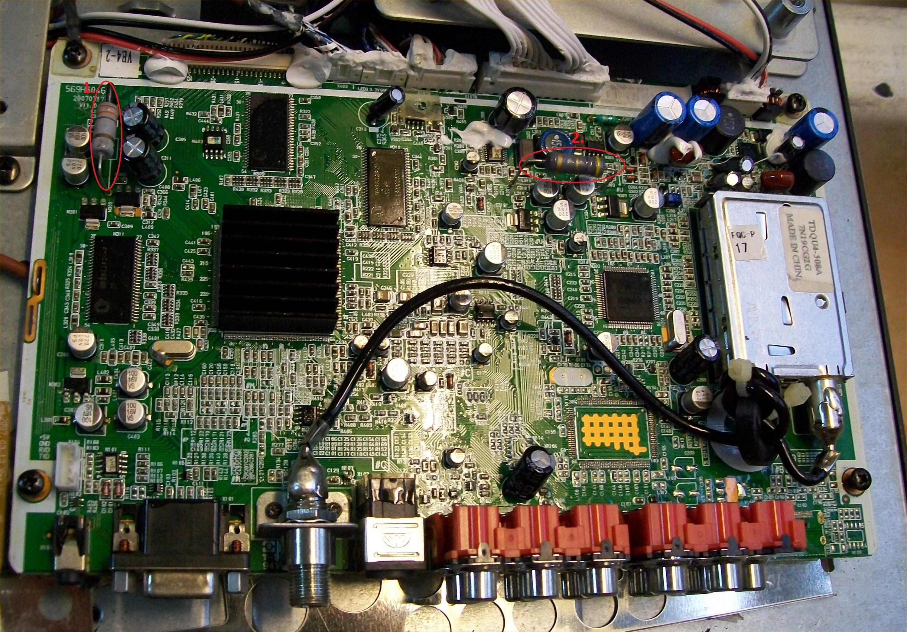

                          I was probing around the mainboard today and the resistor in the upper left of the pic measured 000 and the one on the upper right measured 1. (circled in the pic)
                          Is the resistor that measured 000 acting as some type of fuse?
                          The other that measured 1 ( I tried all ohms settings on DMM) shorted and therefore bad?
                          They were tested in circuit..should I test them out of circuit?

                            The resistors are ok, they are used to drop the voltage down a bit for the regulators
                            #2 is a 4.7Ω not sure about #1 but as a rule resistors don't go low or shorted, the go open.

                              1 last effort before I give up.
                              Since I seem to be getting the right volatages do you all think my problem is likely with the main board, mores specifically the eeprom?
                              Since there doesn't seem to be any parts available for this TV it would probably be near impossible to replace the eeprom ( if thats the problem?) without having a eeprom dump?
                              thanks
                                I did notice the large plug in the picture is not seated properly, also sometimes those elec. caps around the regulators go bad (open) and cause the regulator ic to oscillate putting noise into the circuit.
