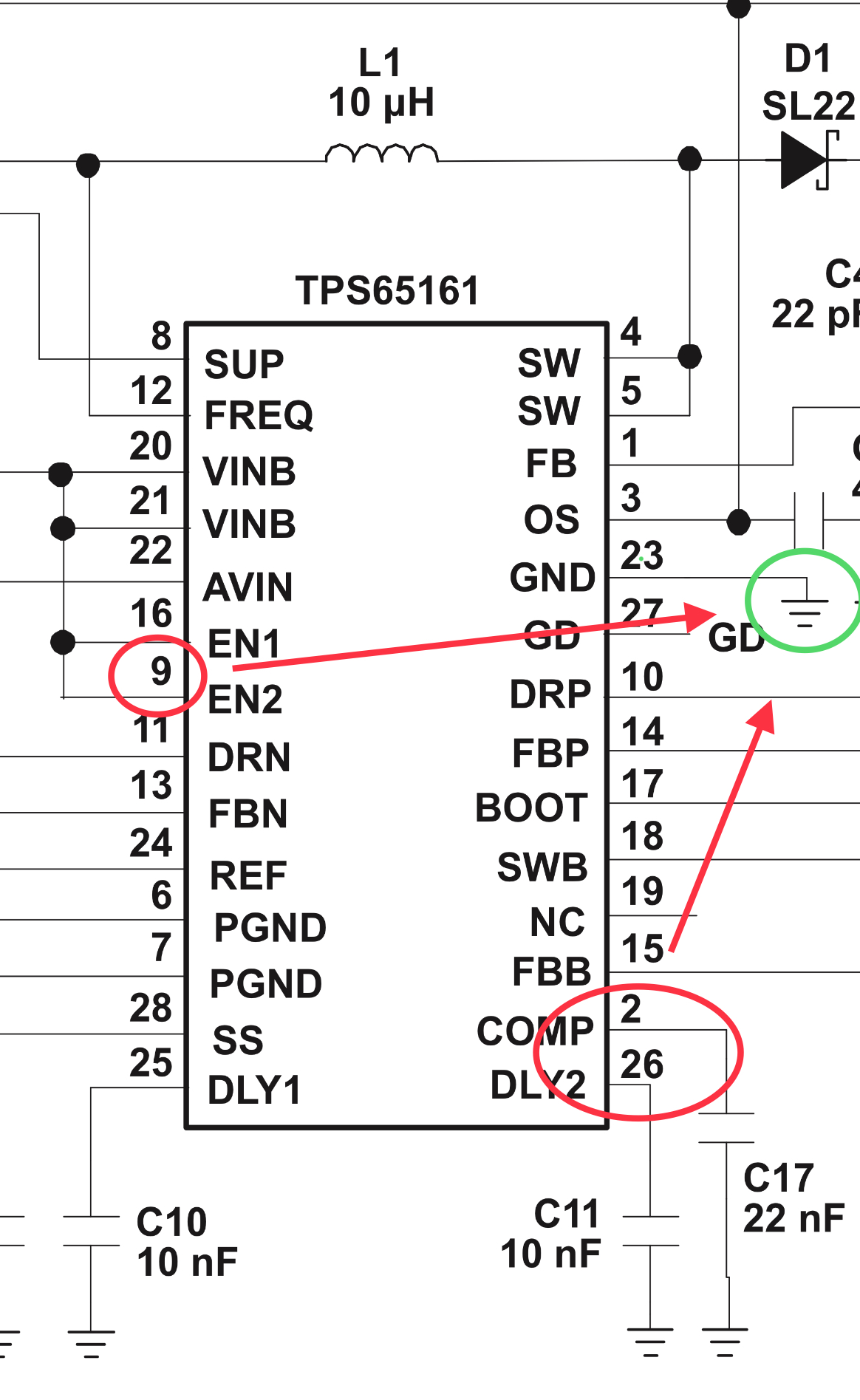

    Not all well, i told to test point 2 again in VOLT...
    For the test on the DP1 anode to the GND it seems OK, maybe there is not a a signal to the near TPS65161 that enables AVDD. In the image under i have squared two test zones, one you can test if C_RP41 is connected to C_CP11 near it, then if you can test in volt RP21 and RP41 respect to GND.
    RP41 connected to CP11 - connection Good
    TP2 Voltage - with left ribbon unplugged - 12.59
    TP2 Voltage - with right ribbon unplugged - 12.59
    RP21 in Volts - -5.48v
    RP41 in Vola - 0.019

      Theese last test tells me more that AVDD booster is not switched on, for some reason, but not for a panel fault.
      Check the voltage on PIN 9 and 26 of the UP1. IF PIN 9 is low like zero and same for pin 26 then check the capacitor on the pin 26.

              Pin 9 - 0.019v
              Pin 26 - 0.019v

                I repeat: "IF PIN 9 is low like zero and same for pin 26 then check the capacitor on the pin 26", that is, desolder it and check its capacity. If it seems good change it anyway with one took from a unuseful board, same era, same or little bigger volume.

                    Check the resistance between circuit GND and those two pins, no power to the board of course.

                        Budm would the cct GND be the one i've Put a green circle round or GND on the Tcon? Sorry for the stupid questions, thanks for your time.

                          Current Findings.
                          GND on tcon board (BP) - (RP) to pin 9 = O/C
                          GND on tcon board (RP) - (BP) to pin 9 = 589 ohms
                          GND on tcon board (BP) - (RP) to pin 26 = O/C
                          GND on tcon board (RP) - (BP) to pin 26 = 744 ohms
                          (BP) - Black Probe DMM
                          (RP) - Red Probe DMM
                          TIA All
                          S.

                              Hi Budm any these readings help or shall i just remove cap on pin 26 and measure as previously instructed by Davi.p and replace.

                                Thank you Davi.p and others for their input, TV now repaired and up and running Tcon was the issue here.
