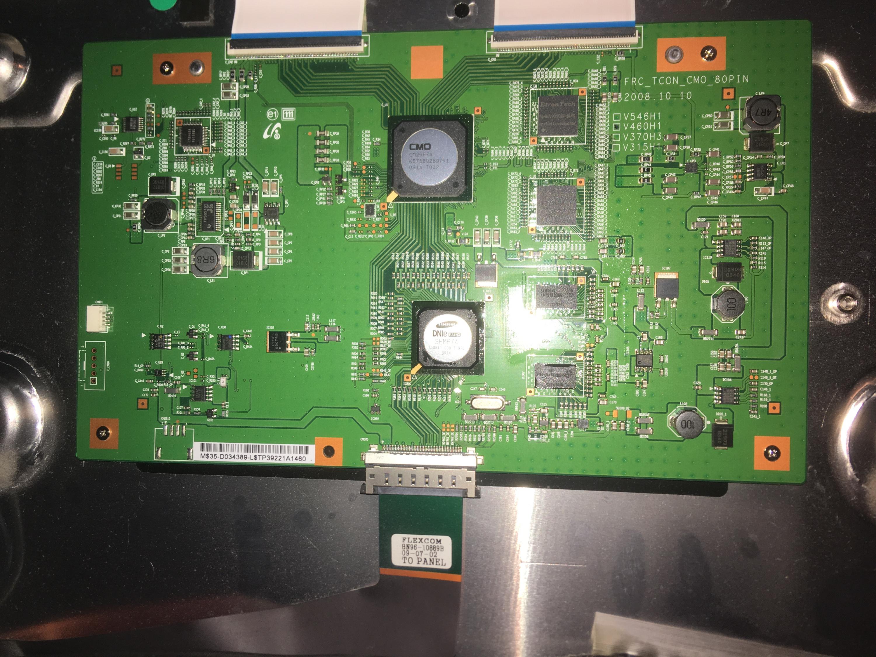

    Hi all looking for some help on the above set i'm trying to repair.
    Tv powers on and has sound but no video or OSD, just a white glow from the backlight.
    Had a look around >
    Checked fuse on Tcon all fine here.
    Checked all cables
    Gave the PSU a good Visual.
    Thanks in advance

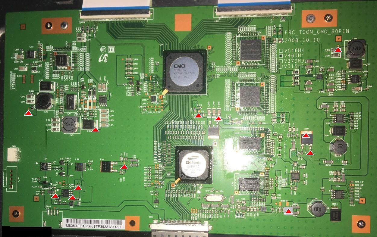

            Vdd, Von, Voff, Vcom, Vgl and Vgh are voltages to start with.
            • StephenU
              • Dec 2013
              • 230
              • United Kingdom
              Re: Samsung UE46B6000VW
              I've had a look at the silkscreen on the board but can seem to see the TP's you are referring too.
              • Andrew F. Ali
                • Jan 2014
                • 2450
                • Trinidad & Tobago
                Hmmm...I seem to not be able to find them too. They may be on the panel Bds that the FFCs go to. However, your problem is either T-CON or Panel. With my experience I would tend towards T-CON as these T-CON Bds. are noted for failure.
                • Davi.p
                  Hobbist Tech
                  • Sep 2009
                  • 4540
                  • Italy - Milan
                  Hi, test theese points in Volt.

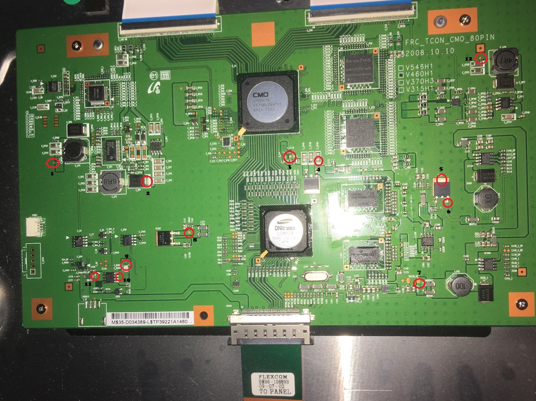

                      I have numbered up the test points and attached a pic here are the results I got.
                      1 - 3.31v
                      2 - 12.58v
                      3 - 1.12v
                      4 - 2.47v
                      5 - 1.816v
                      6 - 3.288v
                      7 - 1.064v
                      8 - 2.512v
                      9 - 12.67v
                      10 - 12.67v
                      11 - 12.67v
                      12 - 2.472v
                      TIA.
                      S.
                      • Davi.p
                        Hobbist Tech
                        • Sep 2009
                        • 4540
                        • Italy - Milan
                        It lacks of the Avdd signal, Check in diode mode across C_DP1 and its anode to ground. Check this point two again after disconnecting one at a time of the tcon output cables.

                            with reference to "C_DP1 and its anode to ground" - Just the normal Black Probe on chassis ground and Red Probe to anode of Diode C_DP1?
                            when in diode mode you have to check between the indicated points in one way and reverse..

                                  So here's what I got -
                                  TV off and both tcon outputs plugged in.
                                  Red probe on Anode - Black on Cathode = 0.177v
                                  Black probe Anode - Red Probe Cathode = O/C
                                  BP Chassis RP Anode of C_DP1 = 1.43v
                                  BP Chassis RP Cathode of C_DP1 = O/C
                                  RP Chassis GND - RP Anode of C_DP1 = 0.54v
                                  RP Chassis GND - BP Cathode of C_DP1 = 0.65v
                                  RP Chassis GND BP (Test Point 2) = 0.65v - Same value measured with 1 tcon output ribbon at a time.
                                  Hopefully I've took the readings correctly.
                                  TIA All
                                  S.
                                  (RP - Red Probe)
                                  (BP - Black Probe)
                                  (O/C - Open CCT)
                                  • Davi.p
                                    Hobbist Tech
                                    • Sep 2009
                                    • 4540
                                    • Italy - Milan
                                    Hopefully I’ve took the readings correctly.
                                    Not all well, i told to test point 2 again in VOLT...
                                    For the test on the DP1 anode to the GND it seems OK, maybe there is not a a signal to the near TPS65161 that enables AVDD. In the image under i have squared two test zones, one you can test if C_RP41 is connected to C_CP11 near it, then if you can test in volt RP21 and RP41 respect to GND.
