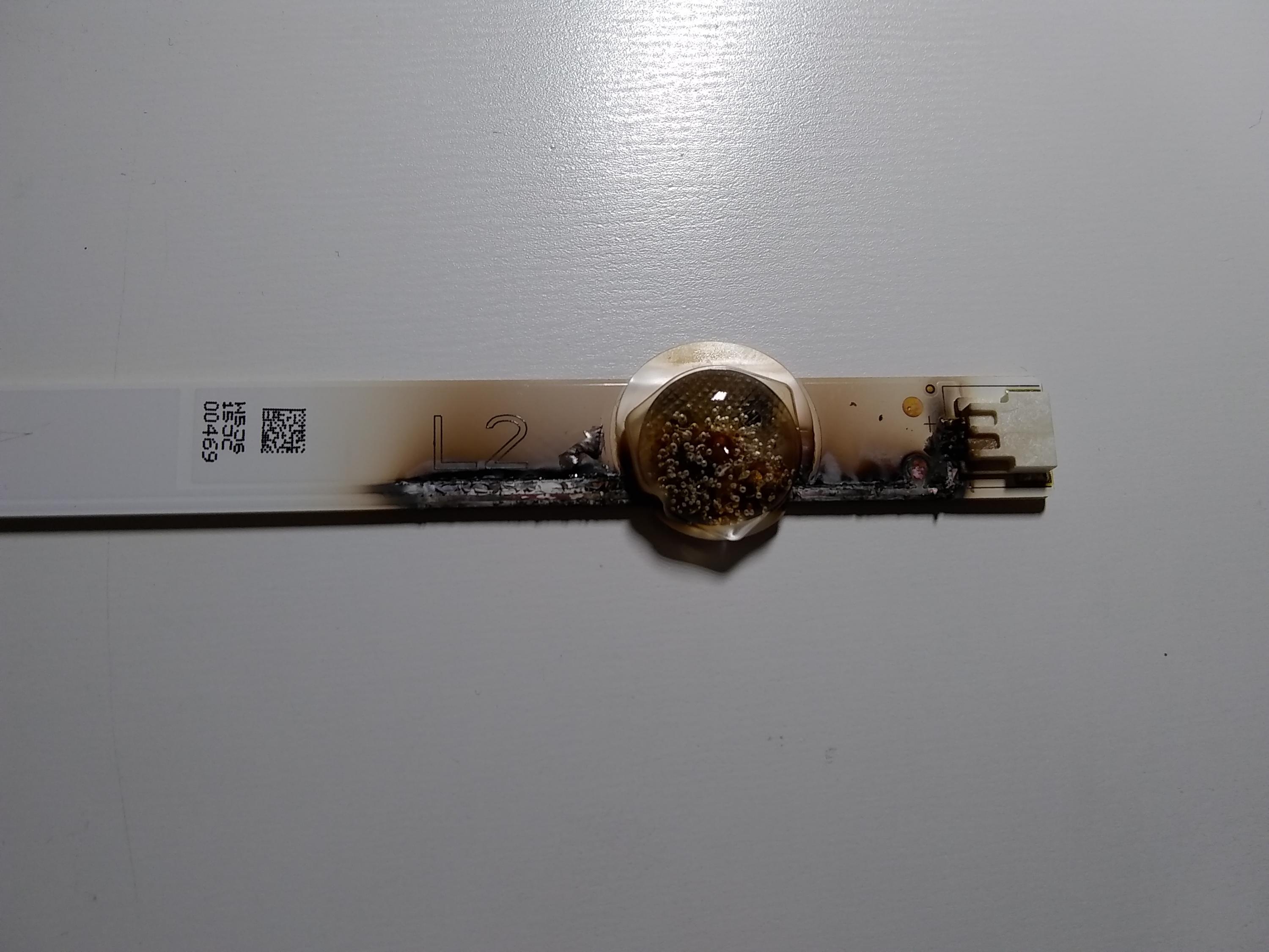

This LED actually caught on fire burning the paper backing around it. The double side tape underneath it had become unstuck so the section of the strip was floating without any heatsinking. Luckily the paper reflector backing doesn't seem super flammable. There were about four other bad LEDs in this TV without visible damage. Once repaired, I checked the backlight setting and none of the inputs were at 100%. Though this is not a smart TV, I have found on the smart LN models, the media player and smart apps (Youtube, Netflix) may run the backlight at 100% by default.
50LN5310 Burnt backlight

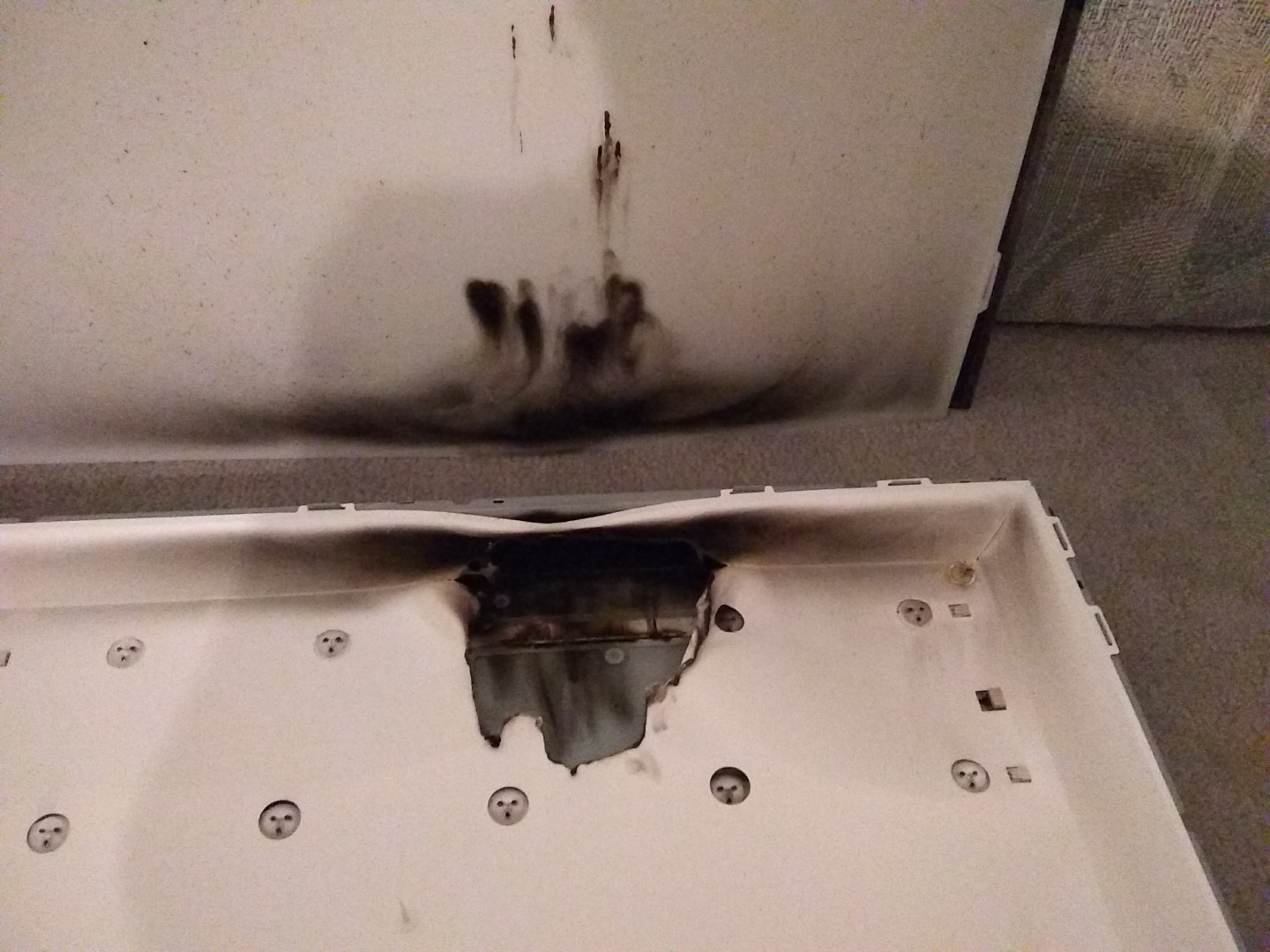

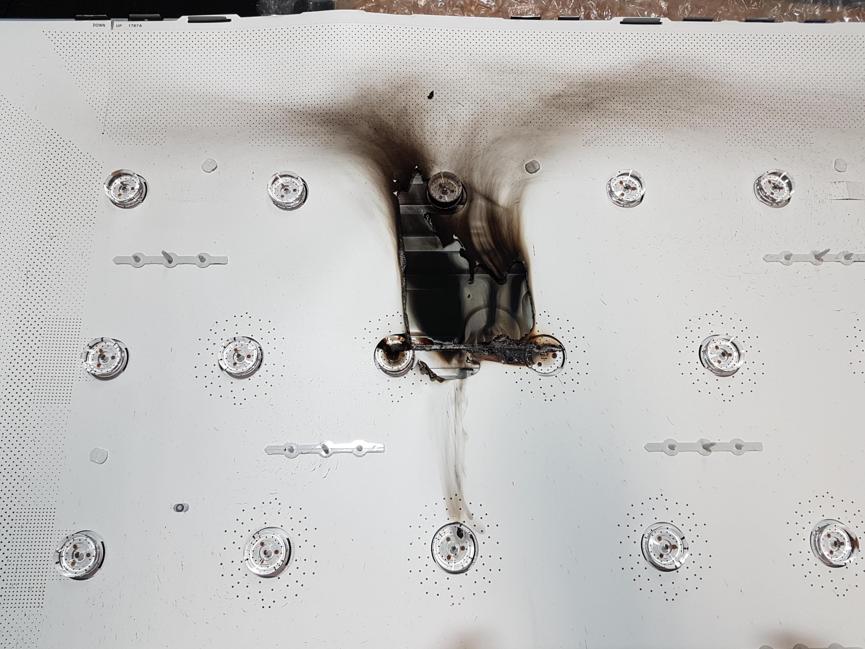

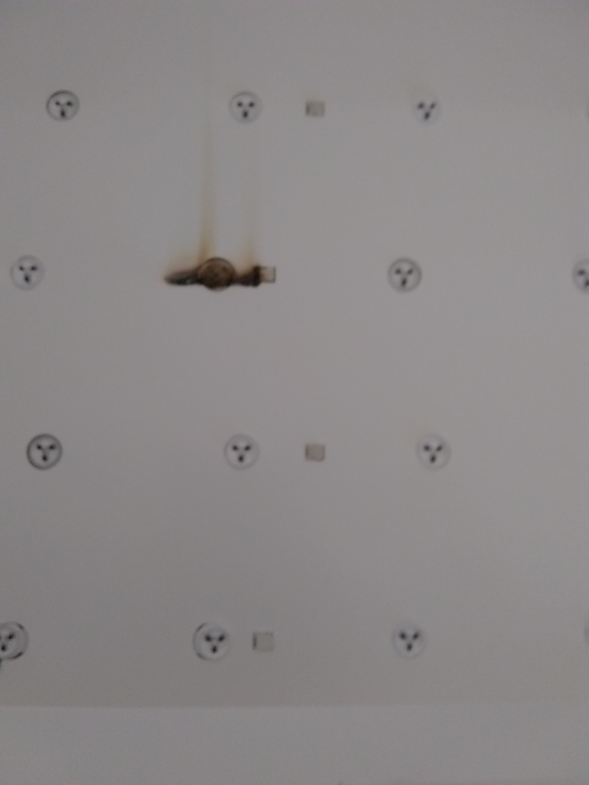

Re: 50LN5310 Burnt backlight
Not as bad as this one:
https://www.badcaps.net/forum/showth...ht=LG+47LN5790
Luckily the whole TV did not catch on fire.
This one is not too bad:
https://www.badcaps.net/forum/showth...ight=burnt+ledLast edited by budm; 04-17-2019, 11:12 AM.Never stop learning
http://www.badcaps.net/forum/showthread.php?t=24809Comment
