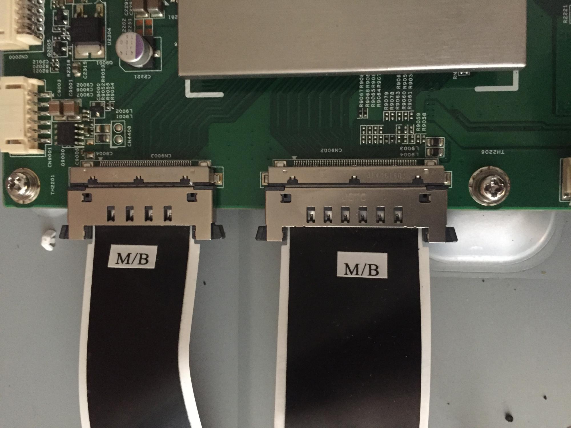

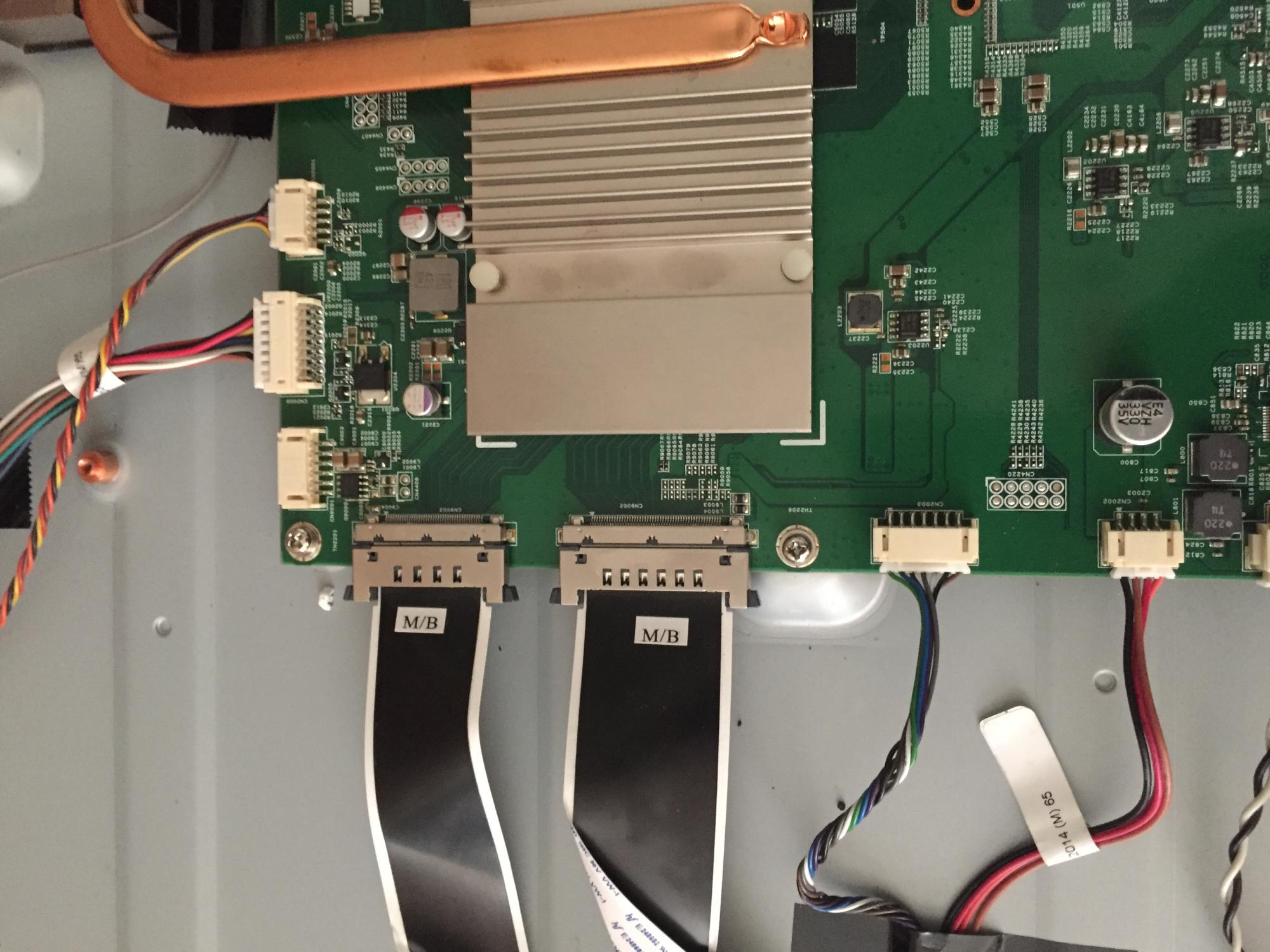

                    Well, I got the new main board and put it in but it did not work. In fact, it's quite a bit worse than the original one because now I can't get any video to appear at all and there is no sound either. It does cycle on and off every minute or two, just like before, but nothing else.
                    It did not help that the board was damaged during shipping, with the upper heat shield bent and, to an extent, broken. But, I simply replaced this with the one from the original and so that was not what I considered a determining factor. Also, one of the aluminum caps was broken off but I just soldered that back into its correct place. Neither one of these things caused the board to go bad, I do not think, but who knows what other components might have been damaged during shipping or not working correctly when it left their distribution center?
                    So, I put the original back in and got the same results I've been seeing for about 3 weeks. Nothing changed. Having determined that, I put the new one back in a 2nd time and it continues to show no picture at all and no audio whatsoever. Very frustrating.
                    Hard to tell where that leaves me. If the new main board is indeed bad, there still remains the possibility that it is the only thing that is wrong.
                    Within the last couple hours, and with the new main board still in, I disconnected everything from the main board except the power from the PSU, and nothing changed. I'd like to say that the continued cycling on and off I still get in this scenario indicates that the main board is indeed bad and therefore the culprit, but it's still very difficult to tell if the cycling on and off also occurs simply because I have disconnected the other boards in this particular experiment (meaning, I disconnected Main Board to T-Con, Main Board to LED Driver Board, and even the Power Supply to LED Driver Board). The same thing happens with the original main board in place in terms of the recurring cycling on and off with all other boards disconnected.
                    Hope that's enough information for someone to make a further suggestion or suggestions. I'll likely be returning this new main board soon, but I'm going to keep it for another week or two to try to troubleshoot it or troubleshoot the original main board by comparing it to the new one. I should be getting my new capacitance meter soon, so that might help track down any problems or anomalies with the aluminum caps found on these main boards.
                    I suppose I could order a new LED Driver Board and give that a try. Since a new T-Con a few weeks ago did not change anything, and the new Main Board made things even worse, maybe the replacement of the LED Driver Board will provide a clue or even fix the cycling on and off part of the issue.
                    It seems to me that I have to track down the fault that is causing this constant power cycling and then deal with the 1/2 picture as a second, or secondary, issue. Perhaps they are one and the same issue, but the only two things left that might allow for that are the:
                    1) Ribbon cables going from the Main Board to the T-Con (especially the one that causes the defective 1/2 picture)
                    OR
                    2) A fault that lies "below" the T-Con and resides on the lower panel board or boards (there are two).
                    ..... but both of these scenarios seem unlikely because the cycling is still occurring when these ribbon cables and everything below them (T-Con and lower panel boards) are DISCONNECTED and therefore functionally out of play.
                    Nick ~ Since you have so much experience with these, maybe you can educate me a little further on what the power cycling on and off can most likely be attributed to. I would really like to solve that element of this puzzle. Or, anyone else, of course.
                    Any ideas or thoughts would be appreciated. Thanks.

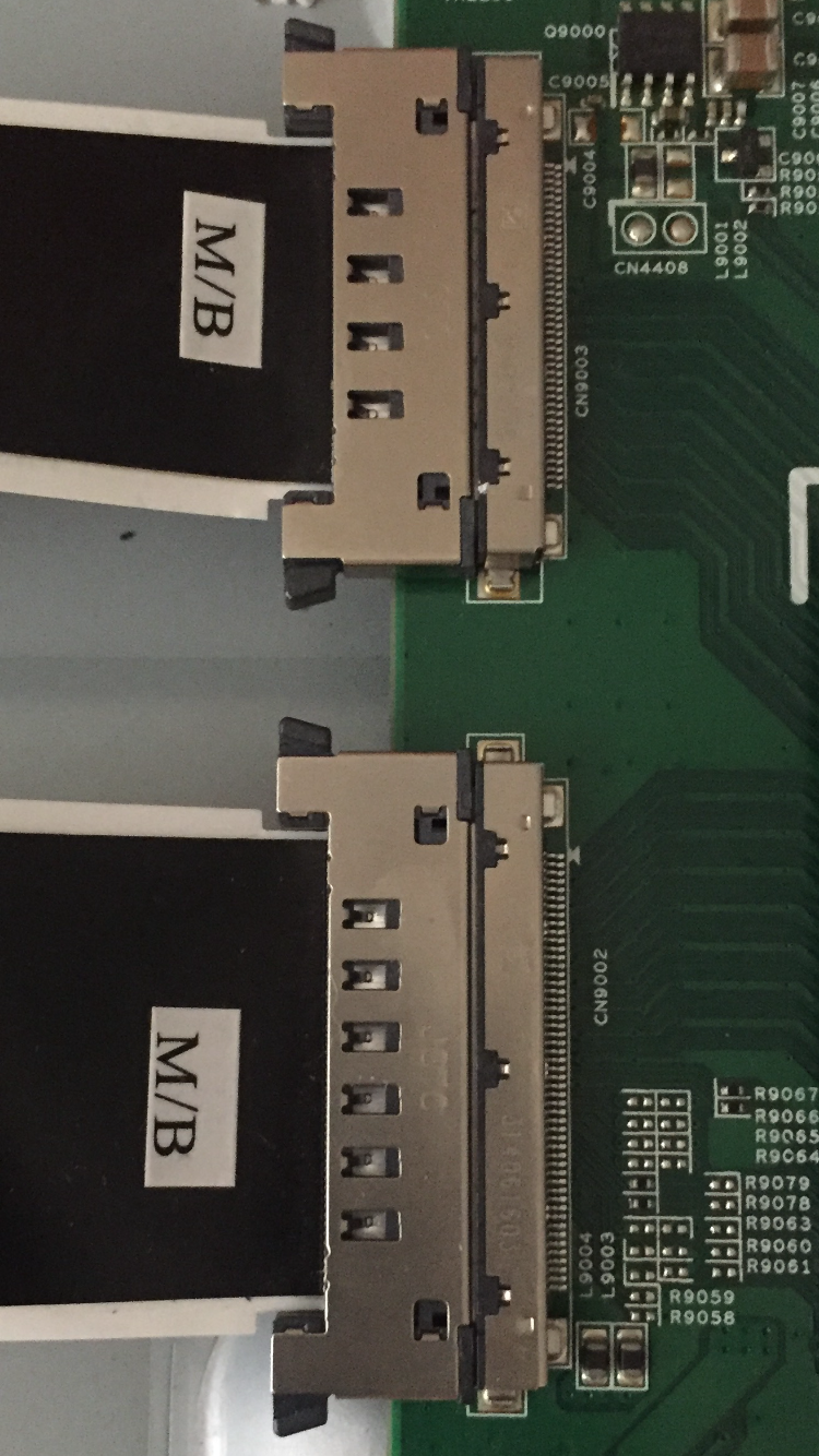

                          Working on it a bit again this morning, and something just happened that I do not believe has ever happened before. With the original Main Board back in (because I am getting nothing productive from the replacement Main Board), the backlights lit up not only once but twice in relative succession. Came one for about a minute, then went off for about 4 or 5 minutes, then came back on AGAIN.
                          I don't think this has ever occurred in the past without my having to unplug the AC power in between "lightings".
                          Also, the entire screen was flickering rather wildly upon the second lighting of the LED's. I think that did happen briefly once before about two weeks ago. Not sure what that is all about.
                          When the LED's were on today, I quickly measured the voltages on the Main Board connectors (see pictures below) where they head out to the large, white ribbon cables and then down to the T-Con, and I was also able to measure the T-Con connectors where these same large, white ribbon cables enter.
                          As expected, when the correct picture appears on the left side of the screen the voltage is present on that particular large, white cable BOTH at the Main Board Connector and the subsequent T-Con connector. It read 11.7. Pretty sure it's a 12v line so that was okay. Of course, it almost had to be in order to produce the 1/2 picture that is, essentially, flawless.
                          Note: There are correct voltages coming off of the Power Supply Unit and heading into the LED Driver Board, so those two do not appear to be related to the problem in any way, shape or form.
                          Now, here's the telltale sign:
                          The other large, white ribbon cable and its two connectors did not have any such 11.7 reading, again as expected. But what pretty much gives this scenario away is that even though all of the LED lights across the entire set lit up, there is NO VOLTAGE READING on ANY OF THE CONNECTOR PINS on the MAIN BOARD where that silver connector leads out to the T-Con.
                          So, in short (no pun intended), I think that pretty much proves once and for all that the problem lies within the Main Board itself and, in particular, only with the circuitry that leads to and controls the upper, silver connector. Because there is no voltage being applied there, no signal is being sent to the T-Con. This, of course, produces the 1/2 screen of white, pink and green fuzz.
                          All of this is what I reasoned a couple weeks ago, with the help and advice of Nick from Nick's TV. The replacement board was supposed to remedy all of this. But, as you might suspect from all of my previous posts, when I ran the same silver connector voltage tests on this board this morning as confirmation, I get NOTHING on the voltage reads on either silver connector. Keep in mind that this replacement board does not produce the LED lights at all (have tried it over 40 or 50 times), and so it has a fault that precedes the large, white ribbon connectors. Hence, no voltage ever gets to either of these connectors (apparently) and no picture is ever produced .... and that's why I am sending it back for the refund.
                          In summary, when the LED's do light up and the original Main Board is in, there are correct voltage readings on ONLY the Main Board and T-Con Board connectors that control the good 1/2 of the picture.
                          The key point is that even though these LED's are fully lit, the other silver connector on the Main Board (the upper one) reads NO VOLTAGE. Therefore, it's pretty safe to conclude that the Main Board is faulty.
                          The only other possible (and very slight) explanation I can think of is that the T-con is faulty ~ only on its left-hand side ~ and is somehow sending a signal in backward fashion to that particular silver upper Main Board connector and denying a voltage reading there. I really don't think that is even possible, but someone can correct me if I am wrong.
