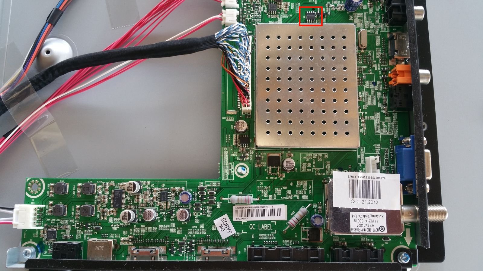

                          Re: HiSense 50K360G Button Lock
                          Didn't seem to address my issue..
                          But I did get a new BIOS chip from EBAY...
                          But I am not sure where the BIOS chip is...
                          Attached is a pic and the chip I think it is, says EM24C32F, is marked in red..
                            Actually the markings on the chip is
                            FM24C32F
                            1230J5R
                            • Michale32086
                              • Nov 2011
                              • 1453
                              Found it.. It's underneath the metal shield..
