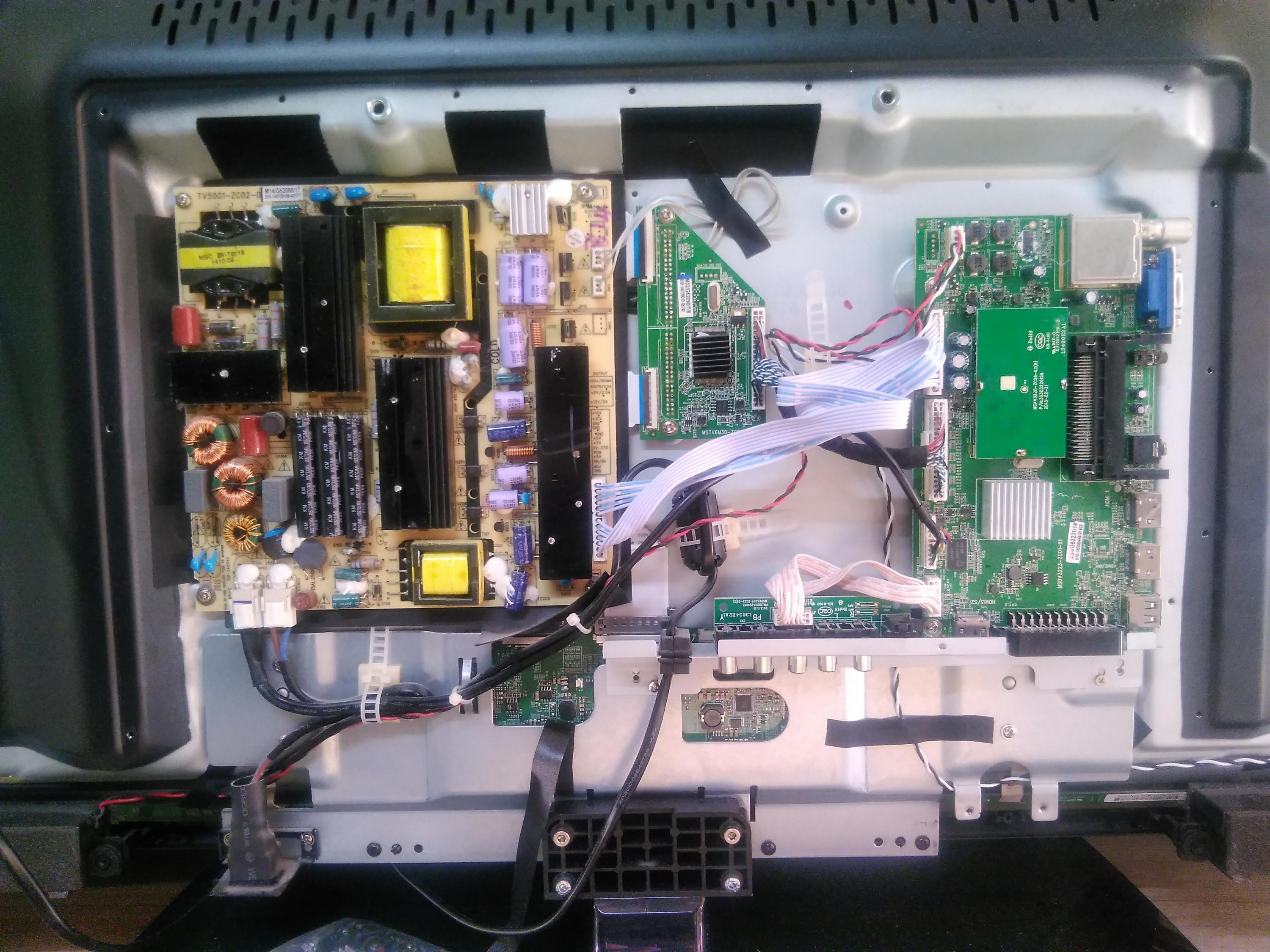

                Re: Jvc lt-50e73
                We will need to see photos of the boards to advise better.
                • fester
                  • May 2017
                  • 158
                  • Slovakia

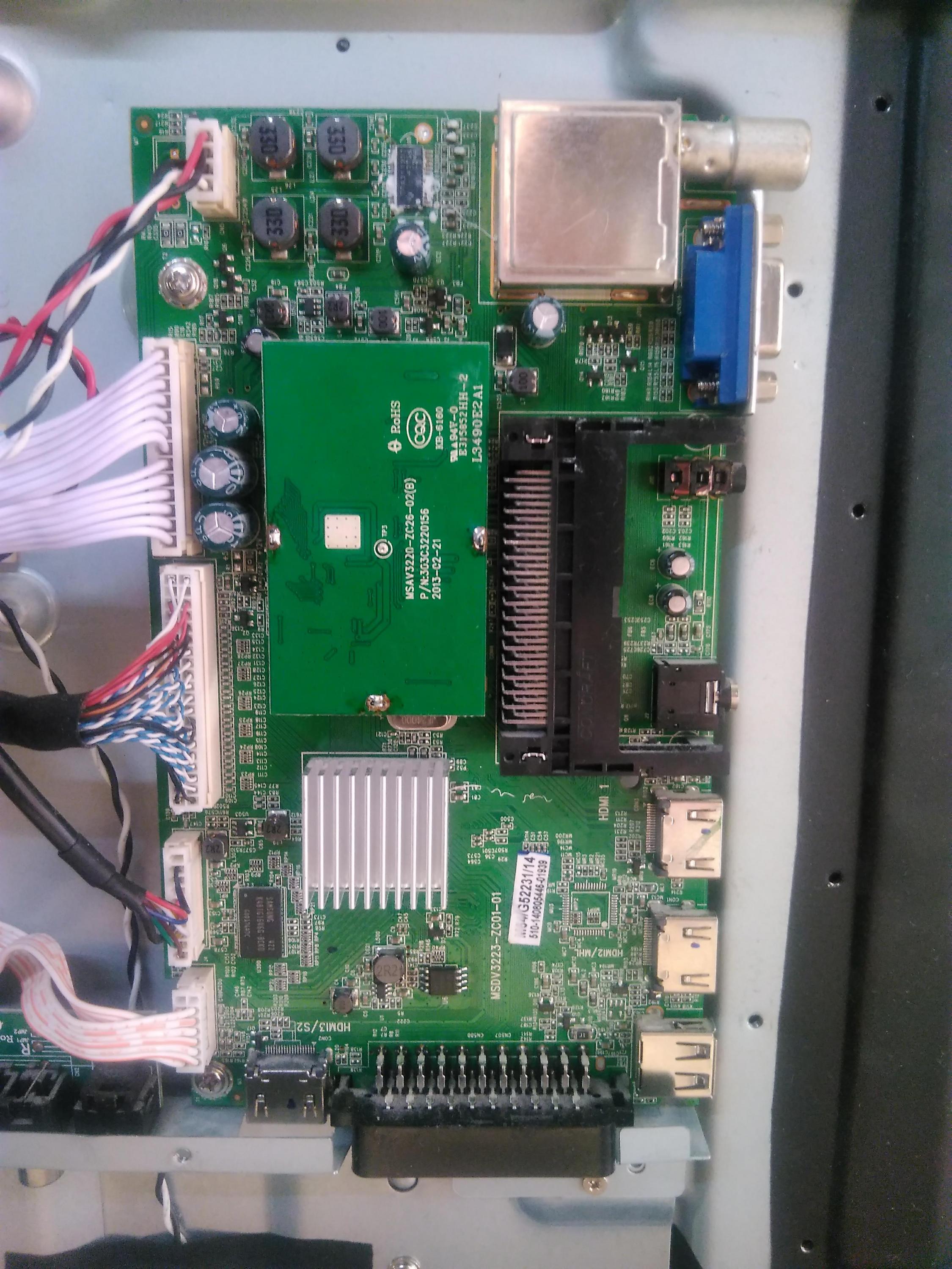

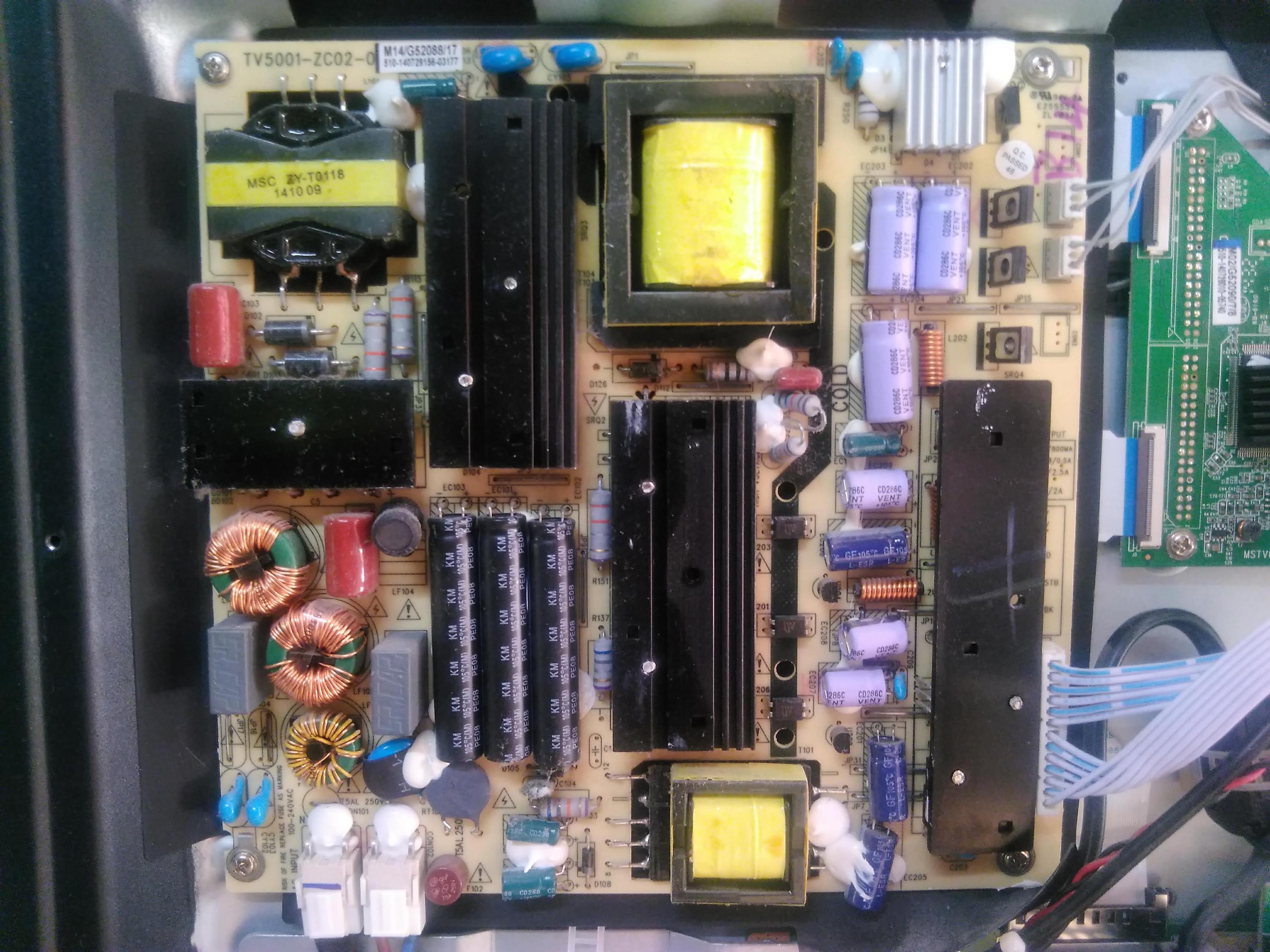

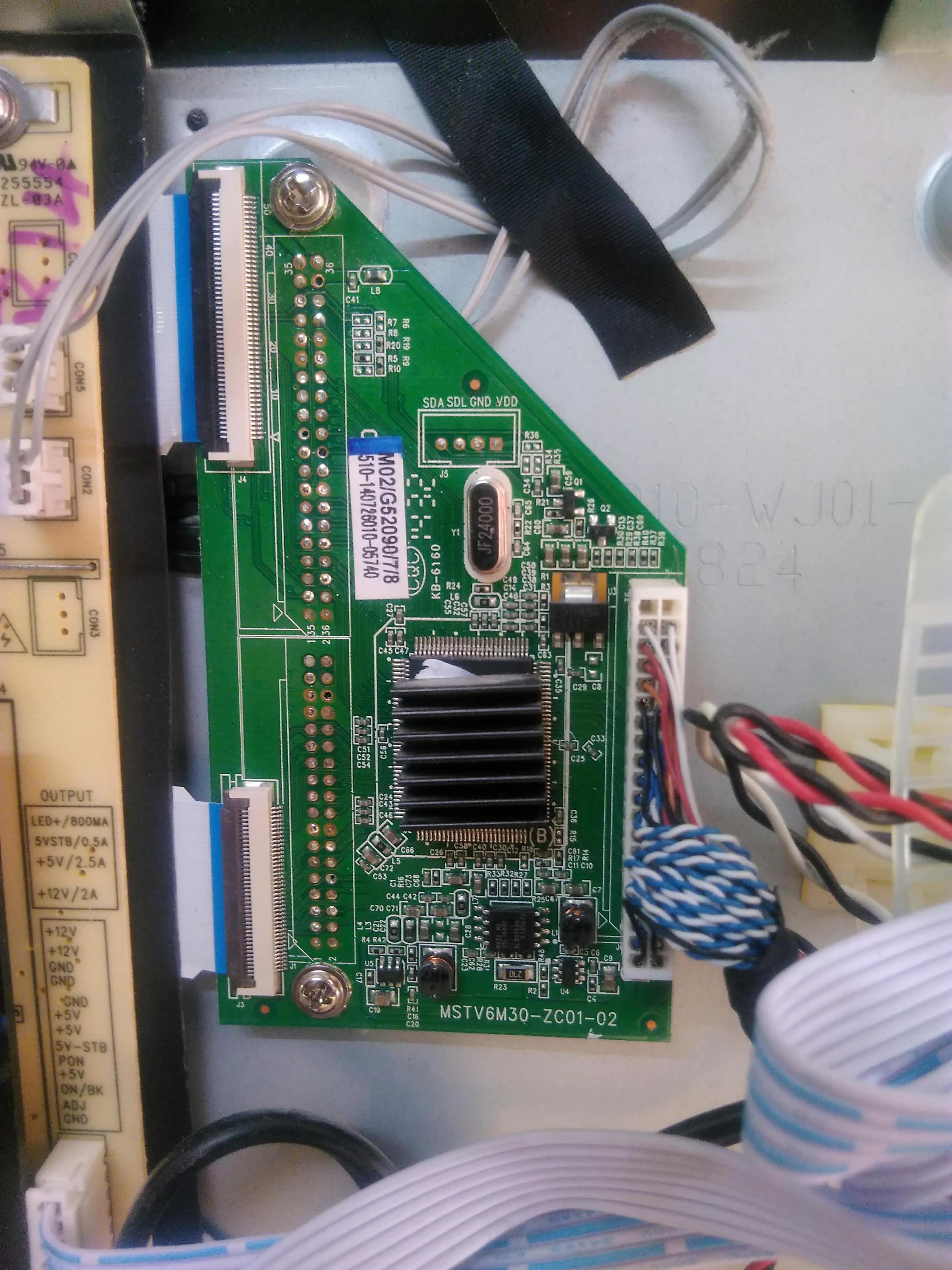

                  Re: Jvc lt-50e73
                  here it is,t-con board is under metal plate,i dont removed it yet.
                  • fester
                    • May 2017
                    • 158
                    • Slovakia
                    Re: Jvc lt-50e73
                    hups,t-con is visible,under metal plate is only display board

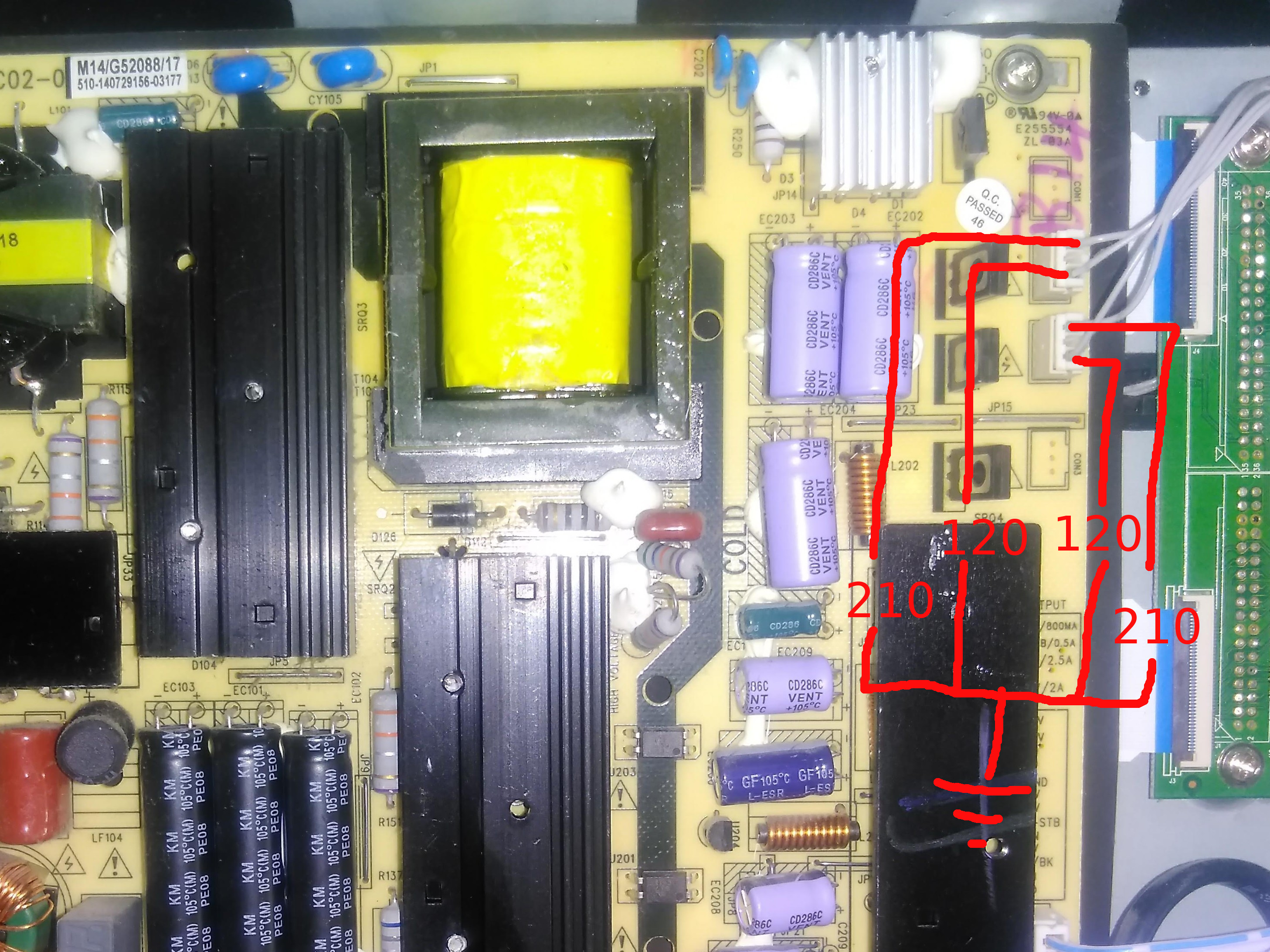

                      Re: Jvc lt-50e73
                      There look to be two plugs with two wires each that feed the backlight (Con5, Con2), measure the voltage on each wire while turning on the tv. Do this for both backlight connectors.
                      On one pin you will likley get 100-140 volts (guess) on the other you should get 10 - 20 volts (guess) if you get the 100-140 but 0 volts on the other pin it is likely an open led string

                        Re: Jvc lt-50e73
                        i have voltage spikes on both connectors,max value what i see on multimeter is arround 90V. if i disconect one connector,no matter which one,the same behavior,only short blink of backlight.
                          Re: Jvc lt-50e73
                          Voltage spike on ALL 4 of the LED connector pins?
                          • fester
                            • May 2017
                            • 158
                            • Slovakia
                            Re: Jvc lt-50e73
                            no,i meassured voltage between two pins of one connector
                              Re: Jvc lt-50e73
                              You need to use chassis GND and the ref. GND for the meter.
                              Please repeat the test on all 4 pins by leaving the probes in place while keeping an eye on the meter during TV powered on to see how high the Voltages go up to for each pin.
                              • fester
                                • May 2017
                                • 158
                                • Slovakia
                                Re: Jvc lt-50e73
                                Sorry for delay,i am too busy last few weeks..here the meassurements in volts..
