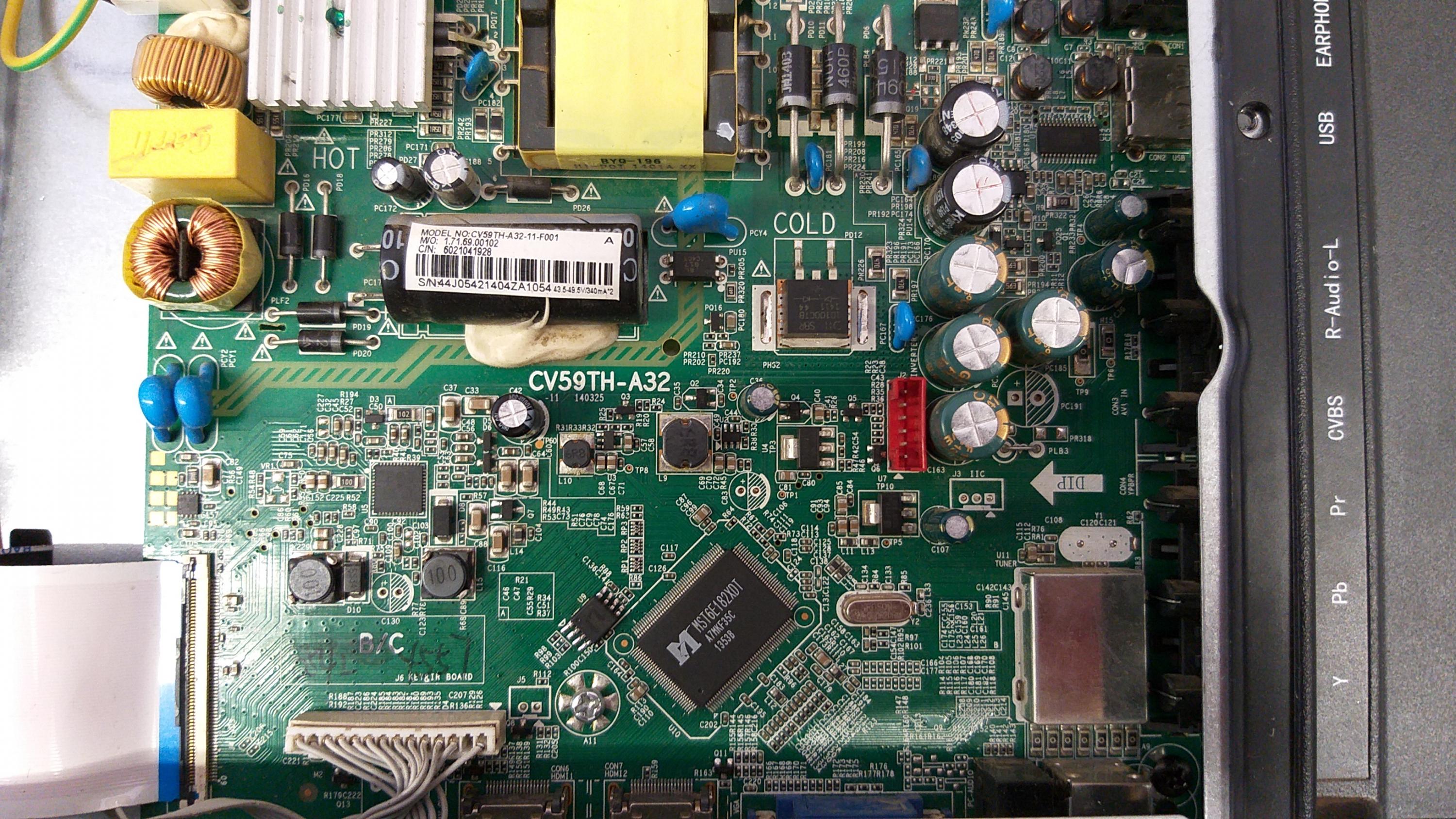

    Update!
    I got an eprom dump from a person on facebook. I loaded it and still same result, no luck. Is there something else i can check? Because its a all in one board it makes things difficult but on the voltage regulators i do have 12V, 3.3V and 1.8V On the 3 diodes from the power supply i have 53VDC. I also have 19V going to the back lights which is not enough to drive the LED's

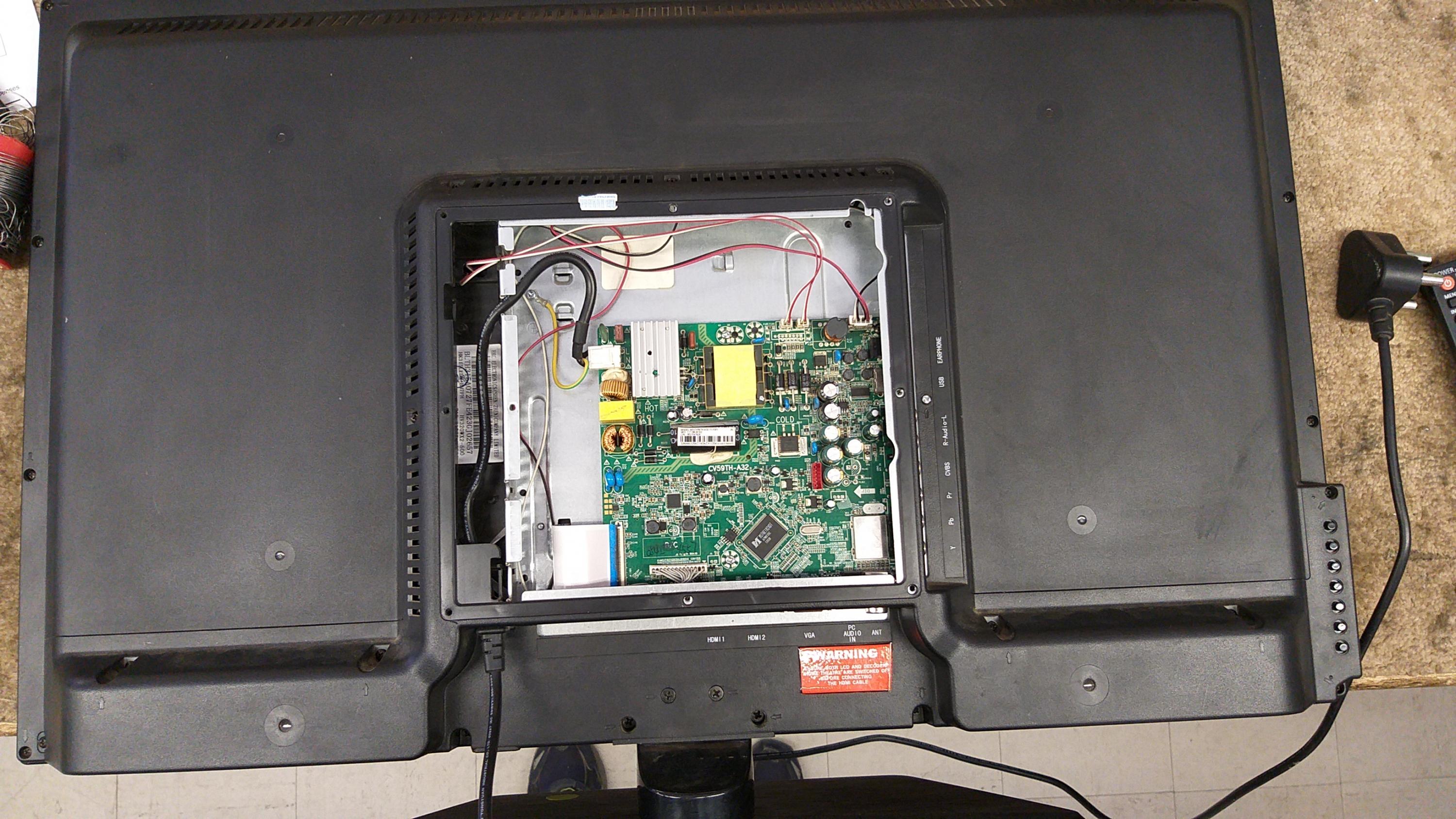

    • Andrew F. Ali
      • Jan 2014
      • 2450
      • Trinidad & Tobago
      Re: Telefunken 32" LED TV Model TLEDD-32HD Require Firmware
      Photos would be useful.
        I have included a picture of the board. What else would you like a photo of?
          can you upload one picture of the back of the tv so we can see where all the wires are going too and one clear picture of the back of the board thanks
            Is this adequate?
