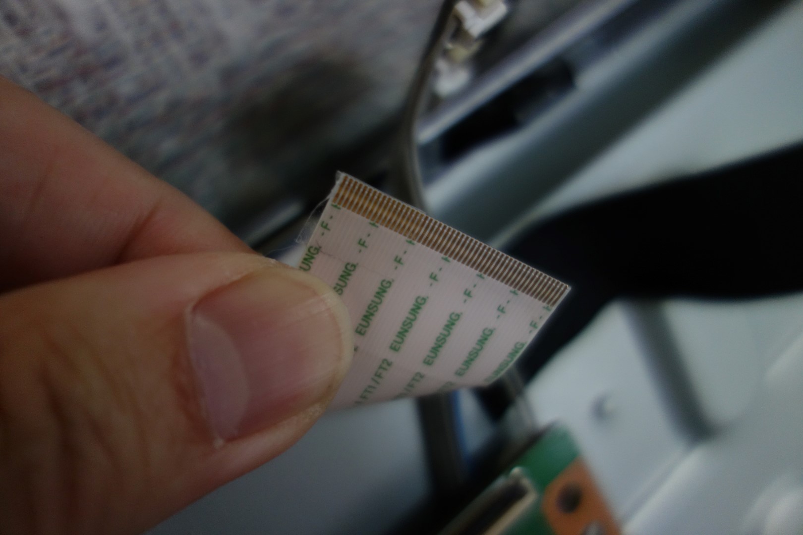

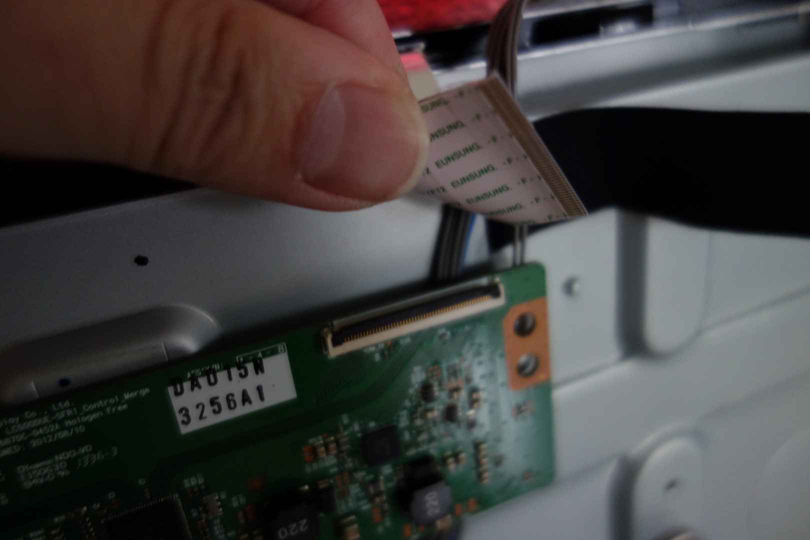

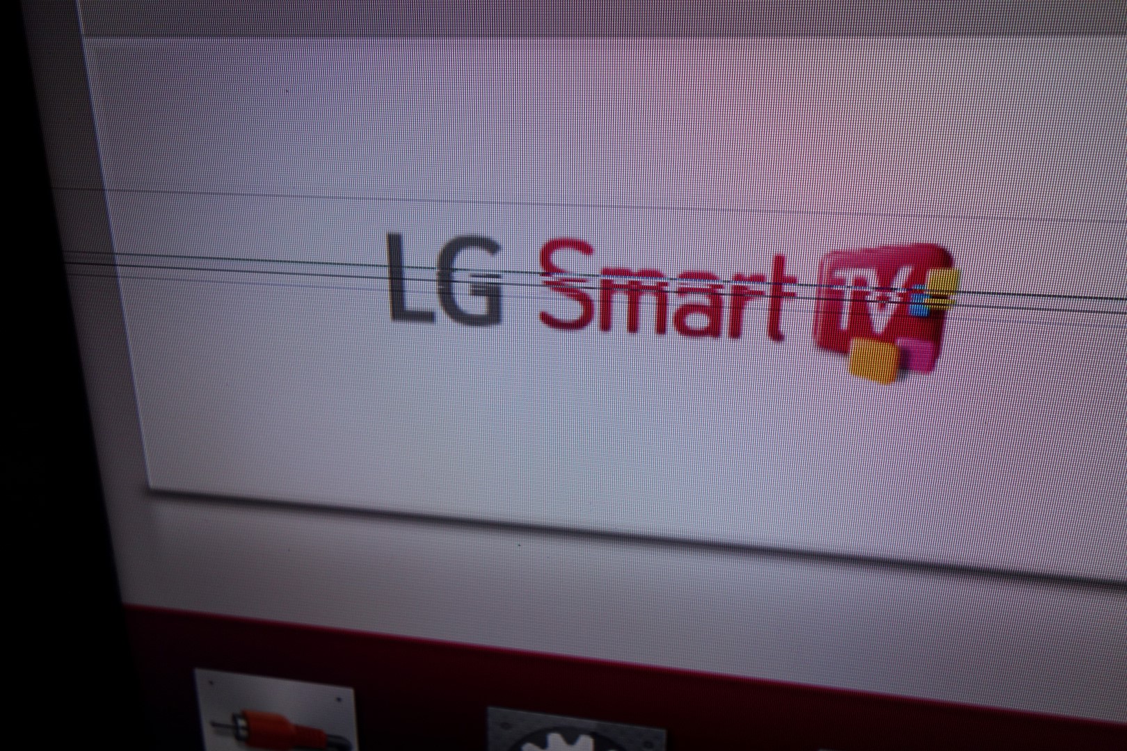

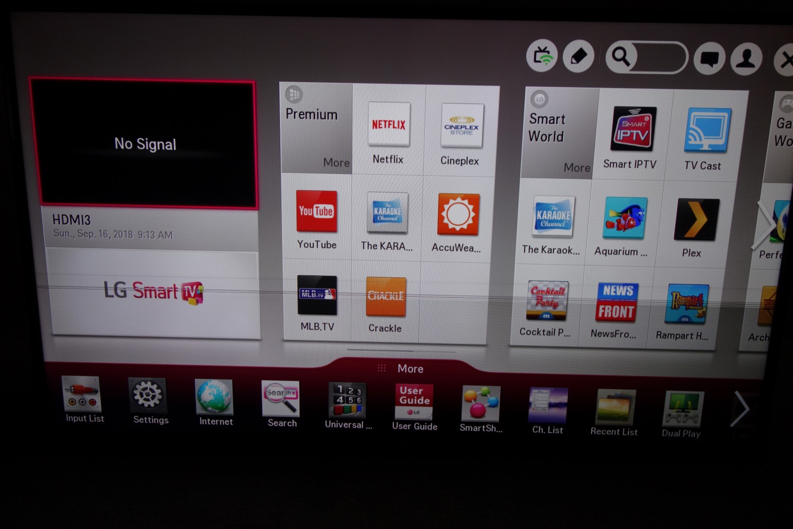

This TV had a logo flash on plug in which is symptoms of a bad LED backlights. Replaced 4 shorted LEDs and now getting horizontal lines. Tcon ribbons connected one at a time show both vertical and horizontal lines with one side. Confirm this is a bad panel before I scrap this tv?
LG 50LA6205 Bad Backlight and Bad Panel
Re: LG 50LA6205 Bad Backlight and Bad Panel

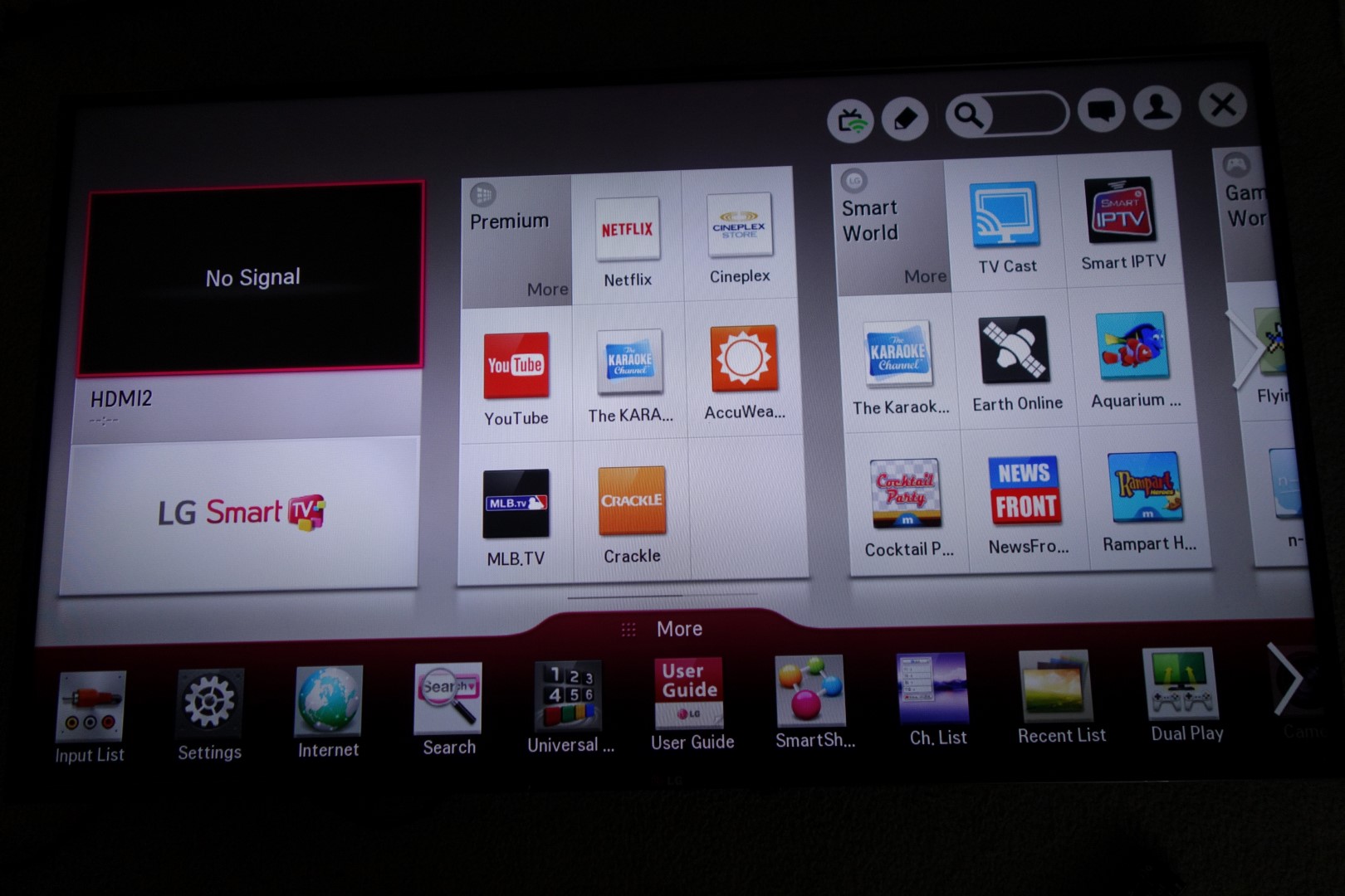

Thanks Davi.p! Was ready to take the TV to recycling and decided one last attempt with the tape method on the tcon ribbon after reassembling the TV. Luckily none of the parts sold yet on ebay. On the side that showed lines (right), I blocked off around 20 pins on the leftmost side and it worked!!

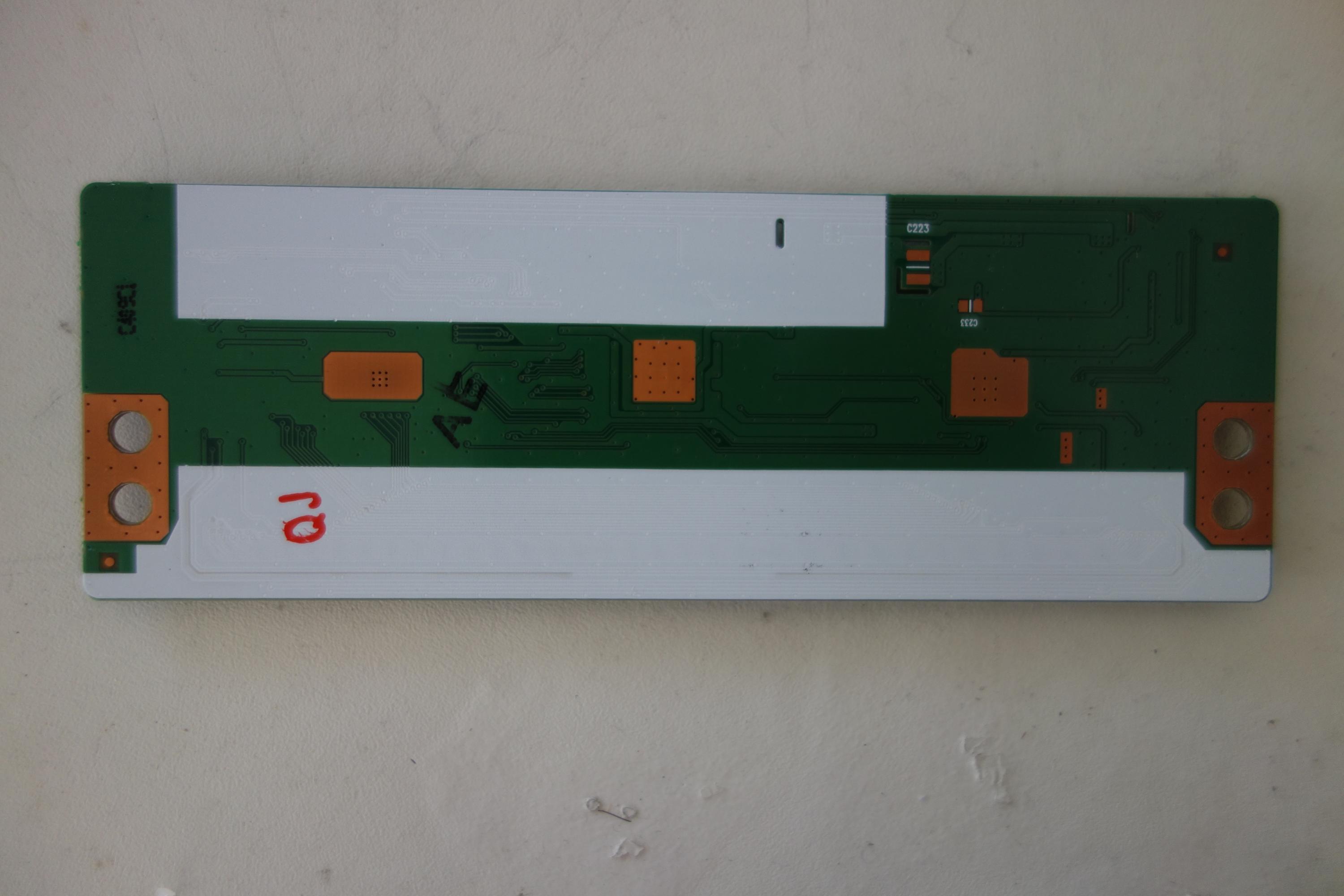

Can I get good clear pictures of the T-CON board so may be I can see what those pins are for.Never stop learning
Thanks for the pictures, at least I can read the PCB and PCBA numbers so now I can go to shopjimmy to get good clear pictures.Never stop learning

Saw two youtube videos before about putting tape on the tcon ribbons. One wasn't really clear what he was doing. Tape is actually used to block the pins and not to apply more pressure to the contacts. Another one I recall was to vary the pins blocked and location. Mainly trial and error with the location and width of the tape. I'll see if I can find them since it was awhile ago.
