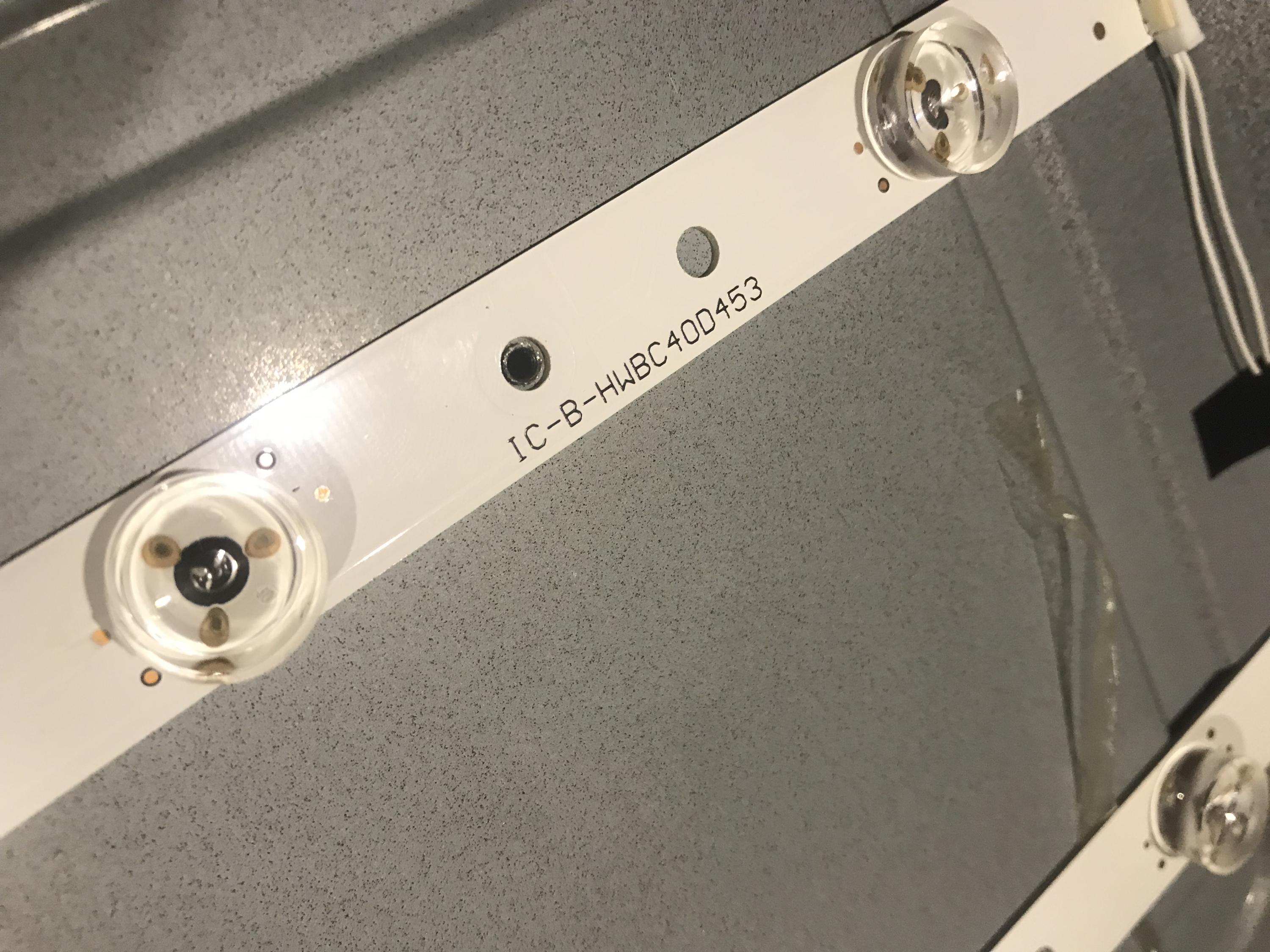

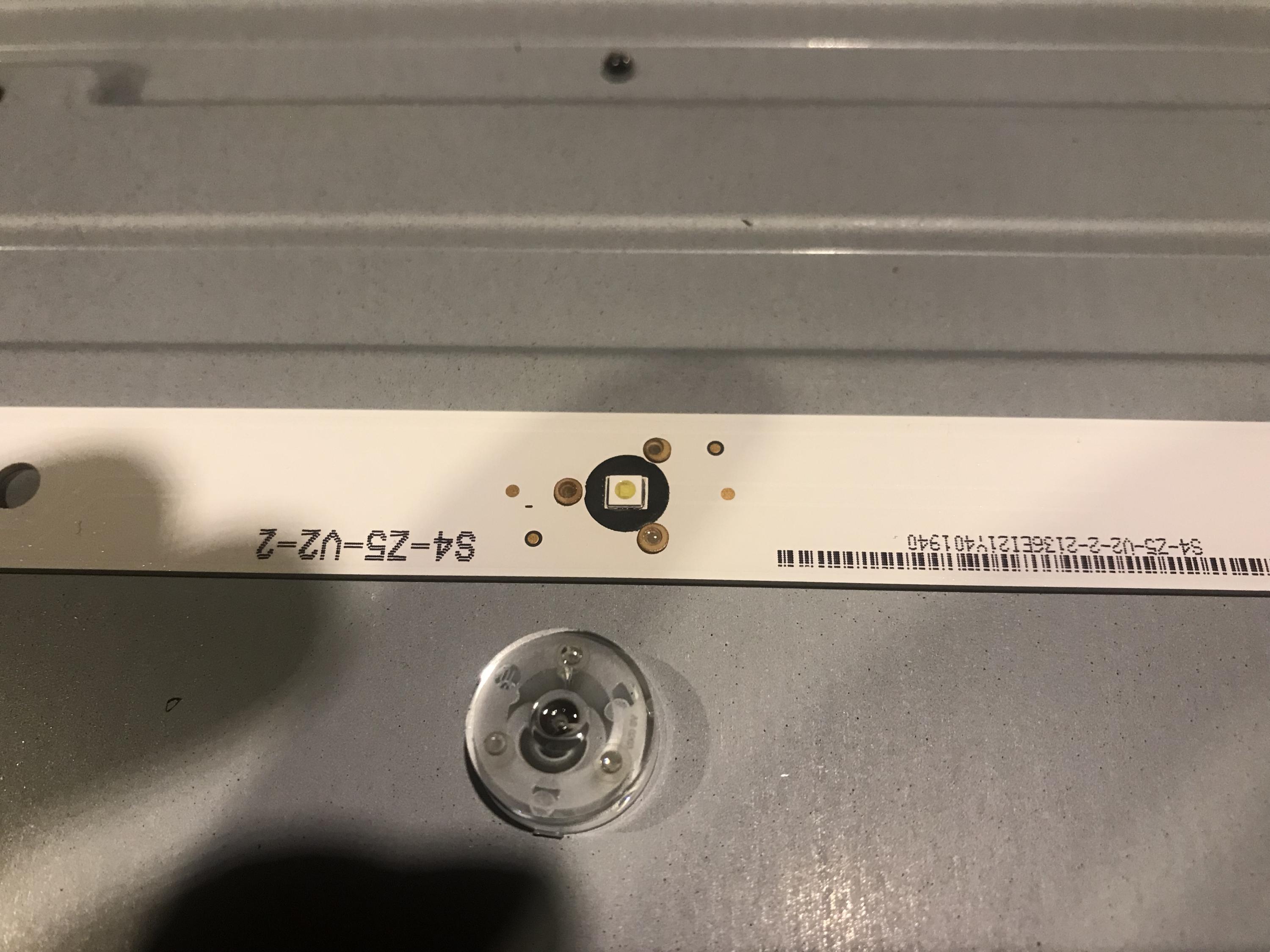

    Hi
    i got a Blaupunkt 40/233I tv with a broken backlight.
    I disassembled the tv and looked for bad caps but they are ok. The backlight connector delivers ~30V under load
    So I disassembled the panel and found 2 broken leds on the led stripes.
    Can you help me to find the correct package and correct values?

    You need to measure the length and width of the LED to identify the package and determine if they are 3V or 6V.

      Hi
      Thanks for your message
      The led is 4mm x 3mm
      There are 20 leds in series. So 30V / 20 = 1,5v?
      Thanks for the link. There they are really expensive. I would like to buy them from my local electronics dealer.
      Greetings
        Re: Identifying backlight LED
        If the 20 White LED (3V LED) in series so the total Vf = 20 x 3V = 60V.
        The 30V looks to be the feeding Voltage to boost converter circuit to drive the 20 series- connected LED.
