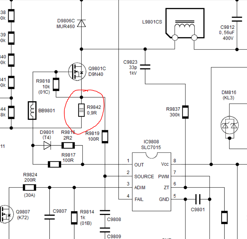

    Dear forum, I would like to ask some help identifying the backlight circuits resistors to limit the ampere to the backlight leds.
    The power supply is a BN44-00852 and I want to decrease the backlight to increase the lifetime of the LEDs.
    The TV is pretty much always on, used for CCTV cameras.
    I suspecting R9838 -> R9841 resistors but I'm not sure. Thanks in advance!

    R9842 - Increase resistance.

        Thank you very much. The video is also very useful.
        How can I identify these kind of resistors in the future?
          It all depends on what backlight driver is installed in the TV.​
