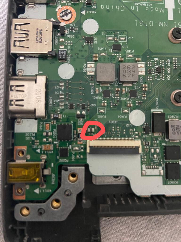

identifying backlight fuse in v14 ada type 82C6

    I need help identifying and replacing a blown backlight fuse in lenovo v14 ada type 82C6. Any help would be appreciated..

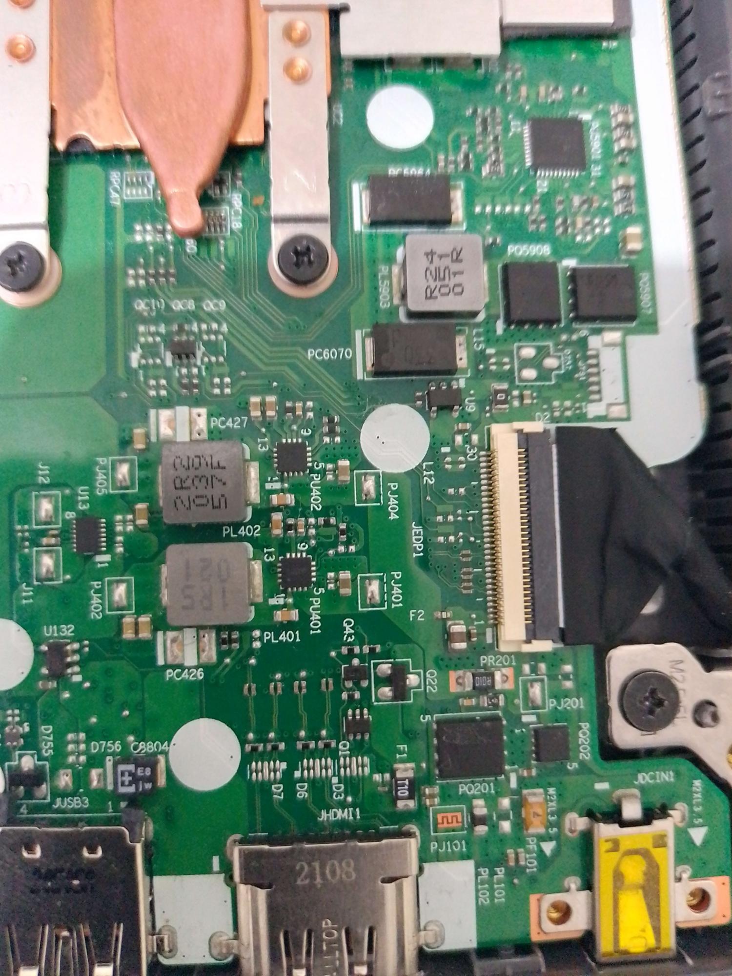

    What you circled is a capacitor, F2 could be around 2~3 amp, what are the markings on it?

      Re: identifying backlight fuse in v14 ada type 82C6
      there are white two lines that reflect light when shined light with a flashlight
        As already posted in another thread you can find the part with the schematic and boardview https://www.badcaps.net/forum/showth...hlight=v14+ada
