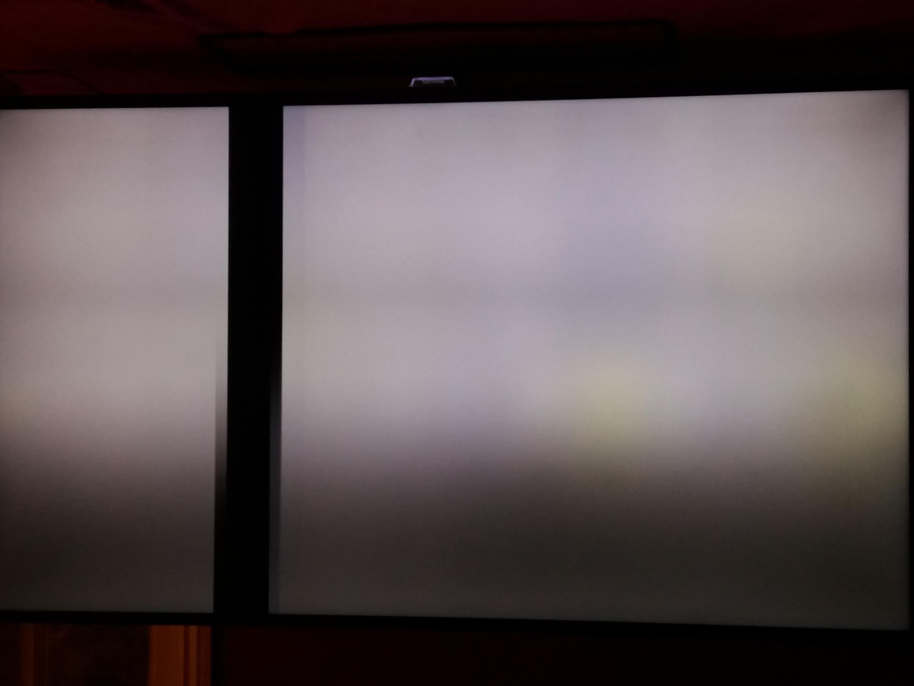

        Replaced blown leds with some i had but seems not quite right.
        Replacements were supposed to be:
        3030 3v 1w
        Vf 3.05-3.65v (250mA)
        6000-6500K
        120-130lm
        but then chinese imports so who knows what they actually sent.
        Think the colour temp is wrong, could see the difference before re-fitting but just wanted to see how it would look with panel back on. Not actually that noticeable whilst colours on the screen, its when its a greyish or white screen.
        The black band across the top is of course where an led has gone out again, perhaps poor soldering, underated mA or just cheapo crud. Or could be another 'old' led gone out.

          Do you have picture of the bacside of the LED showing the solder pad pattern? You also need to find out if the big pad is Anode or Cathode.
          Small pad is anode +
          Large pad is cathode -
            Re: Philips 50PUT6400/12 no backlight
            LG Inotek LED has Large pad as Anode.
            Most Samsung LED backlights have Large pad as Cathode.
            Did you use cool white 7000K?
              cold white 6000-6500k, at least thats what they were advertised as.
                  that black band looks like tab driver is damaged
                      Definately due to led's fortunately.
