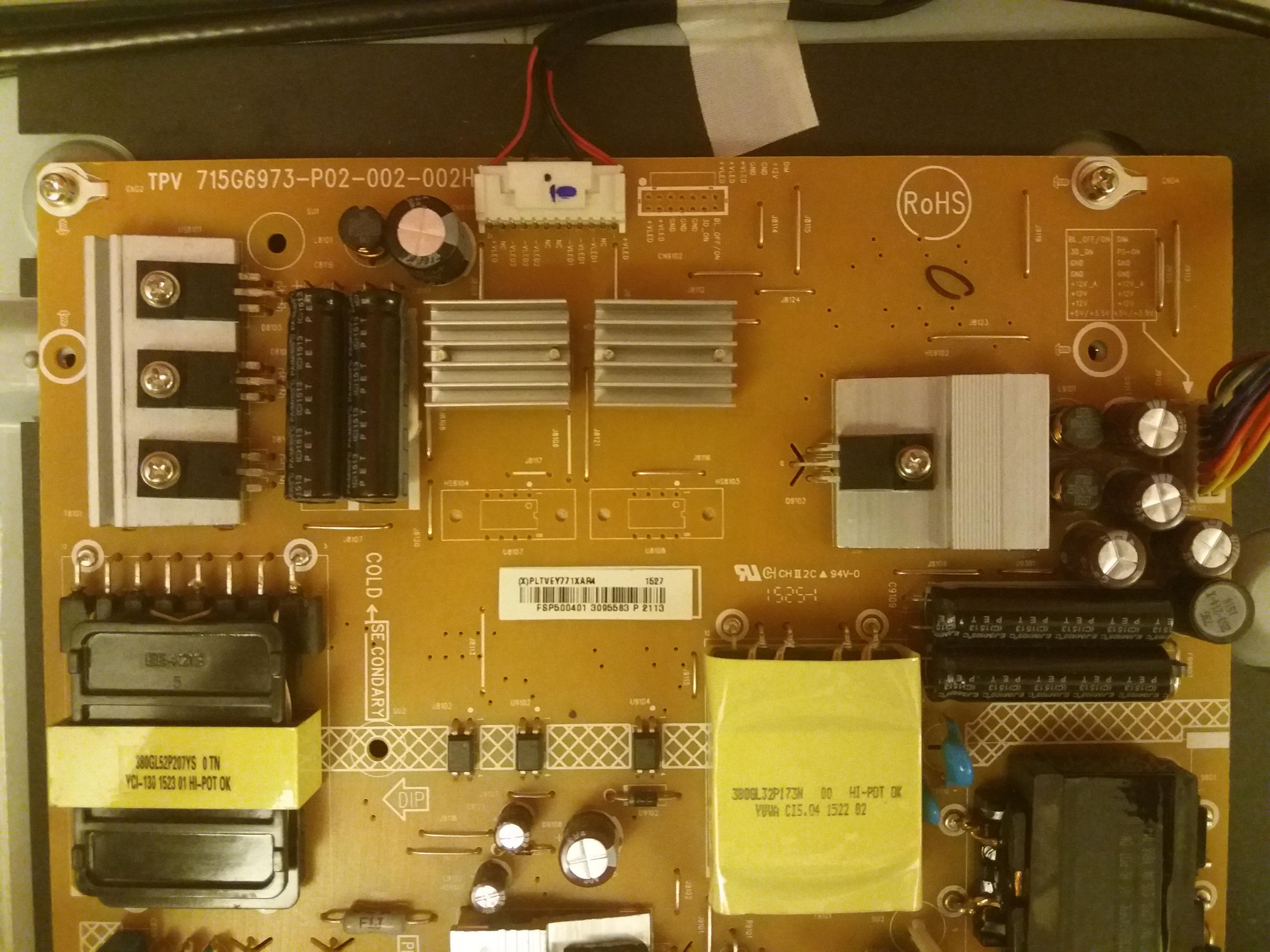

    Philips 50PUT6400/12 no backlight
    Mains power on the front panel red LED comes on solid then slowly 'flashes' about 80 times, (more like it slowly dims out and brightens back up), then goes back to solid red.
    Bring out of stby the red led flashes 3 times quickly then goes out, the 'Philips' front panel display sign lights up.
    Get sound and can change source etc... there is a picture visible with a flashlight.
    The backlight does NOT light up nor does it briefly light up before going out. This is when viewing from the front and from the rear with the back cover removed.

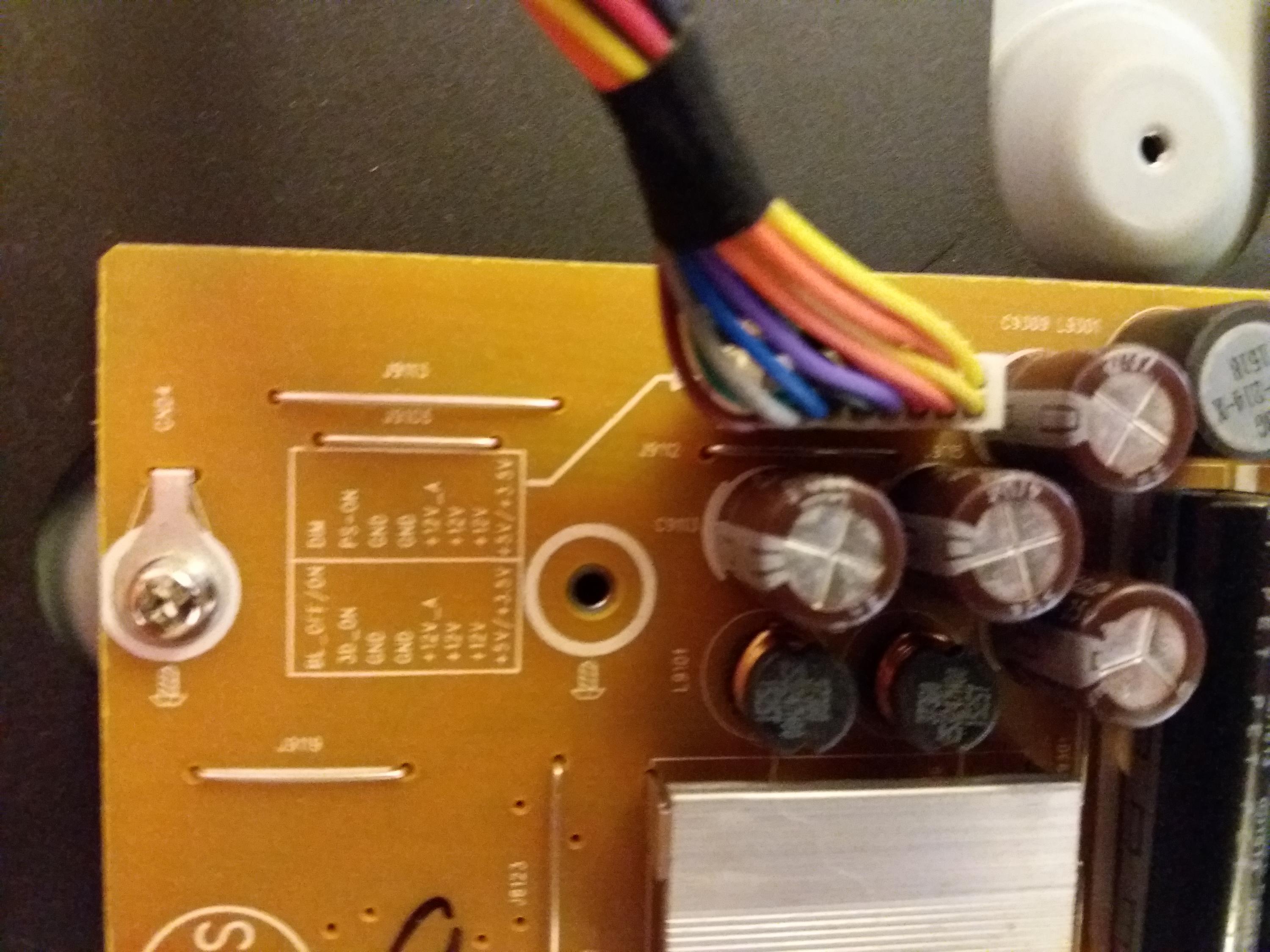

    Voltage readings as follows with reference to chassis gnd: (<<in stby>>, <<On>>)
    BL_Off/On (0v , 3.1v)
    3D_On (0v , 0v)
    gnd
    gnd
    +12_A (0v, 11.7v)
    +12 (0v , 11.7v)
    +12 (0v , 11.7v)
    +5/+3.5v (3.5v , 3.5v)
    DIM (0v , 1.4v)
    PS-ON (0v , 3.3v)
    gnd
    gnd
    +12v_A (0v , 11.7v)
    +12v (0v , 11.7v)
    +12v (0v, 11.7v)
    +5v/+3.5v (3.5v, 3.5v)

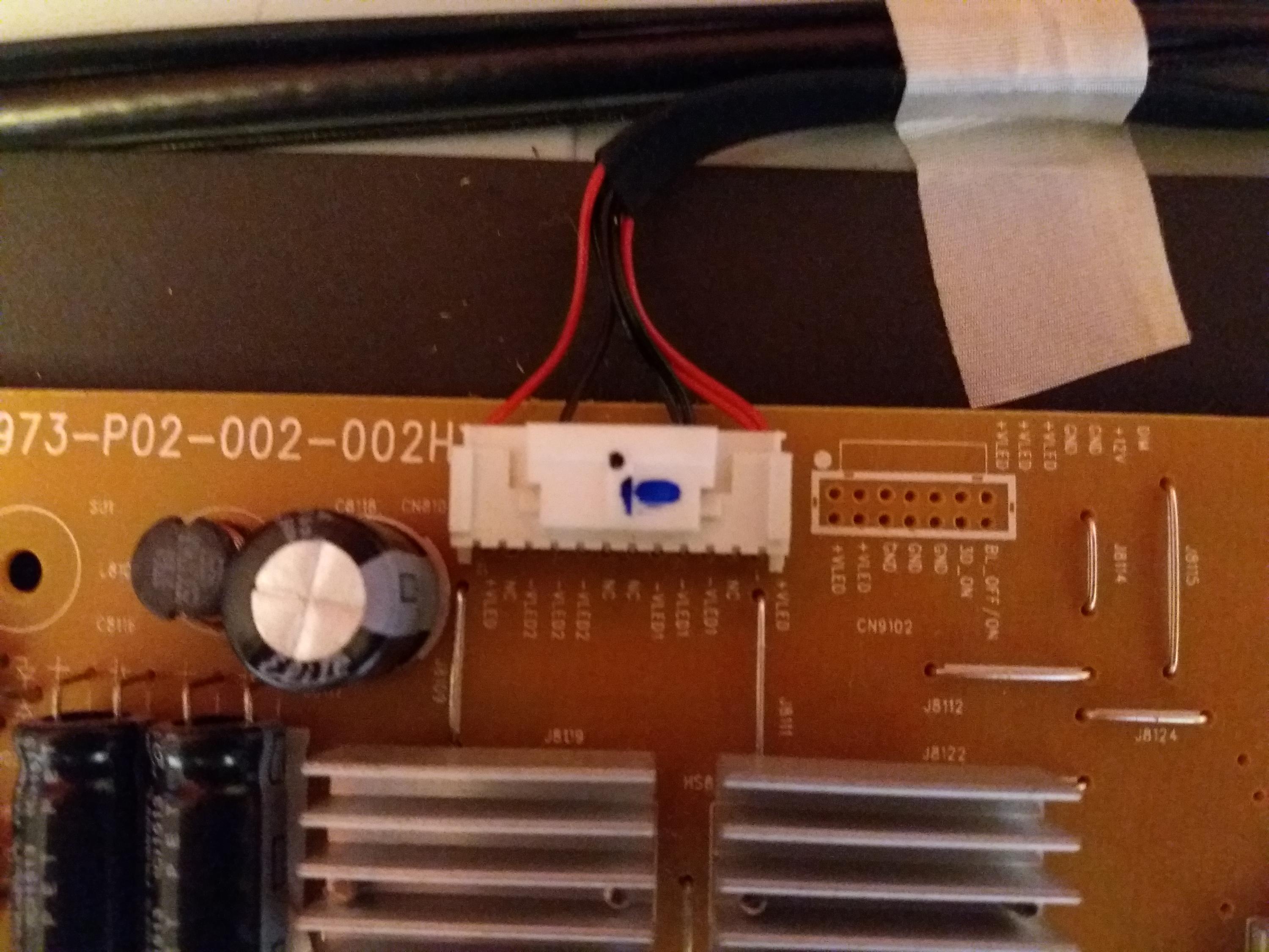

    With LED's connected or disconnected both +VLED pins rise to 75v, settle down to 72v, 5-10secs later ramps up to 102v then gradually drops out to zero.
    Both -VLED1 and -VLED2 read 0v when LED's connected or disconnected.
    I think its looking like open circuit LED's but just wanted to be sure I am not missing anything before proceeding with the onerous task of disassembling the display panel.

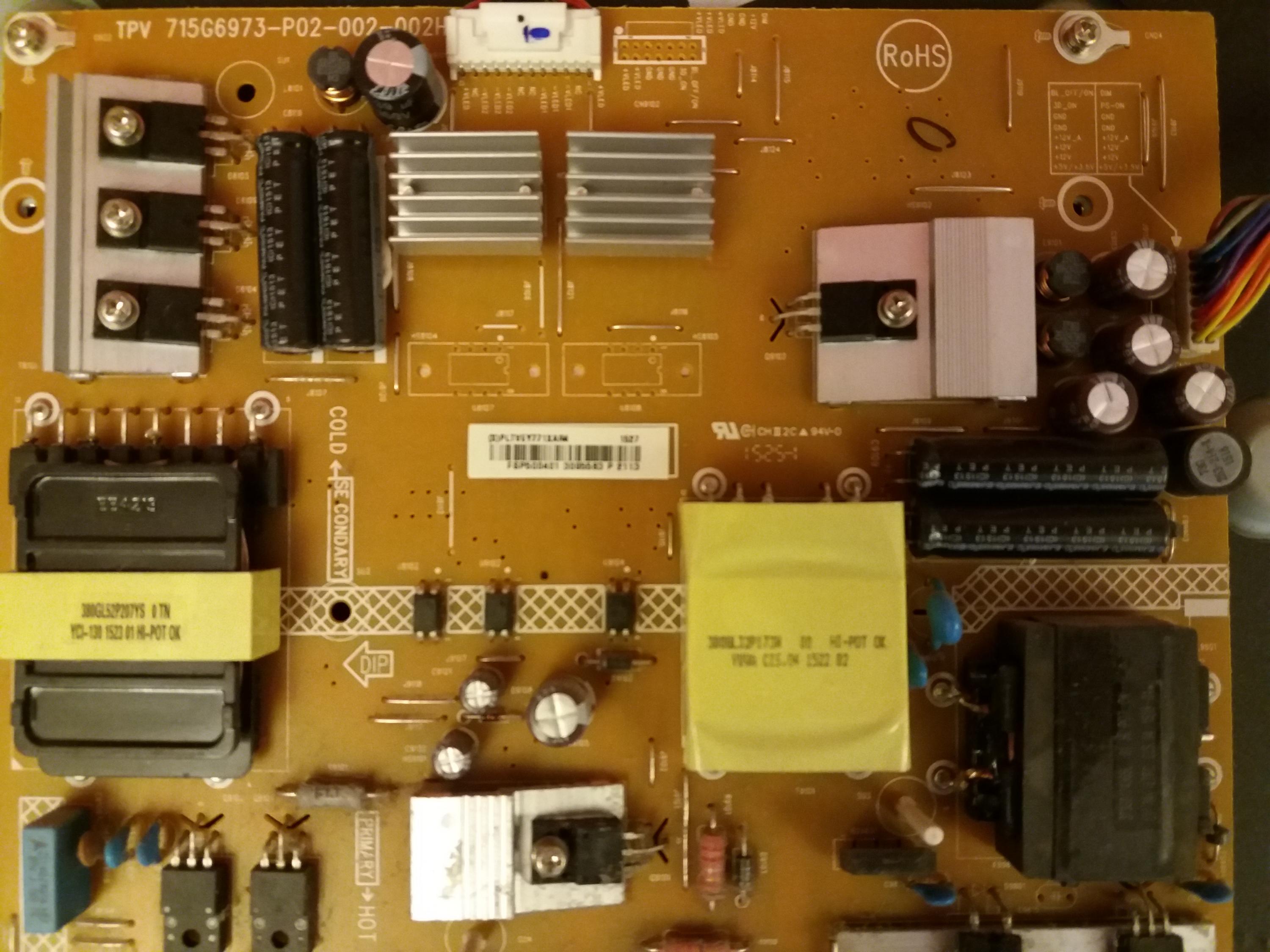

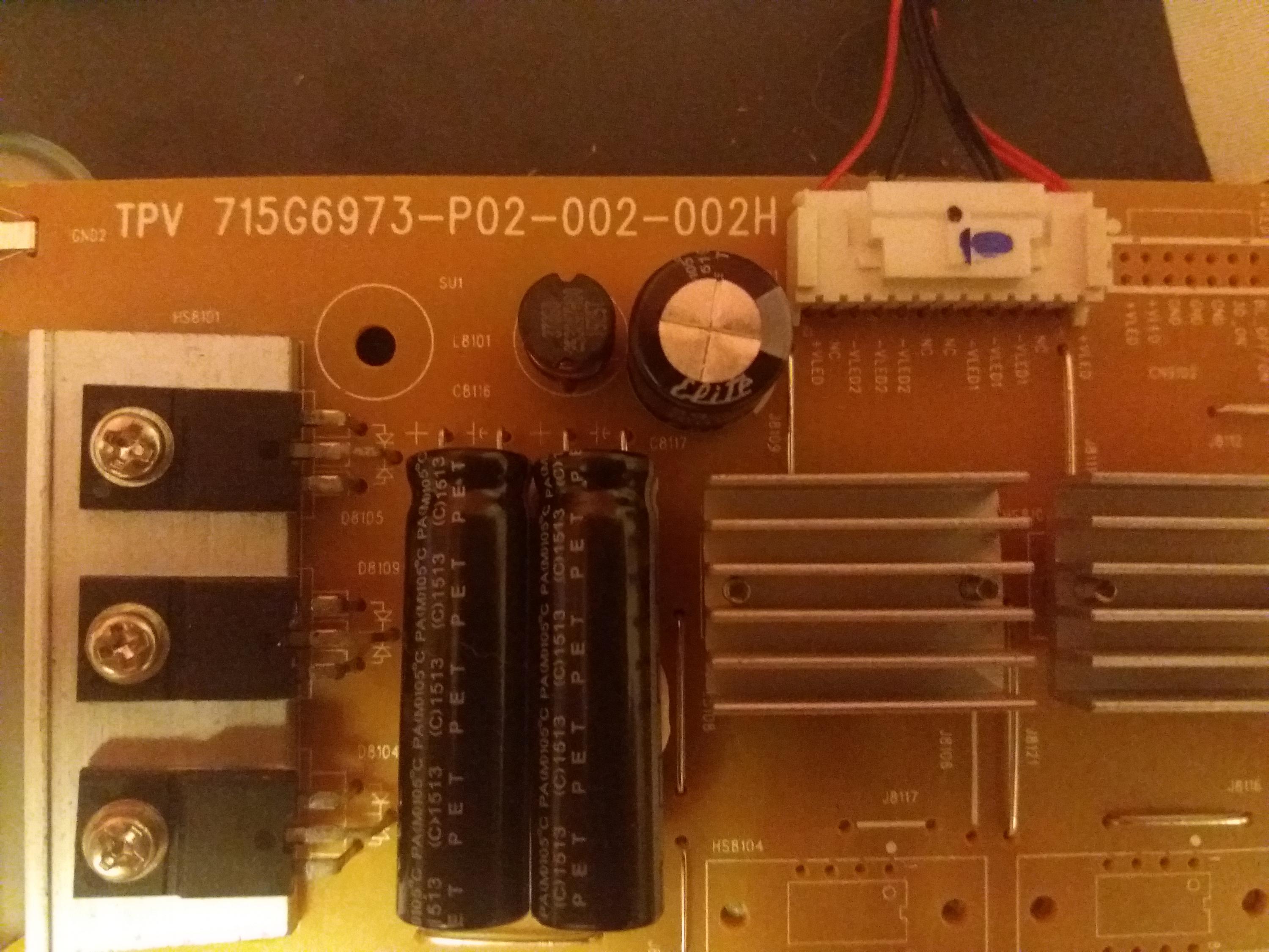

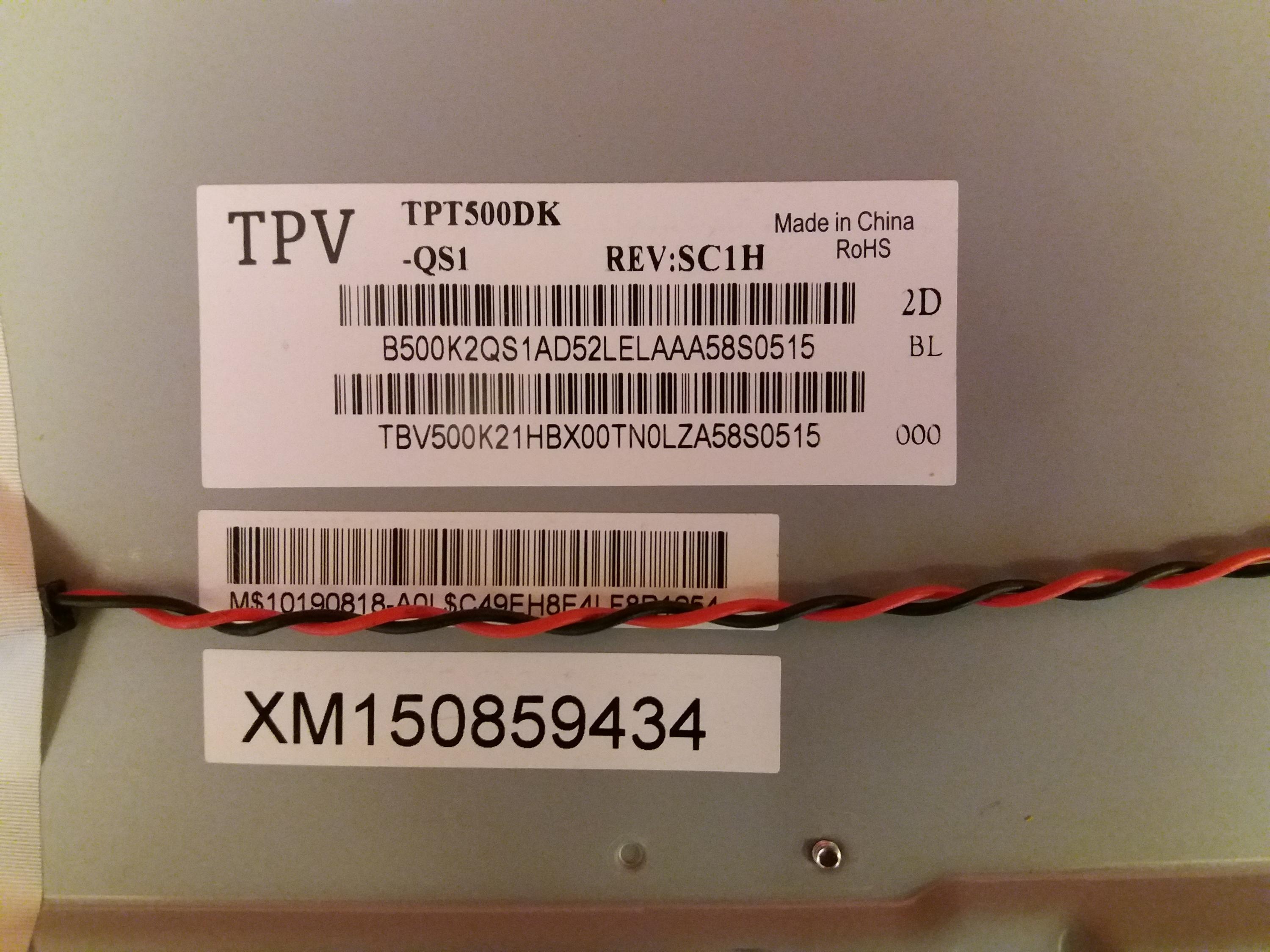

    Photos of Panel details and LED driver/PS board.

    PS Board connector close ups.
      Re: Philips 50PUT6400/12 no backlight
      The -VLED's are measured against circuit GND?
      What are the Voltage rating of those 3 lytics caps in that LED driver section?
      BTW, your pictures are way out of focus.

        The pair of caps are 120uF 160v and the single cap 39uF 160v.
        What point should I use for circuit gnd? On the COLD - Secondary side, of course.

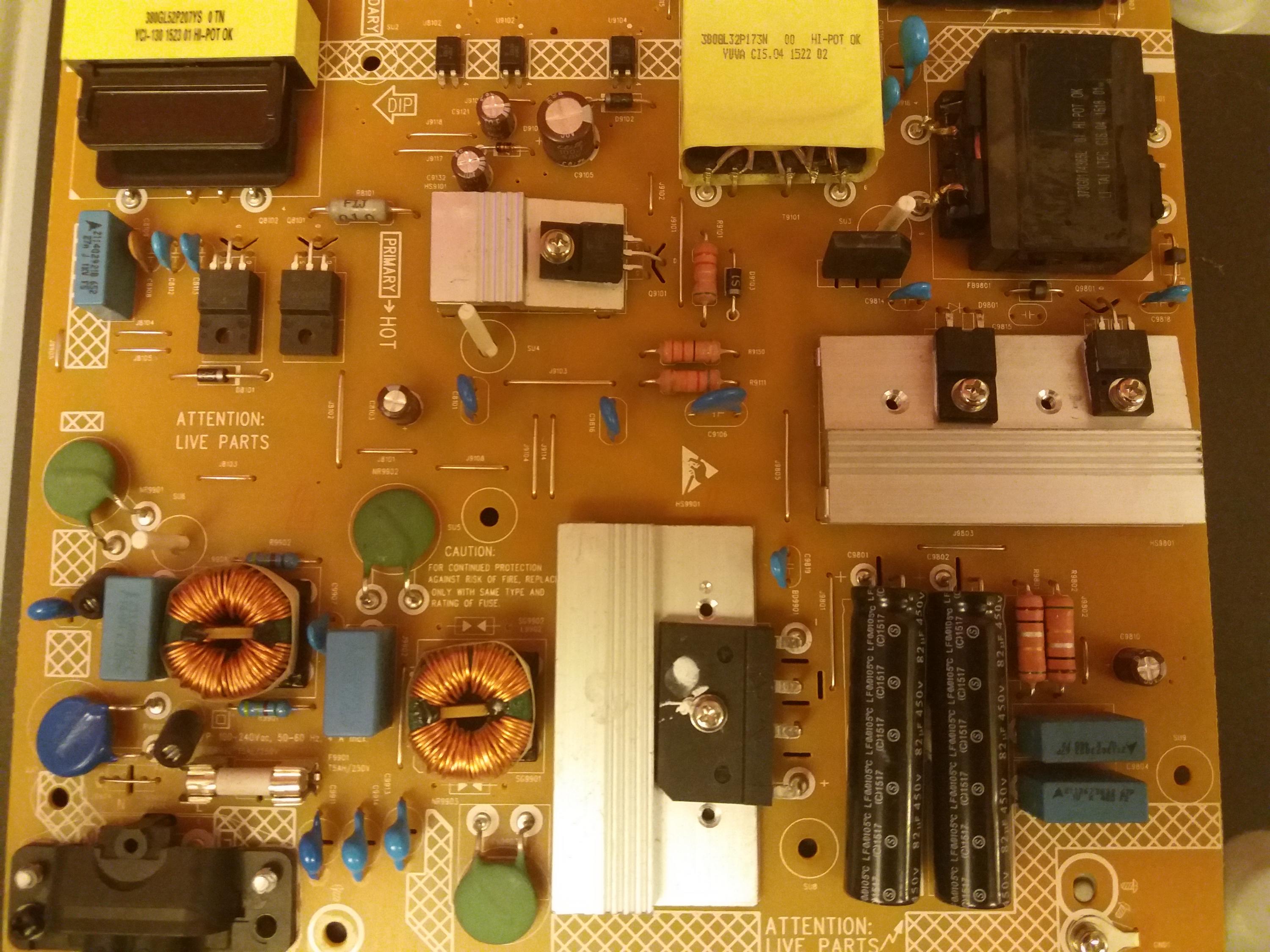

              Photos
                          OK, the LED power supply does not use Boost converter circuit, so 102V reading is about right with 160VDC rating caps.
                          The panel has 3 LED strings, two of them are connected in parallel as you can see that it has two read wires go to one terminal, and then two black wires go the another one terminal.
                          It is also more like likely to be 72 LED's, so 72 /3 strings = 24 LED per string, so the Vf at 3V for 24LED = 72V total Vf for the LED string + Vrops on that PWM control (you can see two small heatsinks).
                          So What you can do is to use 180 ~ 220 Ohms 5W resistor between V- and chassis GND one V- at at time to see if the Backlights will flash on for seconds or not. If you do not have resistor you can use 10W or 25W (not more) in place of the resistor to test.

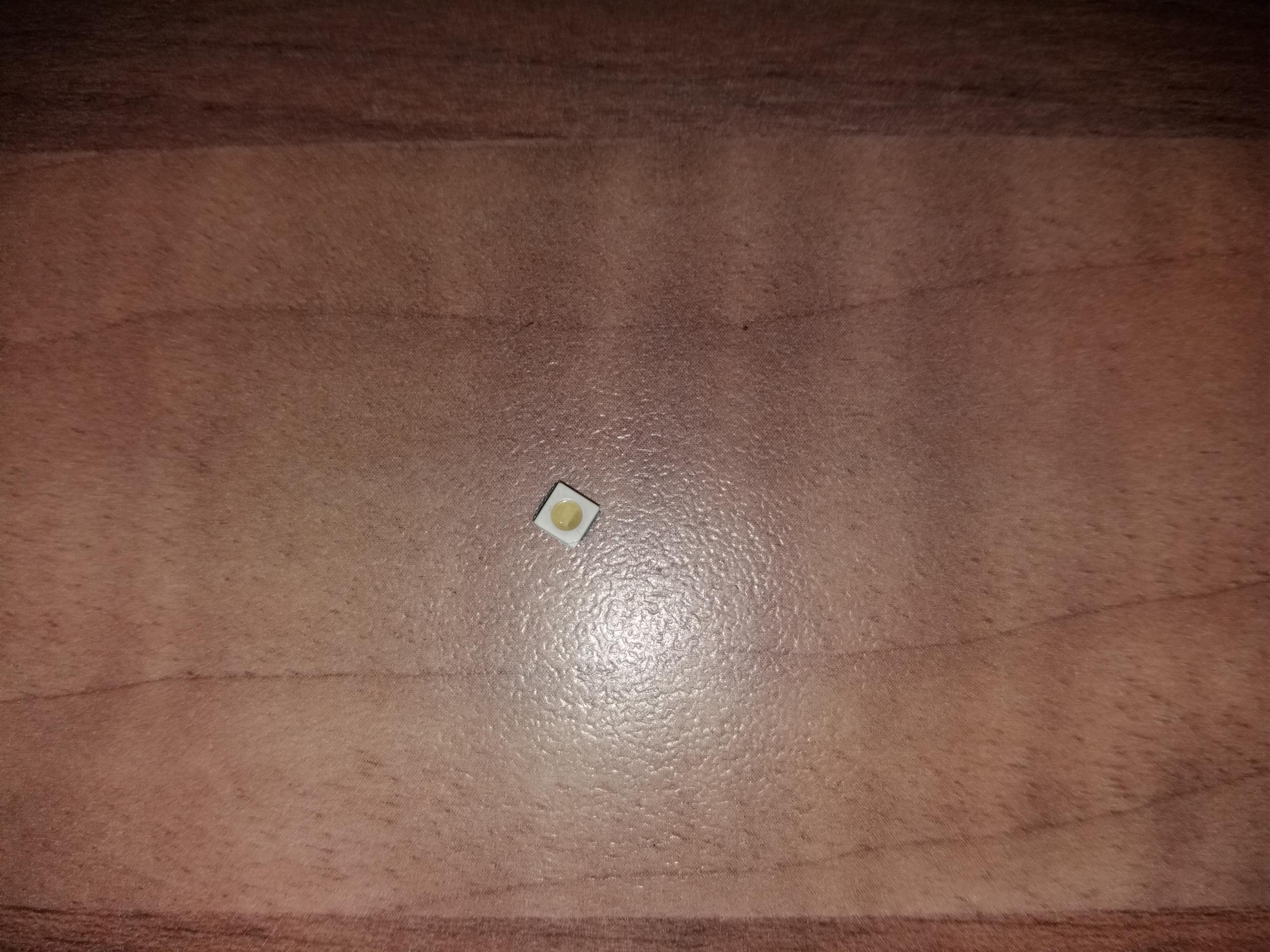

                                Decided to buy a GJ3C Led tester.
                                Found that led's were not lighting so stripped it down. Tested led's individually to find about 5 open circuit.
                                Now to find suitable replacements.
                                The meter reads 2.4/2.5v so clearly need 3v leds.
                                Dimensions are approx. 3mm x 3mm x 0.5mm (l, w, h). With a 2mm diameter lens.
                                Where I do have difficulty is knowing the lux range, do they need to be in the 5000 range soft white/neutral, presumably warm or cool white will give a spot effect on the screen.

                                  Removed led from panel.
                                      Do you have picture of the bacside of the LED showing the solder pad pattern? You also need to find out if the big pad is Anode or Cathode.
