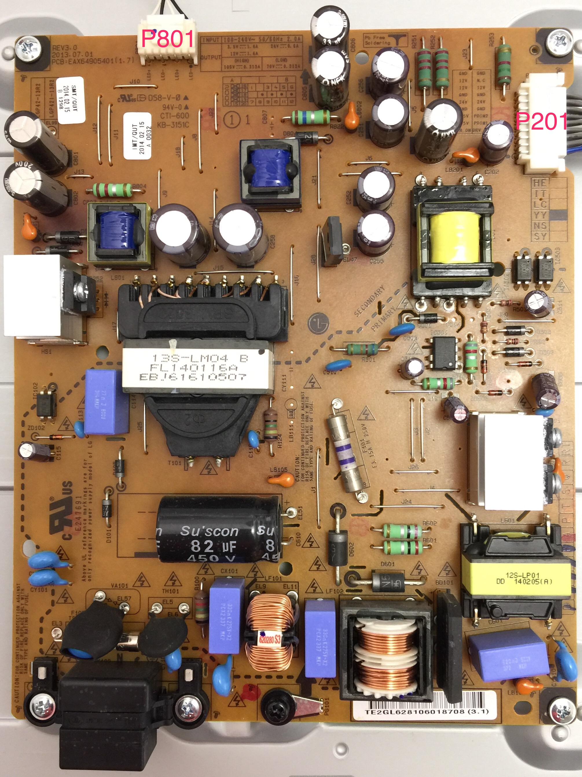

    Attached are photos of the power supply PCB and the chassis label.
    Do my measurements indicate a working power supply and faulty LEDs?

    It indicate you have open circuit in one of the two LED strings. That is why the Voltage went up to 172V.
    Pin 5 - 0.5, 0.6
    Pin 7 - 172, 90

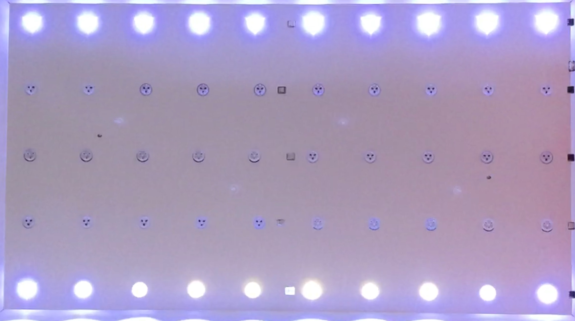

        I successfully removed the panel and was able to use my phone to make a video of the emitters flashing during power up. I've attached a screenshot.
        Only the top and bottom LED strips are flashing during power up. The middle three rows remain off.
        I connected three 9-volt batteries in series and tested each row individually at the contacts nearest the PCB.
        Rows 1, 3, and 5 lit up fully with my test rig.
        Row 2 partially lit up, but its 4th emitter did not. I removed the optic and found it was shorted.
        Row 4 did not light at all. I applied power to just the left half of the row, and those five emitters did light.
        I tested row 4's five right-side emitters with my DMM in continuity mode and found one that was faulty.
        I swapped the left sides of rows 2 and 4, which are both labeled L2. Now I have four fully working strips, with row 4 needing just two emitters.
        Is it worth the effort to simply reflow two new emitters, or is it inevitable that more LEDs on these strips will fail?

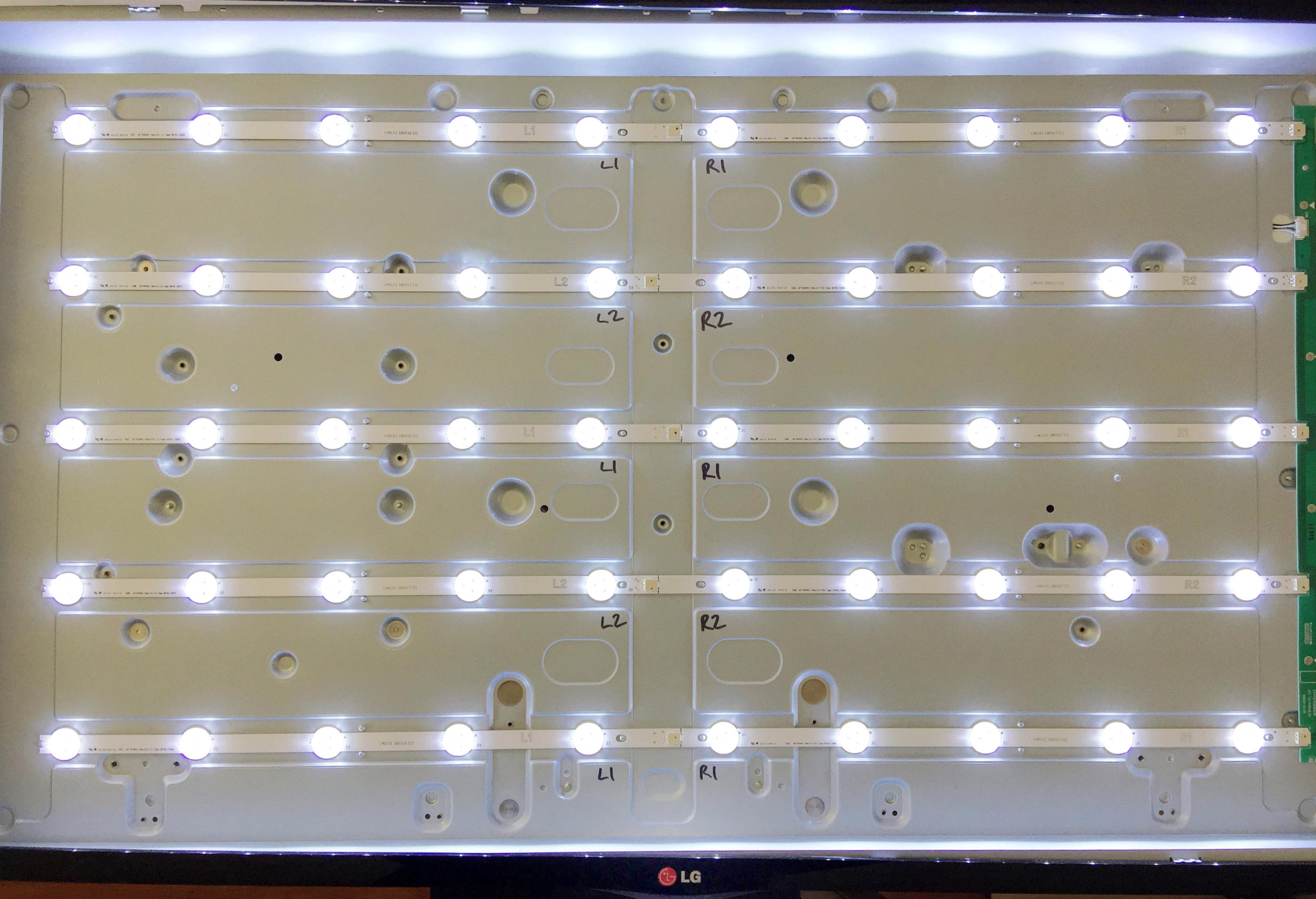

                  Success!
                  The replacement LED strips arrived and the TV is working great.
                  I turned the backlight level down to 60% to help these emitters last a bit longer. I'll do the firmware update, too.
                  Thanks, everyone!

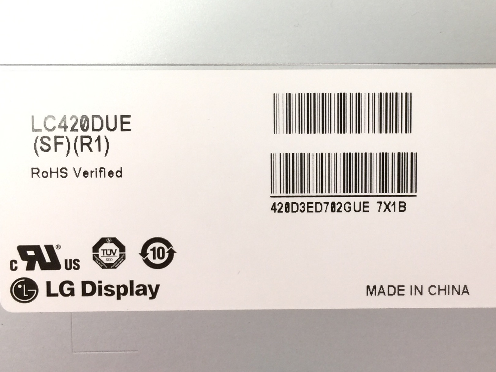

                      I found the lowest price for replacement LED strips on eBay by searching for "LC420DUE" which was on the chassis label indicating the panel model.
                      I was sure to order NEW strips, not used. My set was about $33, including shipping from/to the USA.
