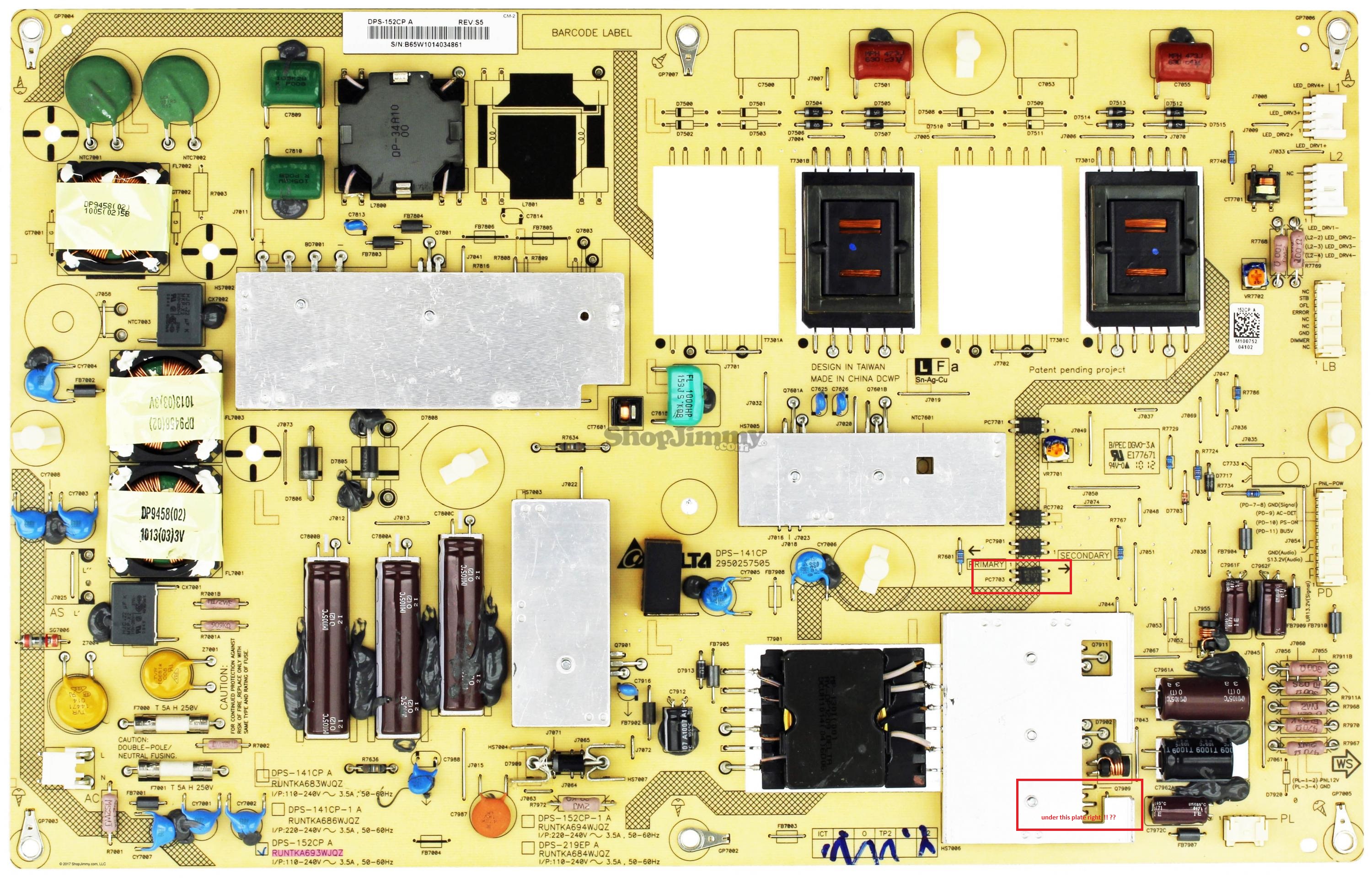

                    btw my tv has power supply RUNTKA693WJQZ,
                    DPS-152CP-A

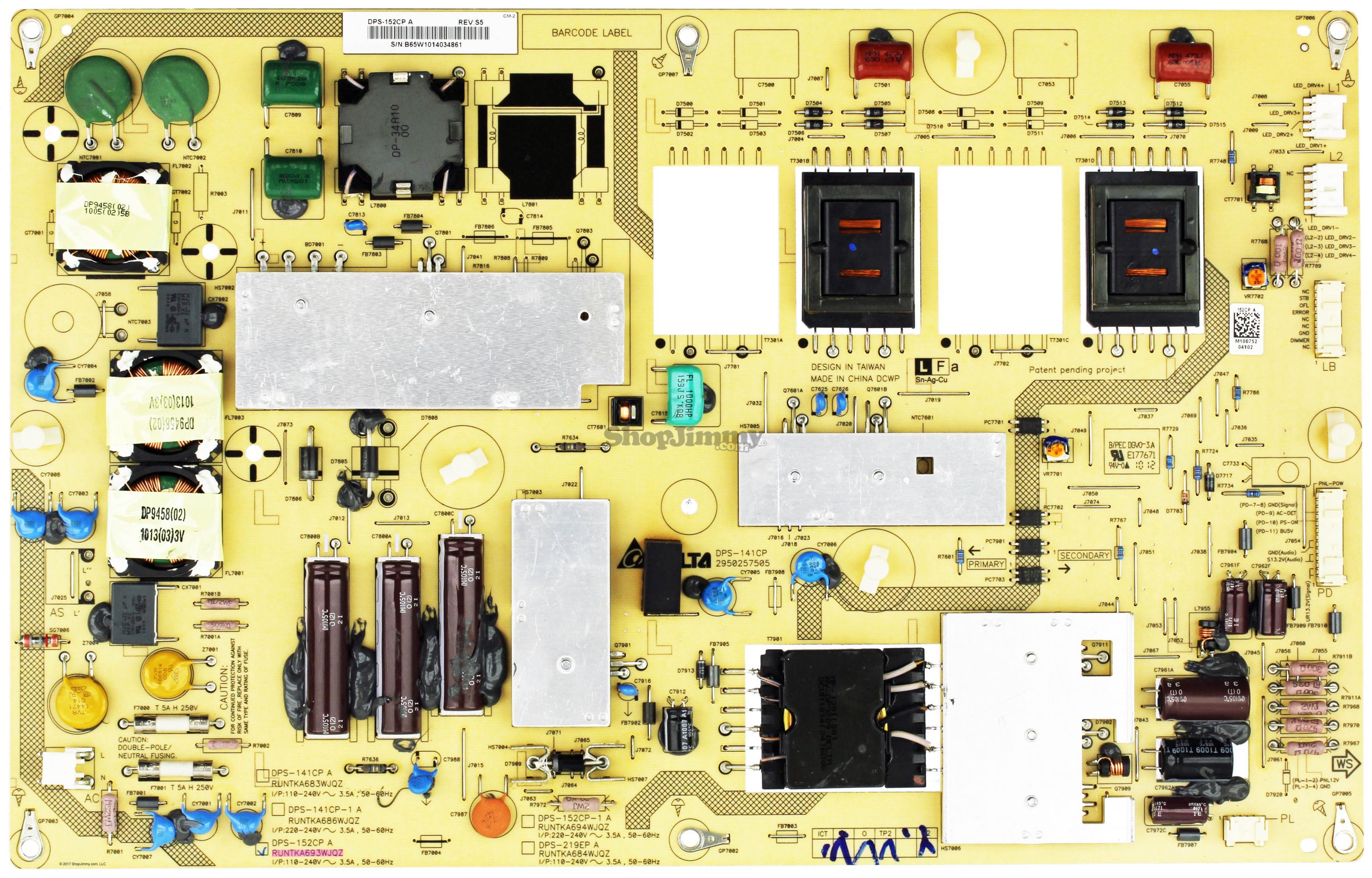

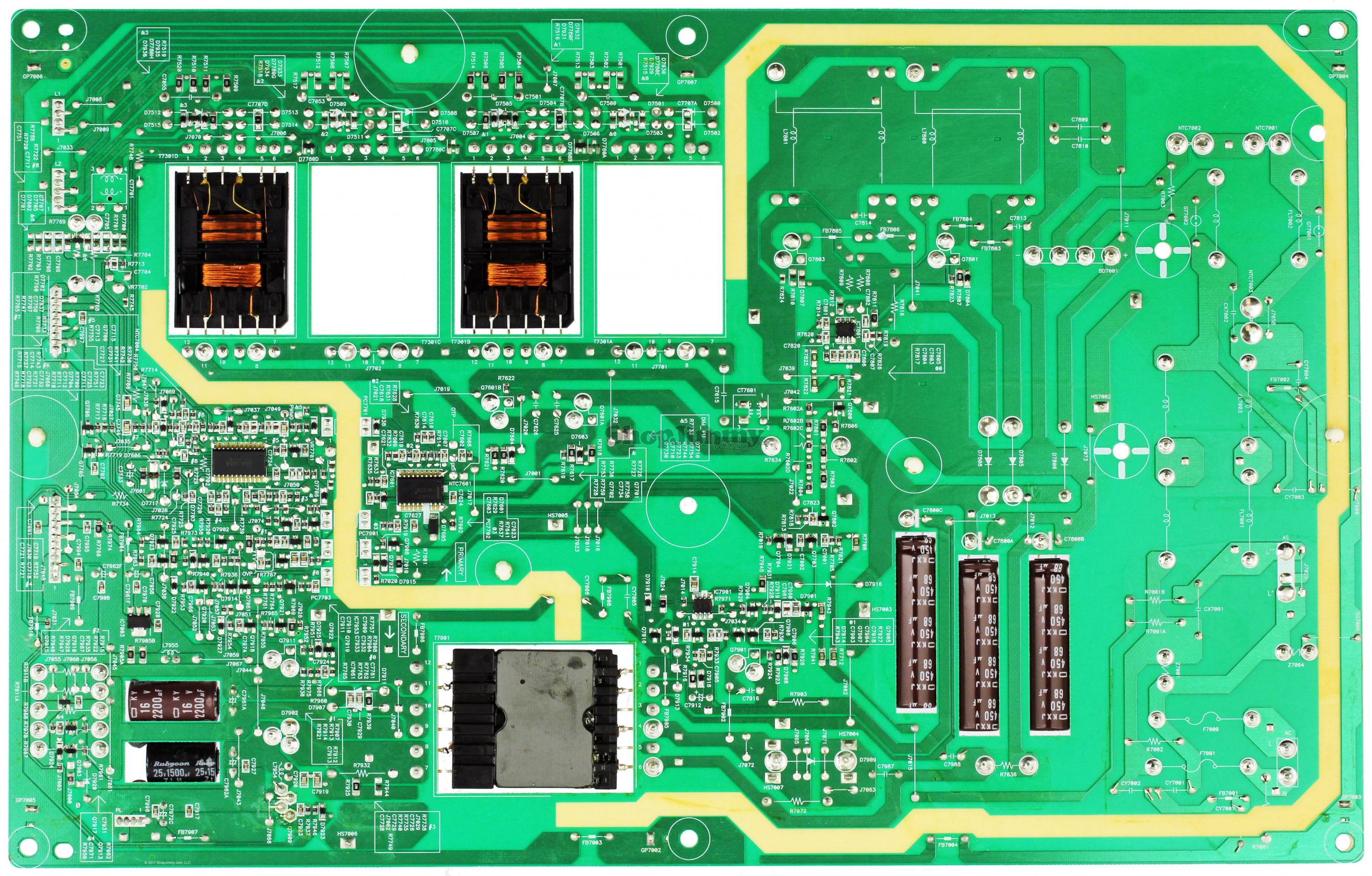

                      Re: my SHARP LC-40LE810UN has issue help needed to find and fix.
                      ?? Photo of the p.supply?
                        You need to report the Voltage readings of the connectors PD, PL, and LB.
                        You MUST report the reading in this format:
                        Connector: ??
                        Pin Name: XXX, Voltage reading: ??? V
                        Pin Name: YYY, Voltage reading: ??? V
                        Pin Name: ZZZ, Voltage reading: ??? V
                        Pictures provided by shopjimmy: Sharp RUNTKA693WJQZ (DPS-152CP-A) Power Supply Unit
                          Hi, I'm wondering why the tv model is the same as mine but the psu is different and also 90 degrees rotated! Anyway it seems the components are the same and also almost the same markings, sorry the optocoupler is PC7703 not 7730 and the KIA chip is the one in TO220 with 4 legs Q7909 at bottom right..

                                • nilesh
                                  • Jul 2016
                                  • 34
                                  • 86994392471
                                  Hi Davi ,
                                  here i have attached pic. with red squre marked on both compotant
                                  to confirm this two right ??
                                  thanks again
                                  this
                                  • Davi.p
                                    Hobbist Tech
                                    • Sep 2009
                                    • 4536
                                    • Italy - Milan
                                    the main issue for me is TV is not completely down it does rebooting randomly...
                                    Sorry, forgot this, so maybe it's better , you can only have the optocoupler bad.
                                    Yes the parts marked are right.

                                      Thank you sir, i will start to replacing with optocoupler first , and test for few hours what it does, thanks
