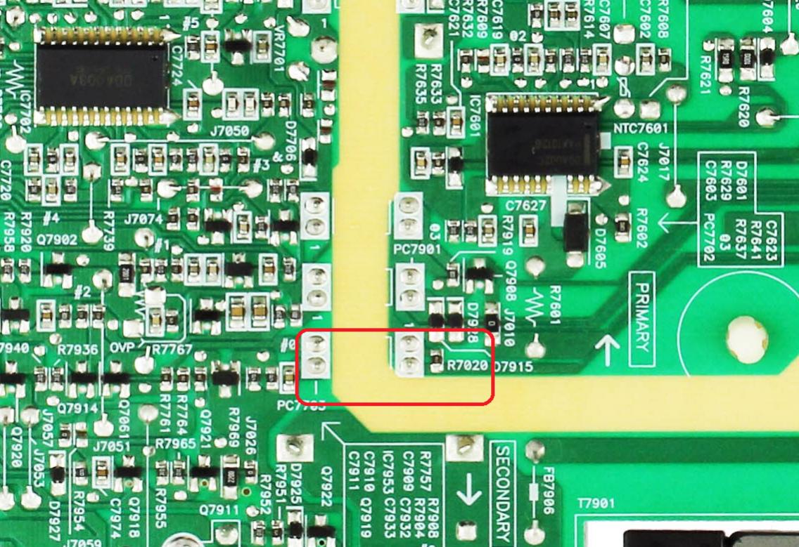

my SHARP LC-40LE810UN has issue help needed to find and fix.

    If you're happy to experiment then you can simply shortcircuit the secondary side of the optocoupler and keep the tv in test, if it works flawlessly then you found the bad component.

      Re: my SHARP LC-40LE810UN has issue help needed to find and fix.
      thanks for suggestion, i thought earlier for that but wasn't sure about ,
      tomorrow i will get parts and will check. thanks again

            • johannesstroh
              • Sep 2018
              • Österreich
              As mentioned here instead of replacing the opto u can simply solder a 47k resistor in parallel to R7019, which is in series to the opto on the primary side and get the opto working again

                        • 86994392471
                        #31
                        stuck with unfortunate issue,
                        the New part i got seems to be bad,
                        i chage optocouplar , and tv doesen't start at all
                        than i put back older one and tv start right away, it tend to believe me that that new part may bad, now quick option is only left to use 47K resister
                        will be update soon .
                        BTW my PSU board i can locate R7020 not R7019 ...so need to confirm before i solder resistor !! pic attached !!
                        thanks in advance. help apriciated

                        • Davi.p
                          Hobbist Tech
                          • Sep 2009
                          • 4536
                          • Italy - Milan
                          #32
                          how do you have mounted the optocoupler?? it has a mark point that identifies pin 1,
                          this must be connected to the HOT (primary) side!

                            • Davi.p
                              Hobbist Tech
                              • Sep 2009
                              • 4536
                              • Italy - Milan
                              #34
                              I say this for you, read again my post #21.... (!)

                                  • Davi.p
                                    Hobbist Tech
                                    • Sep 2009
                                    • 4536
                                    • Italy - Milan
                                    #37
                                    Of course.

                                      • Davi.p
                                        Hobbist Tech
                                        • Sep 2009
                                        • 4536
                                        • Italy - Milan
                                        #39
                                        You don't have to worry about because the function it's used only when mains disappear, but even if it will do, no serious damage will happen.
