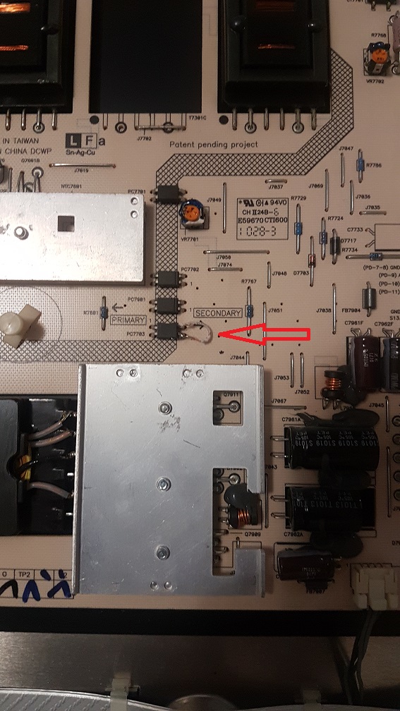

    just finished jumper (pic. attached )
    and TV is under testing !
    one things i notice after i short jumper things notice.
    booting is very fast pretty much tv start almost instant before it take almost
    45 sec to 1 minute.
    it tend to believe me this part was weak or almost on fail status,
    TV is under testing .....i will update here after 6-8 hours final concusion
    thanks for help !! apriciated

          unfortunately TV probelm is still there , jumper improved tv startup time ,
          in 5 hours of continueous watching it random reboot it self 5 times,
          out of 5 times , 4 time it rebooted it self but 1 time it couldn't reboot and stuck with
          (1fast-1slow blink) and stayed like that ,
          than i press hold power button on remote control for 15 second to start tv again ,
          so i guess ** @$%&**!!* it seems not this optocouplour but not sure ...( i will keep the jumper on it )
          also my tv backlight setting is lower to lowest to (-16) as precaution,
          unfortunately i can't measure voltege on all output of psu because tv is not completely down.
          should i think on to replace all (4) optocouplar OR before that think on KIA chip ?
          help apriciated , thanks in advance

            No don't waste time to replace other opto, i don't trust much the problem is there, i suspect the KIA but even it is doubtful it fails random, usually them fails completely, the first step is to read back the lamp error codes happened and download service manual to get info on those codes. start from there, if i can i will check. If you want "rapidly" check KIA operativity, supply an external 12v on the PD connector (i remember it is the one with 4 pins 12v output) disconnecting it from the PSU, then leave it to work for almost 5 hours or until a self restart. NOTE: First switch on the tv, then after 2 sec switch on the external supply.
