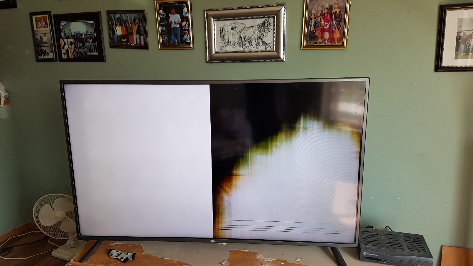

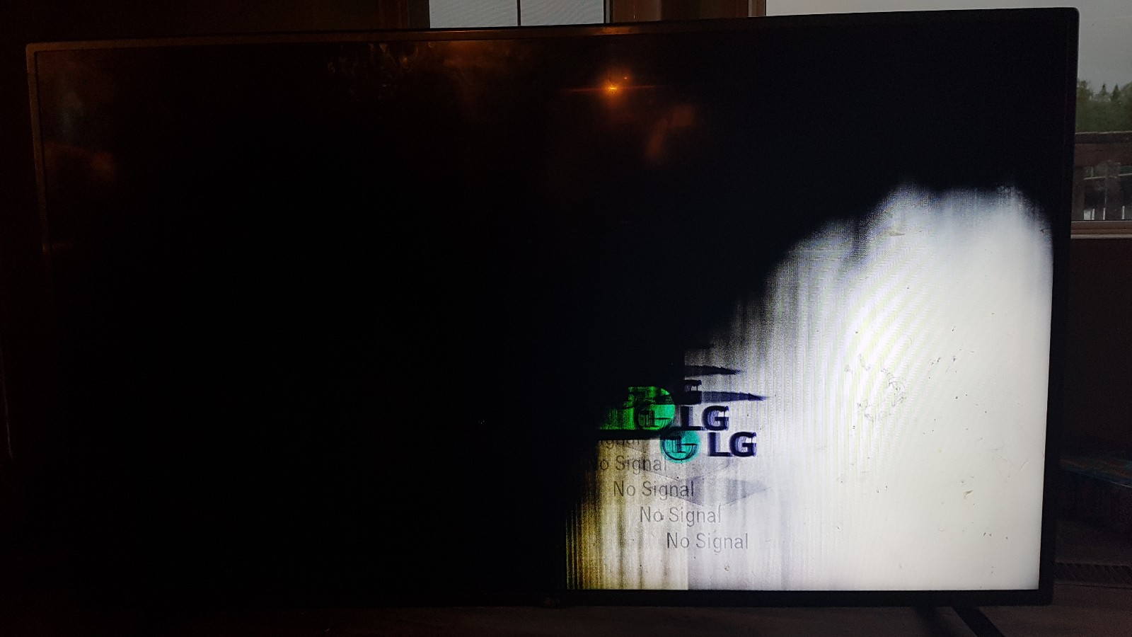

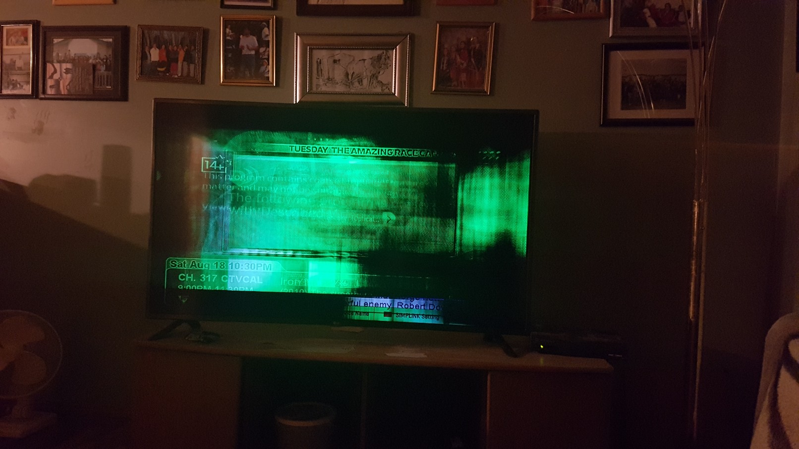

    Someone gave me this ..said there kid tossed something at it..no cracks on the screen that I can notice..does the screen look like its finished..ghosting in the corner where there is light .

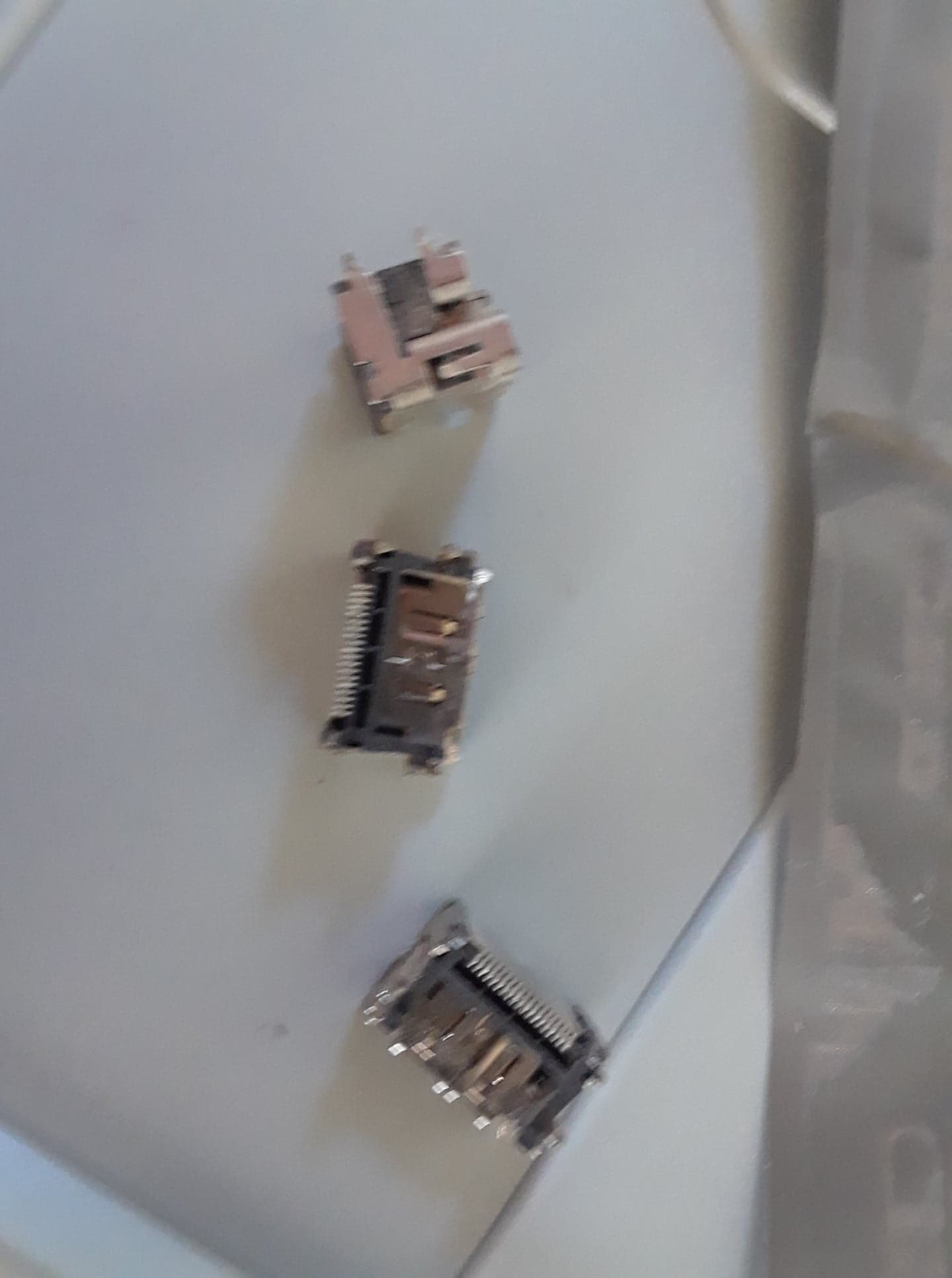

    Managed to crack it open..found all three of the hdmi plugs fell off...I get no sound..the screen is unresponsive when hooked up to satellite..

          Bad panel.
          Try having ribbon cable between panel and the T-CON board connected one at a time to see if you can even get half of the screen to work.

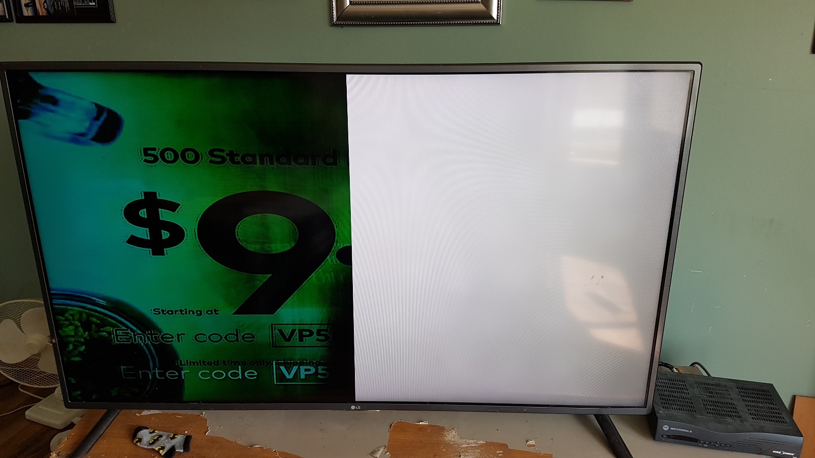

            Tried one side.. still messed up..tried the other.
            No pic..can only use red yellow white av cables as the hdmi plugs popped off..

                :-( you are likely not going to be successful.
                one side works but the other side gets nothing, usually indicates a bad side / panel. My guess, the side that doesn't cause a picture is the right side (looking from the front).... meaning disconnecting the left side leaves you with no picture...based on the posted picture which appears to show issues with the bottom right.

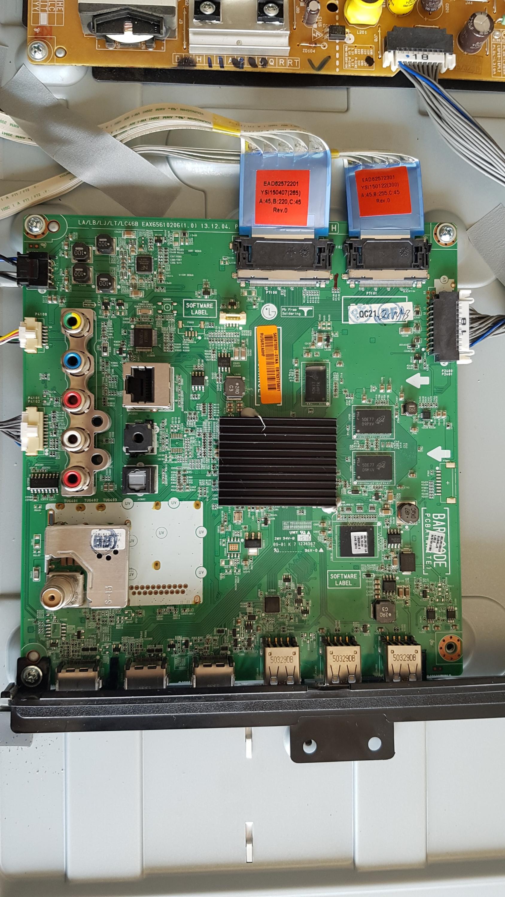

                It is rather strange that all the hdmi sockets fell off... you might want to take a close look at the main board (which I assume is where they came from) and check to make sure that whatever traces / tracks are there, are not shorted in some fashion. IF you post a clearer picture of the main board only some one may see something obvious.

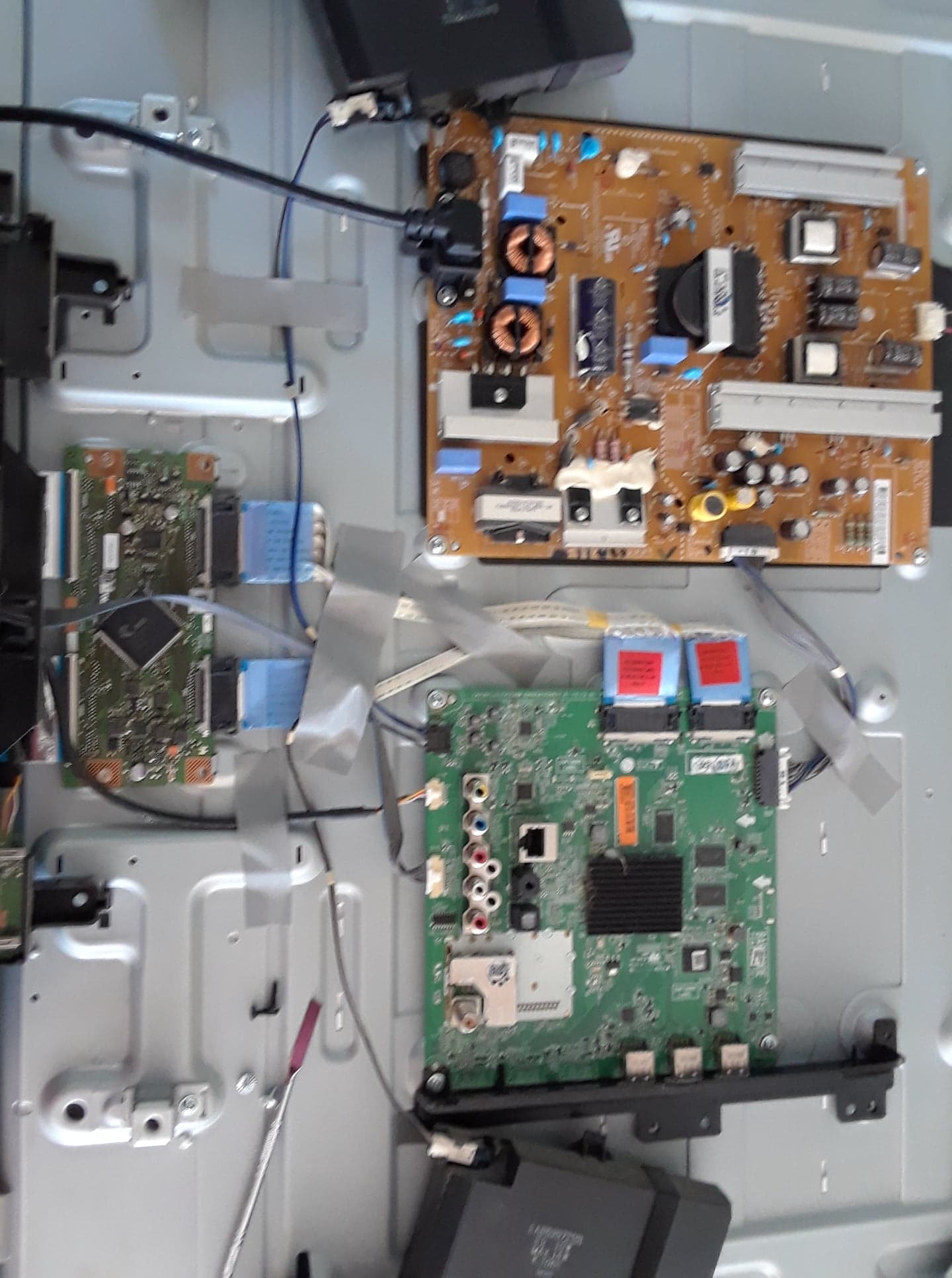

                  Being a newbie I unplugged the top of the tcon and not the bottom..here are some more pics..
                    Re: Lg 60lf6100 is the screen gone?
                    The main boRd looks kinda messed up..the hdmi plugs dont even look like they were soldered correctly..the are four places where they are soldered to the board..the front to holes dont even look filled

                      what is that stray component hanging off the large heat sink ?
                        That's glue..must have been installed that way...I resoldered the hdmi plugs..but since the screen is messed up..cant see which if any work..

                          the first picture of the two screen shots....tells the story. As suggested, the bottom right corner of the panel "took a shot" which didn't crack the screen but caused a "connection issue" on the tabs on the bottom / side of the set. It is unlikely that you can save the panel... but you can try. Are there side edge boards connected to the panel along each side... much like the bottom edge boards? IF so, you might try disconnecting the cabling that runs between the bottom edge board and the side edge board... look in the corner on that side.

                                The glass maybe broken on the right bottom border, if there are tabs, rip off the bottom right, if there are no tabs you can try to cut the glass gently along only the border outside the pixels area.

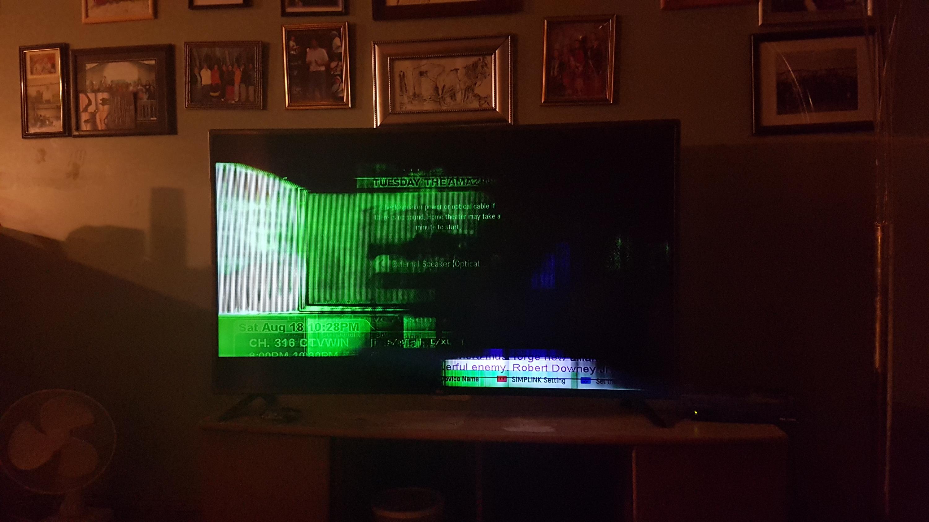

                                  Think it's dead...the are 4 tabs on the side..each with an ic chip..there are vertical lines in that area..pulled the tab off there...it is still doing the Same thing..but looks a little better on the left side..still freezing and weird colors..the white area went away slightly..its darker but white around the boarder in that area..

                                    There's a last try, locate the panel vcc on the tcon, it is usually 3,3v and goes to the panel's boards, follow it on both boards, then try to cut the lines just before them goes to the outer flat on the tracks that doesn't enter the cof chip but passes through and goes to the glass to the side tabs, try to switch tv on and off thenre join the cutted traces and switch tv on.
                                      If the panel only has tabs on one side, you can't pull tabs to make it work - that will just kill it for good.
