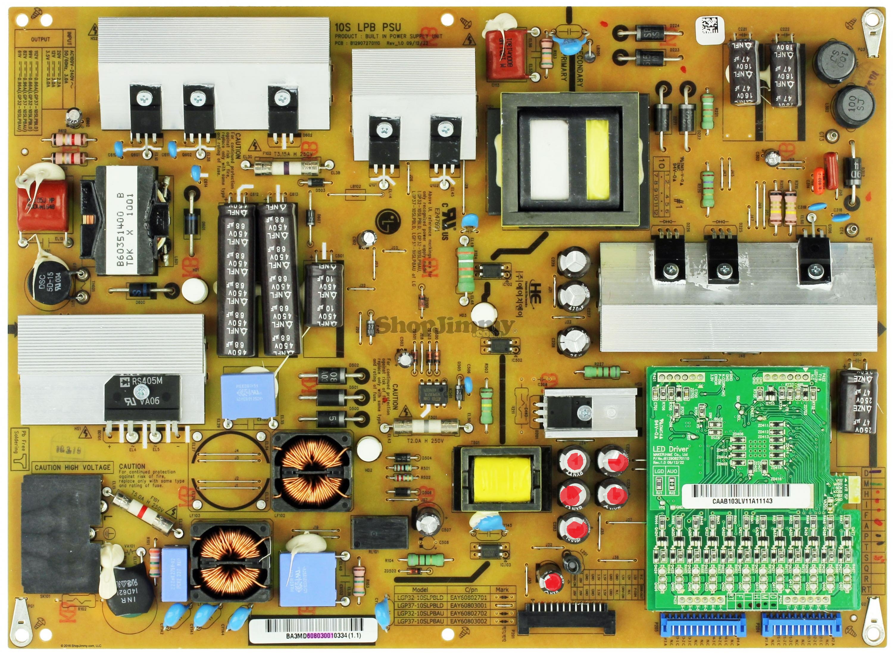

    Hi everyone

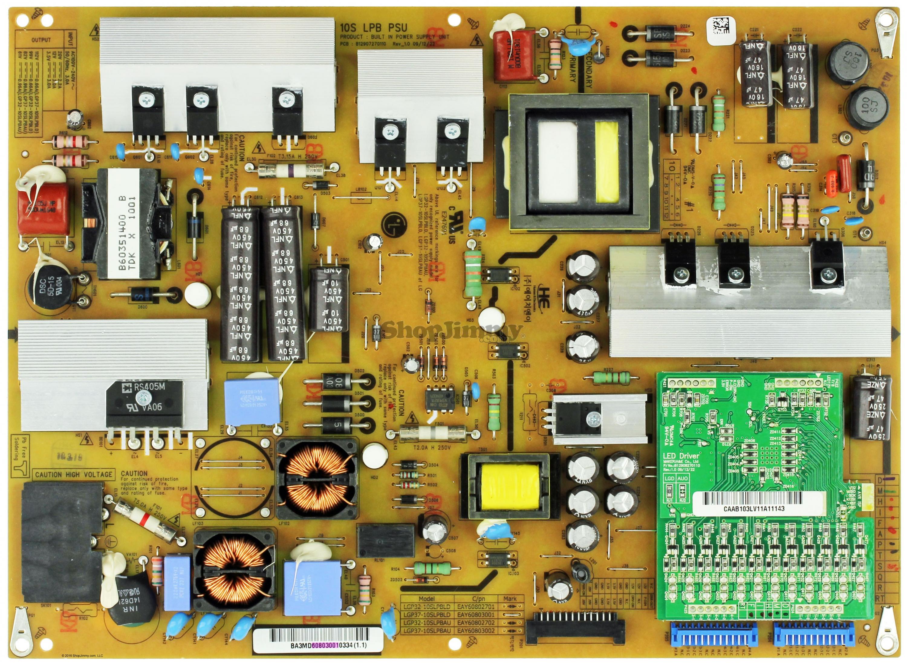

    I am trying to repair my former TV, an LG 37LE5500, mainly for learning purposes.
    The issue is: when I turn the TV on it starts blinking and rebooting, repeating this cycle for about 10-30secs. After that, it works correctly with no issues.

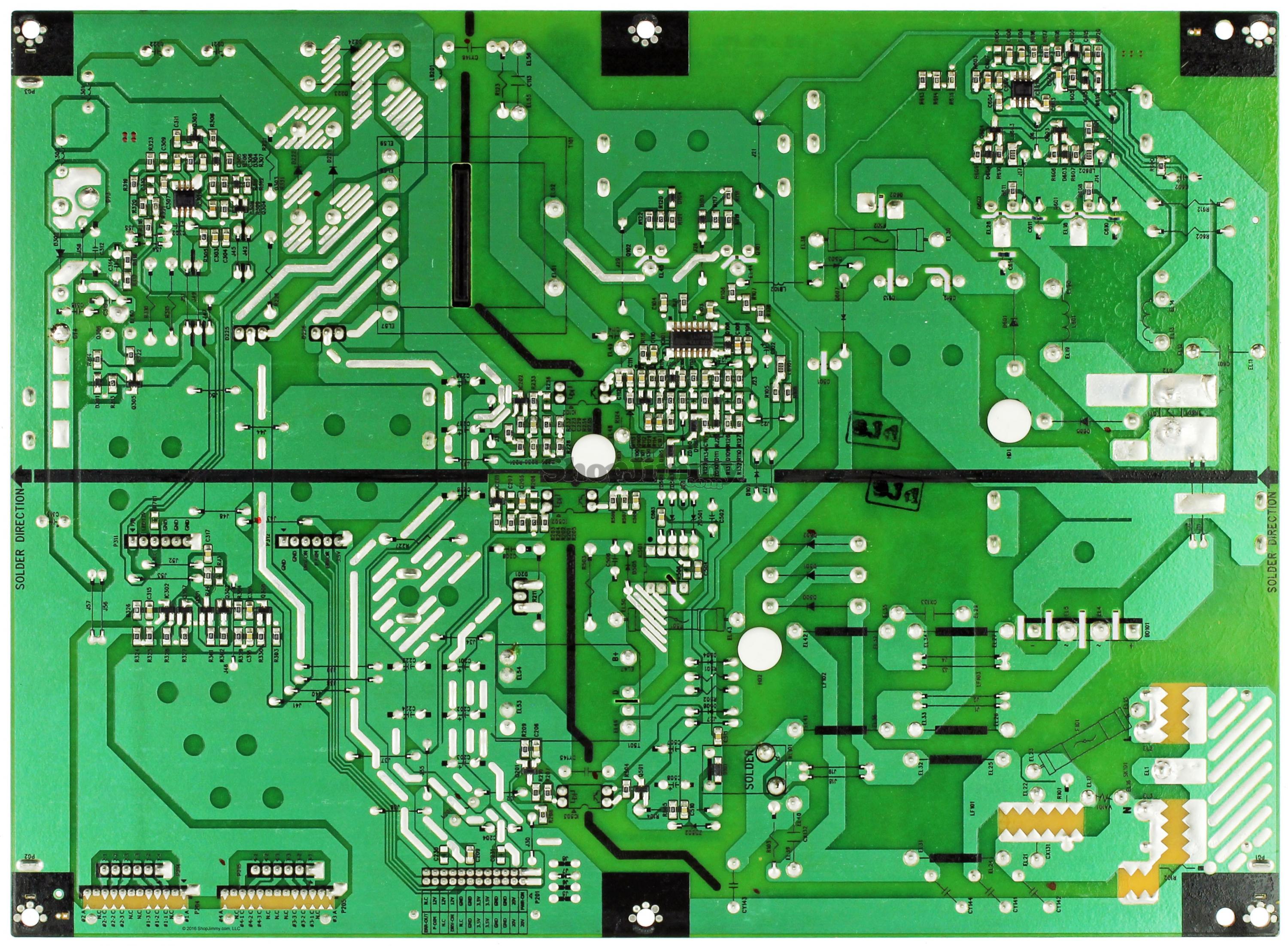

    I started by looking at the power supply (EAY60803001; attached front and back pictures provided by shopjimmy) measuring the following lines (bunch of cables going to main board):
    PIN *******StandBy PWR ON
    ERR-OUT 2.864 2.838
    P-DIM 0.252 1.202
    N.C. *******- -
    DRV-ON 0.061 1.932
    N.C. *******- -
    GND ***** - -
    3.5V *******3.49 3.455
    GND *******- -
    GND *** - -
    20V *******0 18.43
    20V *******0 18.43
    N.C. * -
    12V ******0 12.07
    12V ******0 12.07
    12V ******0 12.07
    GND ***** - -
    GND ***** - -
    GND ***** - -
    GND ***** - -
    20V *******0 18.43
    PWR-ON 0 3.323

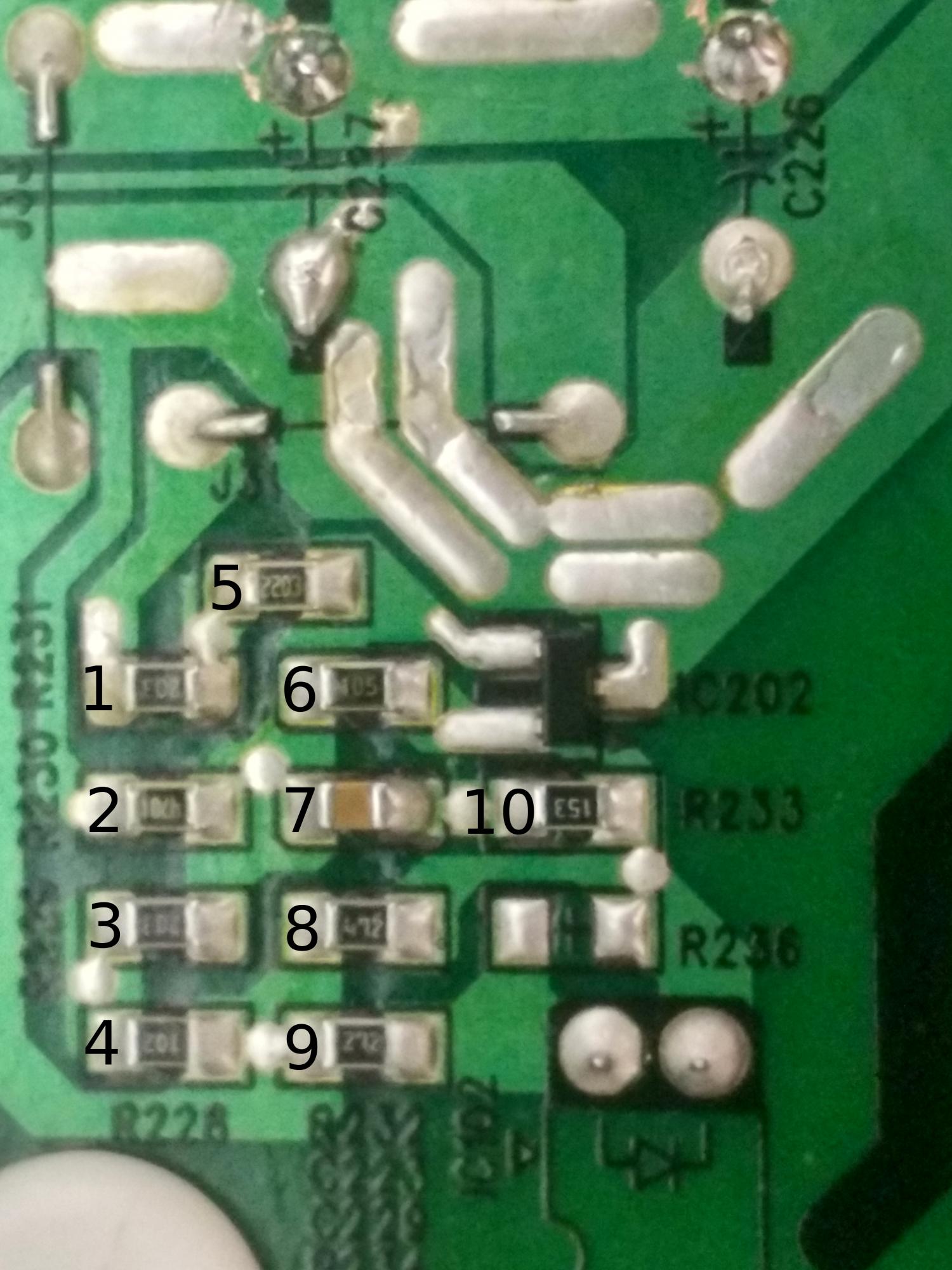

    I found that 20V and 3.5V lines differ about 10% from what they should be reading when TV is on. Note when in stand by 3.5V *line are pretty accurate, 3.49.
    So I decided to trace the 20V back, checking for bad components; I reached *to the area from the attached picture (closer look, with numbers). Here, if I read in-circuit resistors values and obtaining completely different values then they should be for most of them.
    Values are:
    1. resistor code 203 **-> reading 18.35K
    2. resistor code 4701 -> reading 3.784K
    3. resistor code 203 *-> reading 4.80K
    4. resistor code 102 *-> reading 962 ohms
    5. resistor code 2203 *-> reading 22.63K
    6. resistor code 105 *-> reading 8.89K
    7. Cap not shorted (don't know if its good or not)
    8. resistor code 272 *-> reading 4.68K
    9. resistor code 153 *-> reading 15.06K
    I have other SMD resistors spread around the power supply board: for example 105 which are reading 0.85Mohms a couple more 202 reading 1.5K
    Is this way of reading smd resistors fine? If yes, does this mean I have all these resistors failing? aren't they so many?
    Thanks in advance

      Re: LG 37LE500 lcd blinking
      When it is working correctl , are those Voltage readings still the SAME?
          You cannot get accurate resistance reading of the resistor when measured in the circuit.
          Rebooting cycling is more likely there is problem on the main board during startup.
            So better I should start looking at main board?
            I have no clue were to start on any starting suggestions?
            About the 20V line on the power supply, should stop looking at it (is it ok the 18.4v)? or just postpone it?
            Thank you very much for your time and patience
