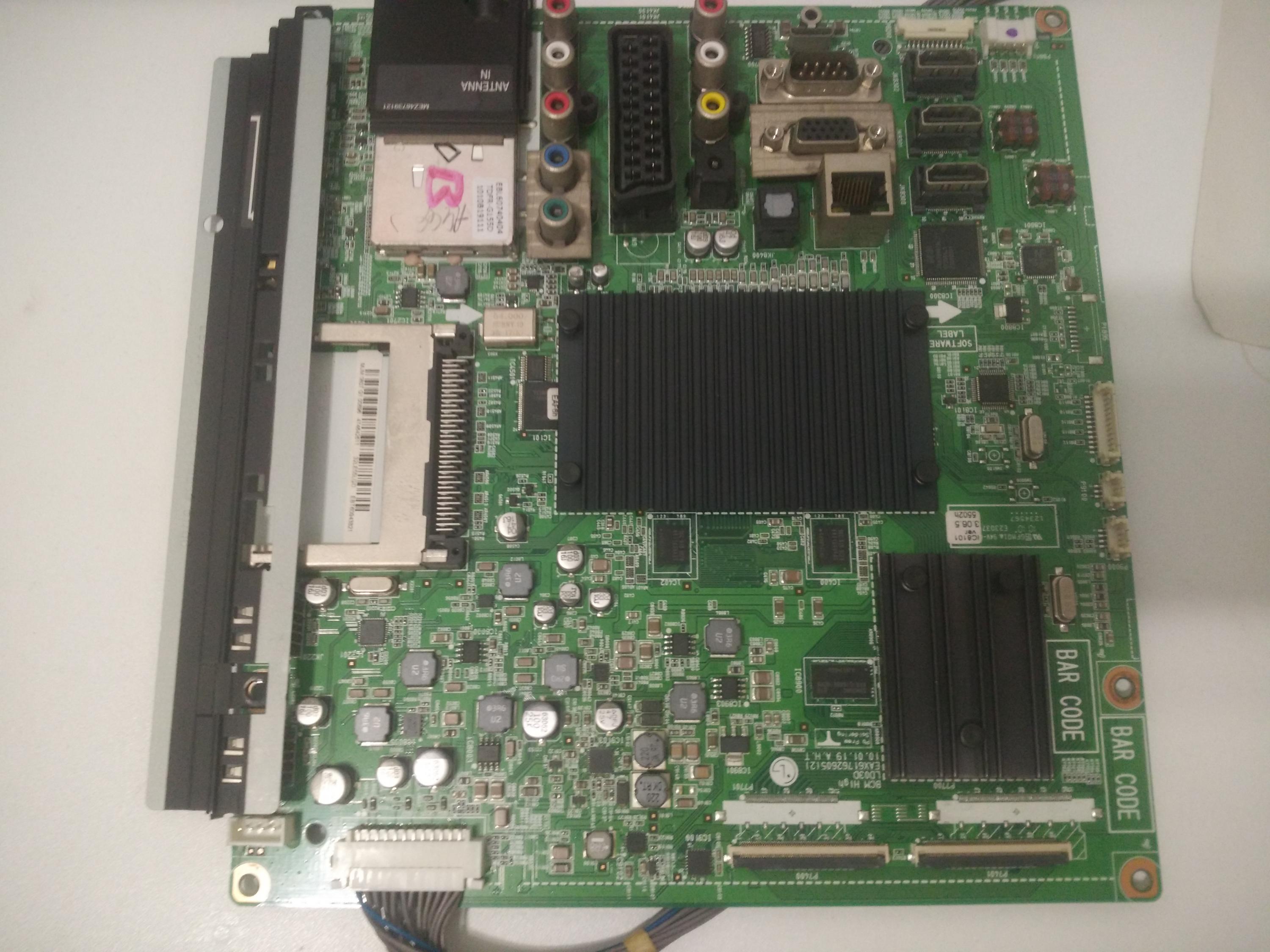

LG 37LE500 lcd blinking
  • neilc6
    • Nov 2015
    • 1550
    Re: LG 37LE500 lcd blinking
    There are quite a few sellers on ebay for repair services of the LE5500 series (42LE5500, 55LE5500) indicating the main boards are susceptible to BGA failure. Reballing is the proper repair. Reheating may or may not have good long term results.
      can you post a picture of the mainboard used in this set thanks

      sorry for the late reply, I've been busy these days (work).
      Please, find attach the picture of the mainboard
      Thanks for the link, a quite interesting reading
      Ooops, I don't have equipment for BGA repairing
      I think this repair is out of my scope
