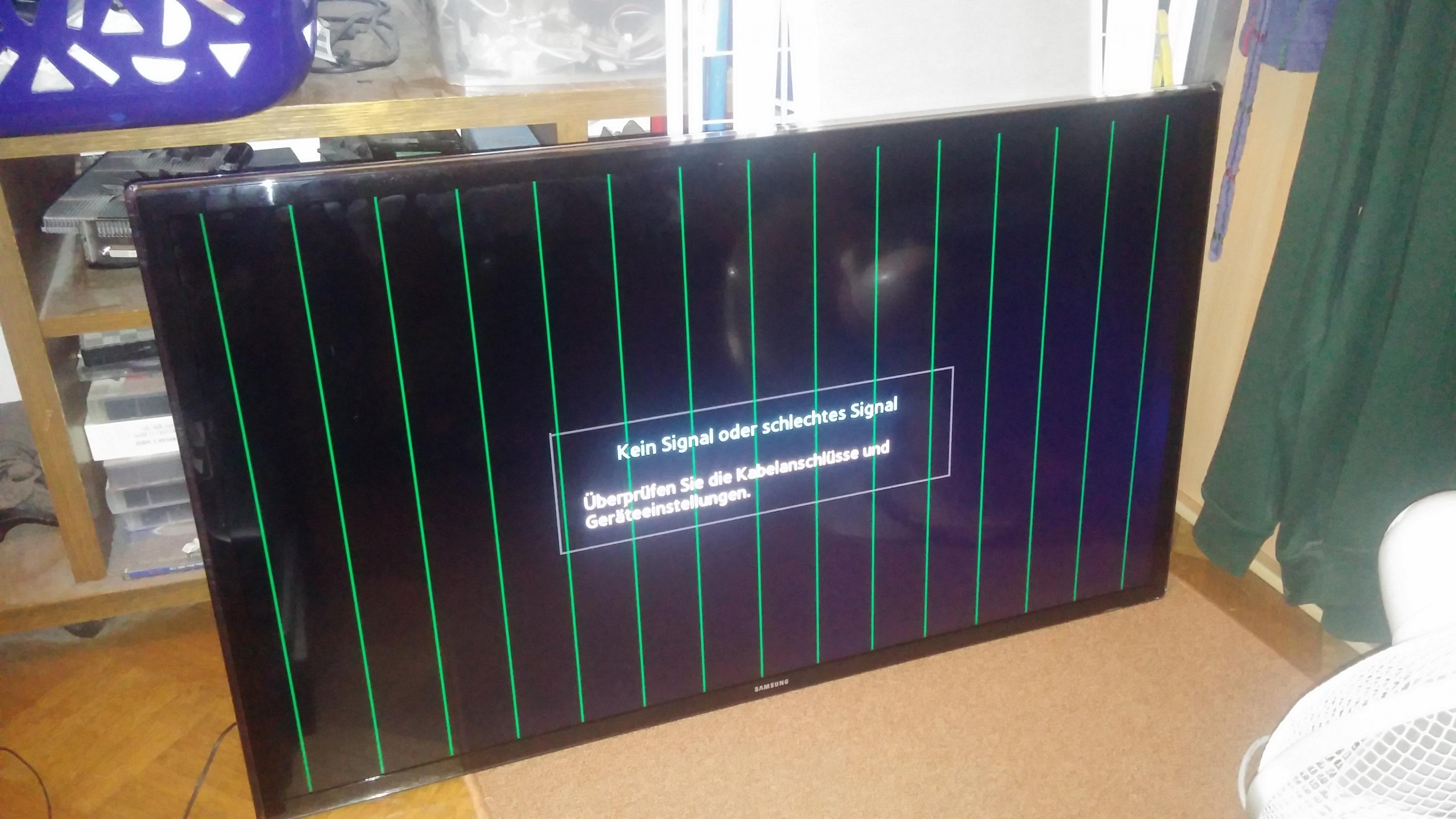

    Samsung UE40F6340 vertical green Lines
    I got a problem with my tv a UE40F6340 there are green vertical lines on the whole screnn ever 2 inches
    In the samsung chat the mean that this maybe a problem of the T-con but otherwise I have look some videos in you Tube where some people work with Heatguns on the mainboard.
    So my question is, is this really a T-con problem or otherwise maybe the panel are gone?

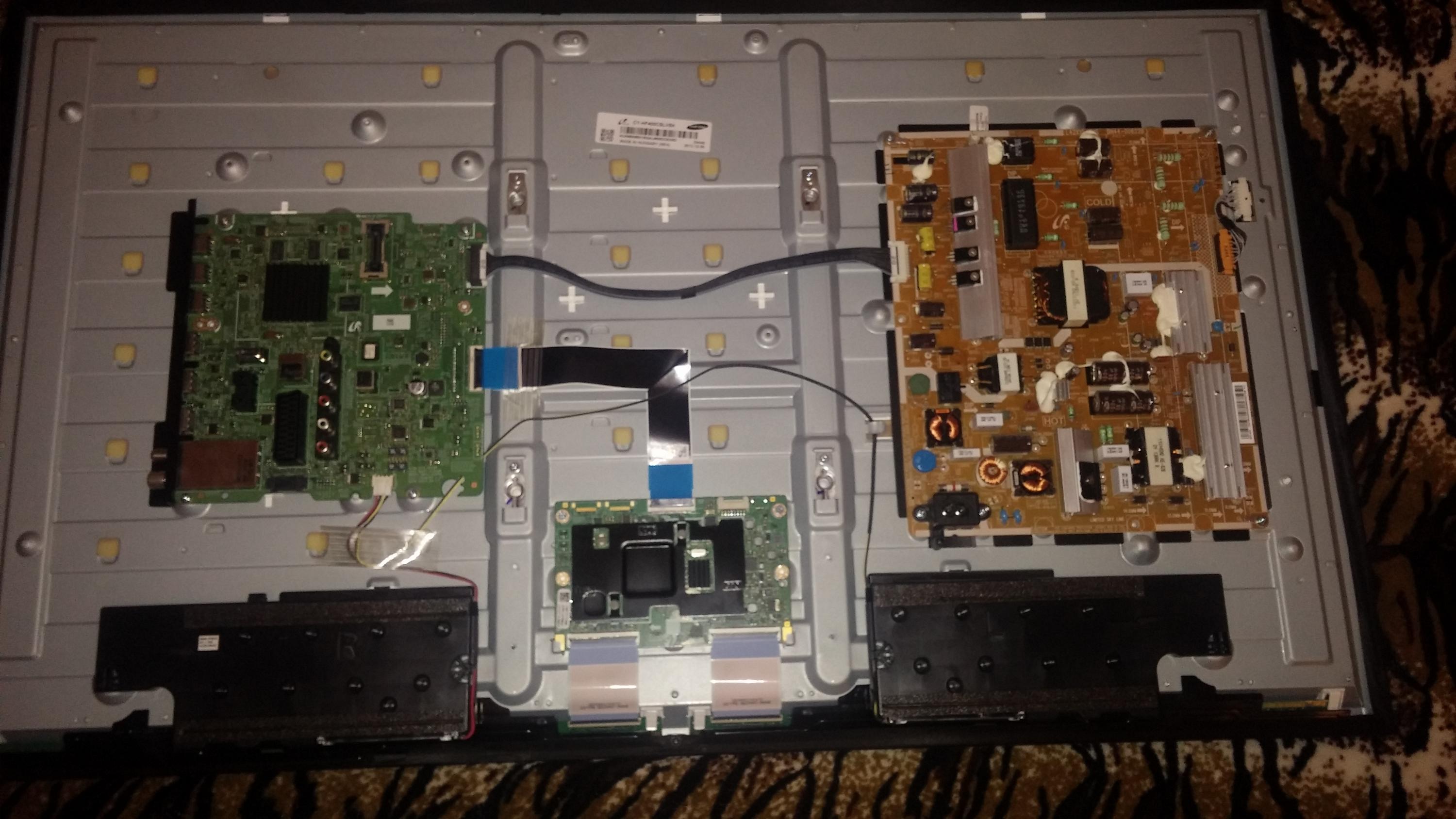

    Re: Samsung UE40F6340 vertical green Lines
    T-con or mainboard problem.
    Could you please pictures of the back of the tv? ( Boards ).
      Thank you for your answer but excactly this is the question, now i dissambley the tv an work with a Headgun on the mainboard but the vertikal lines appears again.
      But is it possible to work with a Headgun on the T-con?
      Here a picture of the backside
        Hello
        this is defect display
        it is not a t-con defect
        t-con gives figure deformity or does not give a figure at all
        I had such a problem and I changed t-con and the same
            its unlikely to be a panel / display problem. try disconnecting / reseating / cleaning the cables at the tcon to see if things change.
            • Diah
              • Feb 2013
              • 6564
              Non T-CON or Panel fault, its main board. packing your MB for 10 minute at 280-300 degree ( non air flow oven ) if you have hotair gun then do it only on the main processor.
                Yeah I already do the hotair thing on the whole Board there is some Coller placed over the cpu that I didn t turn off, but I will try again after I cleaning the cables with probanol alcohol1
                  You need to remove the cables etc from the mainboard. Remove the heatsink on the cpu.
                  Use a heatgun and flux and heat up the cpu. Watch out because the board will bend pretty quick. It is best to make some small balls with alluminium foil and reflow the cpu. Use youtube for example video's.
                  Btw , dont repair Samsung it is shit anyways.
