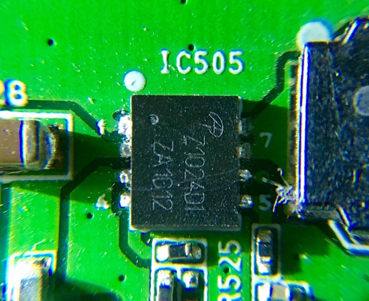

                  Re: LG 55LW5600 No Video No Sound
                  Could you post a picture of IC505 and the area around it. As well focussed as possible.
                    The AOZ1024D can supply an output current of 4 Amp continuous according to the data sheet. If the resistance at pin 8 is 13 ohms then at 3.3v out would be a current flowing of 253mA.
                    The AOZ1021 can provide a continuous output current of 3 Amps. I think the IC or the components around the IC is faulty.

                          #32
                          I verified the number. It is correct. Both of those numbers are printed on the top of IC505 (one above the other). Z1024DI/ZA1012. I'll try and get a pic when my wife gets home. I don't think I have a camera that will get a very close and detailed pic.

                            #33
                            This is the best I could do. Do you need more of the area or is that good? FYI pin1 looks more like pin 8 than the picture shows. I think that's mainly light pollution making pin 1 look blown out.

                              #34
                              Pin 7 & 8 connect to the coil. Does the other side of the coil connect to a ceramic capacitor?

                                #35
                                Here's a pic.

                                    #37
                                    I think that IC505 is faulty. It creates the 3.3V_Normal supply from the 12V input to run so many other parts of the set as shown on page 104.
