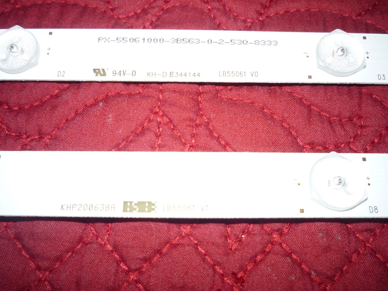

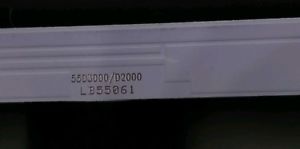

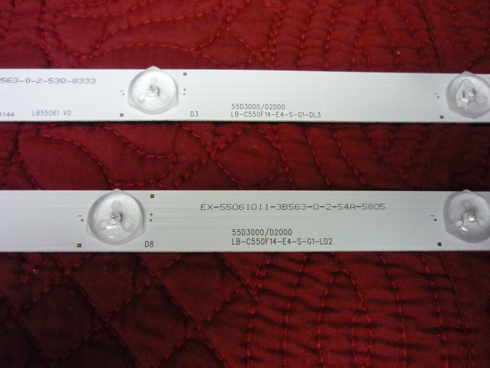

        Re: Hitachi LE55A6R9A, individual LED SPECS?
        Here we go:
        They call me......."threadkiller"

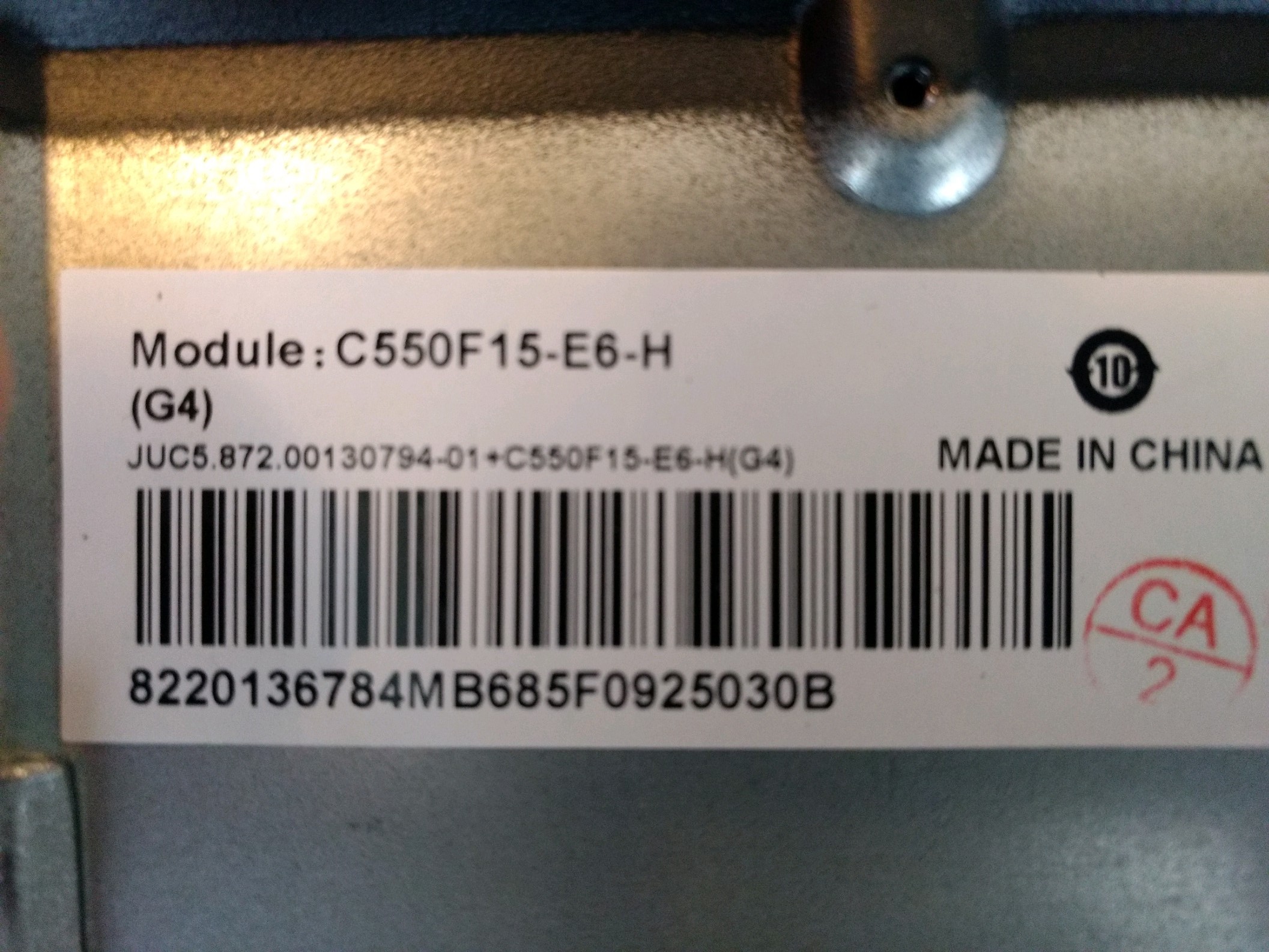

          LCD panel model number?
          C550F15-E6-H?
            Originally posted by DXseekerMO
            Here we go:
            http://www.shopjimmy.com/hitachi-lb5...-12-strips.htm
            You will have to remove the old LED to look at the solder pad foot print and also check the Voltage of the working LED.
            The LED will have to match the solder pads and polarity as well.
              Panel number:
                C550F15-E6-H?
                Is one of those LED testers like one SJ sells good enough to measure the LED voltage, or is there a more accurate method?
                Speaking of LED testers, any suggestions for a good one?
                  That is good LED tester for testing the Vf at low current (30mA). It will give idea if you have open circuit in the LED string or not. It will also light up LED string that has some shorted out LEDs, in that case you will to know how many LEDs you have in the string to calculate what the Voltage reading should be based on 30mA current.
                  Since it does not out out real operating current, the LED may light up with tester but it will fail with real load current.
                  It is a good tool to have, I have one also.

                    Does the information printed on these LED strips tell anything about what LED's are used?
                      That tester is definitely on my list. Right now I'm using batteries to check them but that really doesn't tell me anything other then the LED's work or they don't.
                      No.
                              If you scrape the track of a working led, you cam put a meter on 'short' setting and if its a 3v led it will light up. If it doesnt light its a 6v led.
                              Just looked at your pictures and Id guess they were 3v
