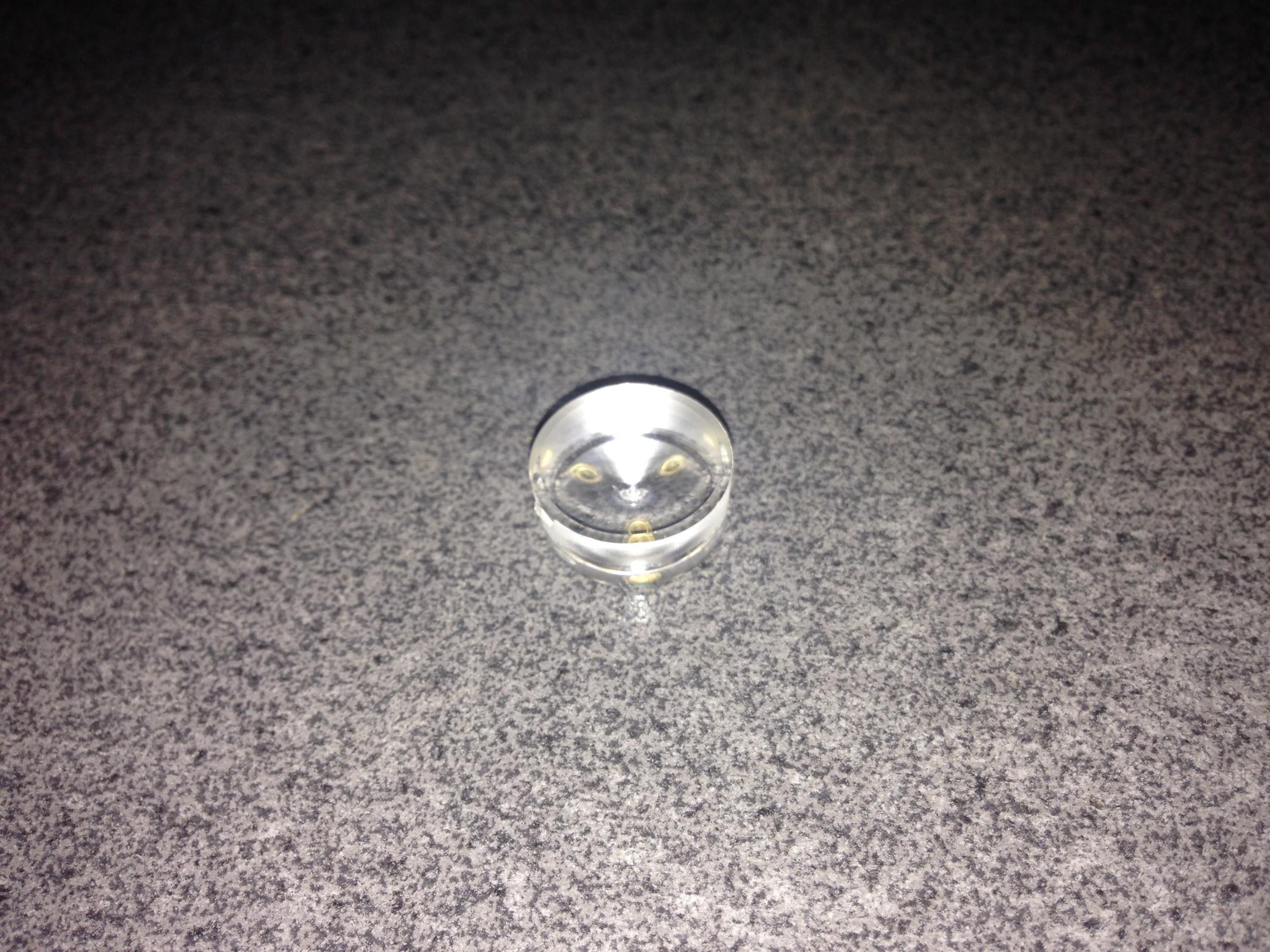

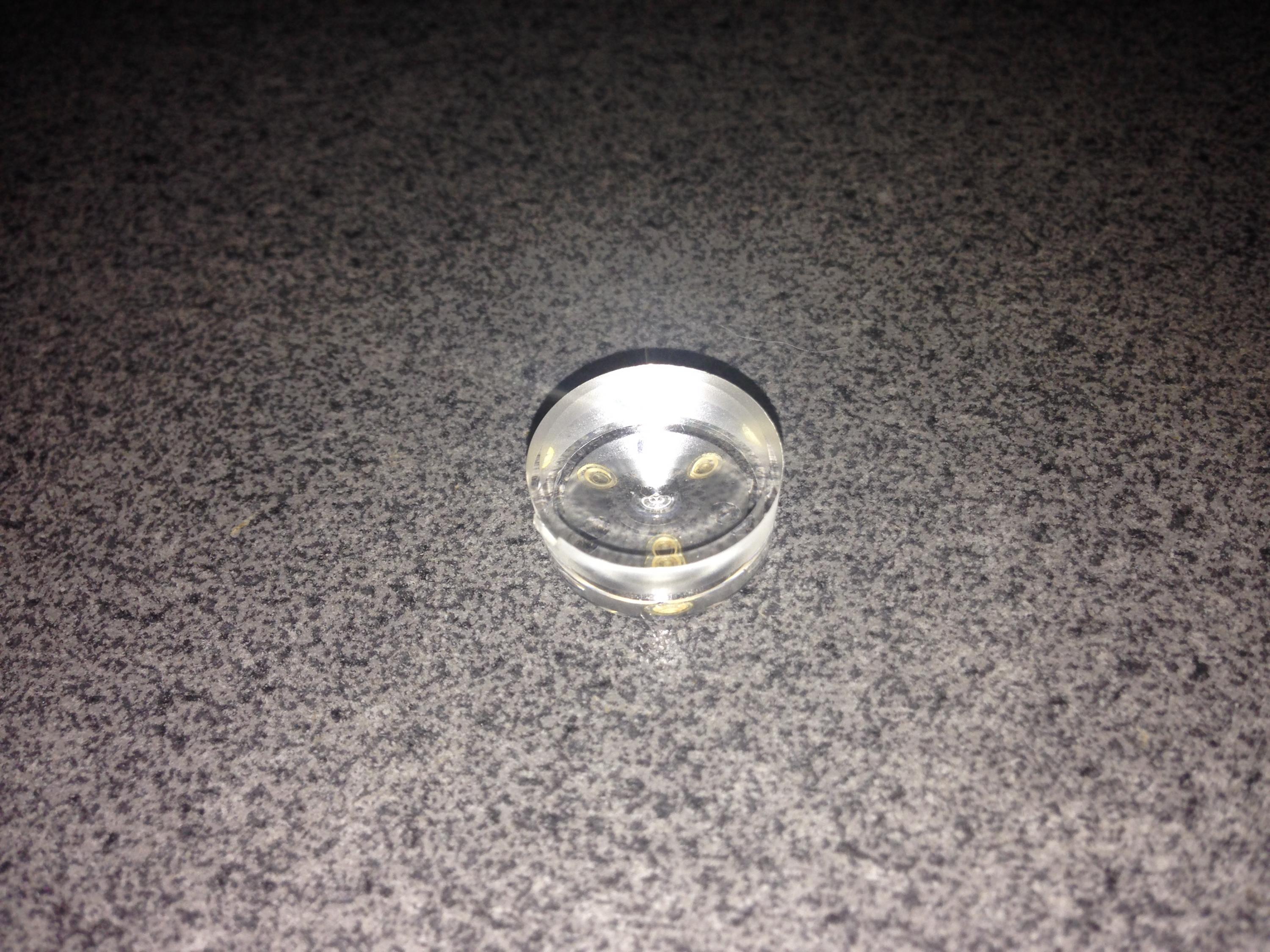

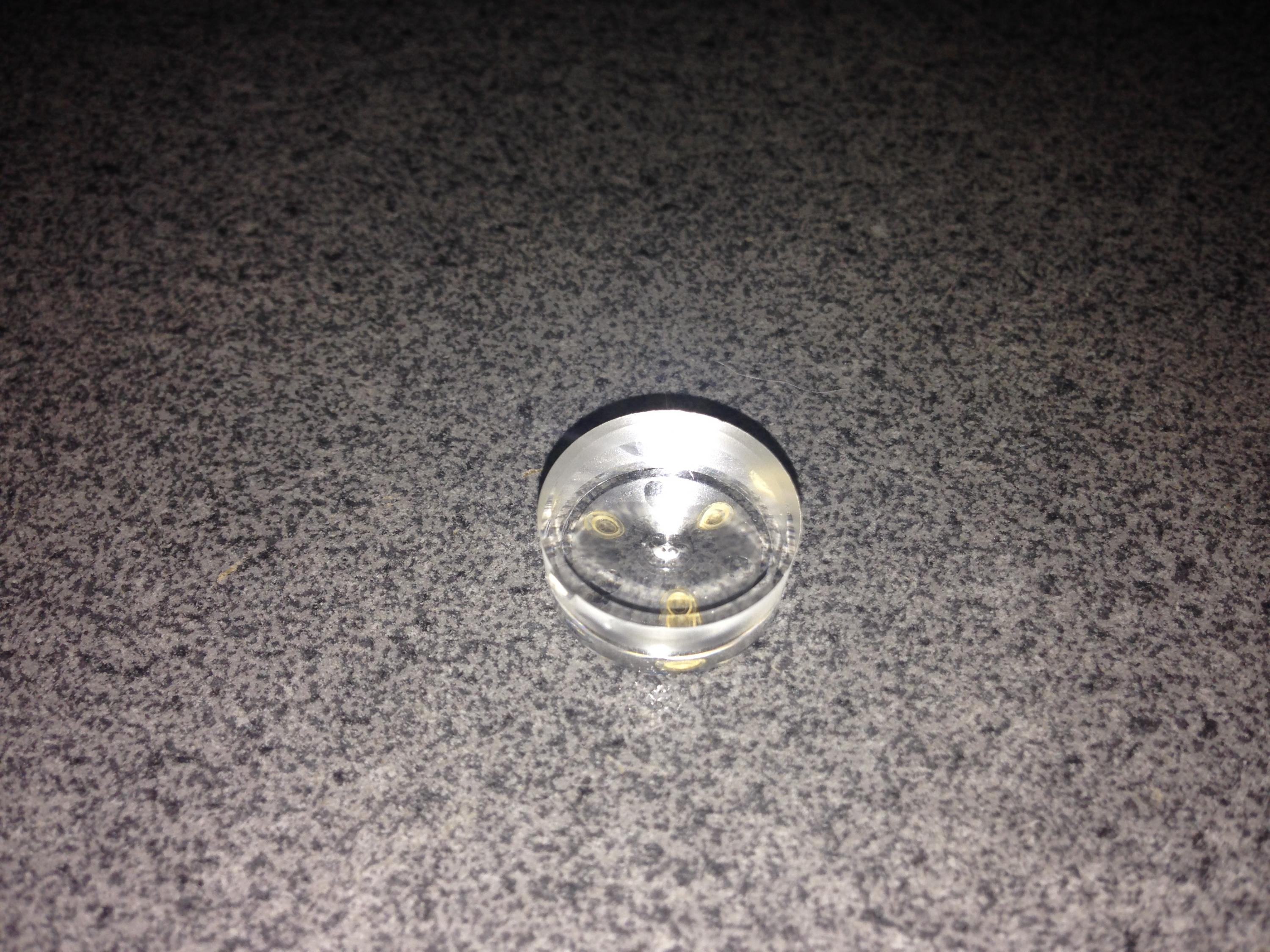

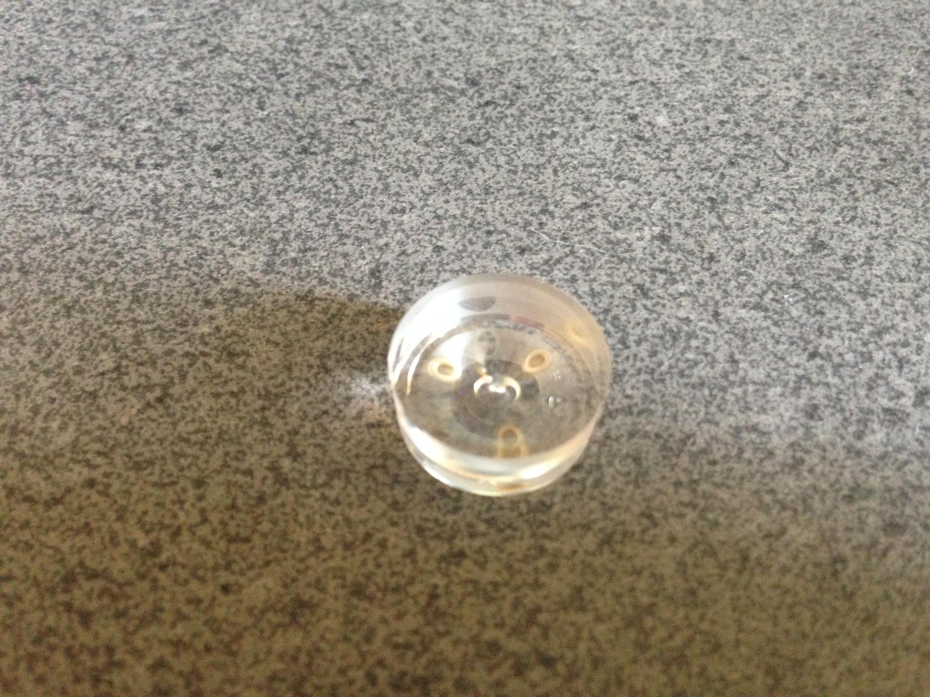

                        Re: Bright leds LG tv
                        this is what the lens are like,the tv is assembled atm i will be taking it apart again next week prob,thanks.Ive ordered some different double sided tape that is ultra thin im going to try that when i take it apart,i still think its the thickness of the tape i was using..
                          its going to be the lens not being seated properly
                          best to use a glue epoxy that lets you move it around
                          and do while you have power to the leds and that way u can put the diffuser down to check alignment.
                          • gabiz_ro
                            • Mar 2011
                            • 171
                            • Romania
                            That lens are more hard to fix on right position.
                            I found in my contry online shop who sell some pen with gel adhesive with UV cure.
                            Put some gel on support pins,center lens,attach first plastic layer and see if is OK.
                            If not try to re adjust lens.When result is OK light with provided UV led that lens for few (or more) seconds.
