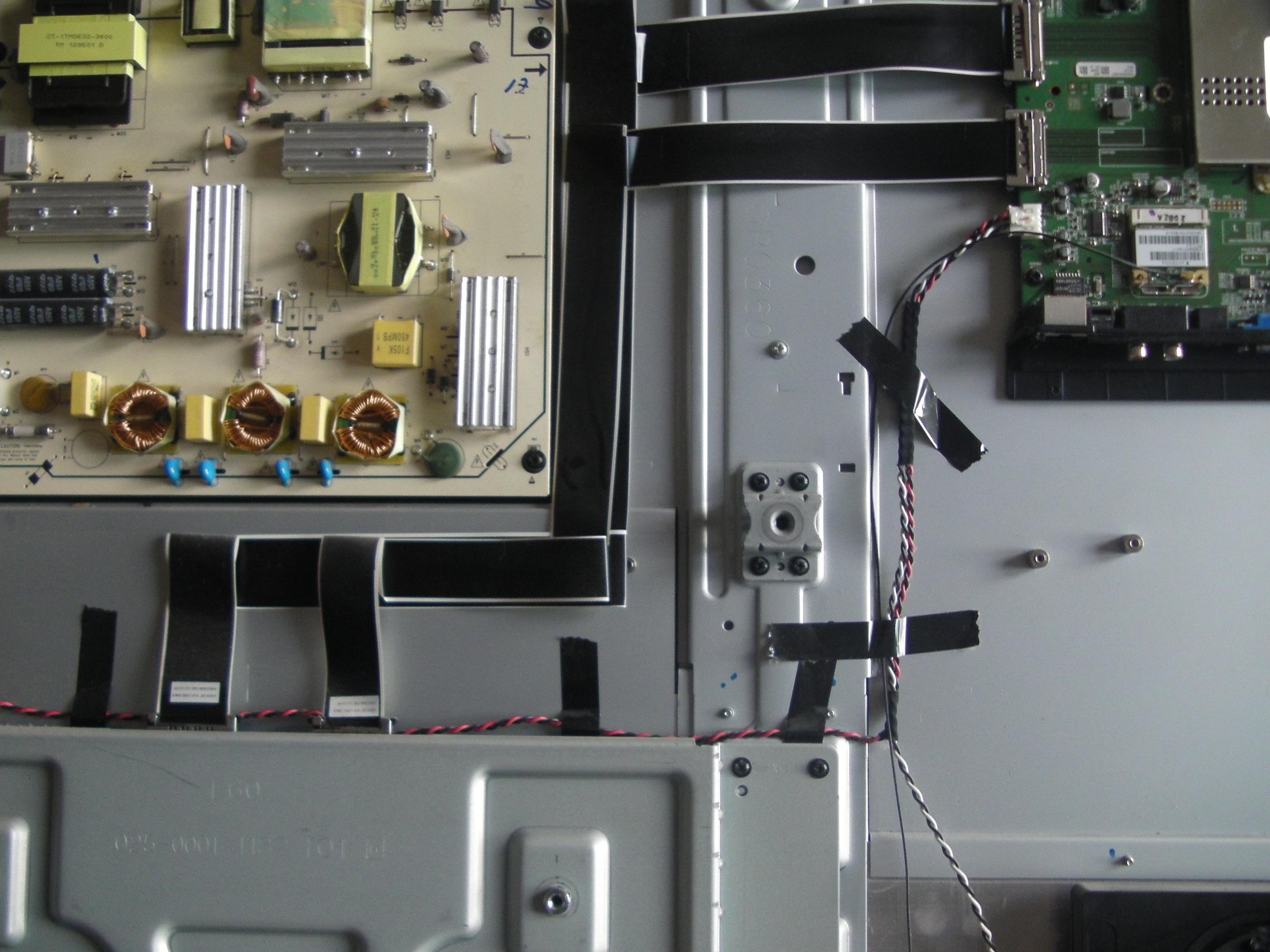

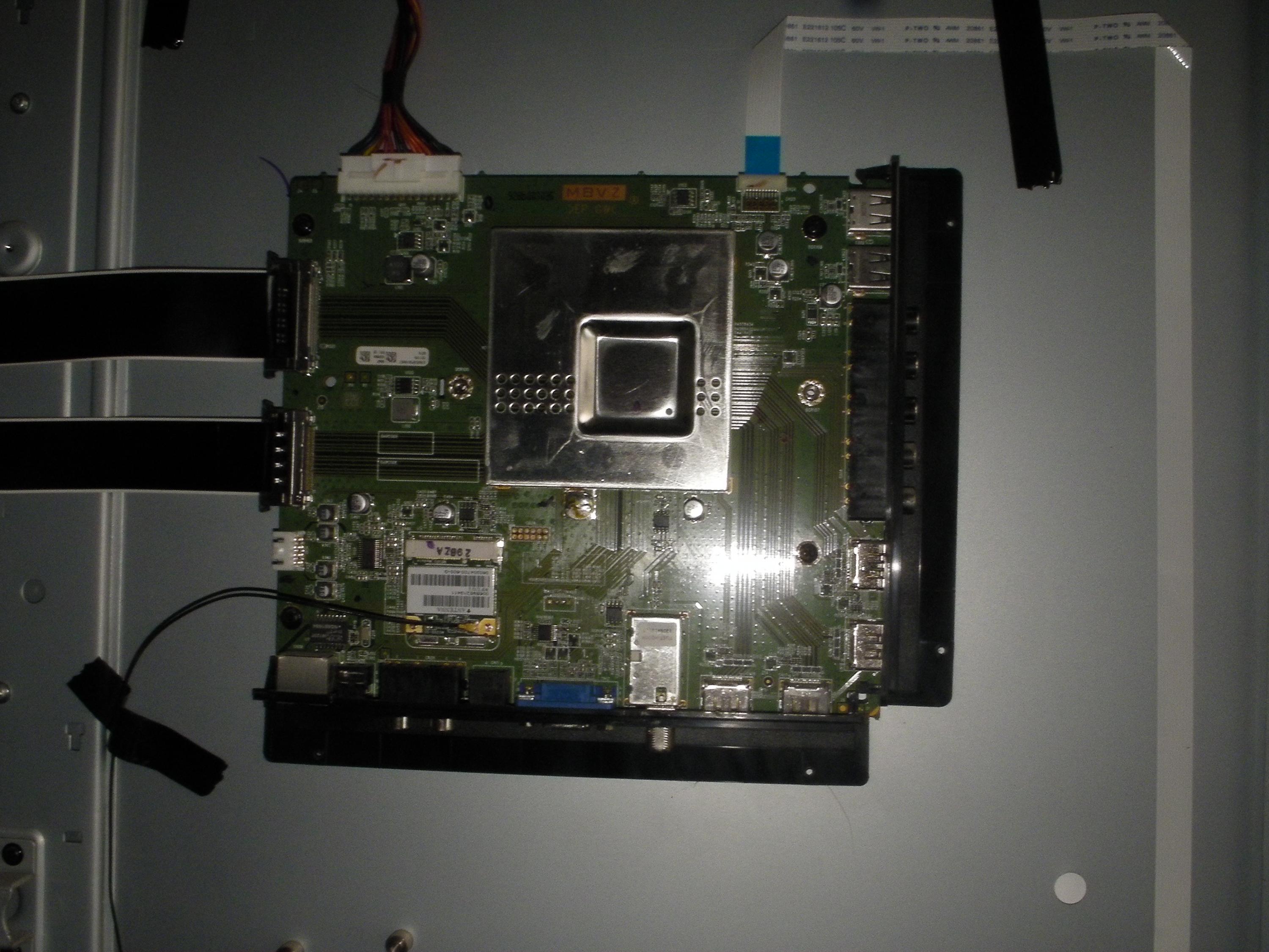

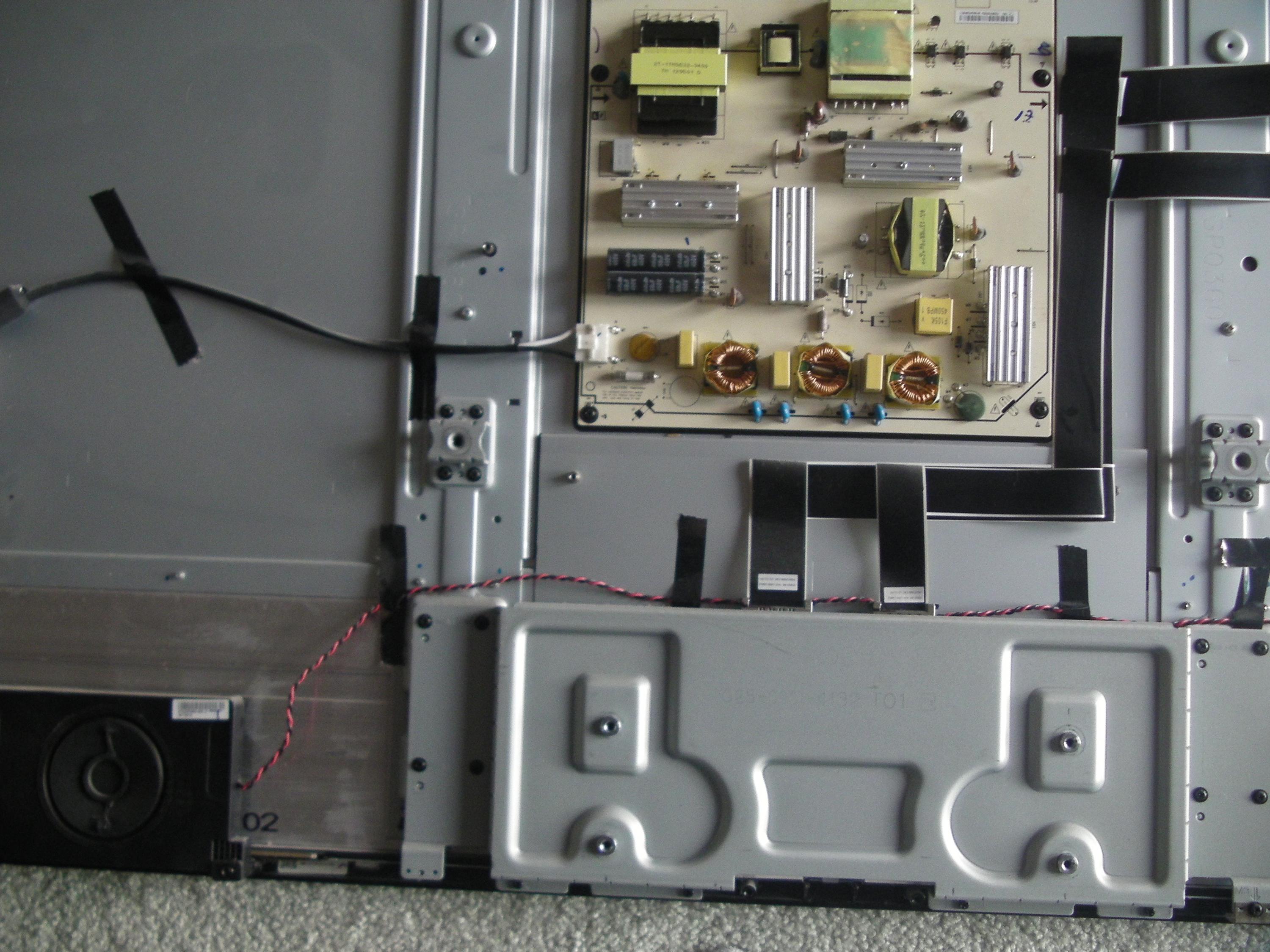

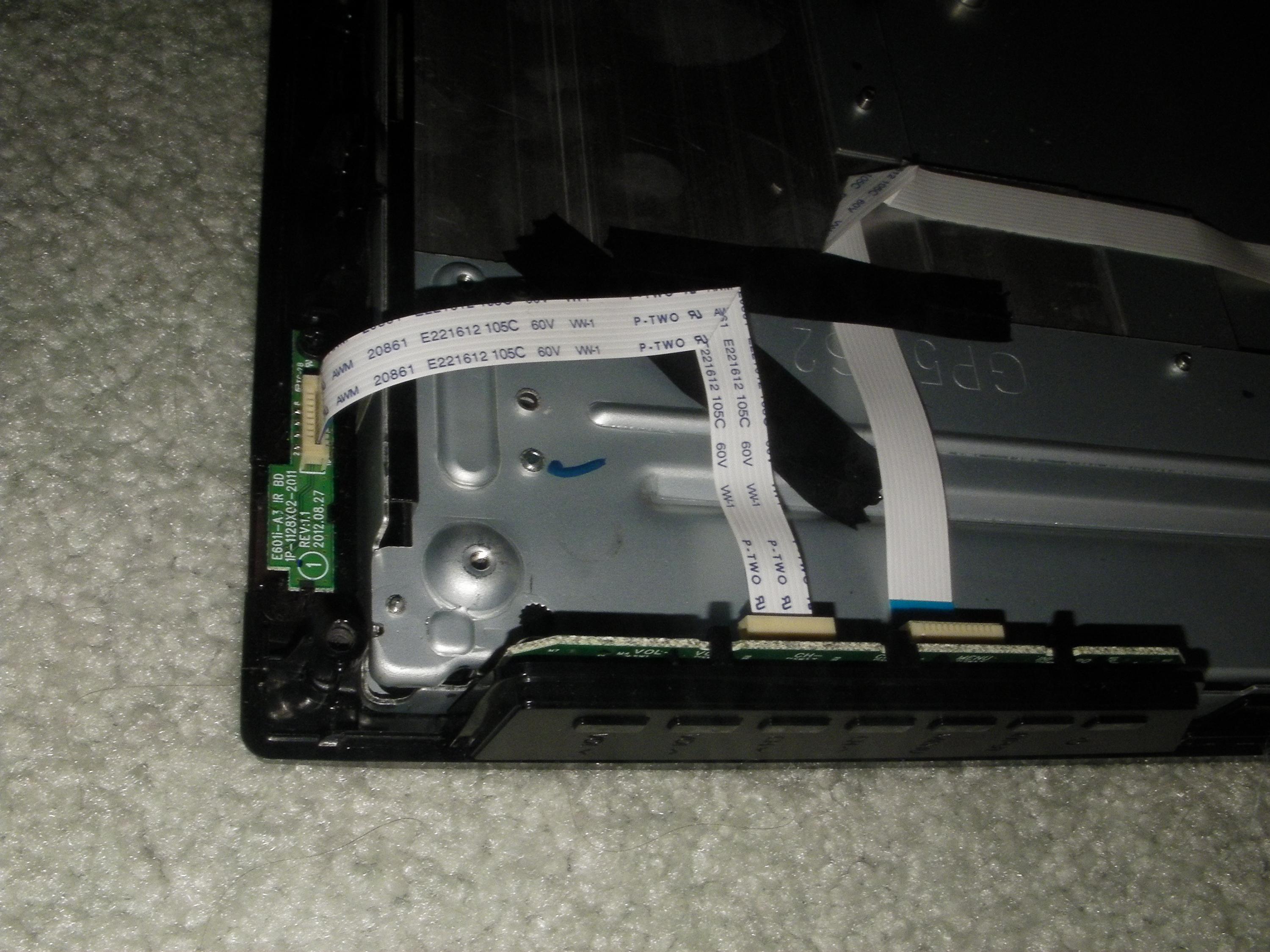

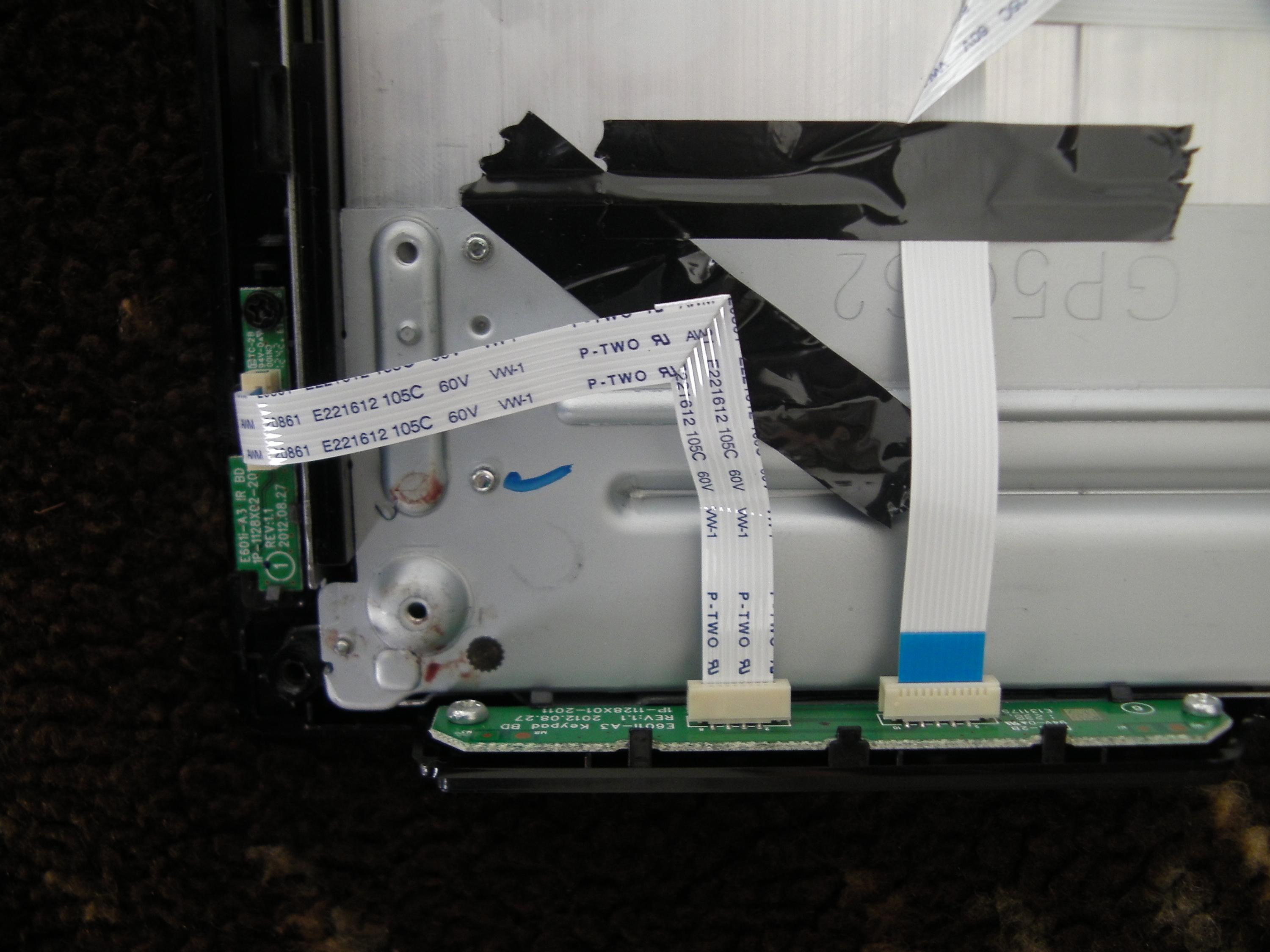

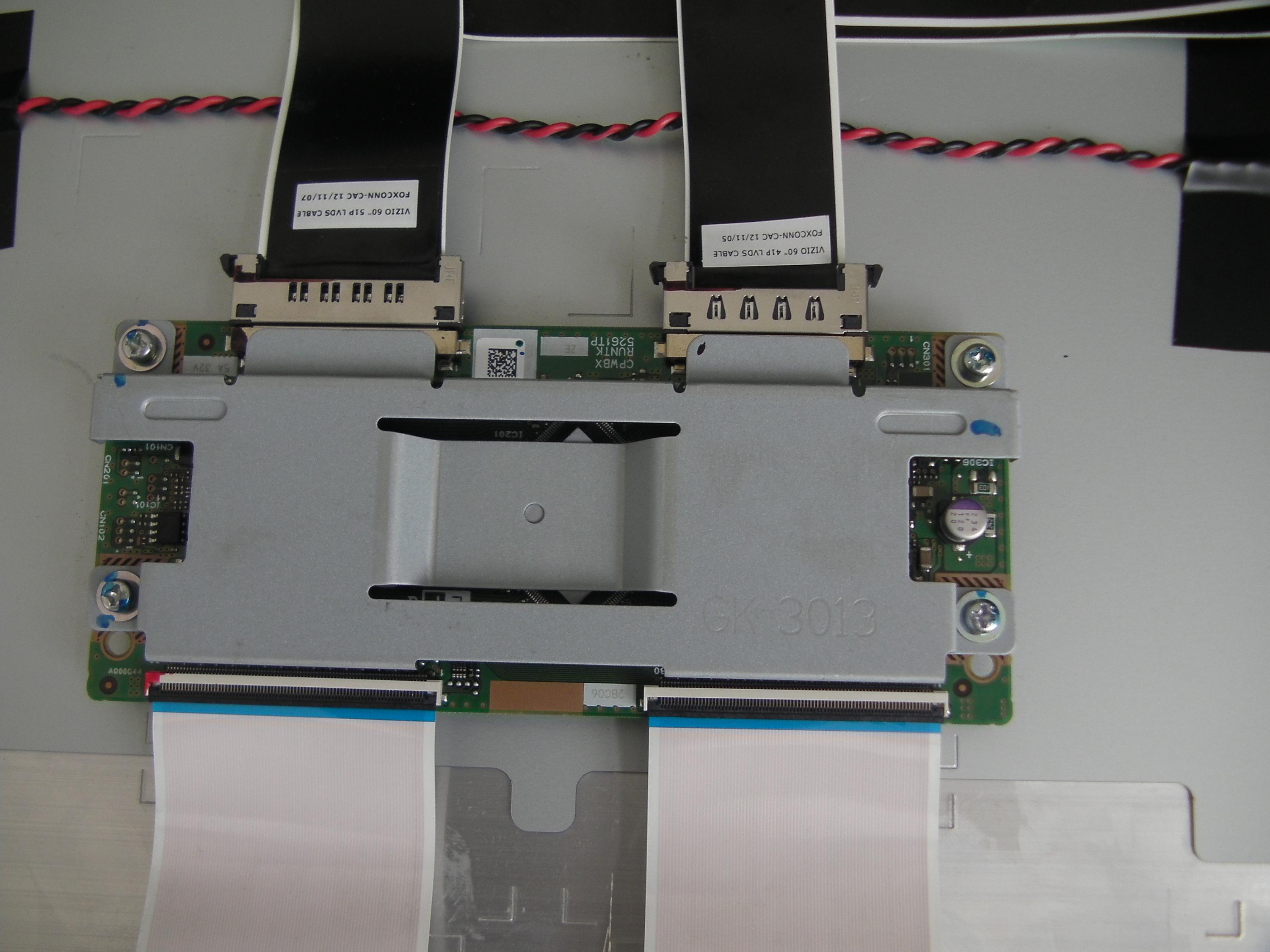

                                  Here are some rather poor photos I took before putting the TV back together:
                                  • SANY6574 = Main board with part of power supply board and T-CON covered by metal plate
                                  • SANY6576 = Partial main board and power supply board with T-CON covered by metal plate
                                  • SANY6577 = Part of power supply board and T-CON covered by metal plate
                                  • SANY6578 = Main board (dark picture)
                                  • SANY6580 = Control panel and IR area

                                    Try reseating your tcon cables taking notice that they are perfectly aligned. If that doesn't work remove the cable from one side and power on and report what you see. Do the same for the other side.
                                    As for the backlighting you may have had a poor connection at one of the led strips which you inadvertently remedied by going inside and mucking about.
                                      Re: Vizio E601i-A3 backlighting problem
                                      OK, I took the back cover back off the TV and disconnected and reconnected the various ribbon cables, and now the image is back to normal, and the backlight still works. So, I guess I have revived my TV--at least for now. Thanks to everybody for all of your help!

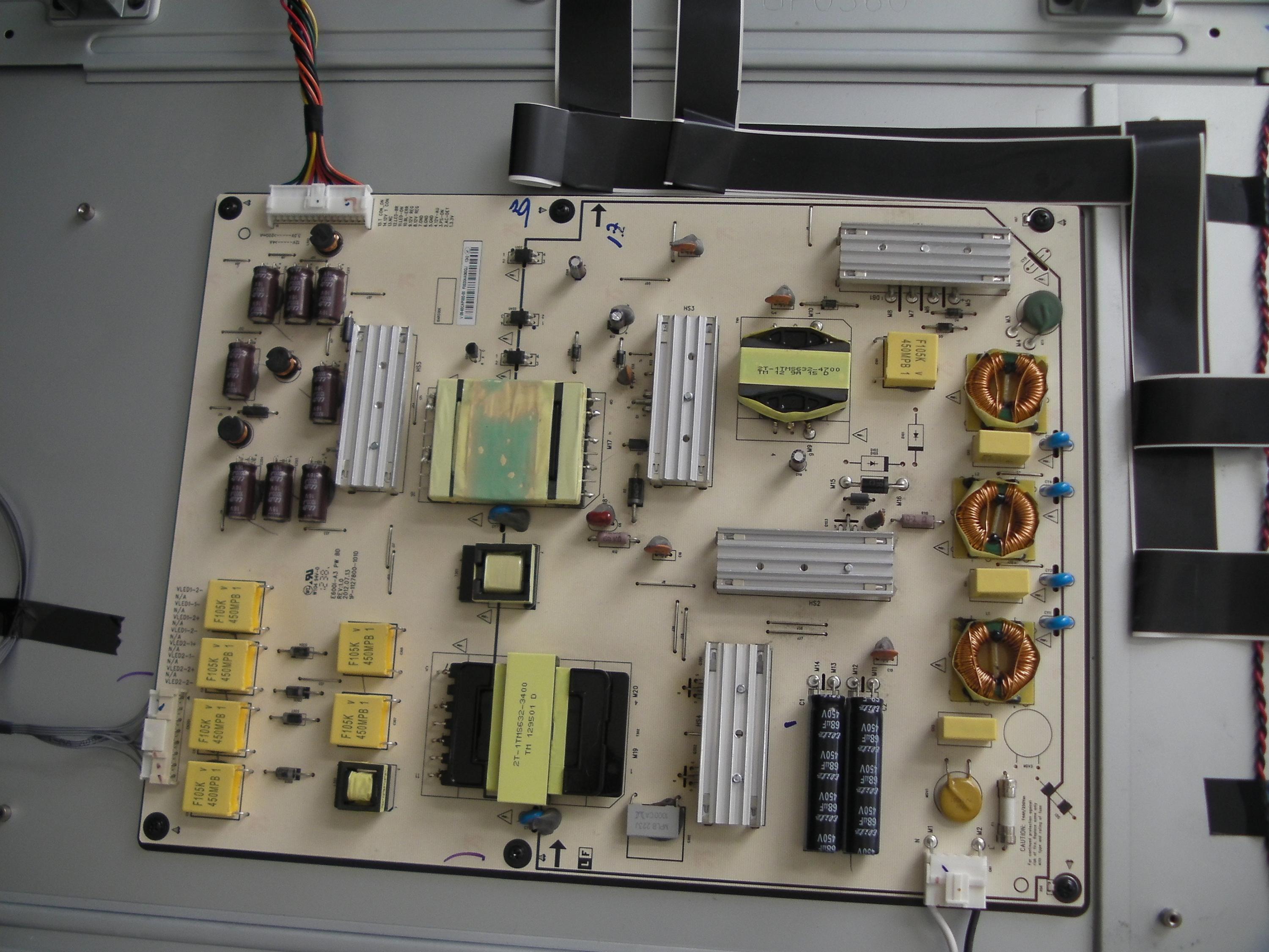

                                        And here are better pictures of the boards in the TV:
                                        SANY6609 = Entire back of TV with cover removed
                                        SANY6612 = Power Board
                                        SANY6615 = Power Board (closeup of LED power connector area)
                                        SANY6617 = Main Board
                                        SANY6618 = T-Con Board (covered by small protective frame/heat sink)
                                        SANY6621 = Small Keypad and IR Boards
