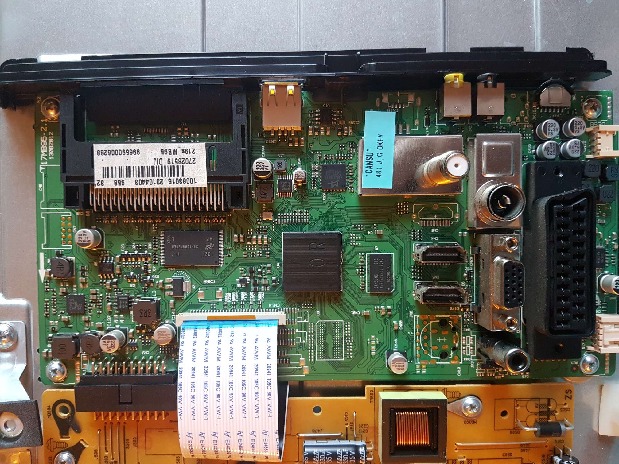

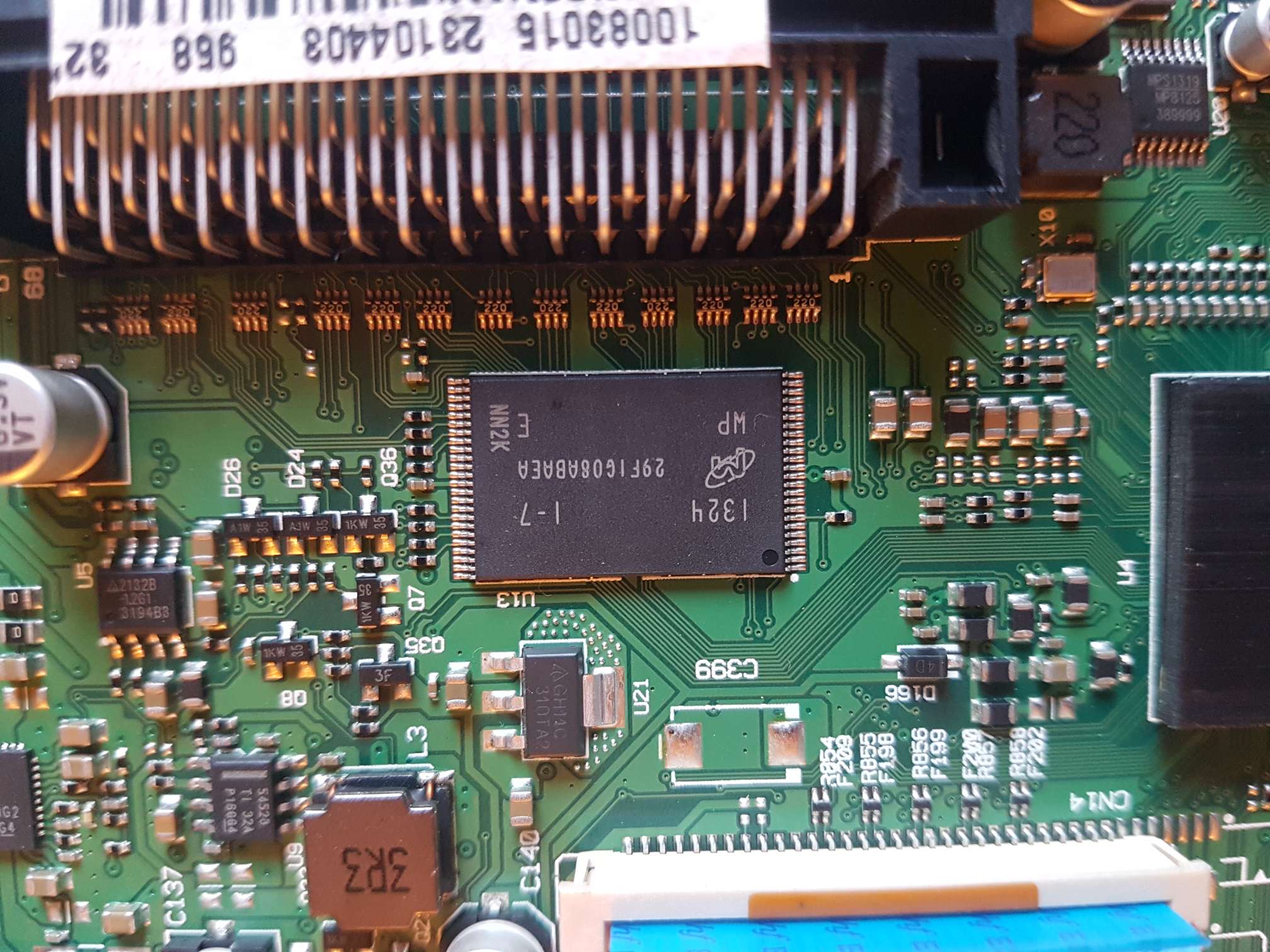

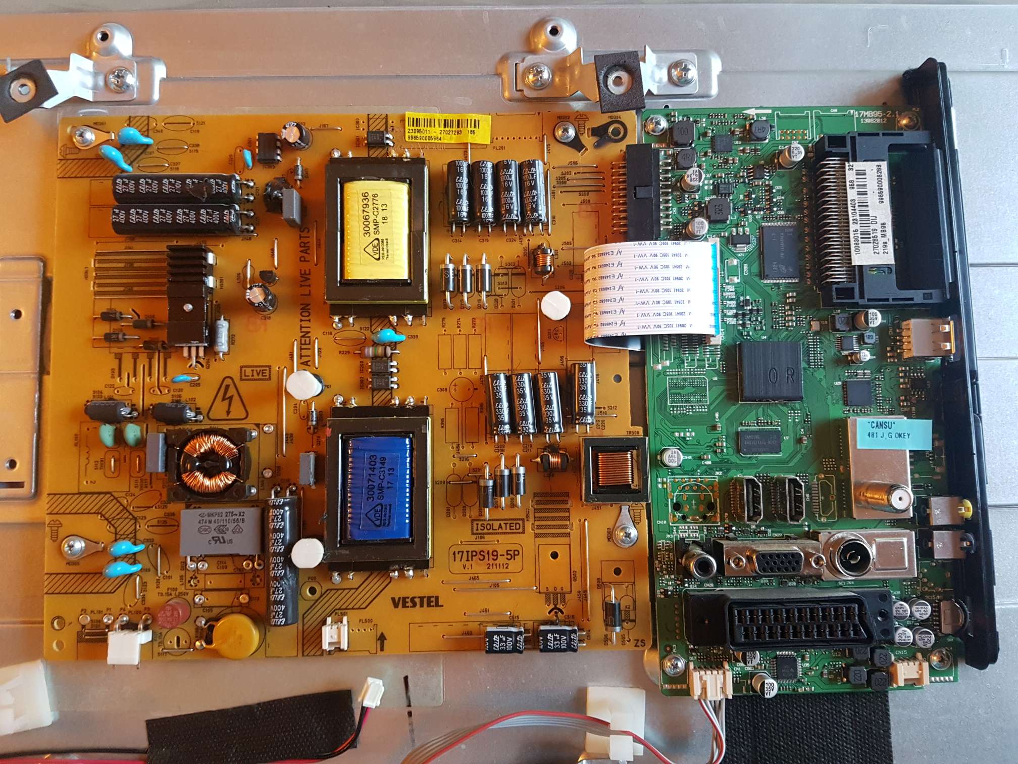

    Hi, I have Philips LED TV 32PFL3008K/12 that blinks 10 times and doesn't turn on.
    It is cheapo VESTEL made TV.
    I measured all the diodes on power supply, some voltages and they are ok, I suspect mainboard - but there are so many variants of firmware so I need some help to find right one.

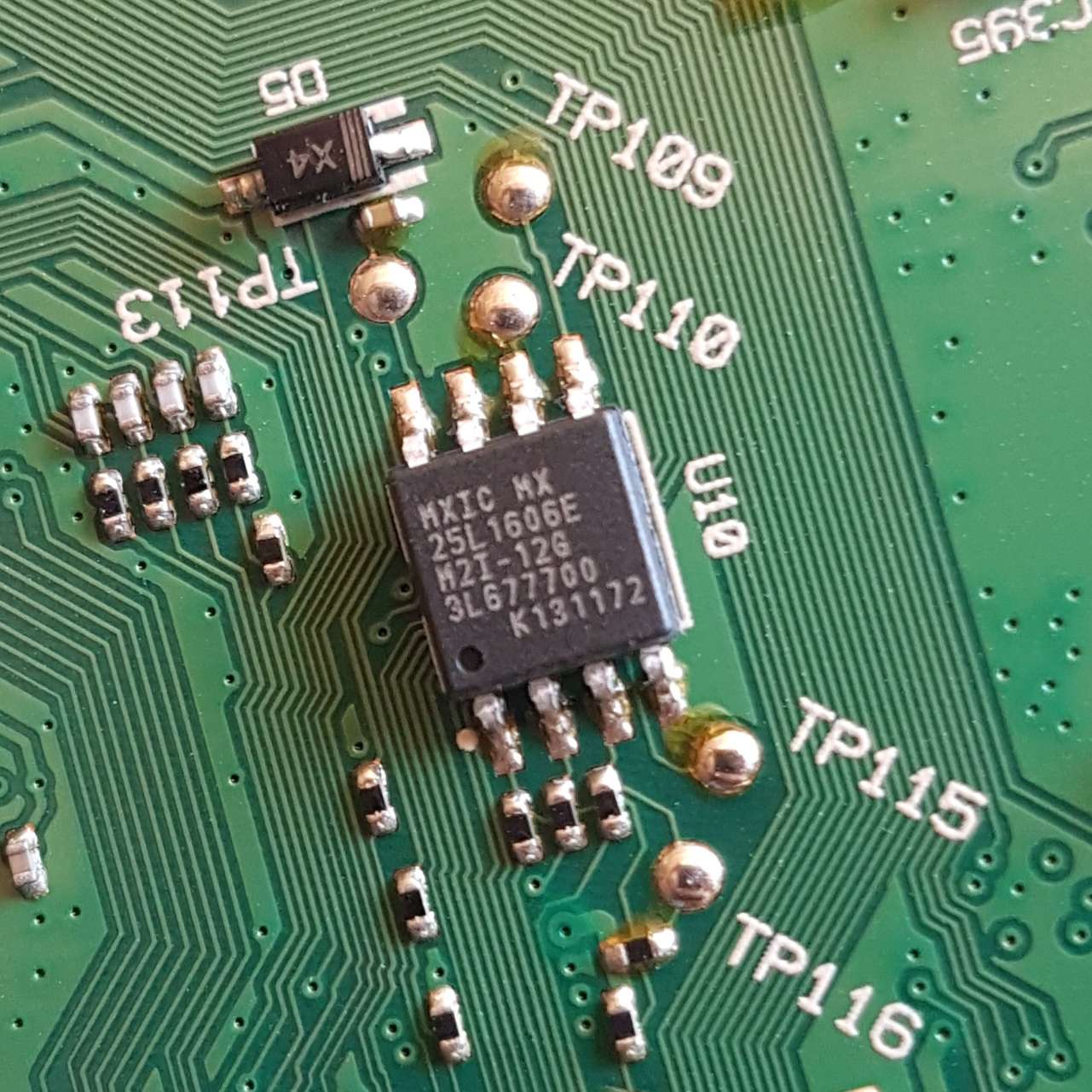

    There are NAND 28F1G08ABAEA (U13) and 25L1606E (U10)
    LCD Panel is VES315WNDB-01 (more info on sticker)
    Can I maybe reflash NAND from USB?
    I can also write on 25L1606E - I have TL866A programmer

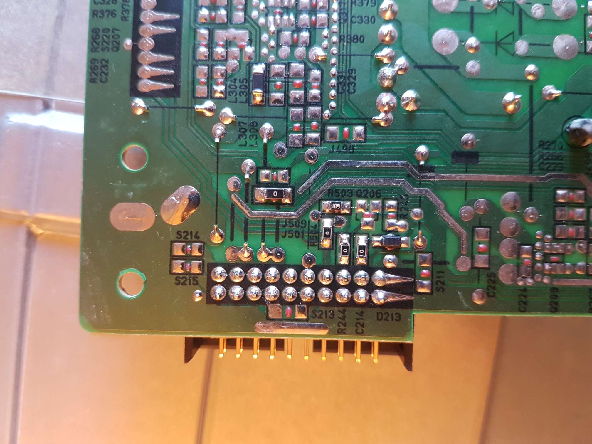

      Re: Blinking 10x Philips 32PFL3008K/12 - VESTEL 17MB95-2.1 and 17IPS19-5 17IPS19-5P V
      Yes, on main connector PL200:
      PIN 5 24V
      PIN 7 12V
      PIN 11 5V
      PIN 15 3.2V
      PIN 17 0V
      PIN 19 24V
      PL501 (LCD Supply) 24V is OK
      Also whole system takes about 12W from wall (I have Power meter)
      PL201
      PIN 1 3.2V
      GND OK
      24V OK

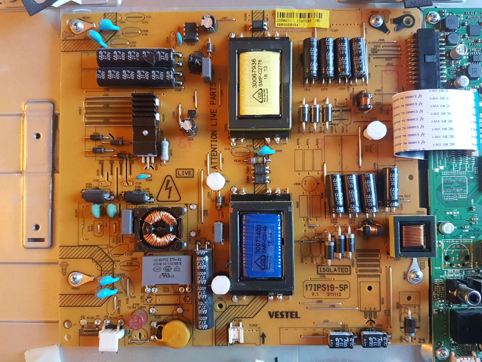

                        On red wire:
                        When I tries to turn on TV voltage is ramping to 46.3V and alowly goes down to 0V
                        On black wire:
                        Ramping to 100V and slowly goes down to 0V
                        • Andrew F. Ali
                          • Jan 2014
                          • 2450
                          • Trinidad & Tobago
                          That's 53.7V difference between them. Looks OK, unless there is a shorting LED that is trying to pull a larger current and shutting down the LED Driver. Well you have another Main Bd. with Driver on the way. Try that and maybe it would work.
                          • Folxs
                            • Nov 2016
                            • 167
                            • Poland
                            So now You suggest to check all LEDs?
                              https://www.ebay.ie/itm/2-X-STRIP-LE...W/112676310576
                              Base on your panel model number provided, it looks like it has two LED strips with 22 LEDs total.
                              The supply Voltage went up to 100V (which is the maximum Voltage rating of the Boostconverter output filter caps C514, C515 which means the power supply is not seeing the load so it goes into OVP shutdown.
                              The Cathode return of the LED string goes to GND via PIN11 (LED 1) of the IC 500.
                              So it can be that the LED string has open circuit some where, or the LED 1 pin is not PWM on. Having the LED tester will be good to have at this point.
                                  I couldn't fall asleep - one LED was burned open, I installed LED from other TV and now everything is working fine
                                    Thanks for the follow-up, make sure to turn down backlights level to as low as possible for all inputs.
