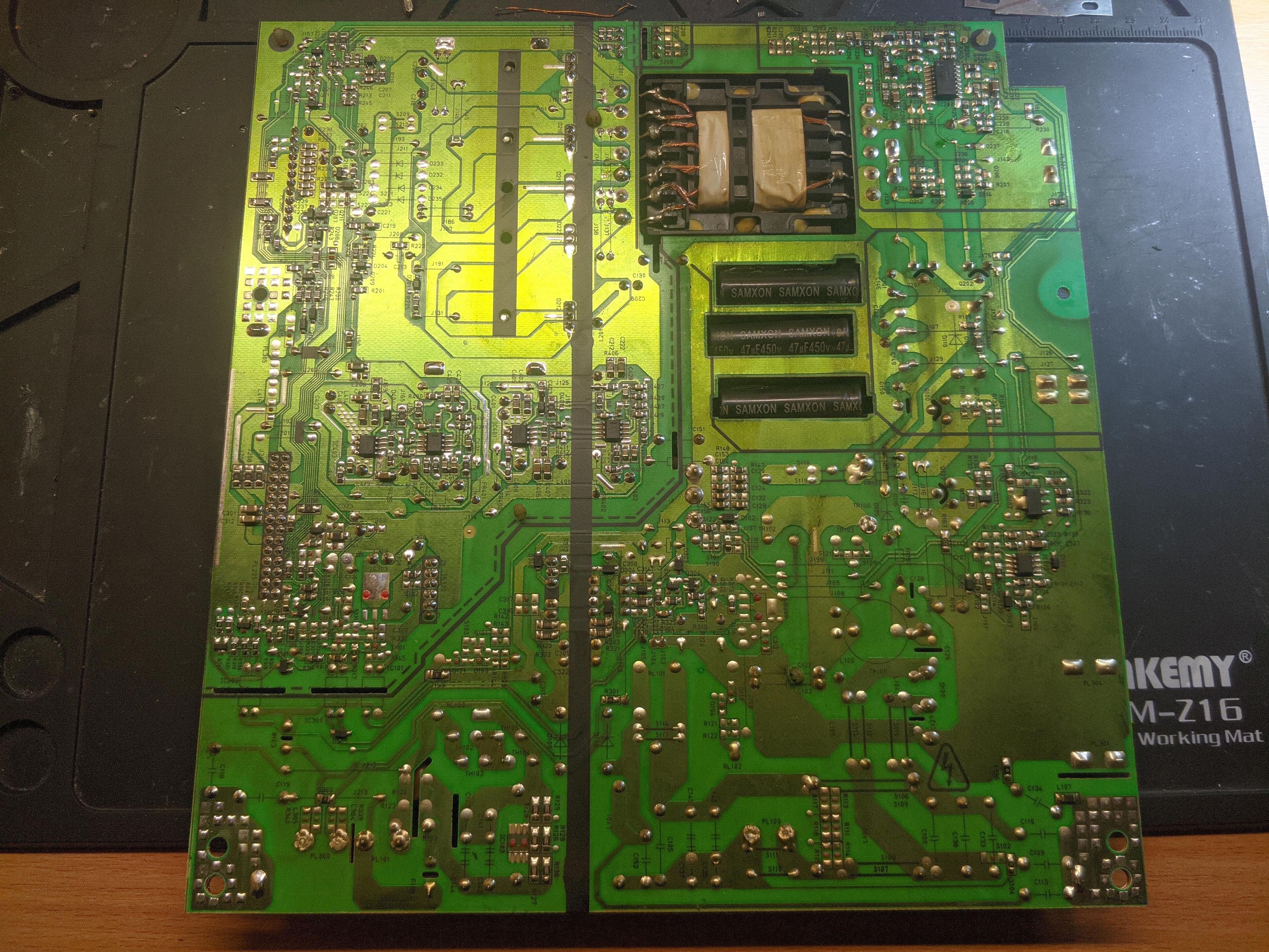

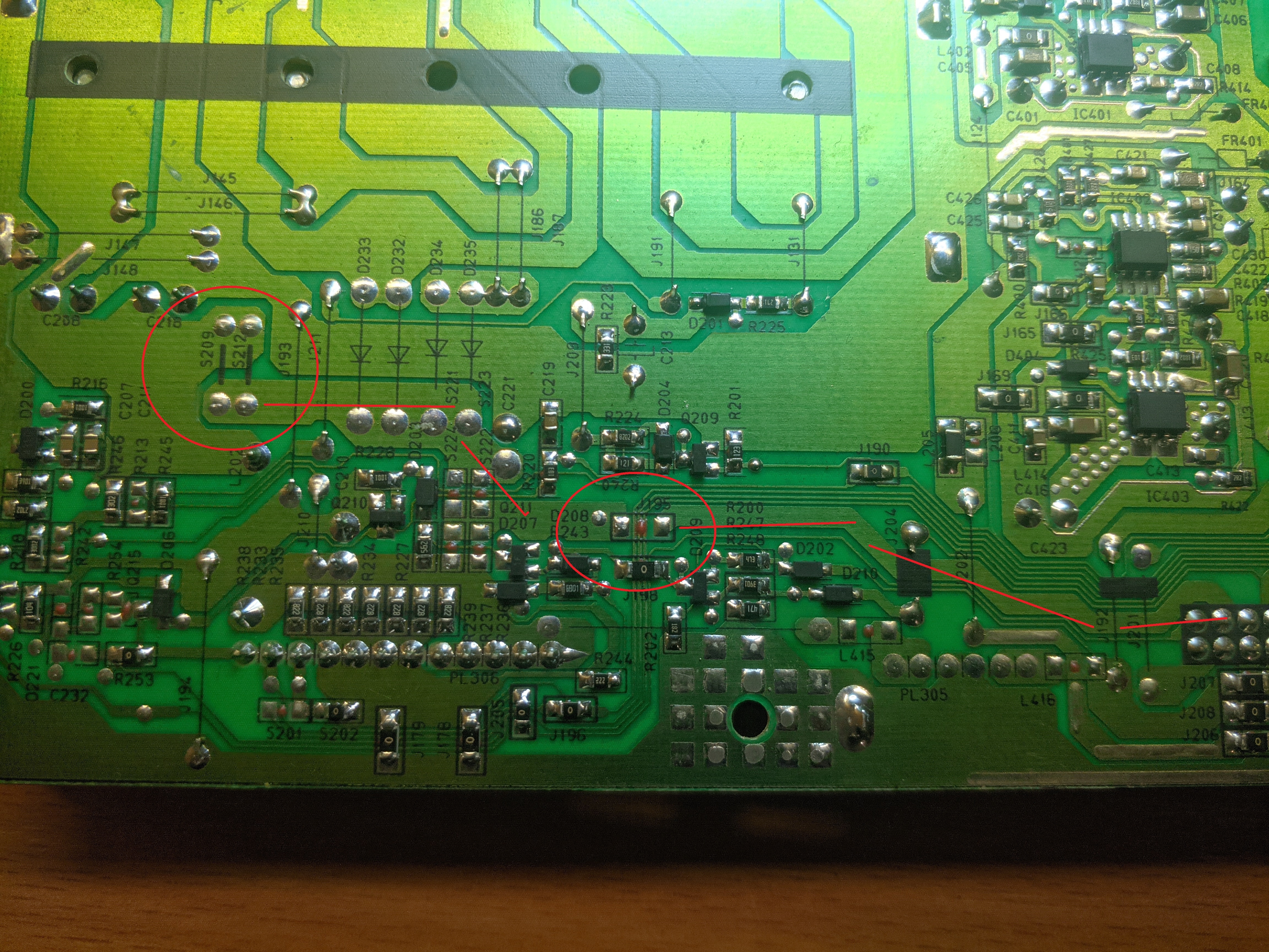

              I found the schemtics of the power board and it looks like 24V is missing from PL205 (MB connector output) and 5V is missing on PL305 (Backlight inverter connector).
                you may have to jump some pins to get the missing voltages if your just bench testing the psu (im not sure which pins though)
                • unimatrix93
                  • Oct 2021
                  • 347
                  • Magyarország
                  What is wierd is that it looks like the 24v rail is disconneted on purpopse. Yet the schematics (both the PSU and the mainboard mentions it for the 32inch model)

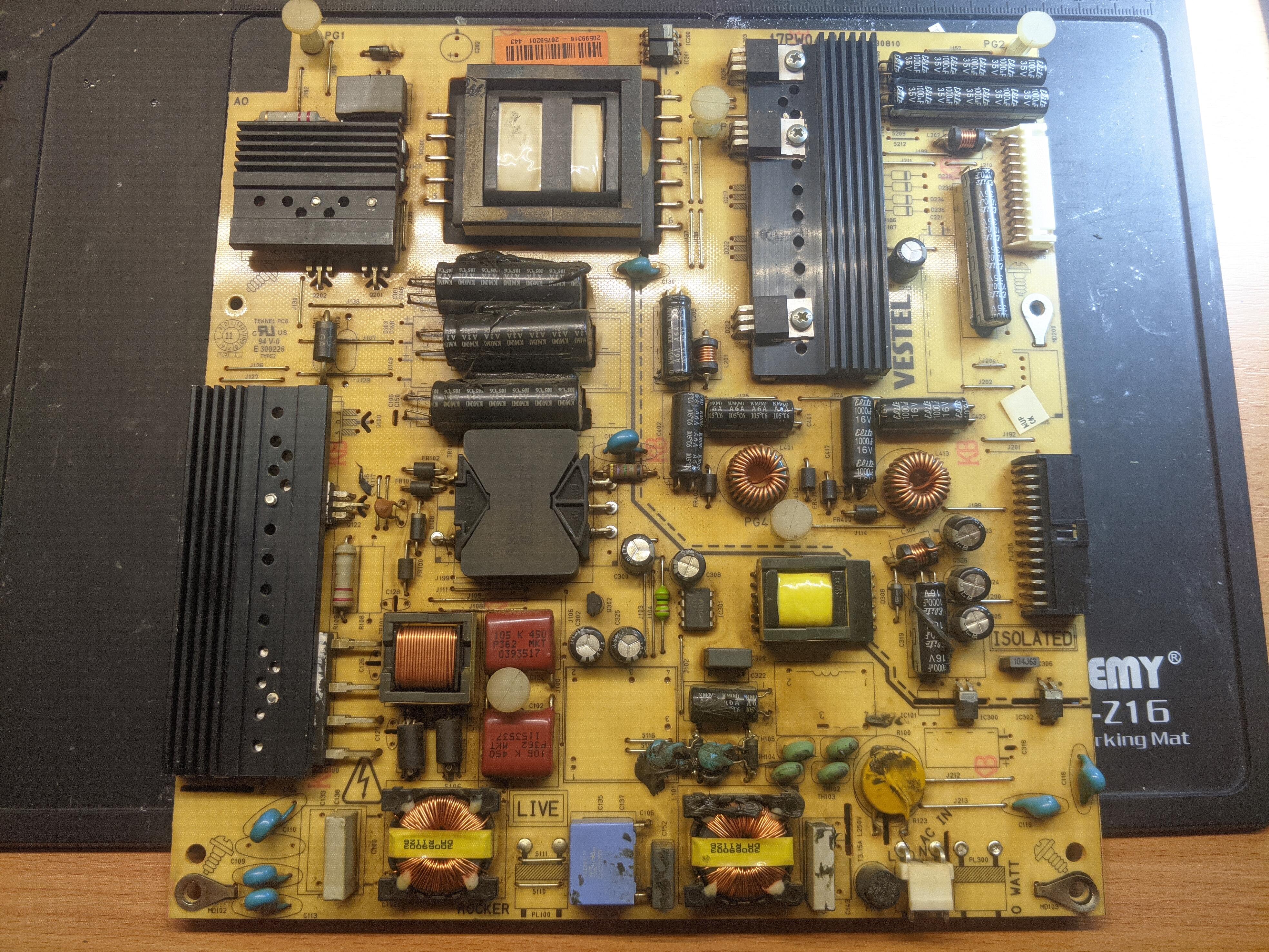

                  • vinceroger69
                    • Mar 2012
                    • 6714
                    • uk
                    can you take some pictures of the top and bottom sides of your psu and upload them thanks
                      Sure,

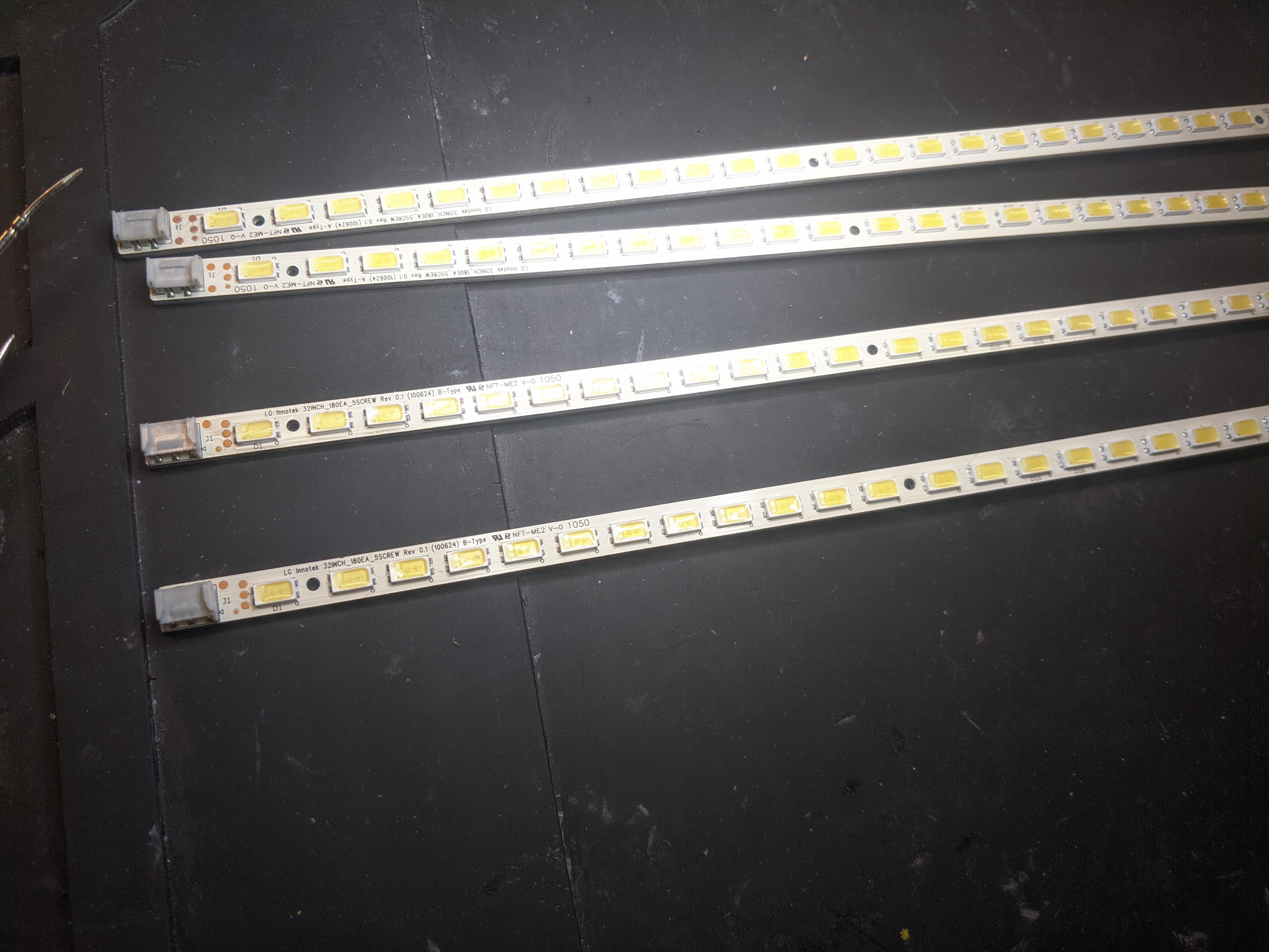

                          • unimatrix93
                            • Oct 2021
                            • 347
                            • Magyarország
                            Originally posted by Diah
                            seem you didn't understand my post#5 yours set just 32 take the screen out and there you will find the issue at LED BL
                            Sorry, I just removed the display and checked the backlight.
                            Backlight LEDs seems to working fine, however they light up in sections with my led tester.
                            This tv has edge backlight.
                            Maybe I should check with my bench PSU too?

                              Take picture of lights when lit. Sometimes to blinding to see one is dim or out when they close together on edgelit maybe
                              • Diah
                                • Feb 2013
                                • 6404
                                if the edge LED are double LED then there are zener diode build in.. if it get open or short PSU turn off but the tester light them on...
                                test each with DMM in diode mode

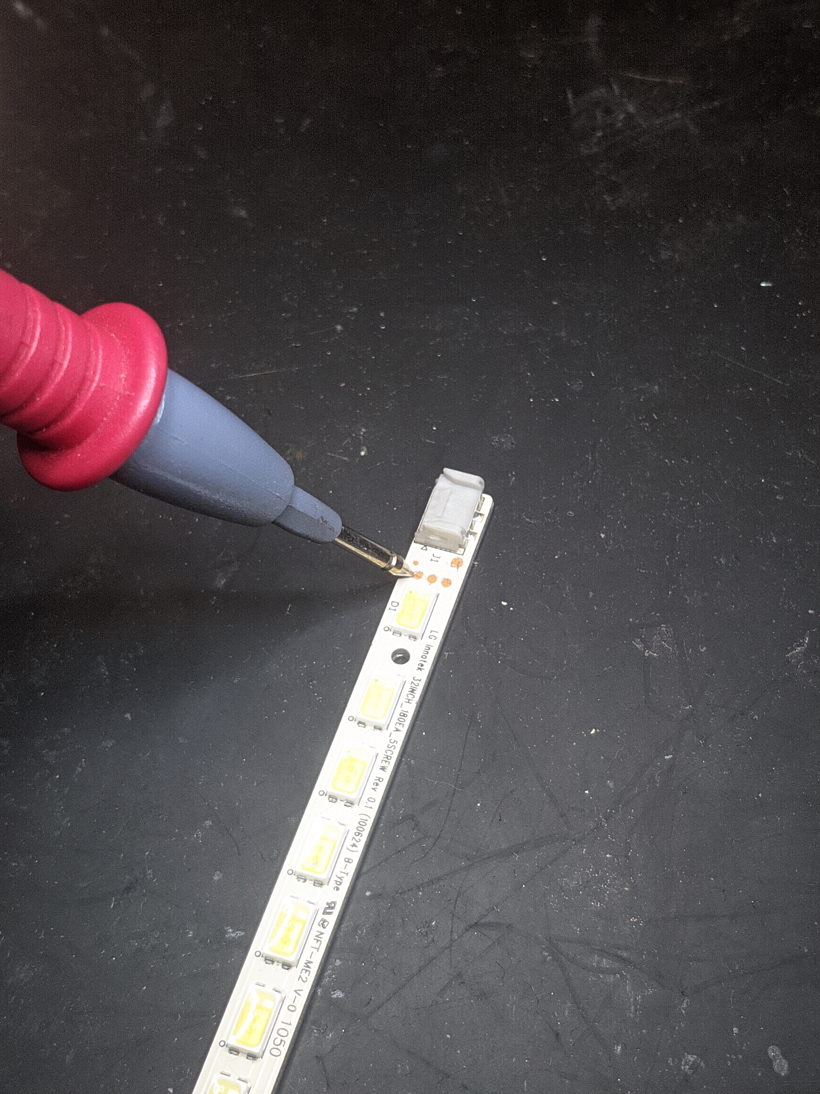

                                  I took out the backlight modules and tested each led diodes one-by-one with my PSU and with my DMM in diode mode. The LEDs are 6V and the voltage drop in diode mode were 0.775V so I guess they are fine.
                                    Can you power each strip seperatly and see what each strip is using voltage and amps wise
                                    • unimatrix93
                                      • Oct 2021
                                      • 347
                                      • Magyarország
                                      My bench PSU only do 30V/5A maximum. However I can measure the voltage of the 3 segments with my tester.
                                      I can turn on the segments one by one by touching the black probe to the 3 test points on the board.
                                      Each segments uses 90-91V.
                                      I test the other 3 board in a minute.
                                      • unimatrix93
                                        • Oct 2021
                                        • 347
                                        • Magyarország
                                        All of them uses the same voltage.
