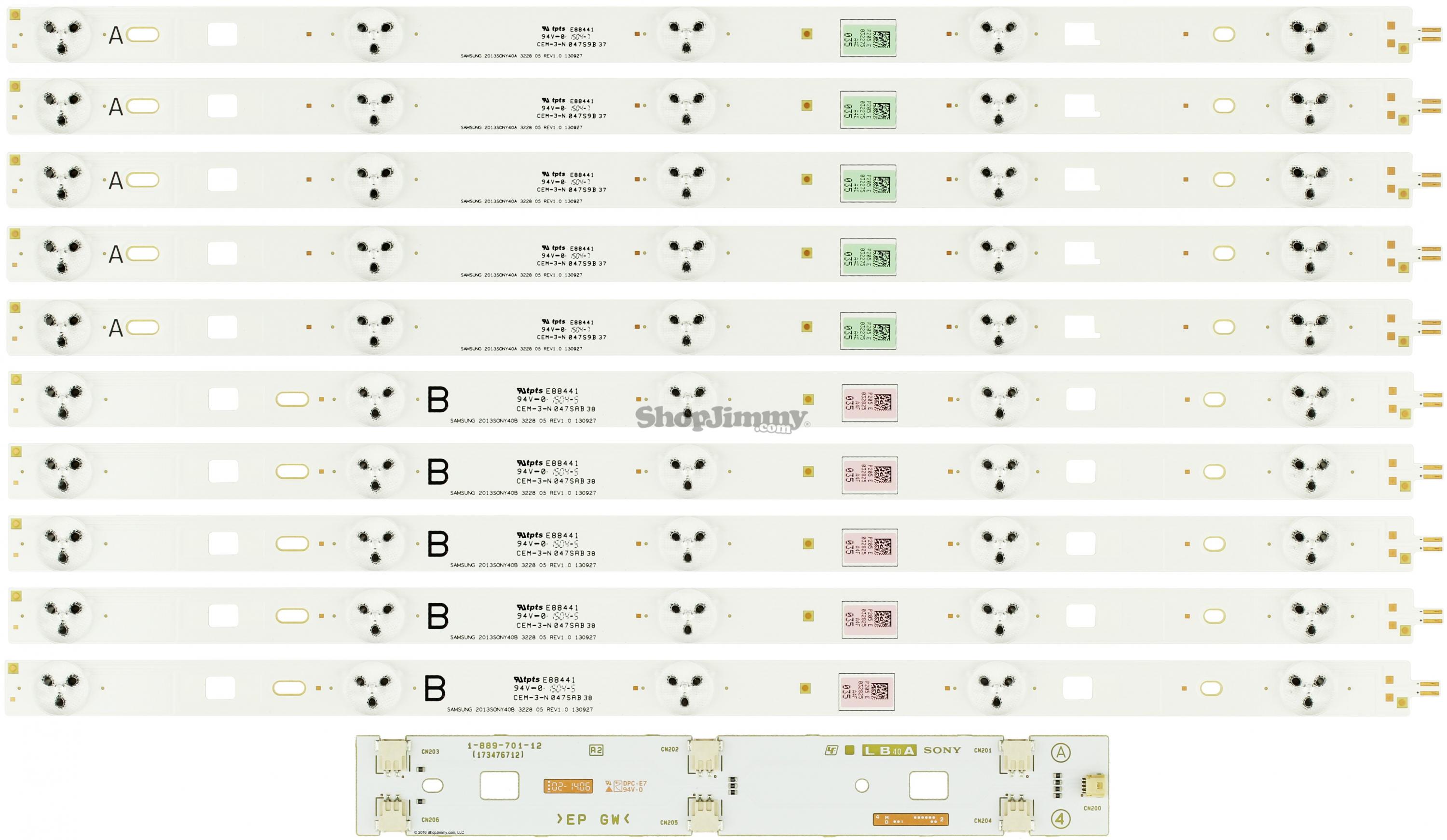

                              Shopjimmy is out of the led strips but they have a picture. Looks like the strips plug into a center board that then connects to the led drive voltage.
                                Well, I just re-seated all the LED strips and connectors and put back it together.
                                There is 5 A Strips and 5 B Strips and they connect to a board in the center. The board in the center has 2 connectors on it from the LDHM. So far so Good but time will tell....
                                https://www.ebay.com/itm/KDL-40RM10B...MAAOSwzppZ9pAG

                                    Re: Sony KDL-40W600B 6 blinking lights
                                    Did you take the picture showing how the LED strips are connected to the junction board?
                                    There are 10 strips but only 6 connectors for the LED strips on that junction board.
                                      That picture I posted was from shopjimmy, his may have looked like this
                                        Thanks RJ, I saw only one junction board at SJ, but it actually has two junction board so now that makes sense. I have one to work on this week end.
