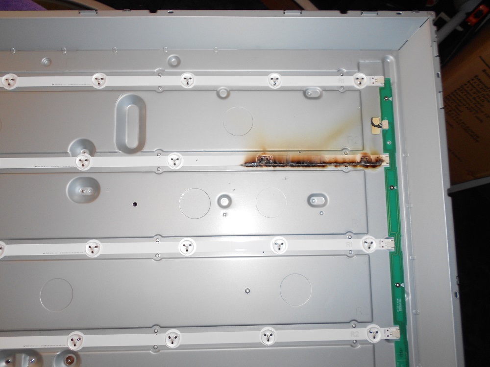

          There are at least two seperate strings of leds and each string seems to have 5 led strips, if one of the strips has a loose connection it will not stay lit. and post an error.

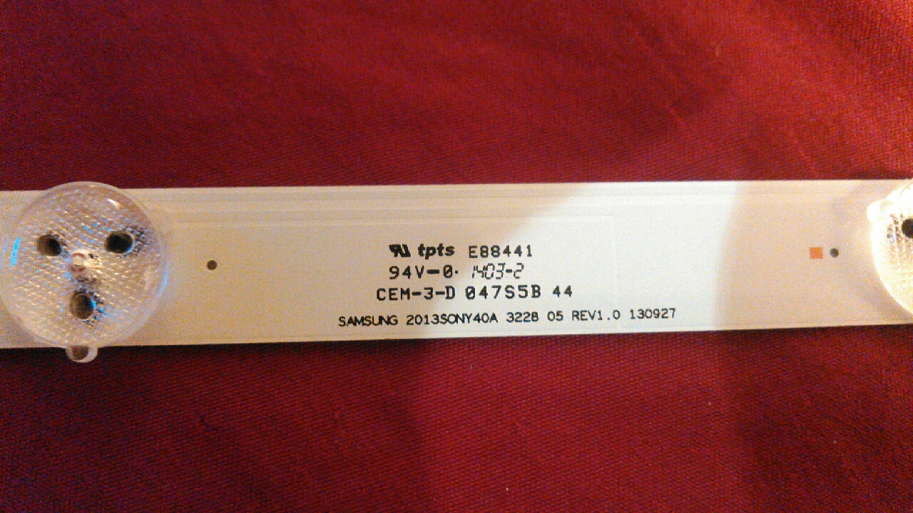

              Originally posted by R_J
              That picture I posted was from shopjimmy, his may have looked like this
              Yes, That's it, exactly

                    Likely worried about this, and I have seen a lot worse, I've seen the white reflector sheet with a 4 inch strip burnt into it

                              Well, this was indeed the case: one of the B strips had 2 burned LEDs (out of the 5). I replaced the LED strip today, and so far so good.
