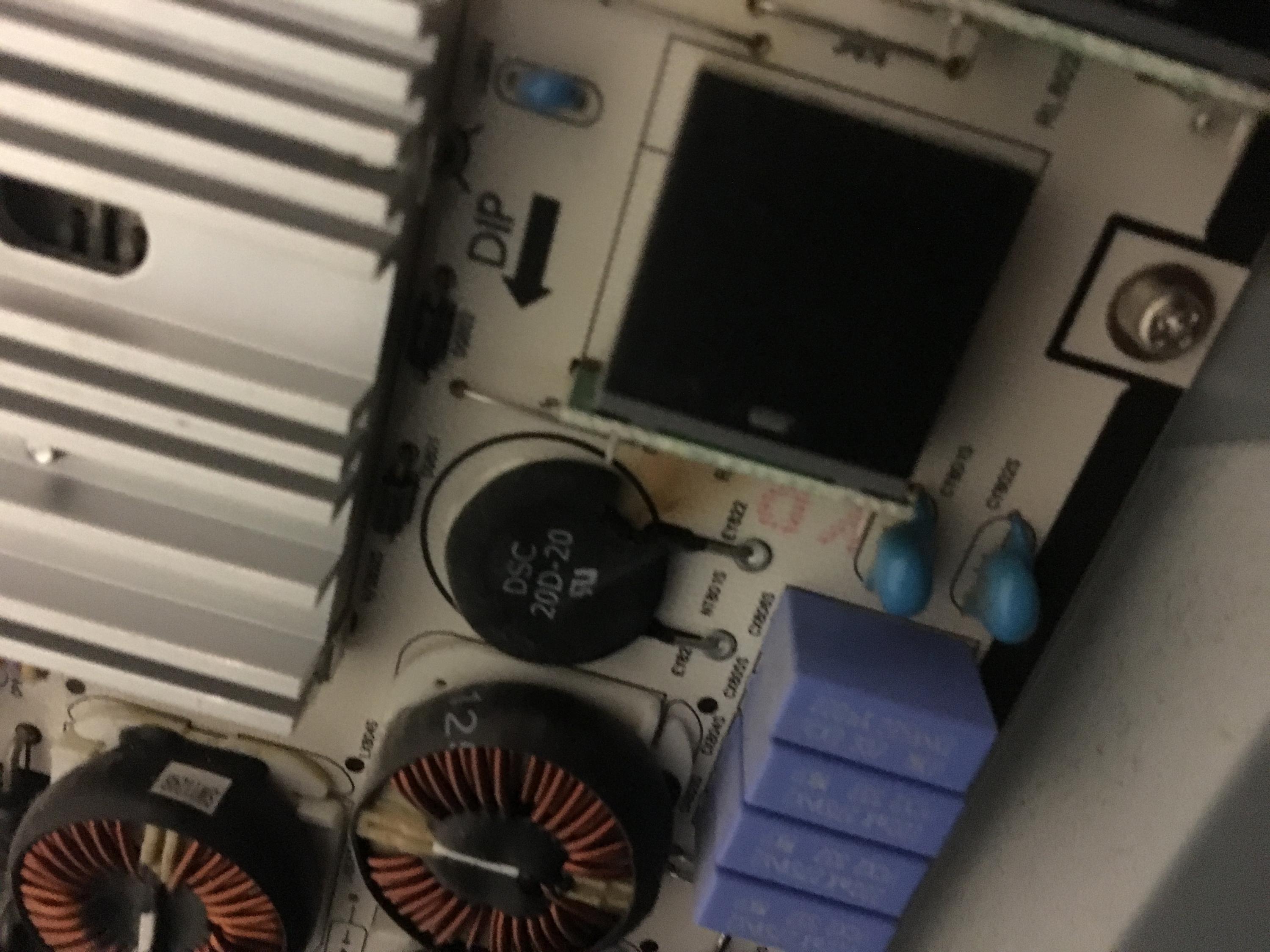

        This is the thermistor that blew. I'm going to pull the board and see if I can see any other damage.

          Sorry, didn't attach the image. DSC 20D-20 Thermistor. See the blow hole on the bottom right side.

            Re: Samsung PN64D8000 - Power Supply Board Issue?
            Ok, that one is the thermistor, Also check the resistance across the blue mov's maybe one of them shorted also, if not just replace the thermistor and don't forget to check or resolder those connections I mentioned.

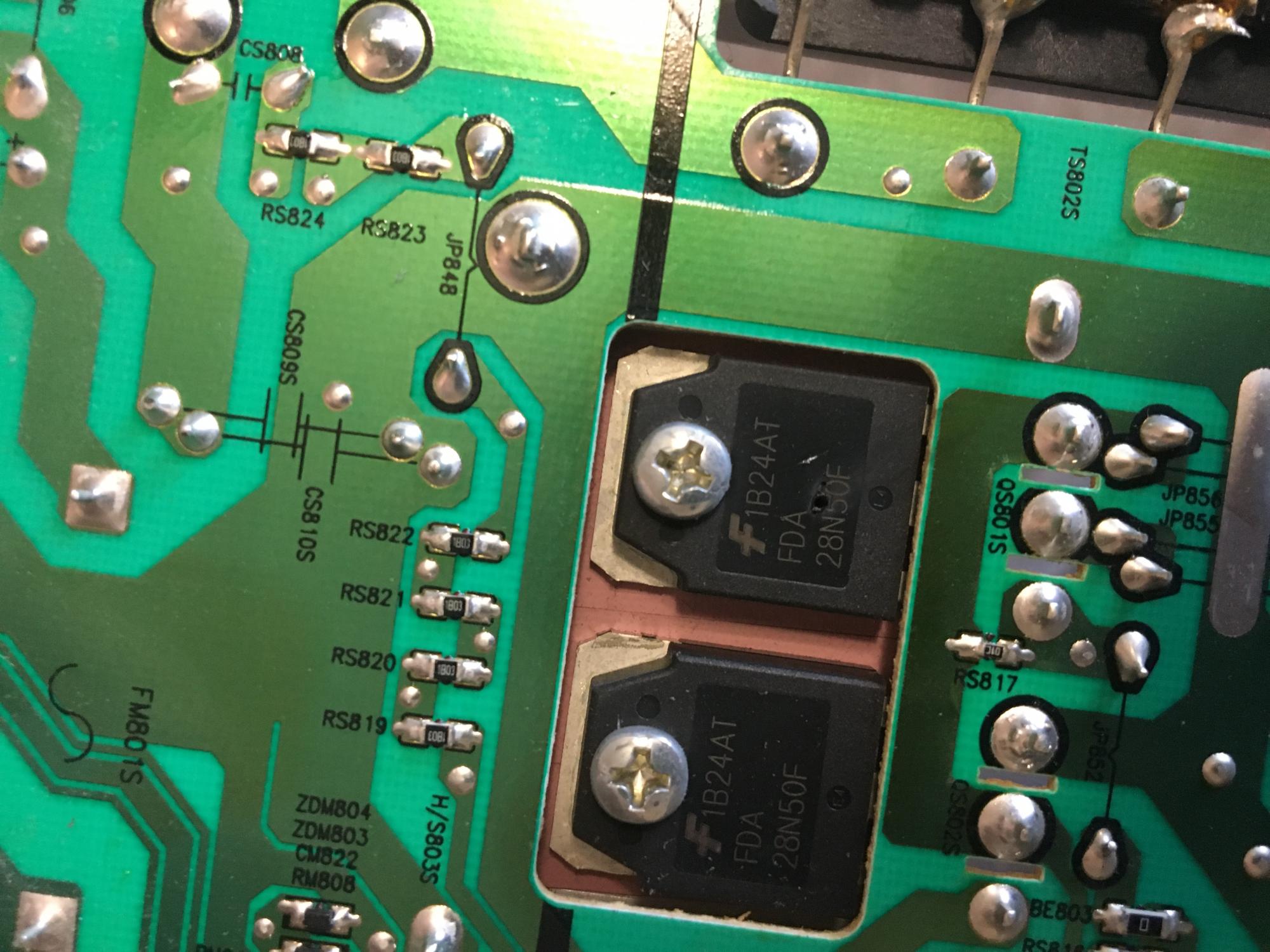

              Also have a blown MOSFET. See the pinhole and the char mark.
              • R_J
                • Jun 2012
                • 9624
                That would do it. Did you have a look at those other connections for cold solder joint? I bet one of the connections on TS801s primary is bad.
