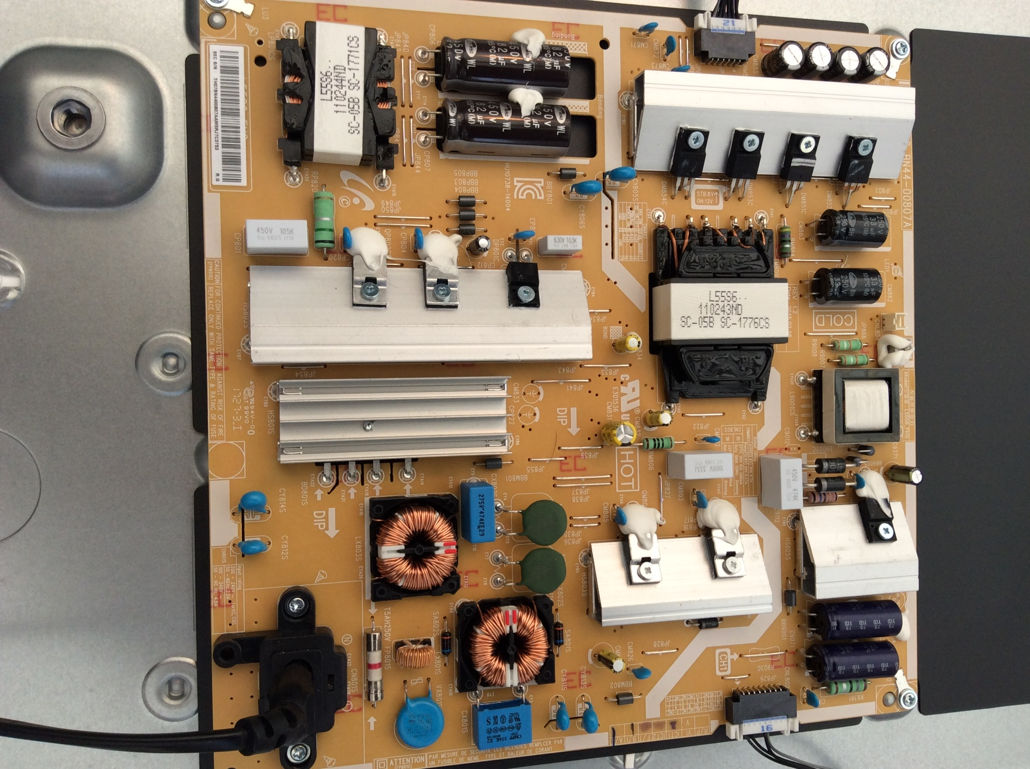

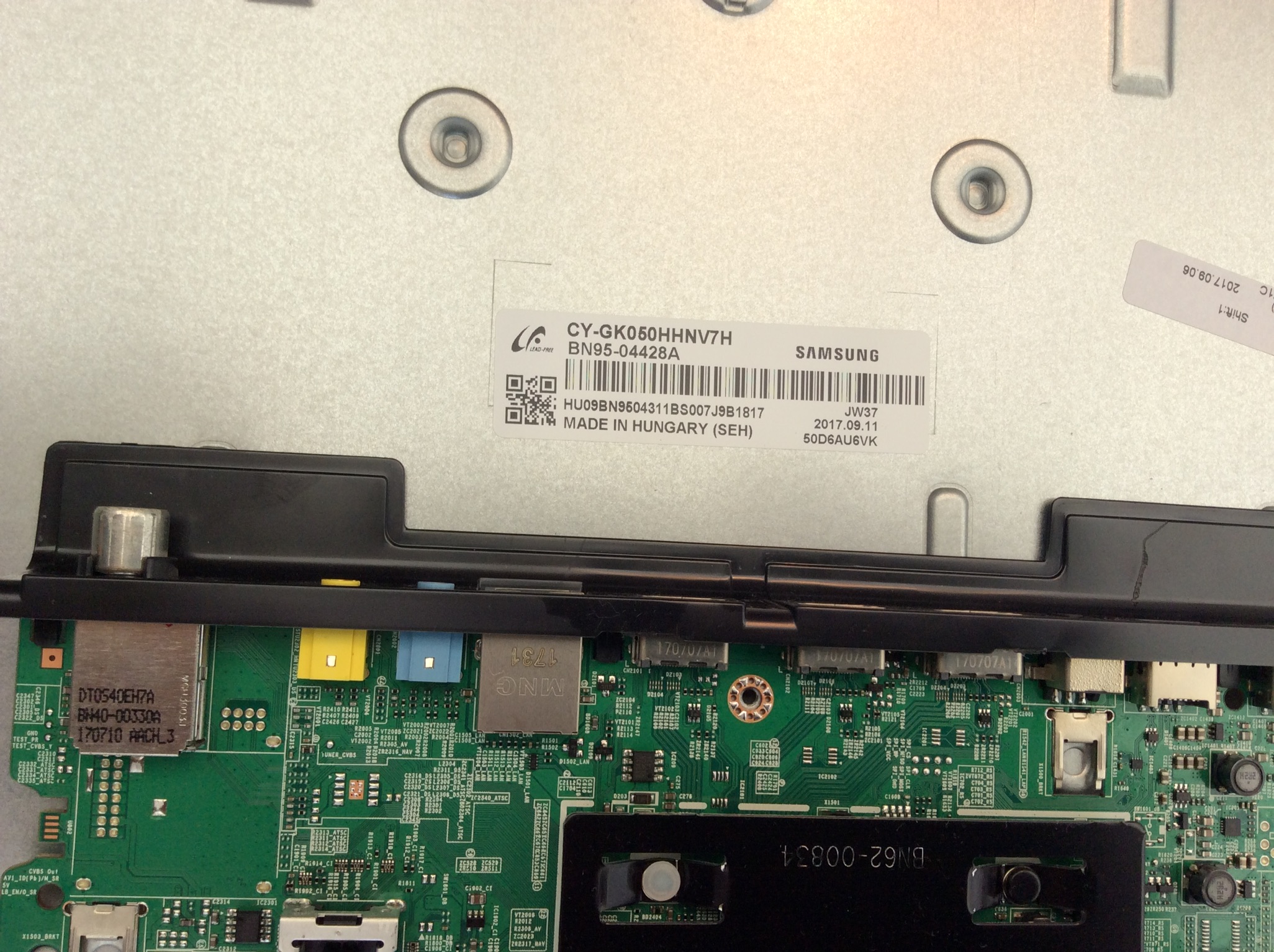

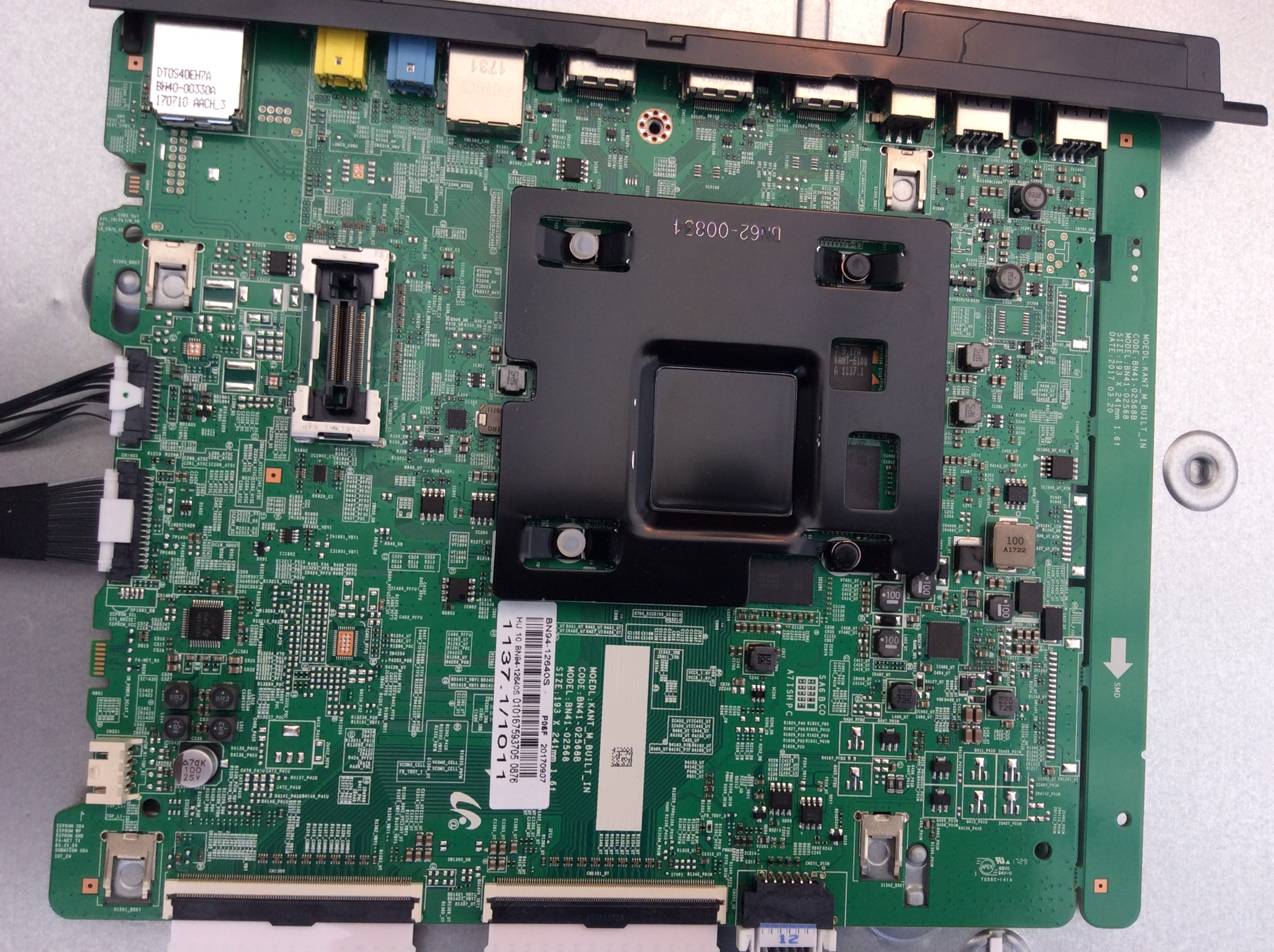

    Hi guys been a while since I have asked for help!
    Right I have a Samsung ue50mu6120k, when you power it up the screen flashes randomly, the front led goes off and on, I read about leaving it plugged in for 4 hours switched on connected to the internet, hoping it will update but nothing has changed.
    I dont know what firmware it's on or anything as I can't get anything up on screen to find out, tried info-menu-mute-power doesn't seem to work. Can I update using a USB stick even though I don't see what I'm clicking?
    I have checked voltages and they all work out right, ok if I disconnect the lvds cables from the screen the leds stay on also if I unplug the main from the PSu
    I have checked all tab bonds and they look fine no burns and I have checked for shorts on screen pcbs no whilst the screen flashes the 3.5v to the psu drops out and comes back, I have read another user has the same fault after software update so I'm rather hoping that's all it is what do you guys think?

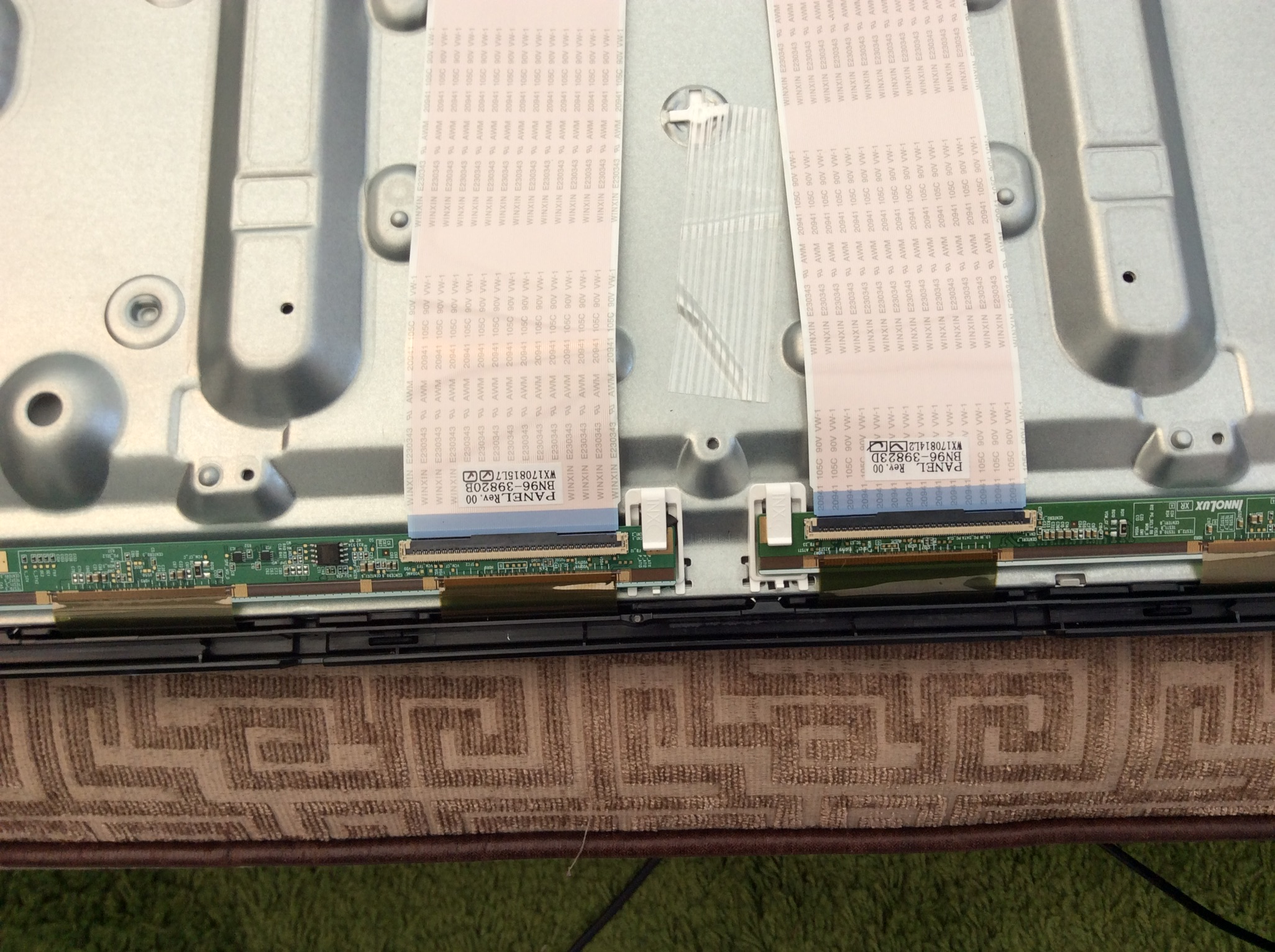

            disconnect just one of. the tcon to panel cables... what is the result? try just the other one.

              Re: Samsung ue50mu6120k
              Can you then hear audio if you raise the sound. May have to try the different inputs.
              Also if only one of the cables from the Tcon to the panel is disconnected, will the set come up with half a picture and if not reconnect and then disconnect the other ribbon going to the panel.
              (There's no photo of the Tcon so I don't know how many ribbon cables there are to the panel.)
                Tried that say left side leds still flicker disconnect left plug in right leds stay on no picture not even half
                  Haven't tried sound as the whole set is switching off I will try again tomorrow tried the ribbon thing and one side lights flicker and set restarts other side leds stay on, there is no tcon its direct to screen it's straight mainboard to screen pcbs

                    You say that with the LVDS cables removed the set stays on so it would be interesting to see if the mainboard is functioning. ie sound.
                    If it's one of the LVDS cables resetting the set then it may well be a panel fault or one of the capacitors gone faulty on the integrated tcon shorting one of the tcon supplies.
                      Yes Dick I checked all caps and I'm going to check resistors they are placed as e.g R131 C131 and only one place so its going to be tuff not knowing it's a cap or resistor there was a few that showed up s/c but not sure if they are across anything else lol
                        Just an update it was a cracked screen in one corner and a damaged edge tab bond removed it panel showed picture and a 1inch crack oh well got some parts and set of leds for £40
