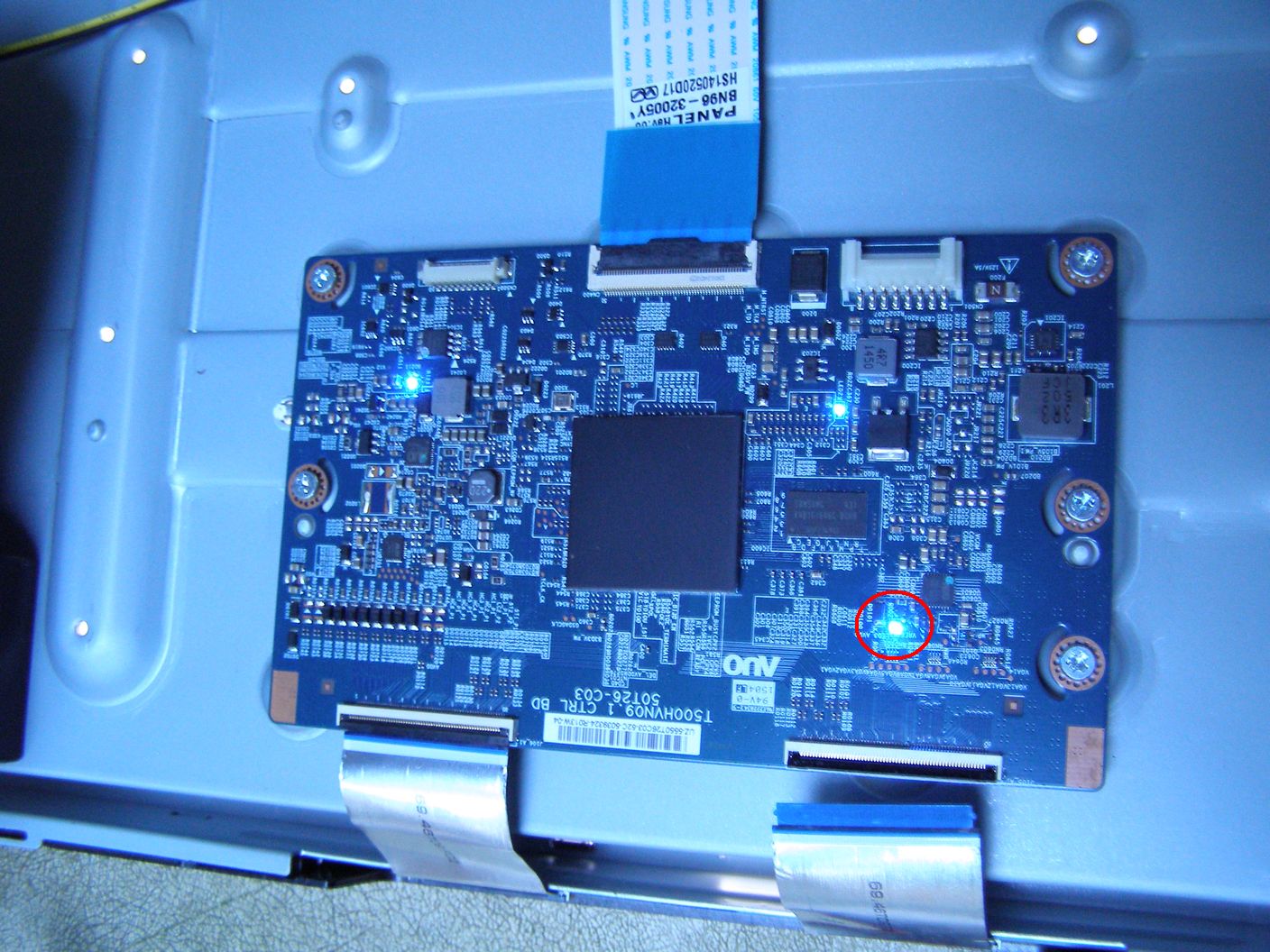

    I have a Samsung UN50H6201 that stopped working for no obvious reason. There is backlight but no picture. I replaced the power and tcon boards since it cost me less than $20. (Please spare me your lecture on "throwing parts".)
    The replacement tcon board the three lights came on, as normal. When I looked at the screen it was operable but there were many lines in it near the center. A minute later the VREF light on the tcon board then went out and it went back to backlight and black and no picture. So I obviously blew something on the tcon board but I can't figure out what.
    One thing I did figure out is that if I have right LCD ribbon disconnected and left connected that half the screen works (no lines) and the other half turns white, and the VREF light on the tcon board comes back on. OTOH if I have left LCD ribbon disconnected and right connected it is backlight and black and no picture on either side.

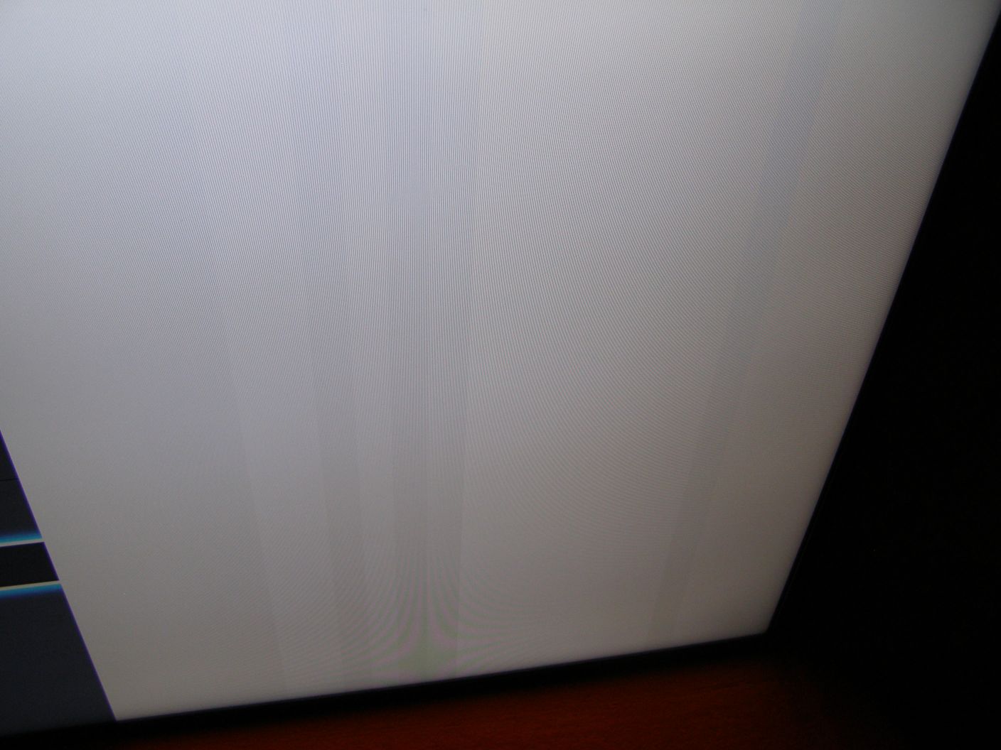

          post a picture of the full screen when you get the "half working screen" situation. That will indicate more about the panel problem.

                  I checked the boards that the ribbons from the tcon goes into. There are two boards, one for each side of the screen. They are hidden under the bezel. They have the ribbons going into the LCD. In the pic I posted they would be at the very bottom.
                  I don't suppose anyone has the service manual for this model? I will take a picture of the boards and the screen and post it when I have a chance. Thanks for all the suggestions so far.

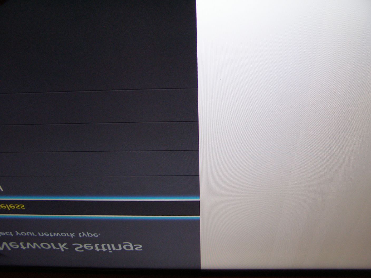

                    I haven't had time to work on the TV this summer. I'm thinking about listing it for free to see if someone wants it. Just to confirm I did check the tab bonding boards for capacitor shorts but didn't find any. I took pictures of the TV which are attached.
                    They show when only the ribbon for the tab bonding board on the right side of the screen (left in the pictures) is connected. (Otherwise the TV is all black and the VREF light on the T-Con does not come on.) Note also I was testing a different main board (UN50J) when I took this pic so the picture is flipped but it otherwise the same with the UN50H main board.
                    If I flex the tv at the bottom (the top in the pics) like from side to side a little the white bars will disappear while that side of the screen will slowly fade to black on its own and then after a second come back to white with the bars. Do you think this is worth any more time?

                      IF there are tabs along the side, then it might be possible to save the set by removing those as they potentially have a problem with them based on your "cable removal test".
                      IF there are no side tabs, you might still get "lucky" using the "tape cutoff method" which uses a bit of tape on the tcon connector to block some of the pins that are driving that side of the screen.
