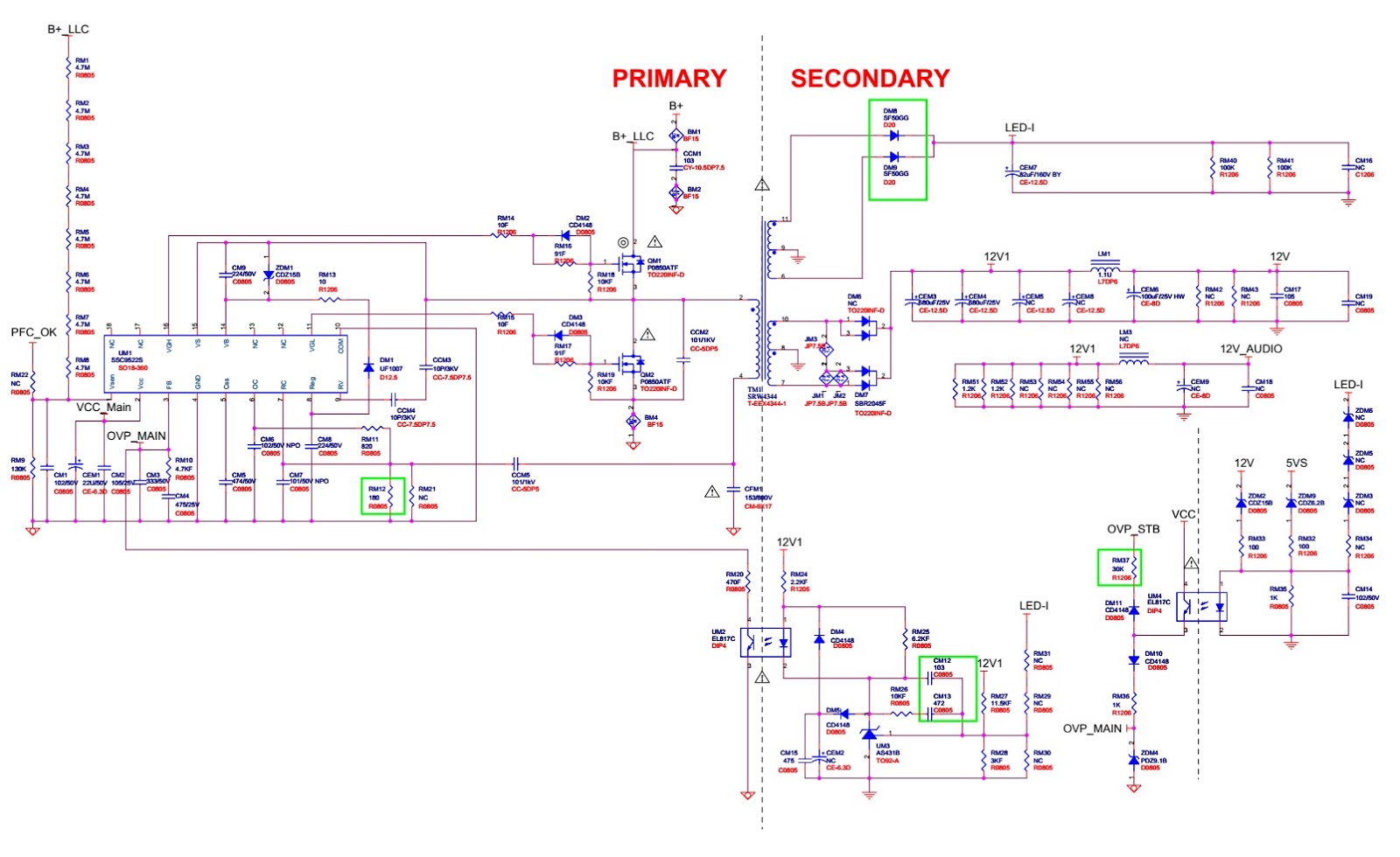

            Another thing to check is on IC7601, what is the voltage on pin 1?, Vsense. You should have about 1.4 volts (to hot ground), if you do not, check J7035 (0Ω) and those high value resistors, R7605,R7606, R7621, and maybe check the R7801,7802,7803 also
            I know on some tv's these high resistance resistors can go open, there usually are 3-4, 1+ meg Ω in series
            Here is a circuit from a Toshiba power supply that uses the same ic

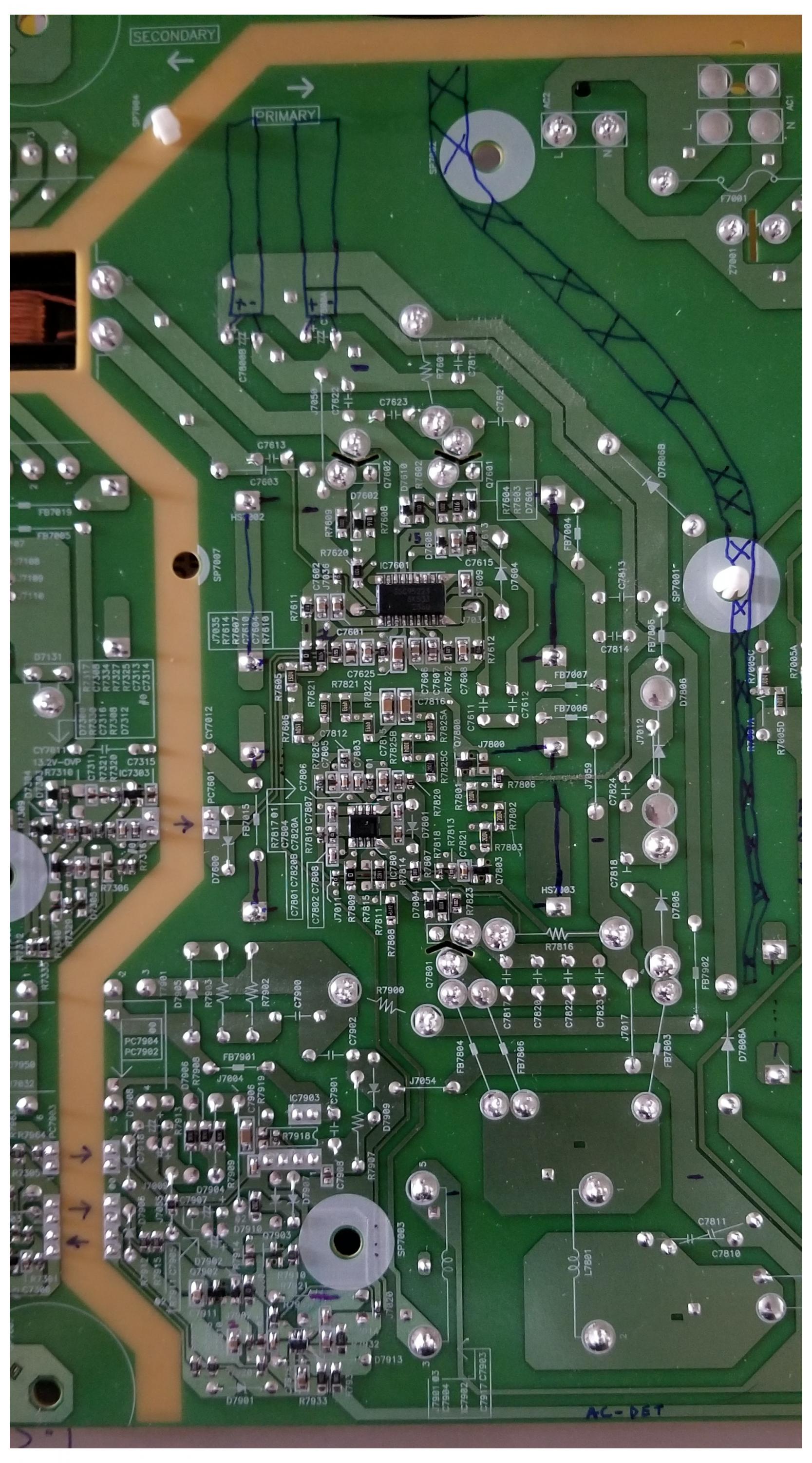

                    I replaced the IC7601 (ssc9522s) on the board but it hasn't fixed the issue.
                    With the board connected to other boards on the TV, the behavior has changed. There is no sign of life...no flashes or anything. Only thing is that I could hear a short soft click every 11 seconds from the main transformer. It appears that the main board is sending the PS_ON signal repeatedly now.
                    With the board on the bench, when PS_ON is supplied, the UR13.2 pin has a momentary voltage ~10V and rapidly falls to 0 V.
                    The voltages on the pins of ssc9522s IC7601 have also changed after replacing the IC
                    Vsense (pin 1) = momentarily 0.5V and then falls to 0 V
                    Vcc (pin 2) = momentarily 5 V and then falls to 0 V
                    I tried to trace the voltages feeding into Vsense. It seems that my meter (in DC voltage range) is affecting the circuit because when I lift the probe from R7606 1.5Mohm resistor the voltage drops from 137 V to 0 V (after touching probe back to the same point!)
                    Any thoughts on what I should check next?

                      I don't know, when you turn the board on what does the voltage on the large cap C7800a/b do? it should be 160 volts in standby then rise to 400v when the pfc starts. Just to be clear you are using the hot ground on the primary side to check voltages right?
                      Is that picture of the ic before or after you changed it?
                      Check the voltage on PC7601, secondary side, you were getting 0 before, is there voltage there now?
                      Am I correct that you had no ur13 before and now it comes up albeit low.
                      It seems like that power supply section is trying to work but is shuting down. Before you did not get any secondary voltages off that transformer right? what do you get across C7200a or b now?

                                To take the idea of a protection circuit a bit further, it seems like the Vsense and Vcc (on the oscillator IC ) fall to 0 V which effectively disables the IC. So if I trace backwards, the voltages seem to come from the area near the 3 opto couplers at the bottom.
                                The lowest one PC7902 feeds from PRIMARY to SECONDARY.
                                The other 2 optos PC7903 and PC7904 feed from the secondary to the Primary. I suspect one of these two will lead me to the problem. What's the correct way to test them?

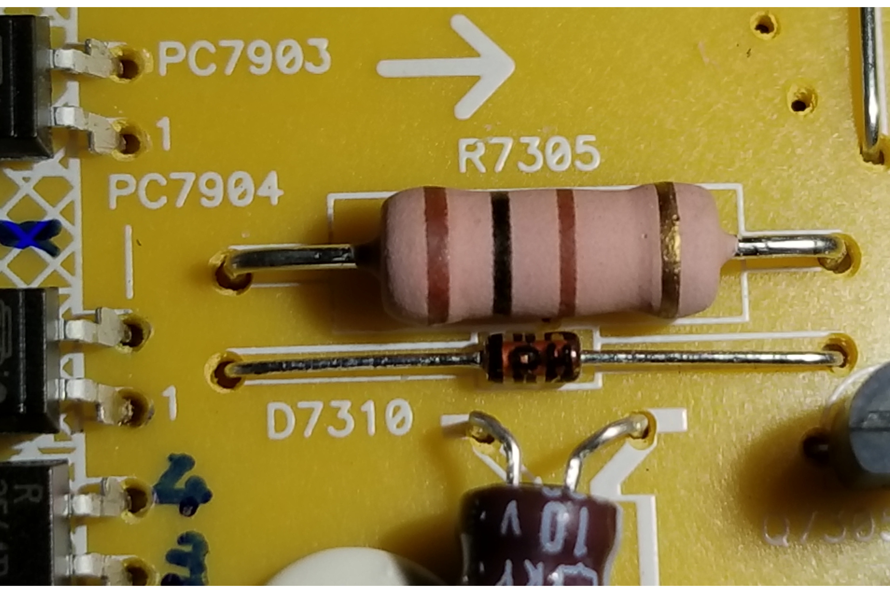

                                      I have some suspicions on D7310 on the secondary side.
                                      Resistance on 2K scale of my meter:-
                                      Forward bias = 0.68 K ohm
                                      Reverse bias = 1.95 K ohm
                                      Does this indicate a problem? I would think the RB resistance would be much higher.
                                      I can't tell which diode it is. The label seems to say PH. Attached picture.

                                        that zener diode is most likely fine. lift one leg and test both ways in diode mode. as long as it is not shorted or open, then your all good.

                                          Thats likley just a 1n4148 diode, not a zener. When you try and measure it the way you are you are measuring all the other components connected to it, If you suspect it, lift one end and use diode test.
                                          There are likely other numbers on it
