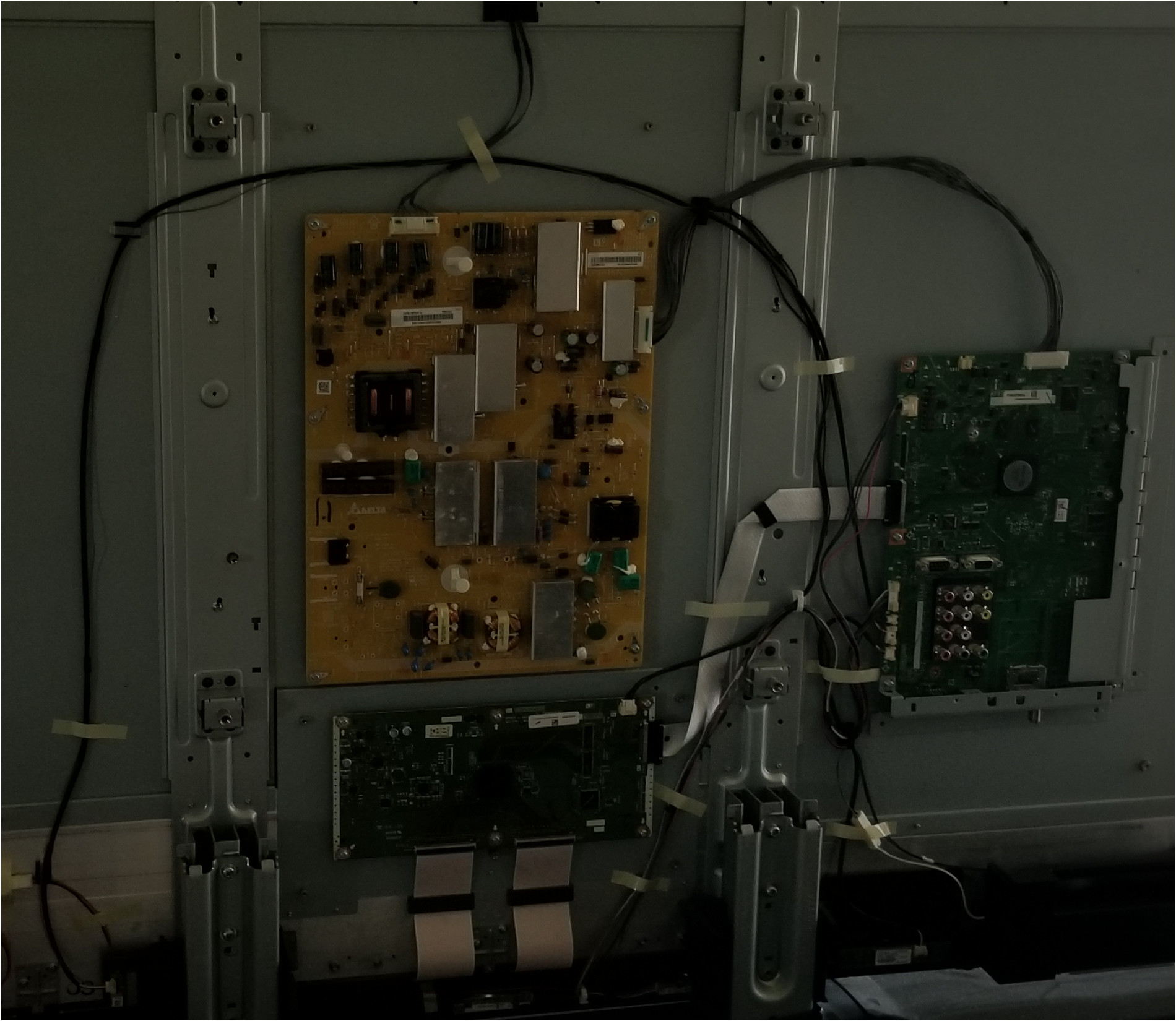

    With the board on bench:-
    Output from Bridge Rectifier BD7001 = 171 V (across output pins)
    No visible sign of swollen capacitors, burn marks or leaks.

    Please give the Voltage readings with all boards connected:

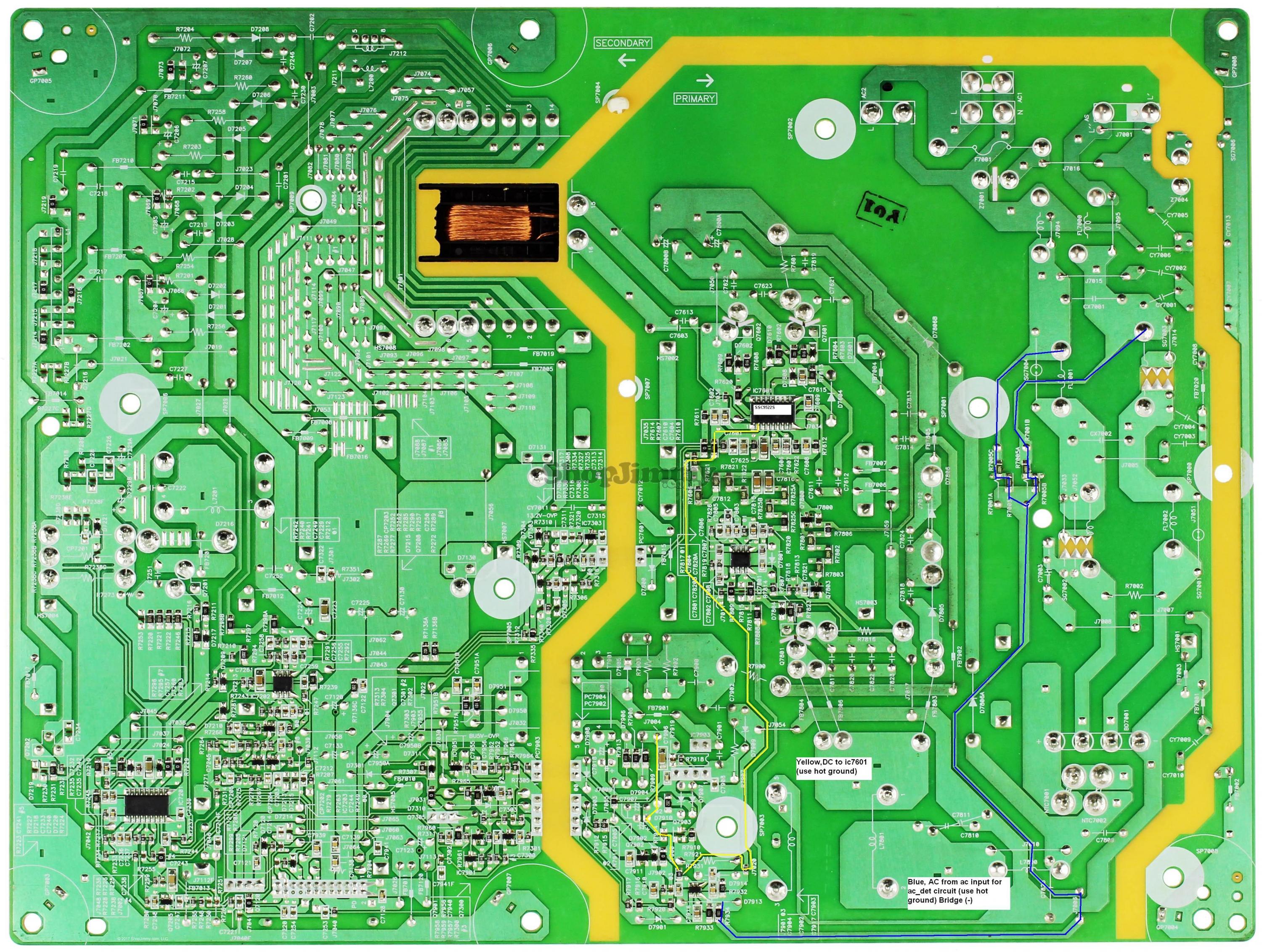

                You won't be able to measure the ac with your meter, its likely around 30-50 khz, The pfc voltage is supplied through that resistor to the mosfets in that circuit. I suspect the driver ic is not being turned on,

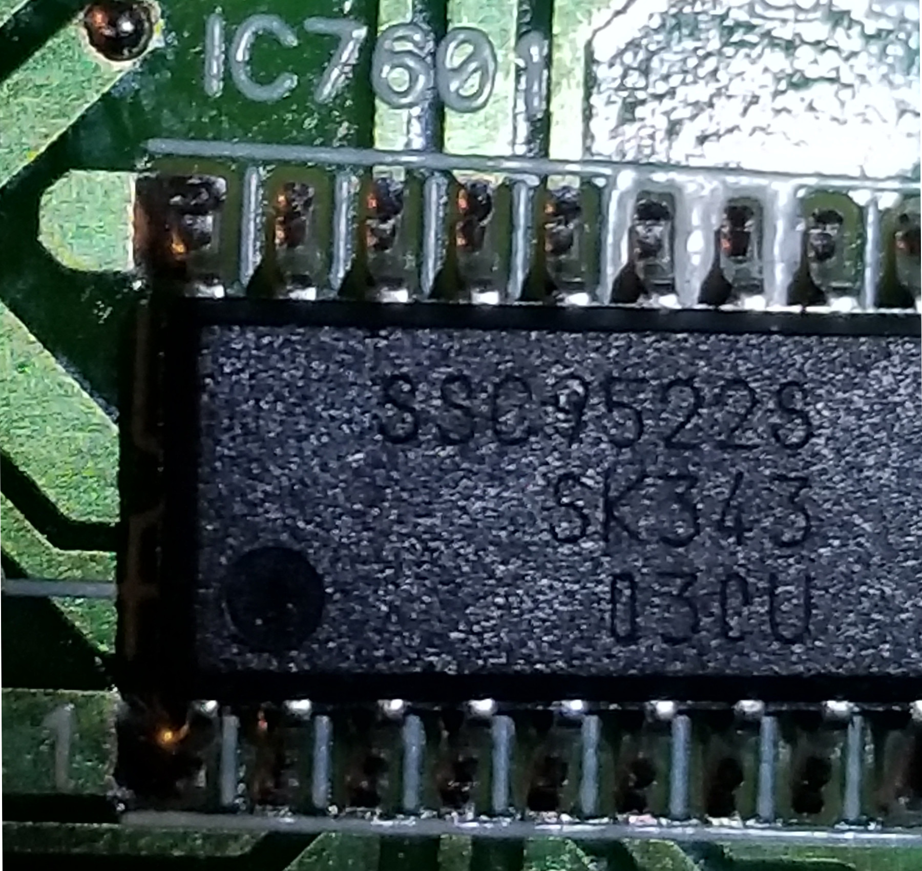

                What is the number on that IC7601, I cant find a schematic for this power supply but there might be a similar one that uses this ic.
                I think ac detect comes via R7001a,b,c&d (1meg each) to J7006, R7934 to Q3 and drives PC7902 opto. Check D7901 (across opto led) it is a zener and maybe got shorted.

                  IC7601 is labelled as SSC9522S SK343 03CU.
                  Trying to figure out if I can test the zener without desoldering. Would measuring the in-circuit voltage across it be sufficient?

                      Thanks R_J. Truly appreciate your input and the efforts you took to draw the circuit for me.

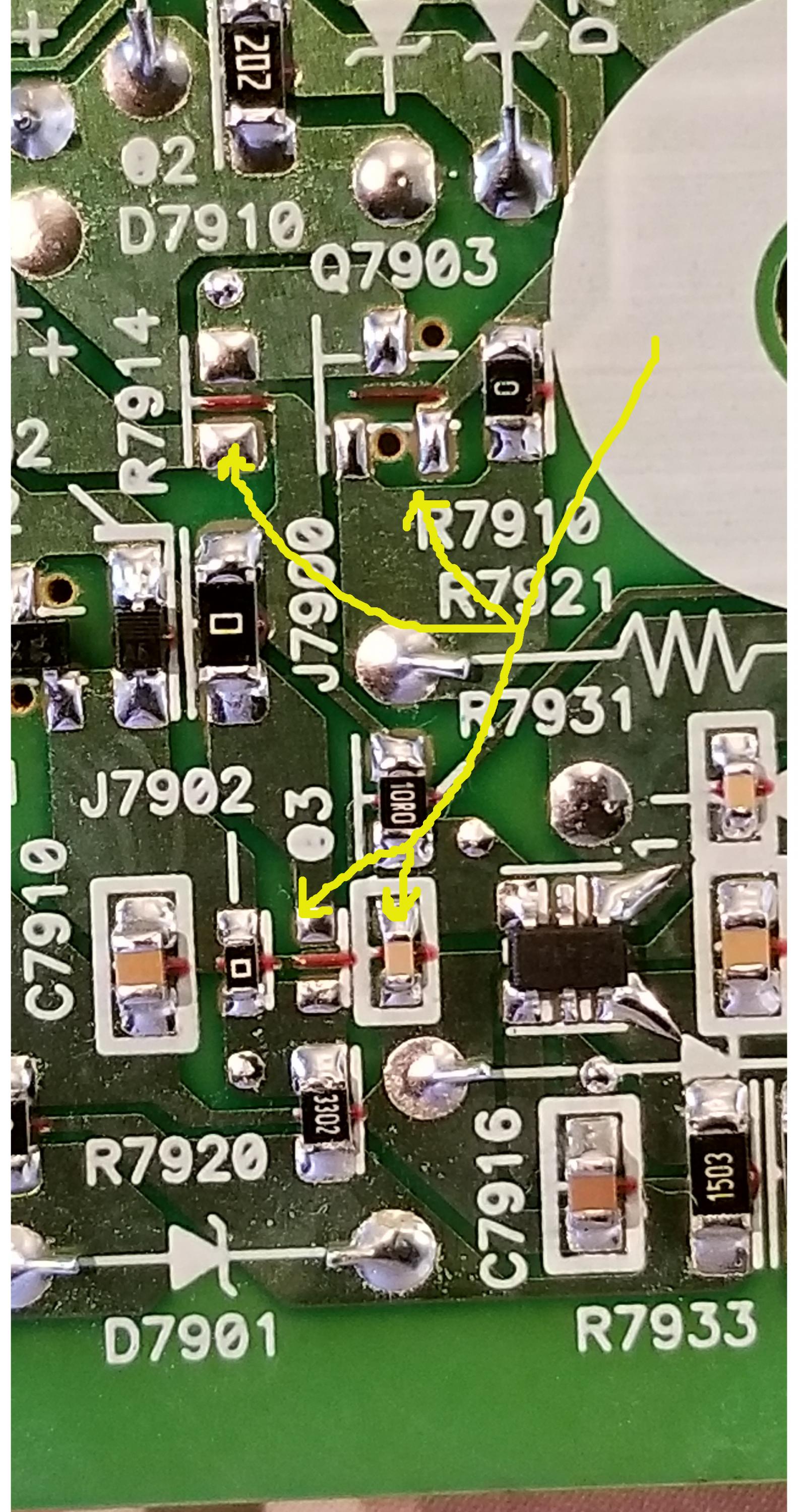

                        I noticed that the PCB has some red sections on top of some traces as well as under some Surface mounted devices. Is that some kind of insulation?

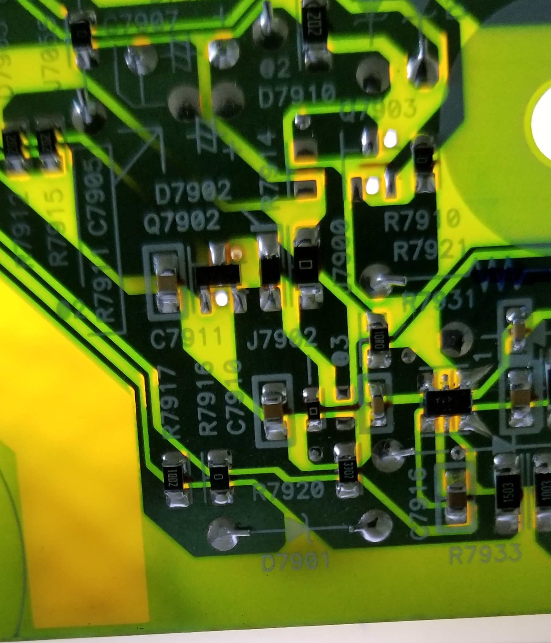

                          I noticed that a small part of your yellow line trace is incorrect. You have it going up obliquely to the left but I was able to confirm that it goes downward (with a light behind the board) Picture attached.

                            The red stuff is glue used to hold the smd's in place during soldering, on this board some locations are not installed, but they still but the glue.
                            I traced it the best I could using the picture, You have the board in front of you I don't

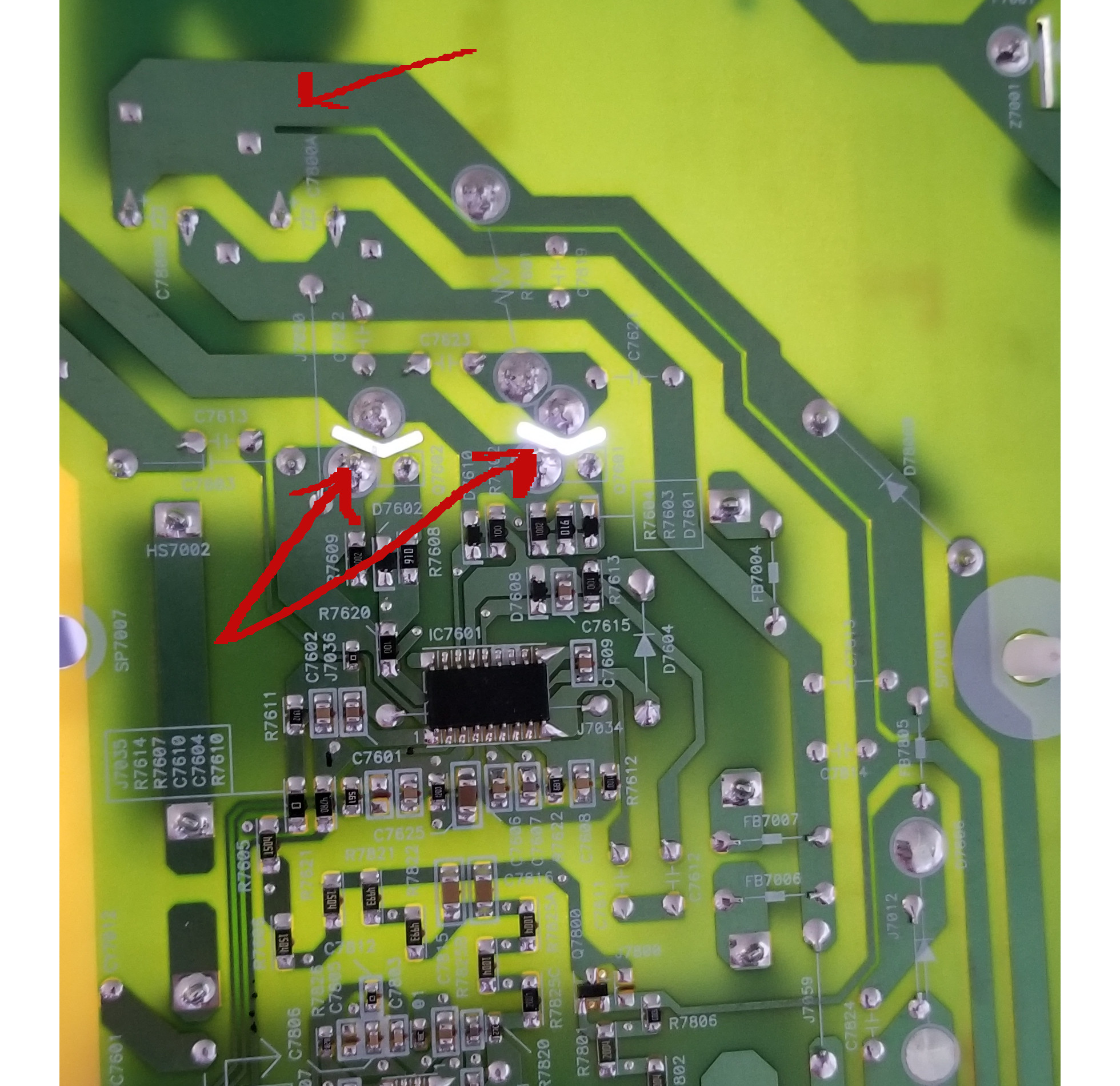

                                    Off-topic curiosity:
                                    I spotted a couple of things on the board ( Picture attached)
                                    1. Why does the trace split into 2 sections with a thin empty line between the 2 sections? Any advantage over one solid trace?
                                    2. There is a chevron-shaped hole under each FET between the pins and the heat sink boundary. What's the purpose of these holes?

                                      pfc circuit is working fine, thats ic7801, Q7601 has good pfc voltage on drain, Source is the other rivited pin (left) gate is the regular trace pin (right)
                                      PC7902 could be pulsing as it is the ac detect opto.
                                      The open chevron is just an air gap to isolate the drain & source pins better. likely to prevent any arcing which might occur due to high voltage pulses.
                                      I don't really know 100% but the wide trace will be to handle the higher current the thin trace provides feedback for the circuit, maybe taping off the large trace closer to FB7805 caused issues so they went this way.
                                      • carsearch07
                                        • May 2018
                                        • 27
                                        Re: Sharp LC 60LE655U 2 long flashes + 2 short flashes
                                        Thanks R_J.
                                        Anything further I can check?
                                        I noticed that the gate of Q7801 is more than 600 VDC! My meter only goes to 600 V DC and it's shows OL in that range between the gate and hot ground. I'm surprised at such a high voltage especially since the largest capacitors on the board are at 400V and also in parallel with each other
