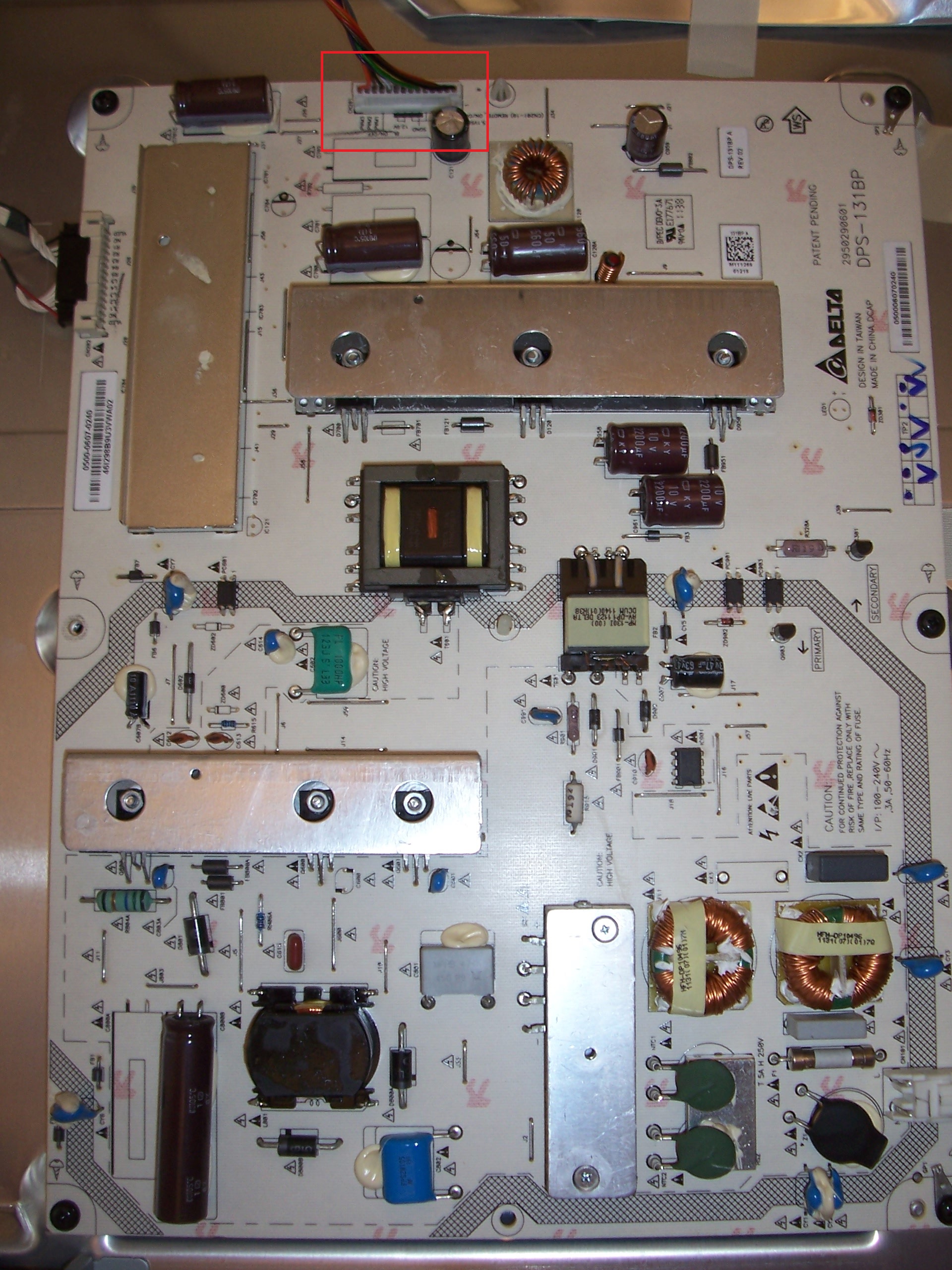

    LG 42LV 4400 Will not come on
    My LG42LV4400 TV will not come on? The red light on the front is on when plugged in but do not change when the power on button is pressed or the power-on on the remote is pressed. Yesterday was fine turned it off with the remote last night and it hasn't come on since. I did pull the back off it to check for swollen caps but none seen. I did check a couple of voltages on the power supply board @ CN201 and found that I have 5v standby but no 12v. Should 12V be present there before being turned on.

    Re: LG 42LV 4400 Will not come on
    You really need to give the pinout number, name and voltage for the connector in the red box.

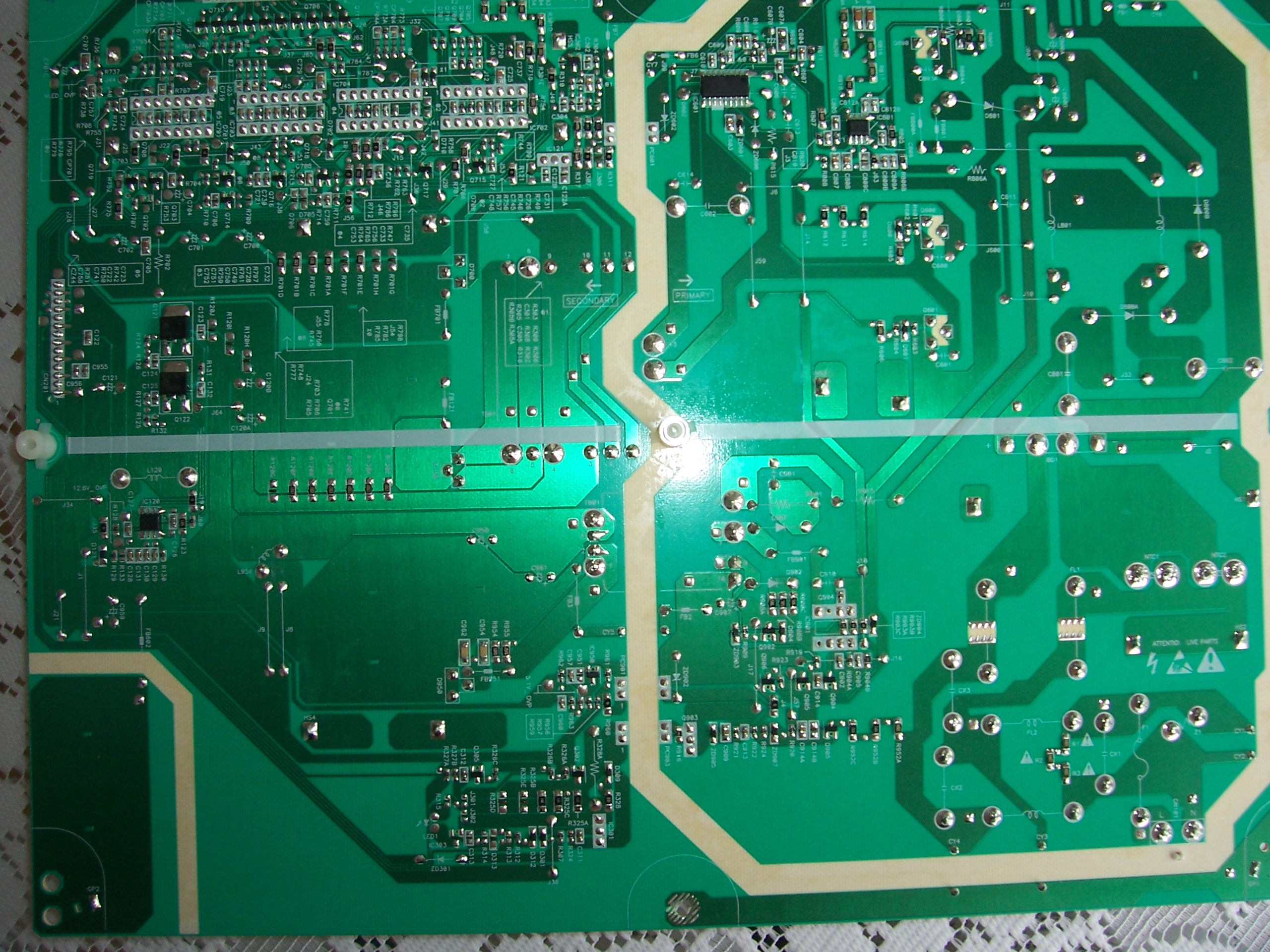

      This might be a little better image
        Please report the Voltage for all those pins except GND pin as request in post #2
        You MUST put down the pin name and follow by the Voltage reading for eack pin when TV is off and when the power switch is activated so we can easily see what it has and does not have in two states.
          Pins 1,2,3 from the bottom is Remote on\off and I am reading 5.2v Pins 4,5,6,7 is SGND Pins 8 &9 is 12.6v and I am reading 0 voltage. Pins 10,11,12 are labeled PWM 1 PWM 2 & PWM 3 BL on\off and I am reading 0 voltage. The unit do not power on.
              Looking like bad mainboard.
                So you do have PS-ON (Remote on\off) to turn on the switched 12V but it is not coming on.
                Please check the DC Voltage right between the two legs of the main filter cap in the HOT side of the circuit, it should be around 380 ~ 400VDC range.

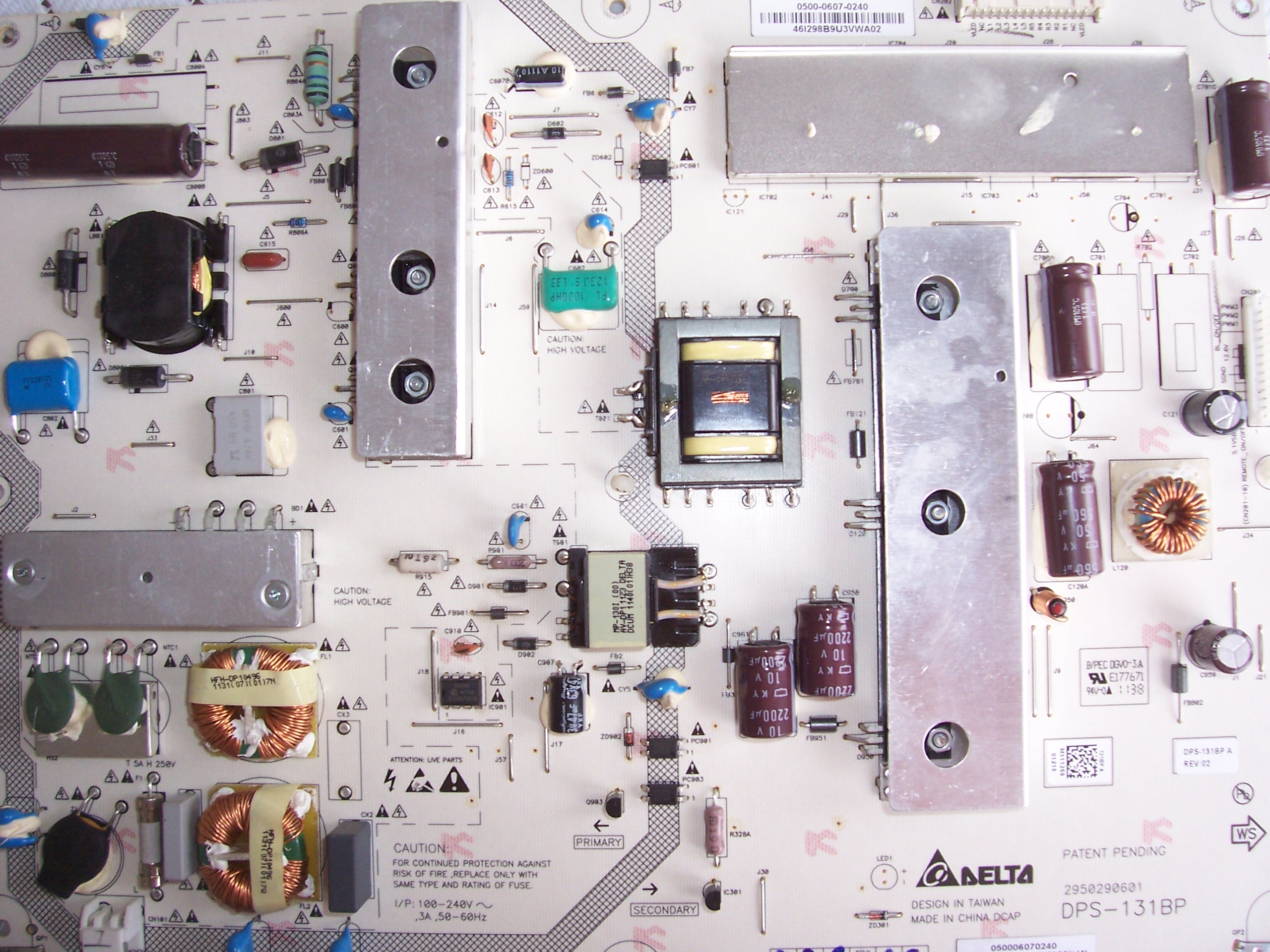

                    Well, that means the PFC Voltage booster circuit is not working, that 12V and the LED power supply section needs that Booted Voltage to run.
                    There are 3 barrel body type Diodes D800A, 800B, 801 close by the main filter cap, check the RESISTANCE in both directions on all 3 of them and report the readings.
                                https://www.badcaps.net/forum/attach...7&d=1528048318
                                Looking at your pictures which are not very clear, it looks like 8-PIN SMD IC801 to the left of D801.
