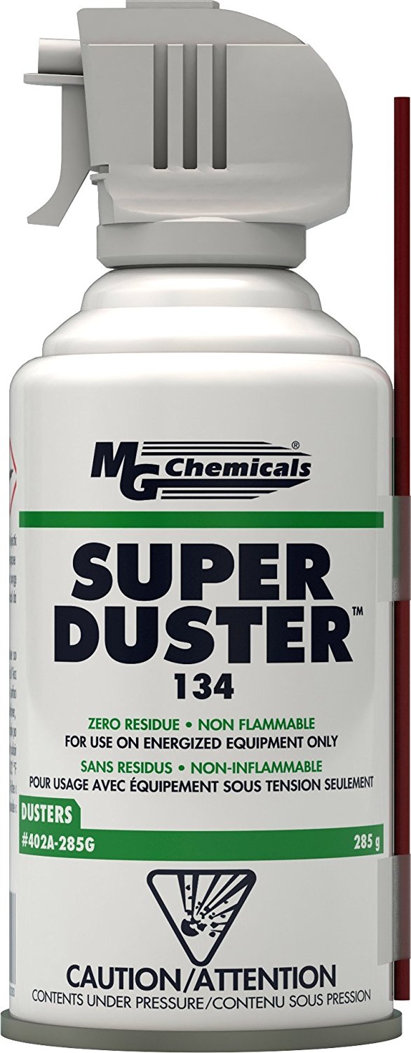

                    • R_J
                      • Jun 2012
                      • 9627
                      #70
                      Re: LG 42LV 4400 Will not come on
                      You can buy freeze spray in a can or use an invertered can of caned air, the liquid propelant in caned air will freeze the ic.
                      The only part that you need to freeze is the eeprom itself.
                      With the tv unplugged, freeze the eeprom, then wait a second or two, plug in the tv and see if you can turn it on, you may need to repeat the freeze process a couple times, but always unplug the tv then freeze the ic. The reason for this is the micro reads the eeprom when the tv is first plugged in, not when the power button is pressed. freezing the ic after the tv is plugged in will not work.

                        #71
                        Tks RJ will give it a try and hope for the best.

                          #72
                          Tried this process with no success? The tv still will not turn on, but I am guessing that don't rule out the eeprom? Any idea what else might cause this symptom
