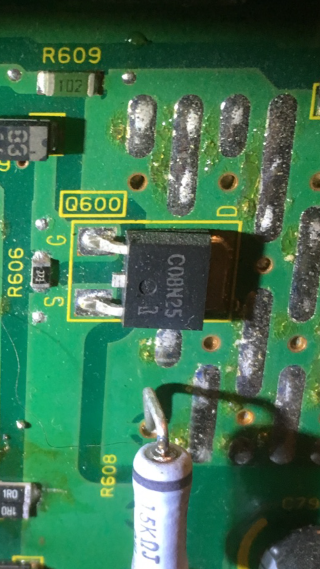

    Trying to attempt to repair my sc board TNPA5335 BG
    found a bad diode at d618 but cant determine its values..can anyone help please?

    If you can post it in focus, it would help to identify it.
    Edit
    Is this a continuation of your other thread and if so would have been better to have stayed on that thread.?????
    If it is then from your previous thread it's marked C08N25 and a search on the internet bring them up.
    There's also some information on this Mosfet in the following thread

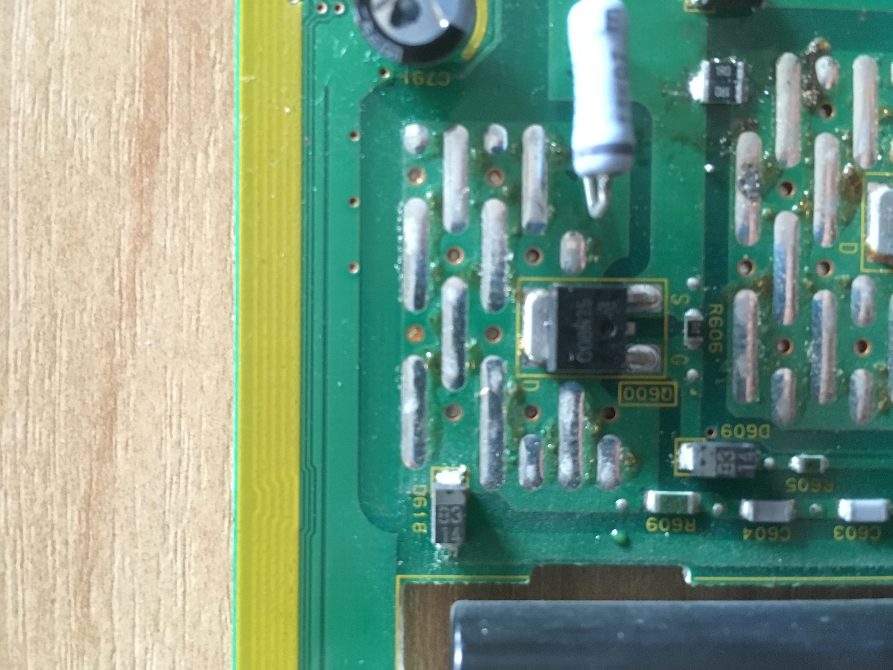

      Re: Diode Identification
      Edit
      its the one in the bottom left with d618 marked next to it
      • R_J
        • Jun 2012
        • 9608
        It could be a RF101L4S, Panasonic pt# B0ECKP000055, but I might be wrong

            Is Q600 still blown apart? You will get all sorts of bad readings with bad parts still on the board.
              yep it sure is.. but d618 is the only diode showing a short
              • jetadm123
                • 2169
                Just remove D618 and check it out of circuit.
                    It could be reading bad because of the bad Q600 is still on the board.
                      I use Fairchild ES1G as a substitute however that one always reads short on the board. After the fake parts usually the 2/3 diodes top right on the board fail ( close to the white prong connector ).
