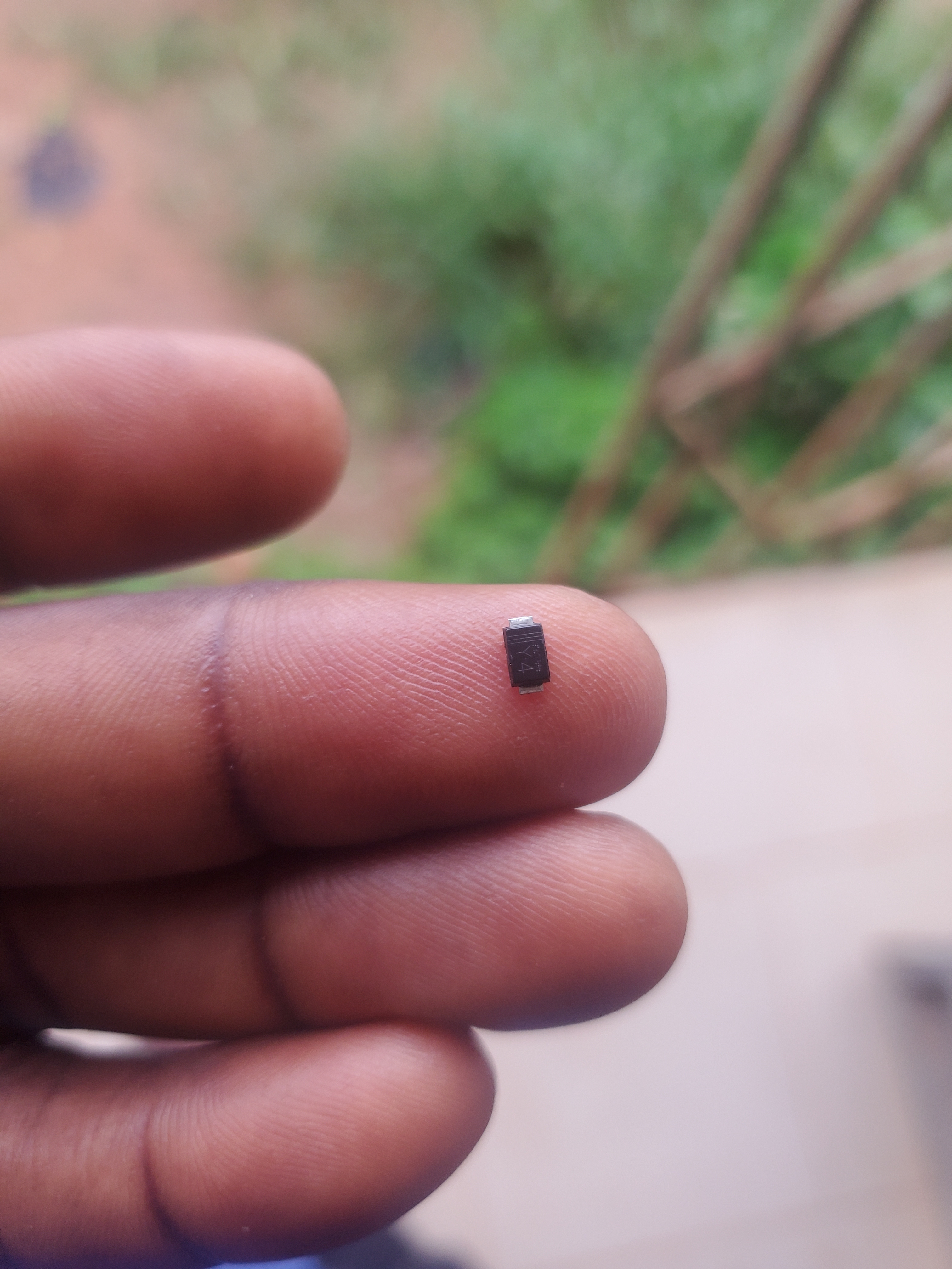

    Please help me identify this zener diode.
    I find it hard to see the datasheet. The diode was found on 14TB 3.5" WD HDD
    I'm looking into having it replaced.
    Pictures attached

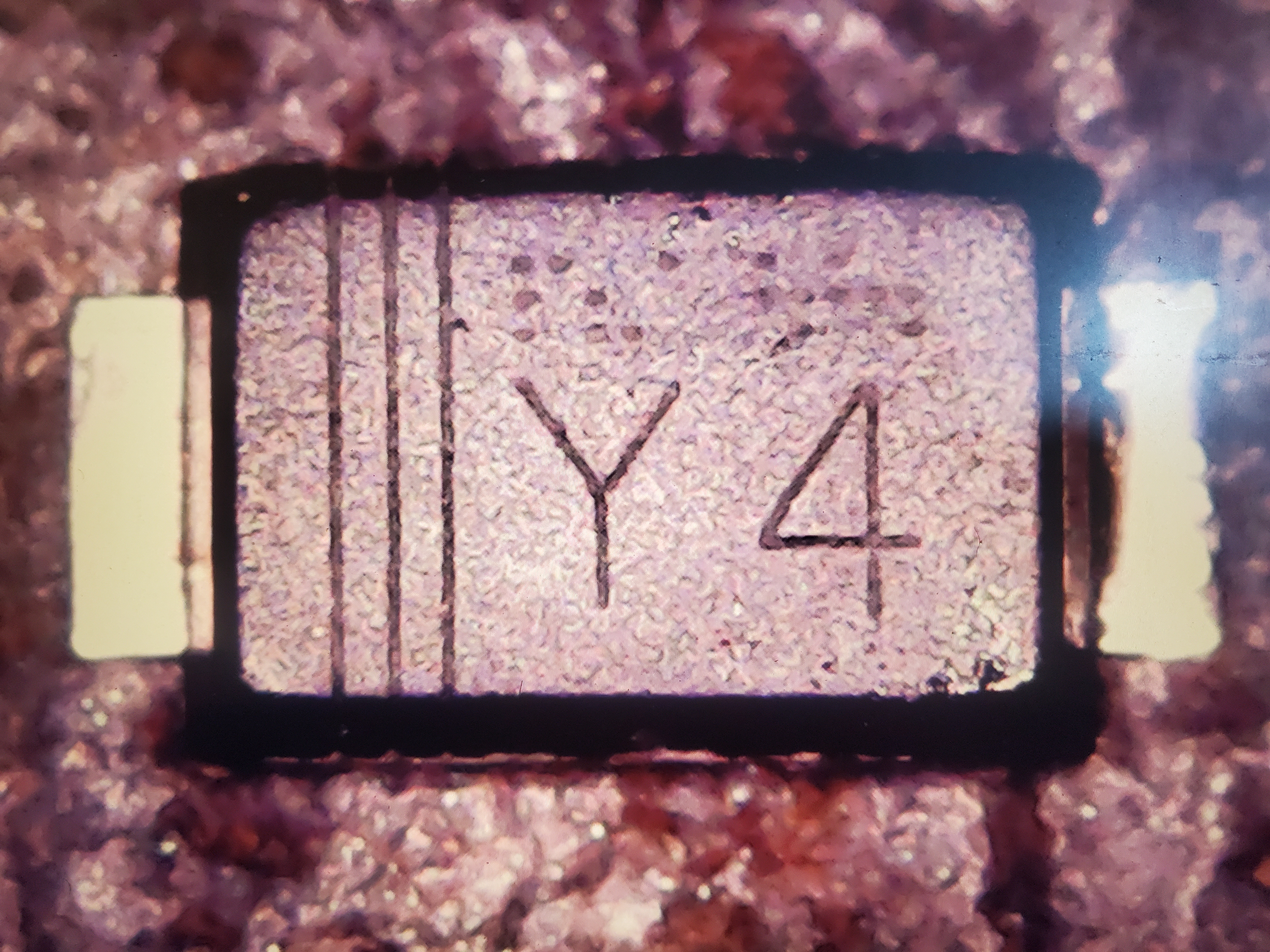

    It's a 12V unidirectional TVS diode.

      Please can I have the datasheet?
      And please, how do I source for datasheet of stuff like this?
      S-manual.com was not really helpful
      • truclacicr
        • Apr 2019
        • 356
        • australia
        I haven't been able to find a datasheet. I just know from experience that HDDs have two TVS diodes (5V and 12V) at the power inputs.These can usually be replaced with SMAJ12A/SMAJ5A, SMBJ12A/SMBJ5A or SMCJ12A/SMCJ5A, depending on dimensions.Also be aware that there is often a 4A smt fuse (marked "S") in series with each diode.
          Thanks a lot.
          S-manuals.com seem to lead me astray.
          TVS make more sense than what S-manuals is giving me, especially considering how it was arranged in the circuit.

            Maybe this:
            BZX584C15
            https://www.alldatasheet.net/datashe...BZX584C15.html

              Originally posted by harp
              Maybe this:
              BZX584C15
              You are on it...
              Thank you.
              I saw something related too. All pointed to a zener diodes. Different diodes with different electricl characteristics.

                It can't be a zener. A zener is far too slow, for a start.
                  Exactly.
