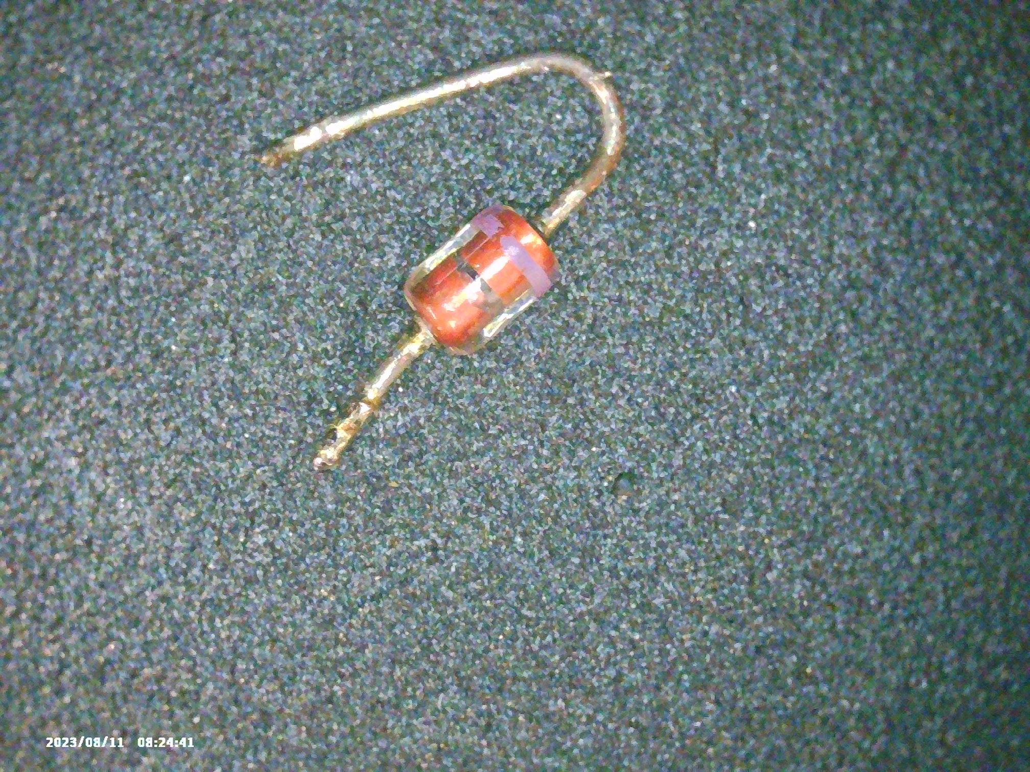

    Hi everyone,
    I have a diode that I need help identifying. I've been scouring the web (newbie) can can't seem to find anything. Perhaps I'm looking in the wrong place. Attached is an image of the diode. If you could help me it would be greatly appreciated. Also, an explanation of how to calculate the values would be great.
    Thanks for your help.
    Peter

    Re: Diode identification help
    any markings on the other side ?
    • lethbrp
      • Apr 2023
      • 15
      • United Kingdom
      Unfortunately not. Just a violet band.

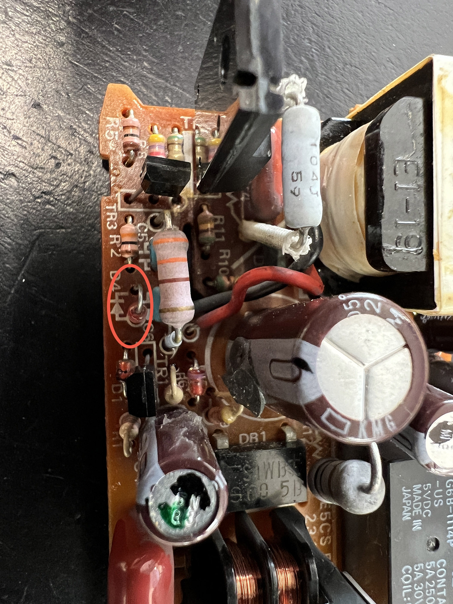

        What PCB has it come from,any model numbers ,is a schematic available .
            does the board have markings where it was?
            actually, show us the whole board - it may give a clue

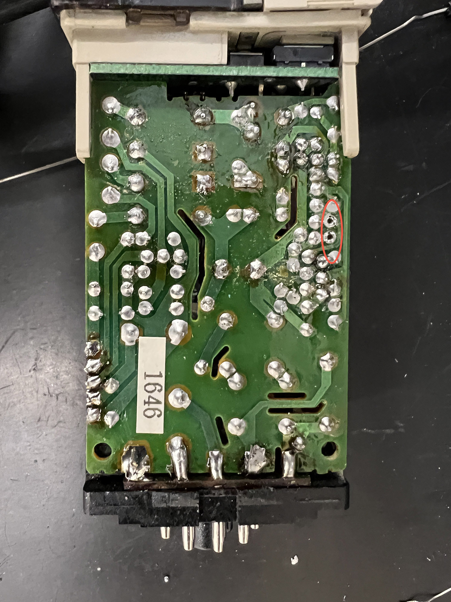

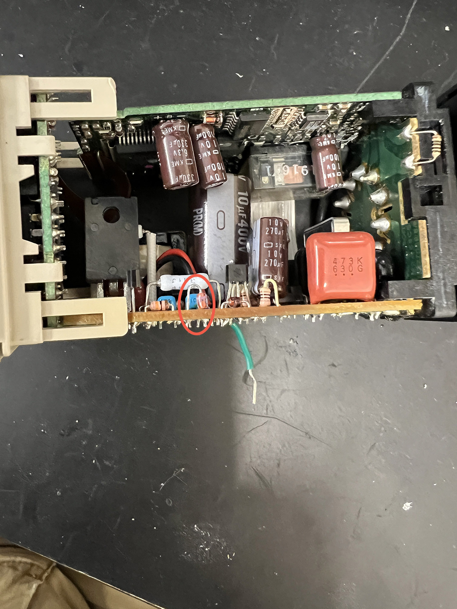

              Re: OMRON E5CS heater controller Diode identification help
              Attached are some images of the board. This is this is the power board that converts the AC into various DC voltages for the logic board.
              Running a did from a good board through a component analyser, it says it's a Diode Junction with a forward voltage of 0.672v at 5v. So I'm guessing that it's not a schottky diode or Zenner. Therefore, its it safe to assume I could replace this with even a 1n4007?
                It appears to be a 3-transistor SMPS and D4 is part of the drive to TR3. I think 1N4007 is too slow, you would use a high voltage fast switching diode 1N4937, UF4004, FR107. Could even be SMT tacked on to the bottom of the board like ES1J, FR2G, RS2G (400V) etc.
                Check the cap C6 is not shorted which would mislead in-circuit readings.
                D1 has a black stripe and more, so it might be a zener.

                  Do you know what purpose the small blue capacitors serve. In my ignorance, I thought it was these two capacitors and resistors that were creating an oscillation which was driving the main transistor to the transformer.
                    • 31260
                    the small ceramics are snubbers to protect the diodes and reduce rf.
                    it does look like a regular diode - cant tell the current.
                    if you want to risk it a 1n4148 can handle 250ma otherwise just use a UF4007
