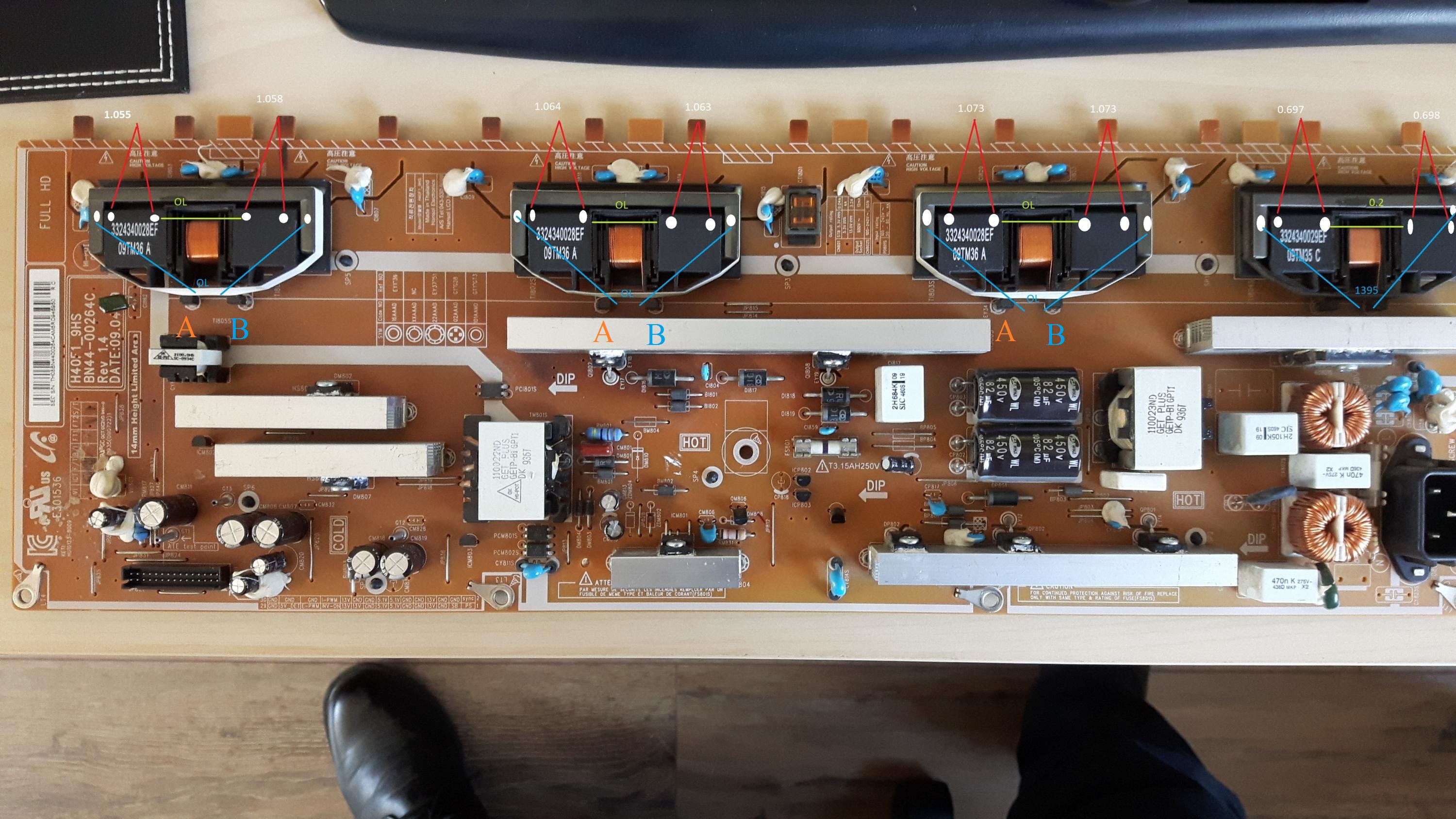

    hi all
    i have a samsung LE40B551A6W black screen with sound, when i got it i new a bulb needed changing, (my mistake took bulb holder off and broke tube) then tested all bulbs and all worked fine. now ive put it all together.
    so now this is how i got the tv no picture but with sound. iive taken the in power inverter board off and checkedthe transformers and come a cross a difference in the readings.
    heres a pic to explain
    the one on the right has different readings, could this be the cause or is it normal as this one has a different letter with black edgeing tape
    any infor appricated
    thankyou

    That transformer on the right is different as it only has to drive 2 lamps, the others each drive 4 lamps. both secodaries on that check the same so it is likely ok.
    Do you at least get a quick flash of the backlights when first turned on?
    If you disconnect the plug going to the main board do the backlights come on?
    On the first 3 transformers primaries you show OL, that is not right, it should be low around 1 Ω or less
    Also on the first 3 transformers the two secondaries are not connected together, on the third one they do connect the secondaries together at the 2 center pins. this is normal
    Another item to check is CI817 (square white cap) If it looks slightly bulged it is bad

      I am not sure but I think the transformers should carry the same numbers and the odd numbered one seems to be bad one. Wait on others to chime in before deciding.

        You may want to check the connections on the circuit side of the board, all the transformer primaries should be connected in parallel, so if TI804 measures 1395, that is wrong, it should be very low, like a short.
          the meter i use is a fluke 113 so i used the ohms as auto, i shall try the manual range and see if it measures 1 or less.

            ive the measurement in the different range and the only one that seems diff is the one on the right on pic its 0.2 as it jumps from 0.2 to 0.1 and
            CI187 0.435 v one way and OL differenr direction.
            in ohms its 3265 one way OL different location and not swollen

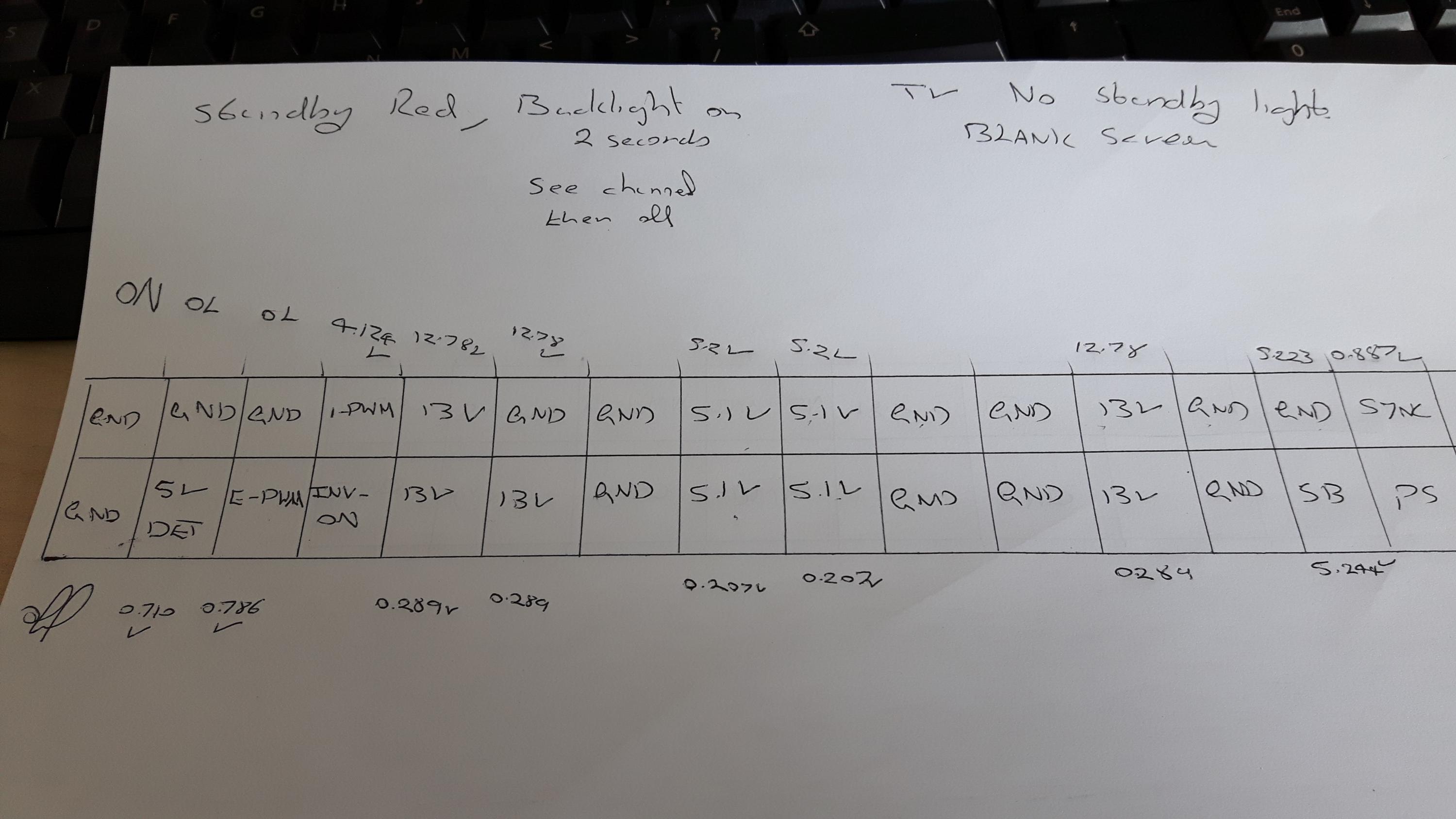

              hi all
              ive taken readings with tv on and standby hopefully it will help out as to how the tv is at the momment. when on tv blank but you can see the snow effect on tv channel with a torch. so for some reason the back light is going off after 2 seconds

                If the backlights come on for 2 seconds, I suspect the inverter board is ok, and there is a bad ccfl lamp in the panel.
                The backlight will shut off if it sees an error on one of the ccfl's ie: it did'nt light. It could be hard to isolate as you can't just disconnect a single lamp output and it can be hard to see if all the lamps light for 2 sec without opening the panel.
                as for CI187, it must be ok if you get the 2 sec.of backlight, also it can't be checked with a multimeter unless it has a capacitor test function.

                              Where did you get the replacement tube from. Perhaps it's not to the same specification as the ones you already have in the set and may be causing an error signal.
                              On the prmary side of each CCFL transformers, have you checked (using you meter set to ohms) that pin1 of each of the transformers are connect together and also all the pin 2's are all connect together. As suggested by RJ in post #4
                              When you power up what voltage do you have at DET_5V?. If it's low then there is an error.
                              What voltage do you have at the Inverter On/OFF pin when you power up?

                                    the inverter on /off as far as i can rember no reading as that why i left it blank on my picture i added
                                    the 5v det when on showed OL, think im going after recheck these readings
                                    you mentioned the primary pin 1 and 2 primary , im not sure how you mean with this .

                                      It's the dc voltages at the pin 23 & 25 being asked for. With the black lead on the chassis and red meter lead on Pin 23 (Inverter On/Off), power on the set and give the voltage the meter reads. Repeat for pin 25 (Det_5V)
                                      With the set off and using your meter set to ohms do all the "A" connect together and all the "B"
                                        Re: samsung LE40B551A6W black screen with sound
                                        Most CCFL tester does not have detection/.protection circuit to detect lamp over current draw, bad worn out lamp (which draw more current than normal) will still light up with tester so keep that in mind.
                                        Det_5V is normally HIGH (it is active low, LOW = PROBLEM in backlights circuit).
