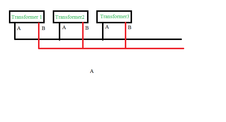

      Re: samsung LE40B551A6W black screen with sound
      It's the dc voltages at the pin 23 & 25 being asked for. With the black lead on the chassis and red meter lead on Pin 23 (Inverter On/Off), power on the set and give the voltage the meter reads. Repeat for pin 25 (Det_5V)
      With the set off and using your meter set to ohms do all the "A" connect together and all the "B"
      you say measure in ohms A connecto together and B together.
      ive seen the A and B ost you have put on pic do you want the measure beteen the two post on each of the transfmores with tv off . have got this right
          the A post 0.2 then drop to 0.1
          B post 0.2 then drop to 0.1 aswell

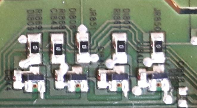

                          There's no reason why you should be asking for trouble. The component he lifted is a small surface mount 0 ohm resistor (used as a link) so you need to be careful not to lose it, reference JR860
                          If the tubes do not light up then the problem is elsewhere.
                          Watch the video and take your time and don't rush it.

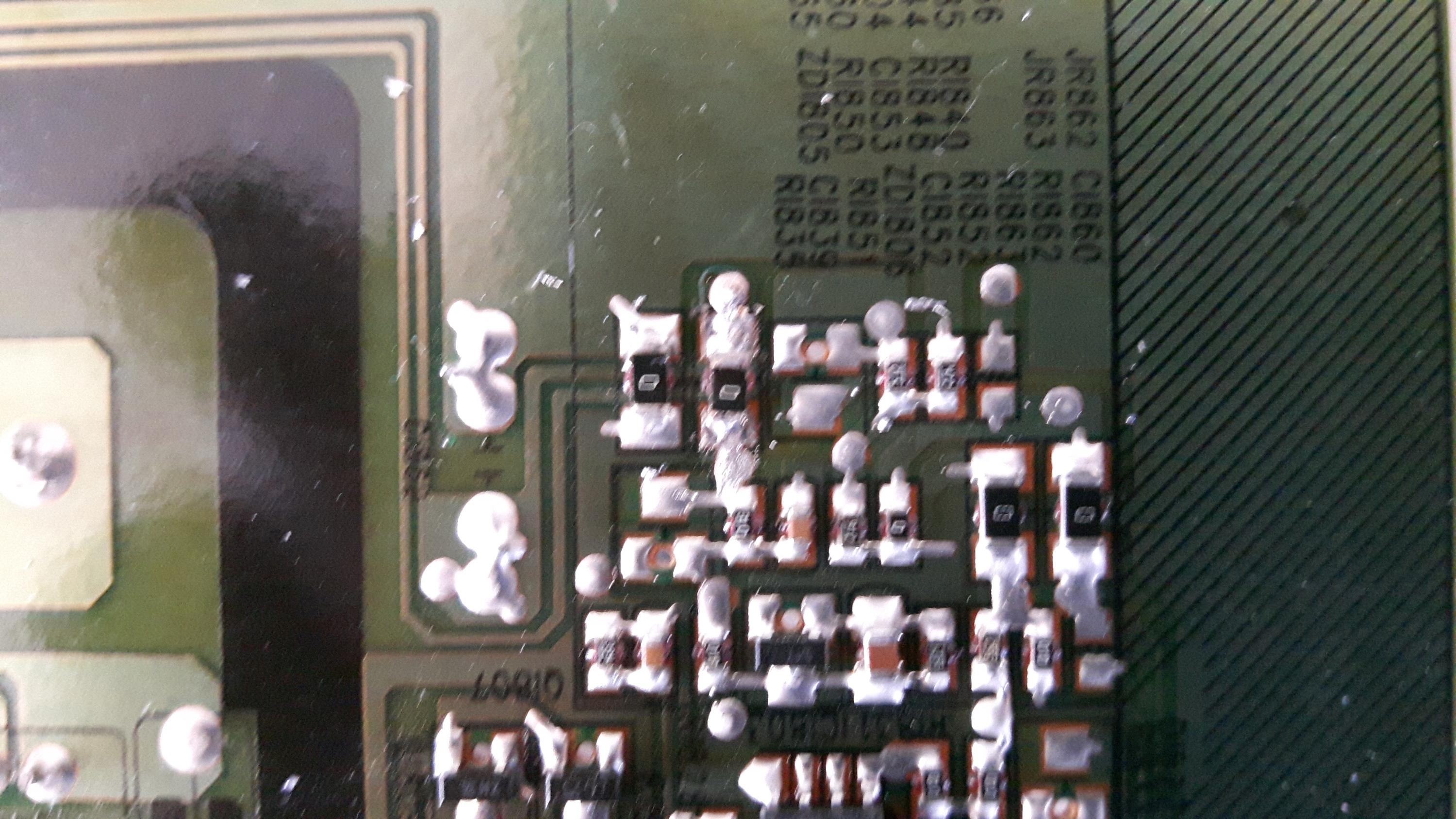

                              hi there well progress so far. ive gone over my solder joints on the transformer again and also lifeted the JR860. now the tv is ON. no dark areas as if a tube is out, so what do it do now then do i leave it or reconnect the JR860

                                #35
                                It's not advisable to run anything with the protection circuits disconnected otherwise there would be no need for them.

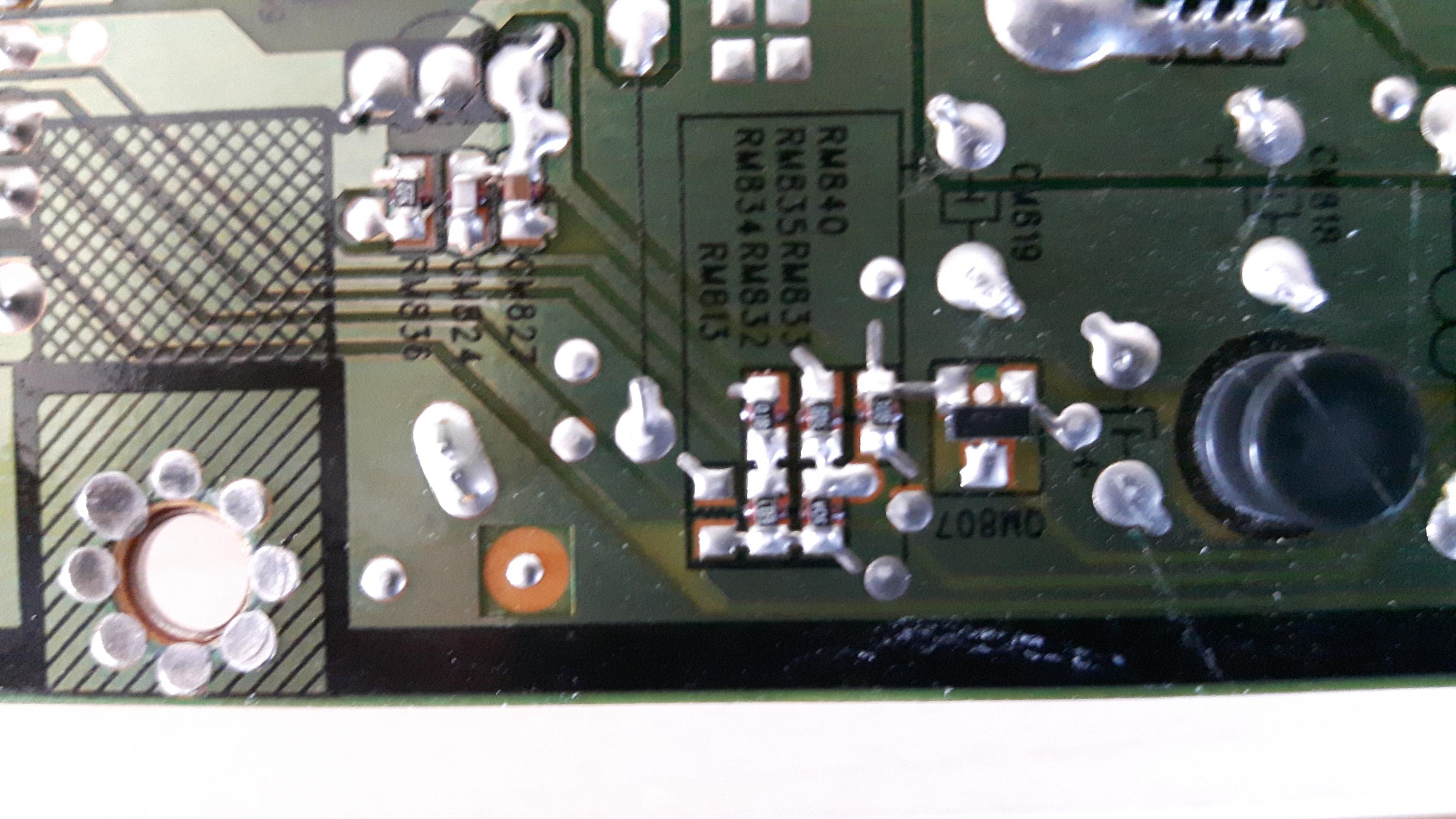

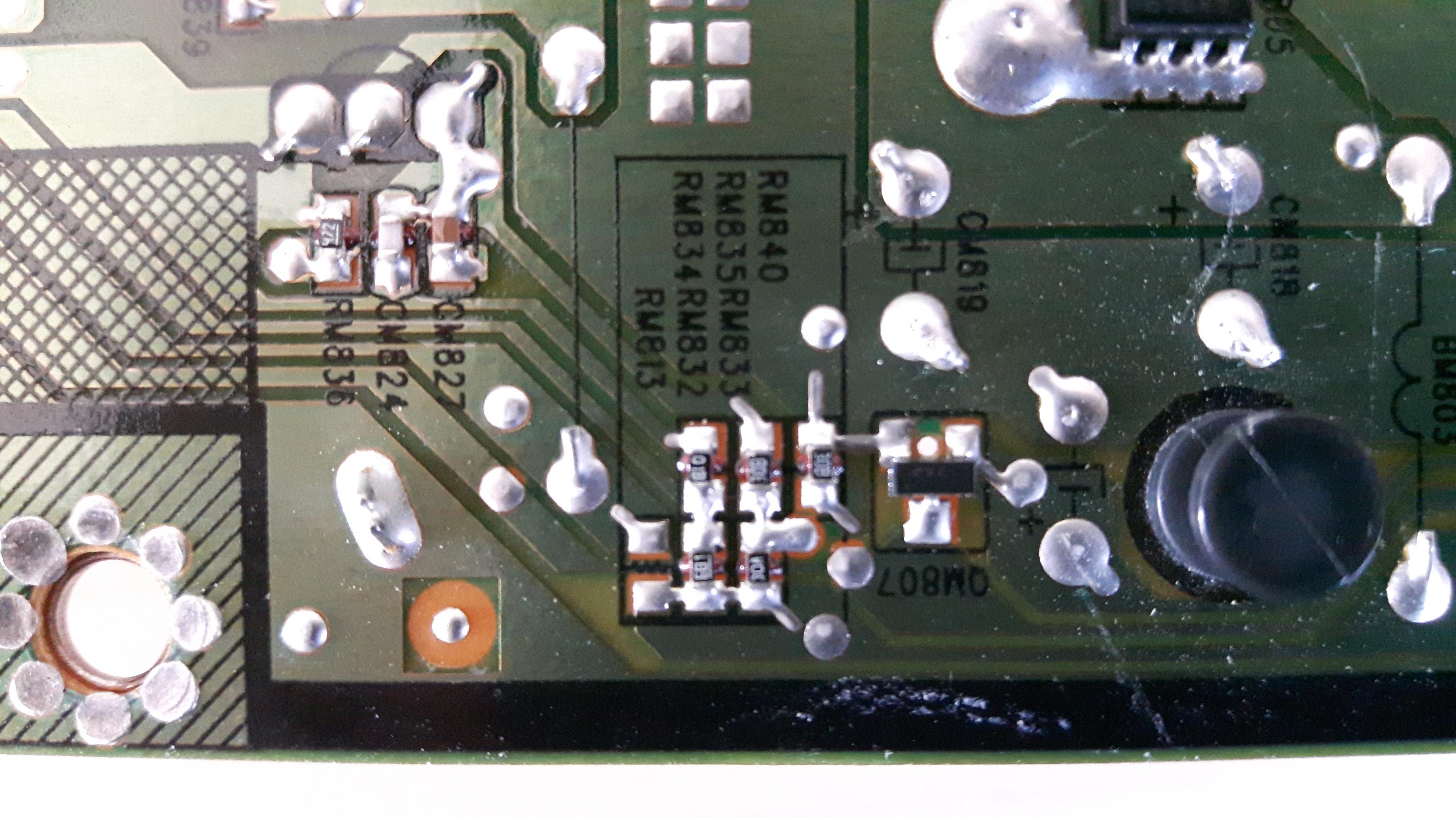

                                Can you post a nice sharp and well focused picture of the underside of the board so that the component references can be read.
                                • andrewblueboy
                                  • Feb 2017
                                  • 47
                                  • uk

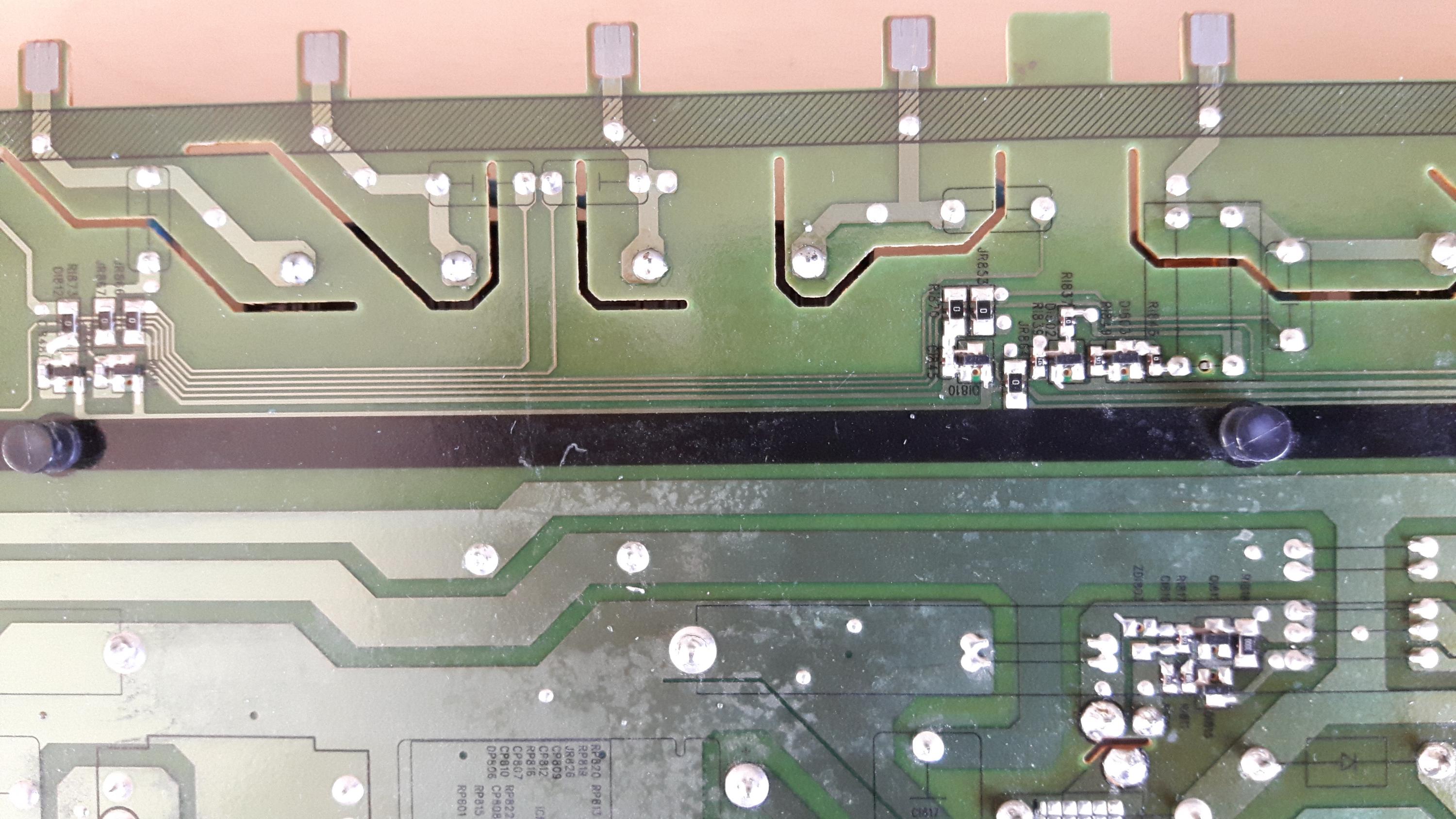

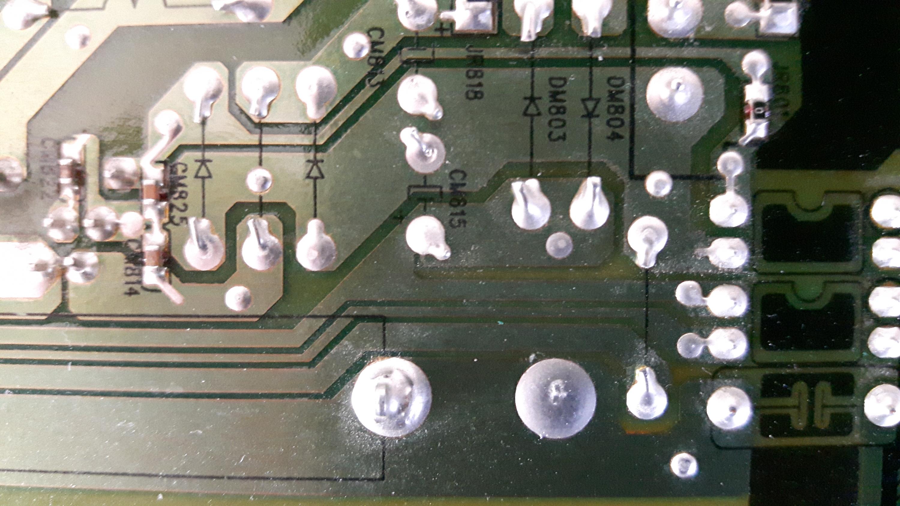

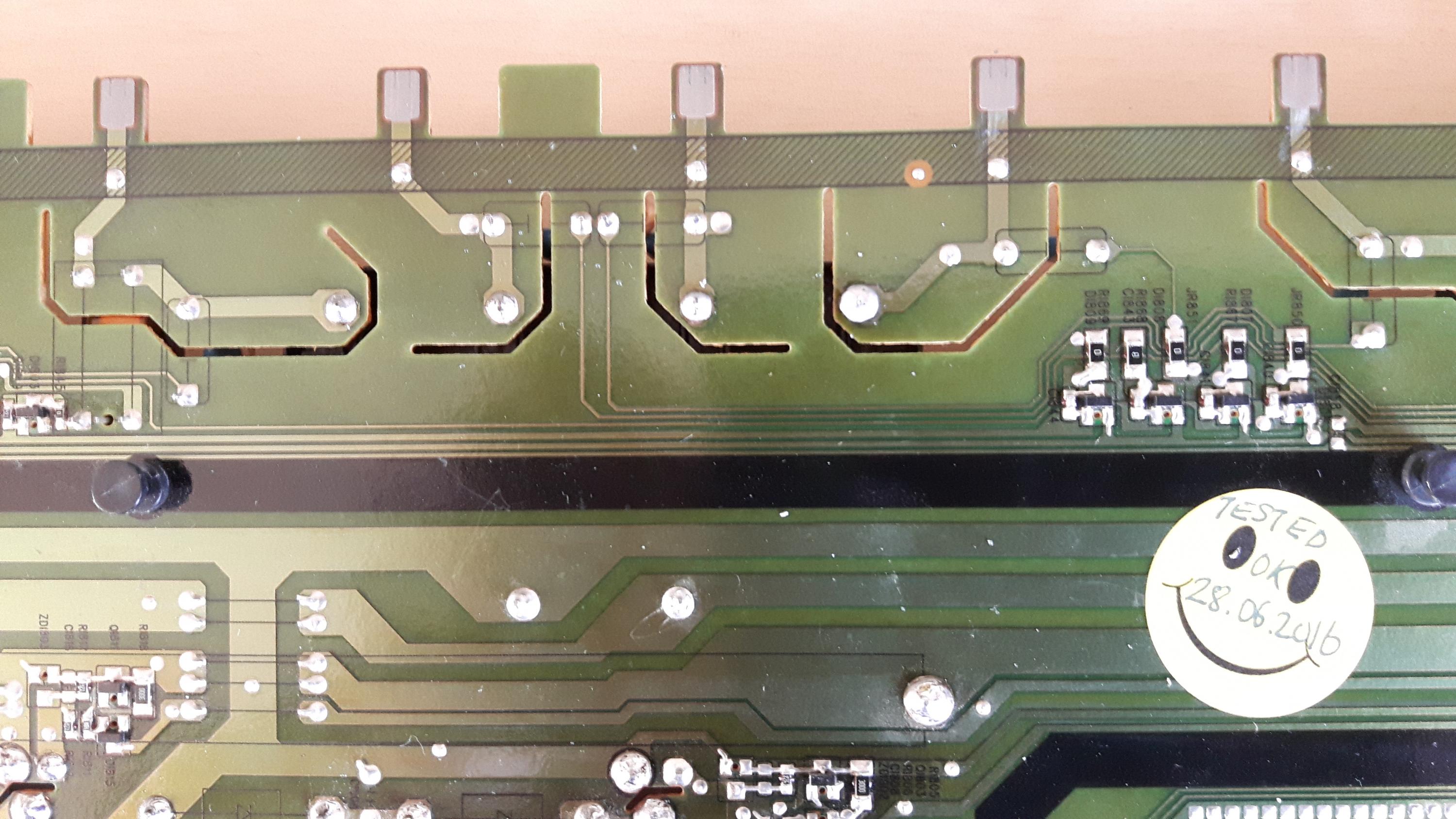

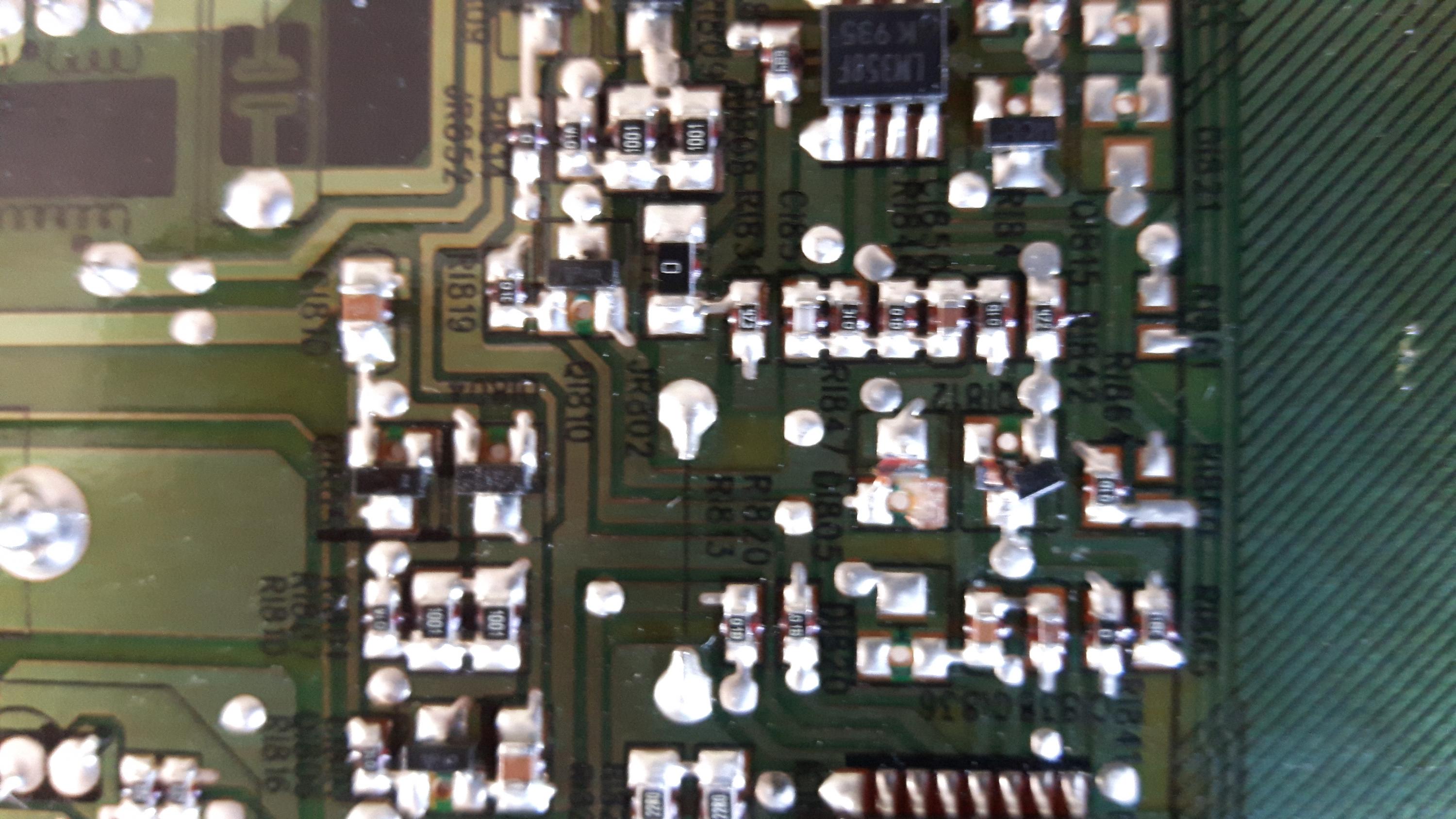

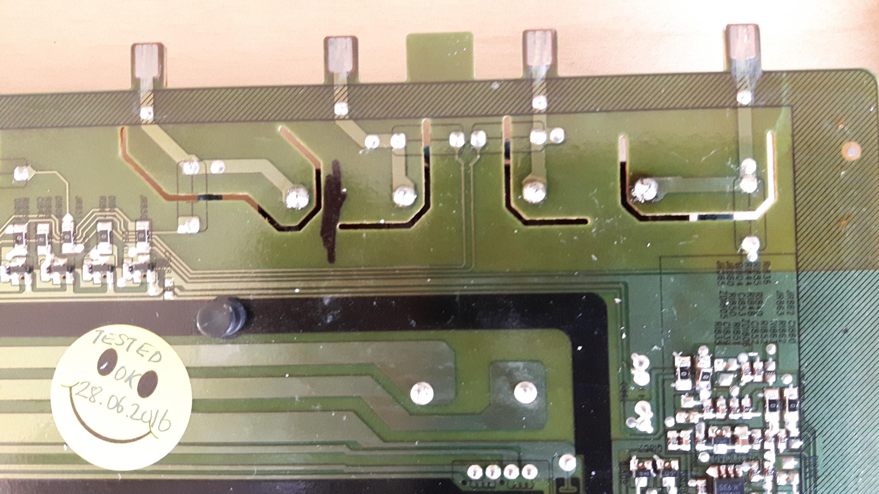

                                  #36
                                  here are some
                                  • andrewblueboy
                                    • Feb 2017
                                    • 47
                                    • uk

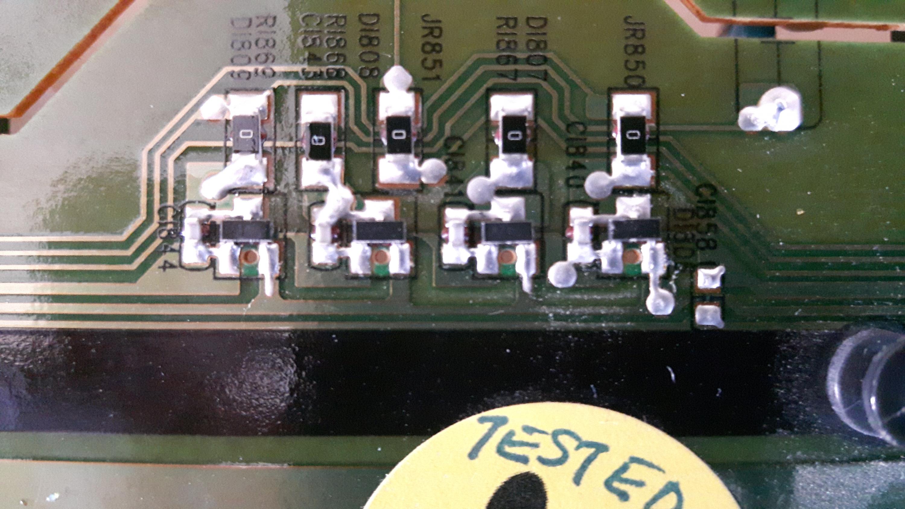

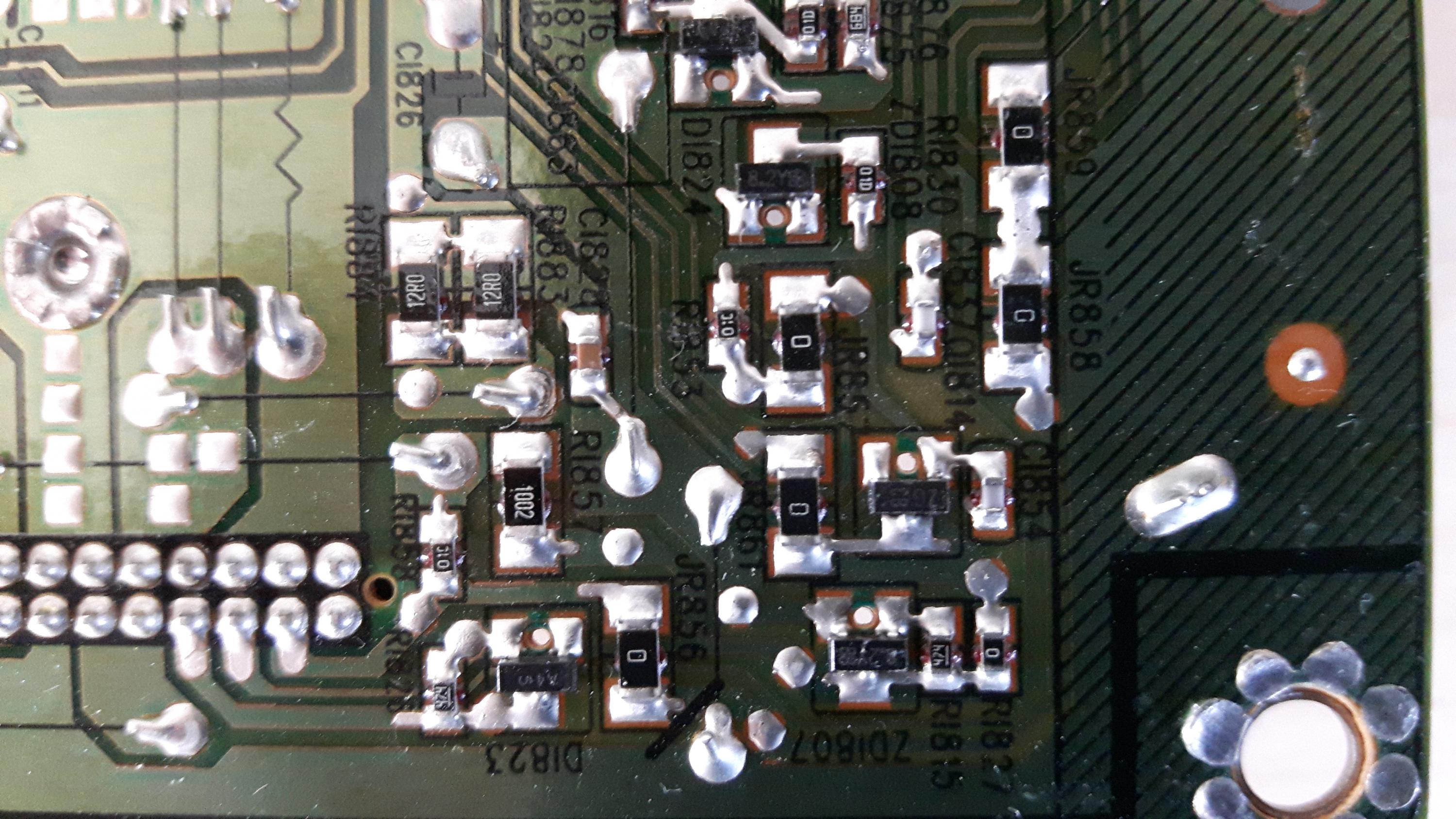

                                    #37

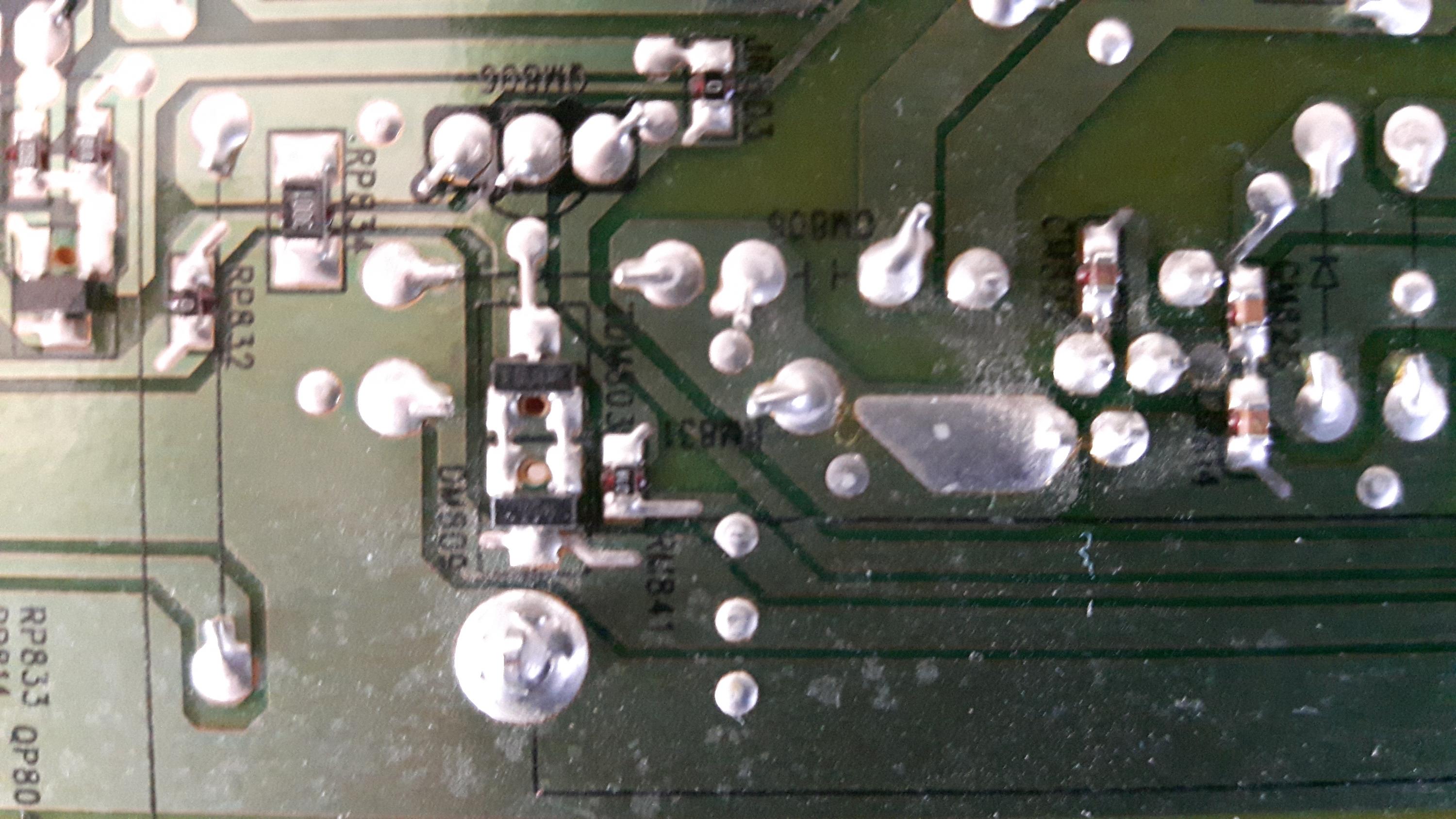

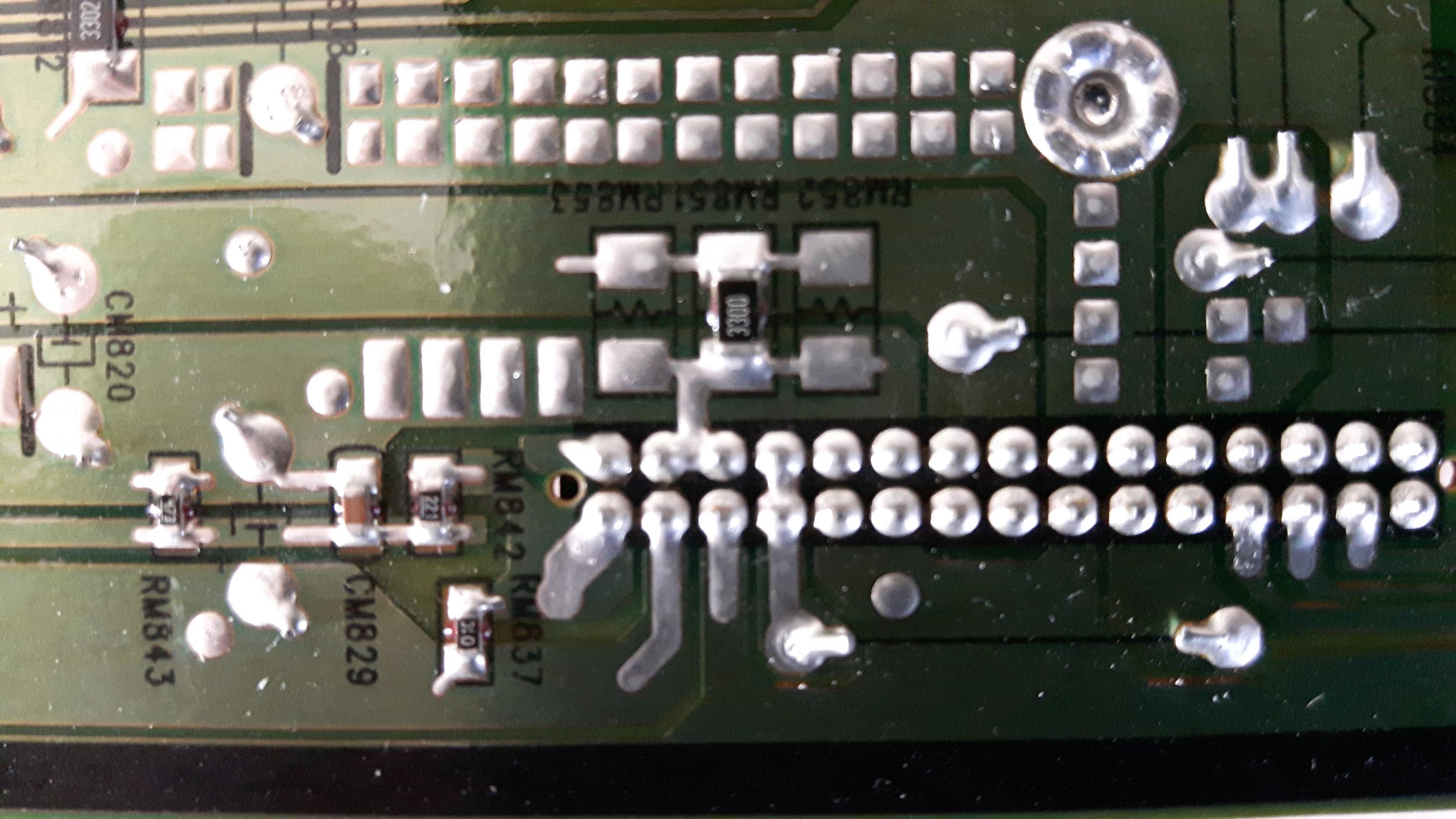

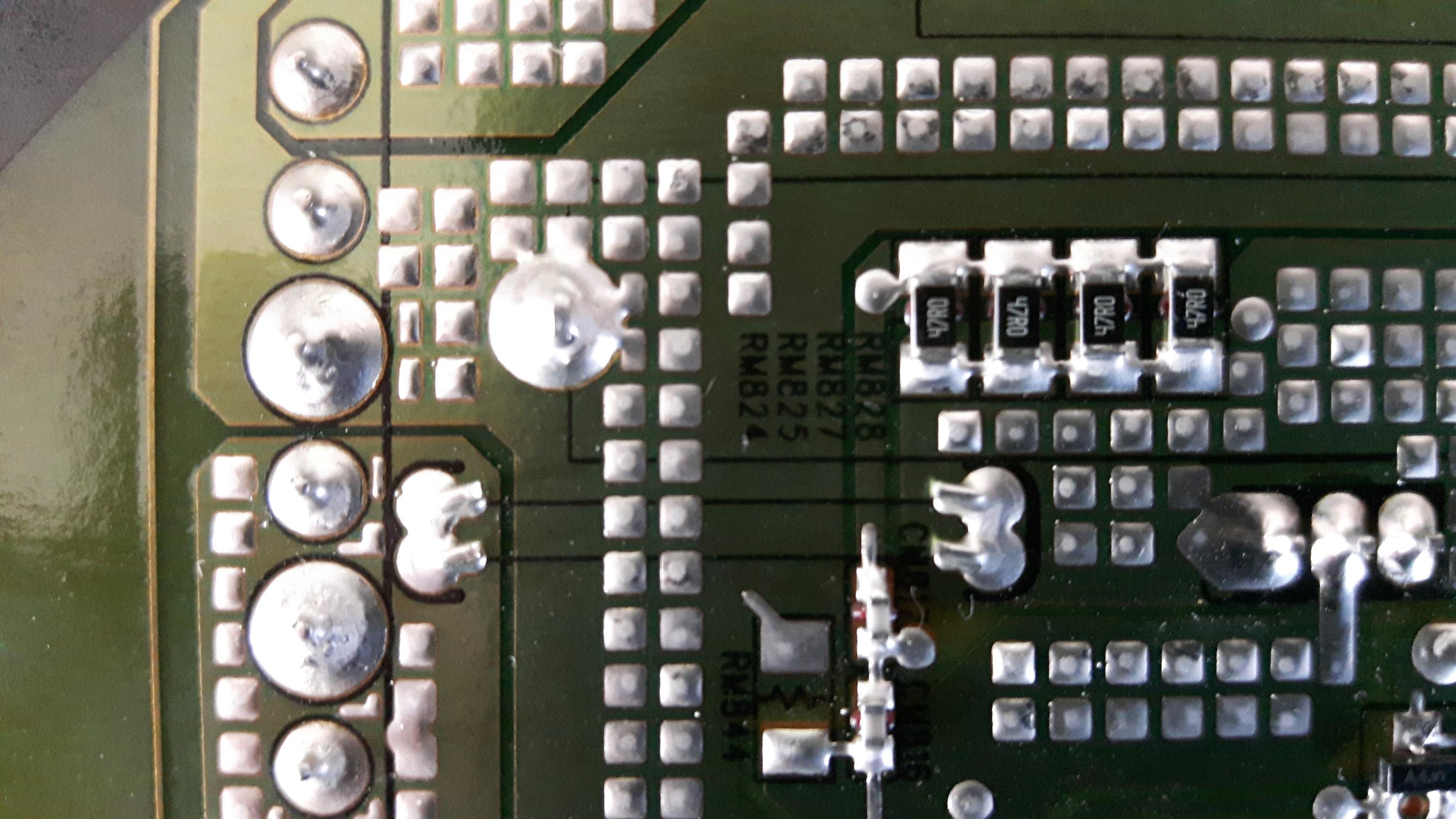

                                    here some more
                                    • dick_barton
                                      • Aug 2015
                                      • 6643
                                      • Wales
                                      #38
                                      Can you replace the jumper JR860.
                                      I can't think of a simple way to isolate the fault other than knowing that there is an error being generated by the lamp circuitry.
                                      If you feel confident then there are a number of diodes DI8106 to DI812.
                                      Can you carefully lift pin 3 of DI806 and switch on. Do the backlights stay on?
                                      If not reconnect pin 3 and move on to DI807 and switch on. Do they stay on.
                                      If not reconnect pin 3 and move to the next diode..
                                      Repeat until the backlights stay on and report the diode number.
                                      If anyone else can think of an easier way then I'd like to hear.
