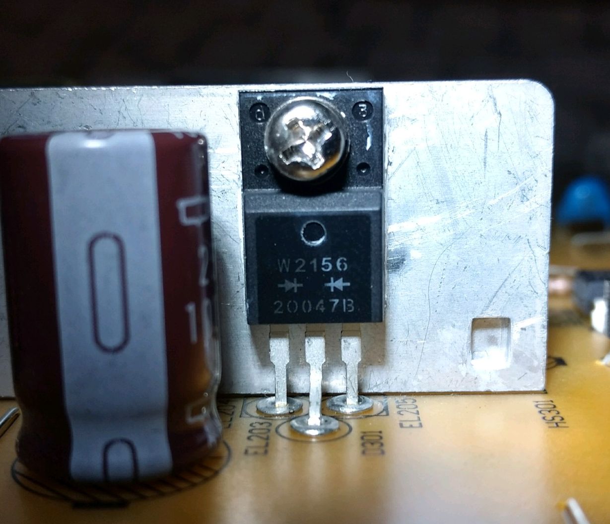

Can someone please tell me how to identify a rectifier diode using the numbers printed on it? I'm having a hell of a time and just frustrating the p out of myself

Here's the pic, looks like I need glasses worse than I thought.
I thought the number was W215G, instead its W2156
I found this on Digikey, but they call it a Schottky diode. It looks like mine is marked as a rectifier diode?
https://www.digikey.com/products/en/...ys/286?k=w2156Attached Filesif you find these attachements useful please consider making a small donation to the site

It is a dual schottky, common cathode diode. They use a shottkey as a "rectifier" because it has a lower forward voltage drop and are very fast switching. due to the high frequency of smps'sComment

Thanks guys, looks like I found the right one then, I appreciate it!They call me......."threadkiller"

What is wrong with it? Just so you know they do check different than a silicone diode, in diode mode on a meter they read around .2xx where as silicone is .6xx
and if you are measuring a short accross the outside leads you are likely measuring across the transformer windingLast edited by R_J; 05-21-2018, 10:17 PM.Comment

I shorted the center and left pins together while powered upThey call me......."threadkiller"
