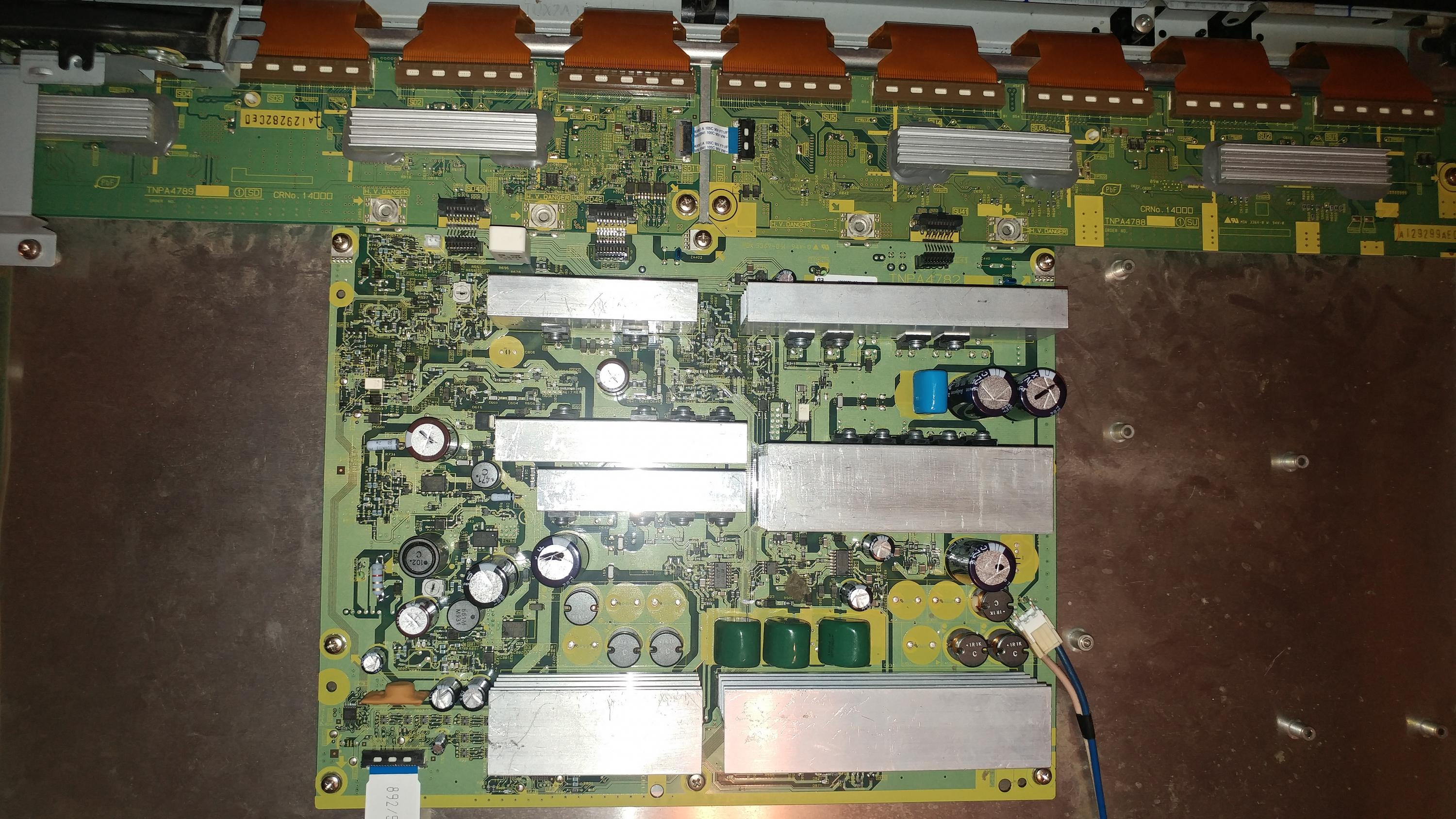

    Panasonic TC-P50G10. 6 blinks to 7 blinks.
    My Panasonic recently went out and had a 6 blink code. Per the manual, 6 blink code means SS, SC, SU or SD board. It turns on, shows no picture blinks 6 times then turns off. I read the most common issue is the SC board so I purchased one and switched them out but the TV went from a 6 blink code to a 7 blink code. The manual states that is an issue with the SU SD or SC board. I'm wondering why it went from 6 to 7. Did I buy a bad SC board or is it just the SU SD? Is there any tutorial I can use to test the SC board? I have a multi meter but pretty new to this stuff.

    Re: Panasonic TC-P50G10. 6 blinks to 7 blinks.
    Test the su and sd boards this way:
    Remove the 2 screws from them to the sc board.
    Take a paper plate and slip it in betwine the sc and the board youre testing.
    Put your meter in continuity mode( beep when probes touch).
    Put a probe, dont matter which one, on the metal tab of a screw hole.
    Take the other probe and slowly rake across the pins of the flat ribbon connectors. Flip up the tab to test the back side.
    If you hear a beep the su or sd you are testing it has failed. It has a short on the ic chip.
      Ok tested the pins of the ribbon connectors and no beeps. Should I also be testing the needles circled on the picture I attached?
        No, should be fine. Check sc2 on the sc board. One probe on each pin. A beep longer than 4 seconds is bad.

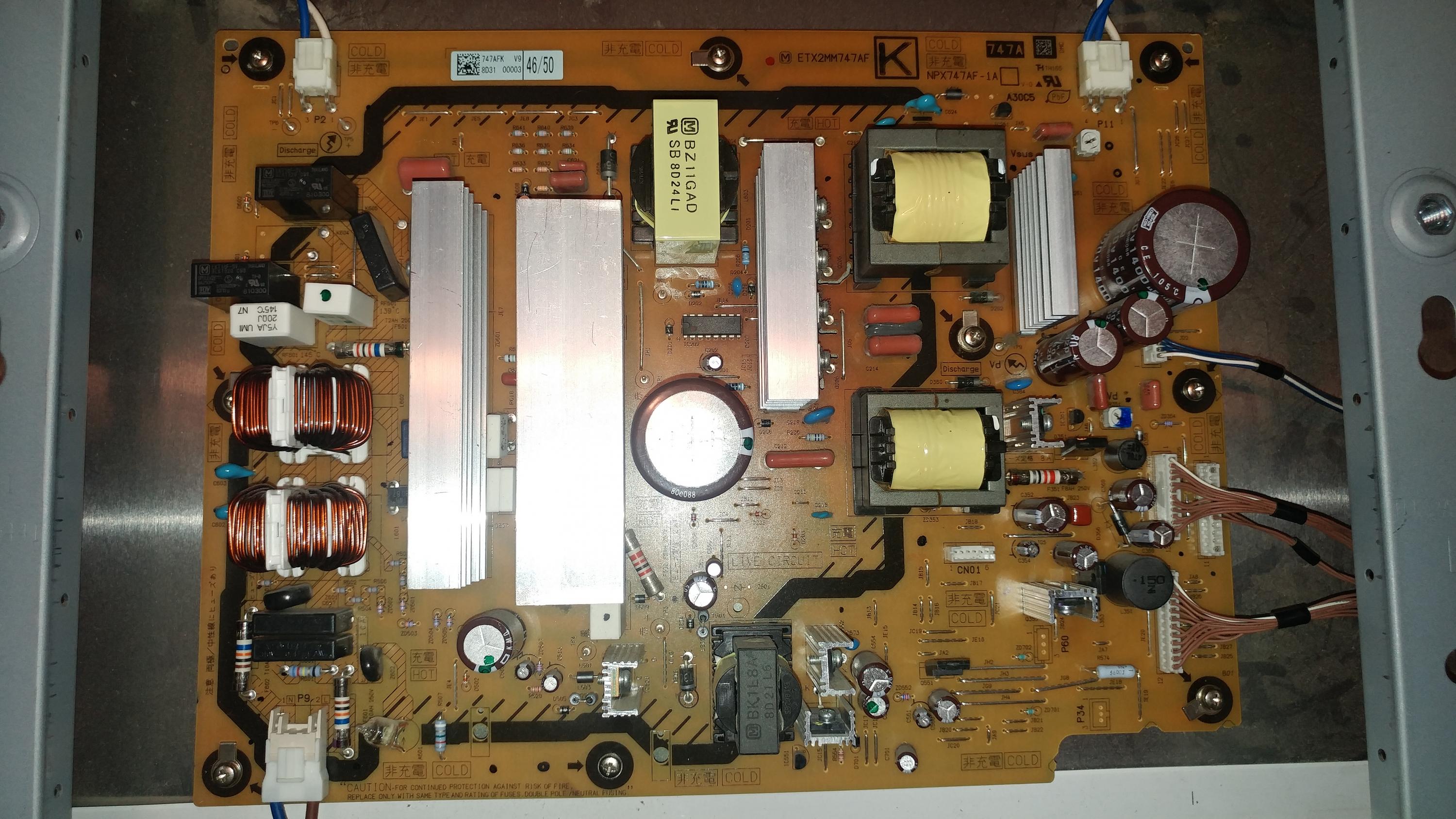

                          I would also check the power supply board, as many times it happens that SC board failures take out a fuse and maybe some transistors on the power supply.
                          I don't remember the SOS circuitry right now, but I imagine that in case of no power supply to the SC board, the SOS acts as SC failed or is missing, hence SOS7.

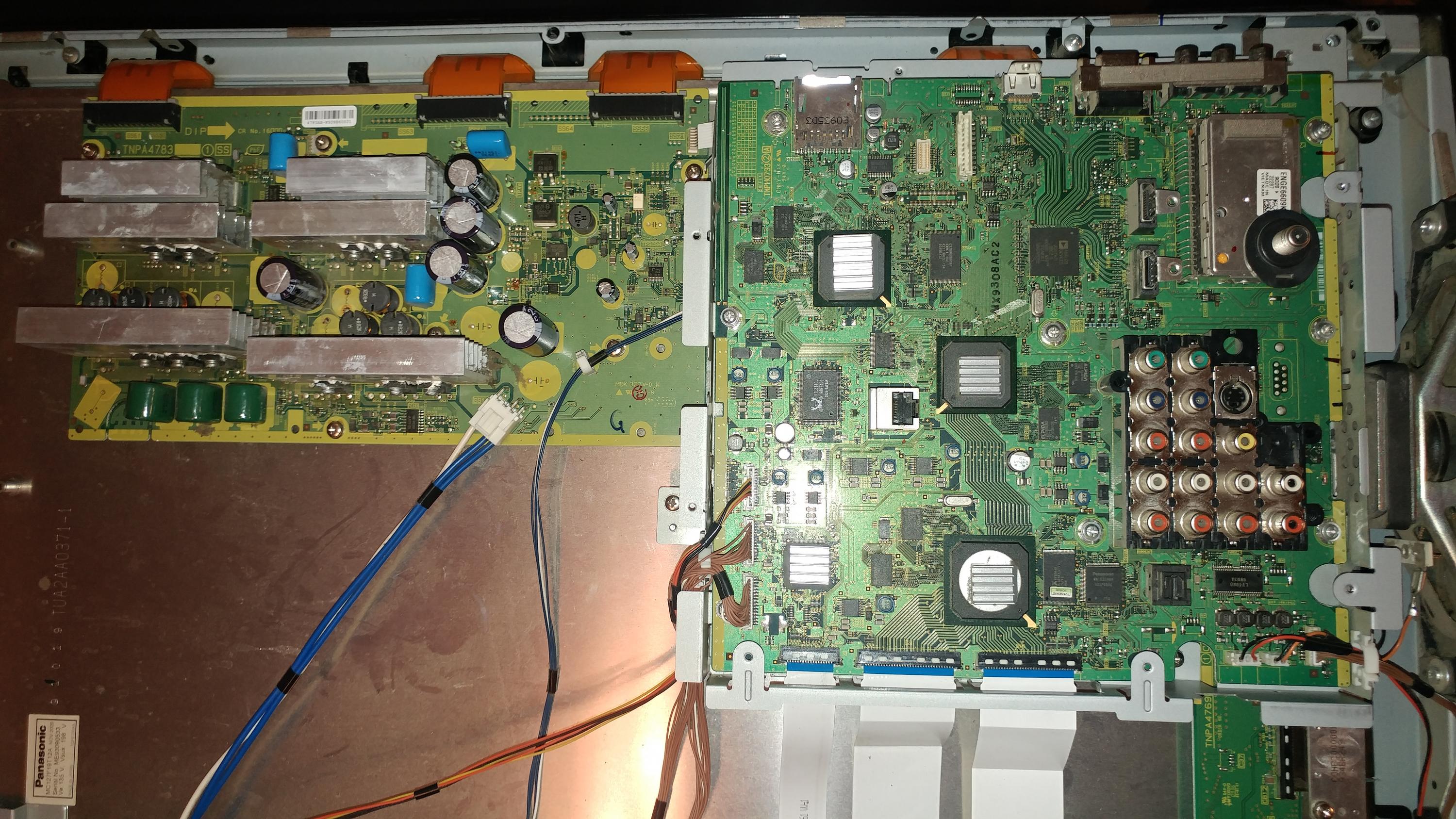

                            Went through and reseated all the ribbon cables and tightened all screws, then tried jumping it but received the same 7 blink code.
                            I actually thought it was the power supply at the very beginning and so I purchased a new one since they were pretty cheap but it turned out to be something else. I did check the transistor on the new one though and those came back good.
                              Now I know tvtimmy stated that those plugs I circled in my picture above should be fine but is it possible that they are messed up which is why I'm getting the 7 blinks? I'm thinking its the SU/SD boards but I just don't know.
                                Did you take out the 4 screws for the bufferboards, un latch the 3 black connectors, and short the 2 pins at sc50 , then turn on?
                                If the tv stays on and the green led on the sc board stays lit the sc board is good. Only run it like this for 30 seconds MAX.

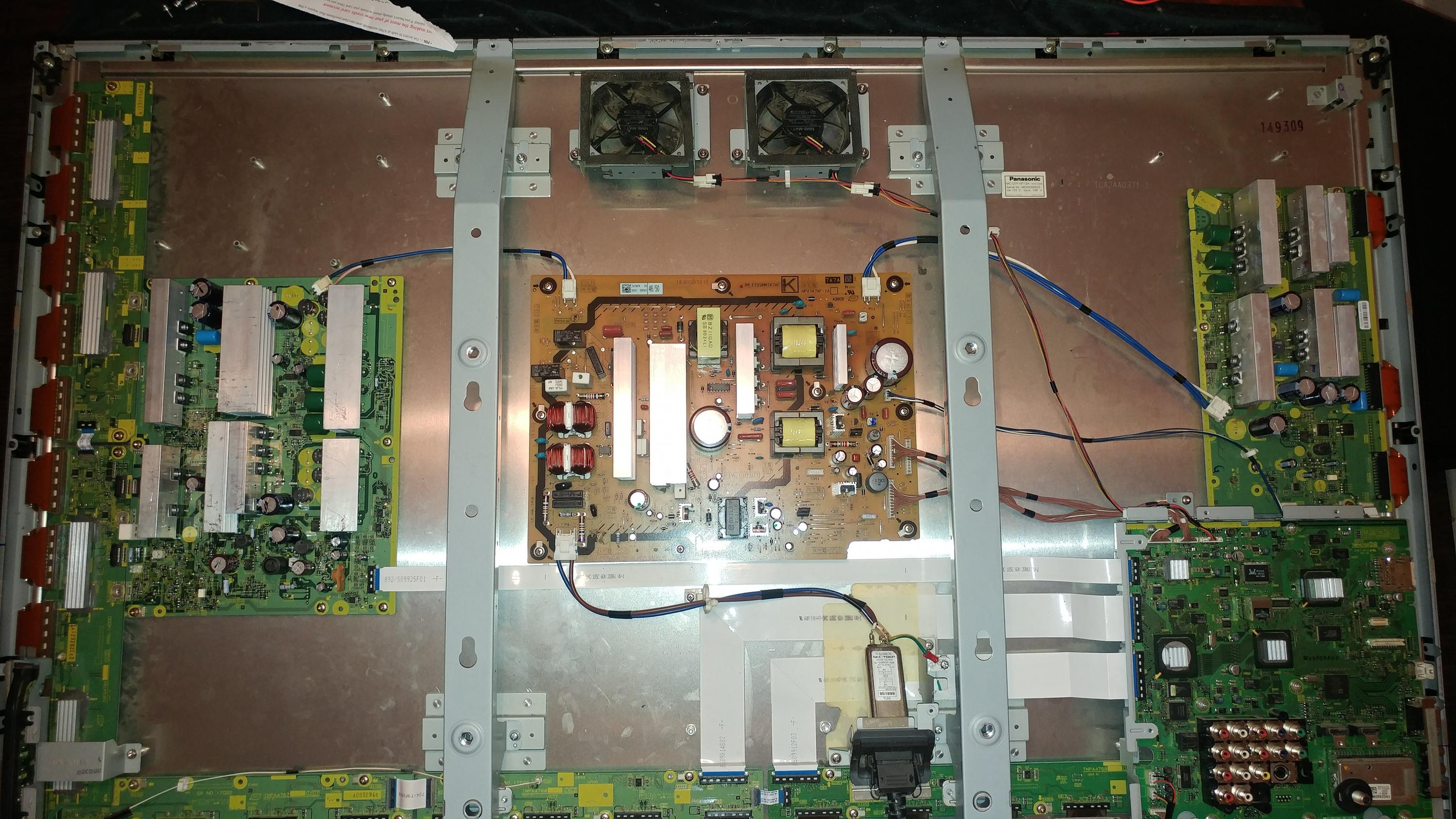

                                    Adding photos of the TV.
                                      Test voltages at test points on SC board. VSUS, VAD, VSCN.
                                        Tested them:
                                        VSCN 40
                                        VSUS 198
                                        VAD 185
                                        Manual says that's right where they should be.
