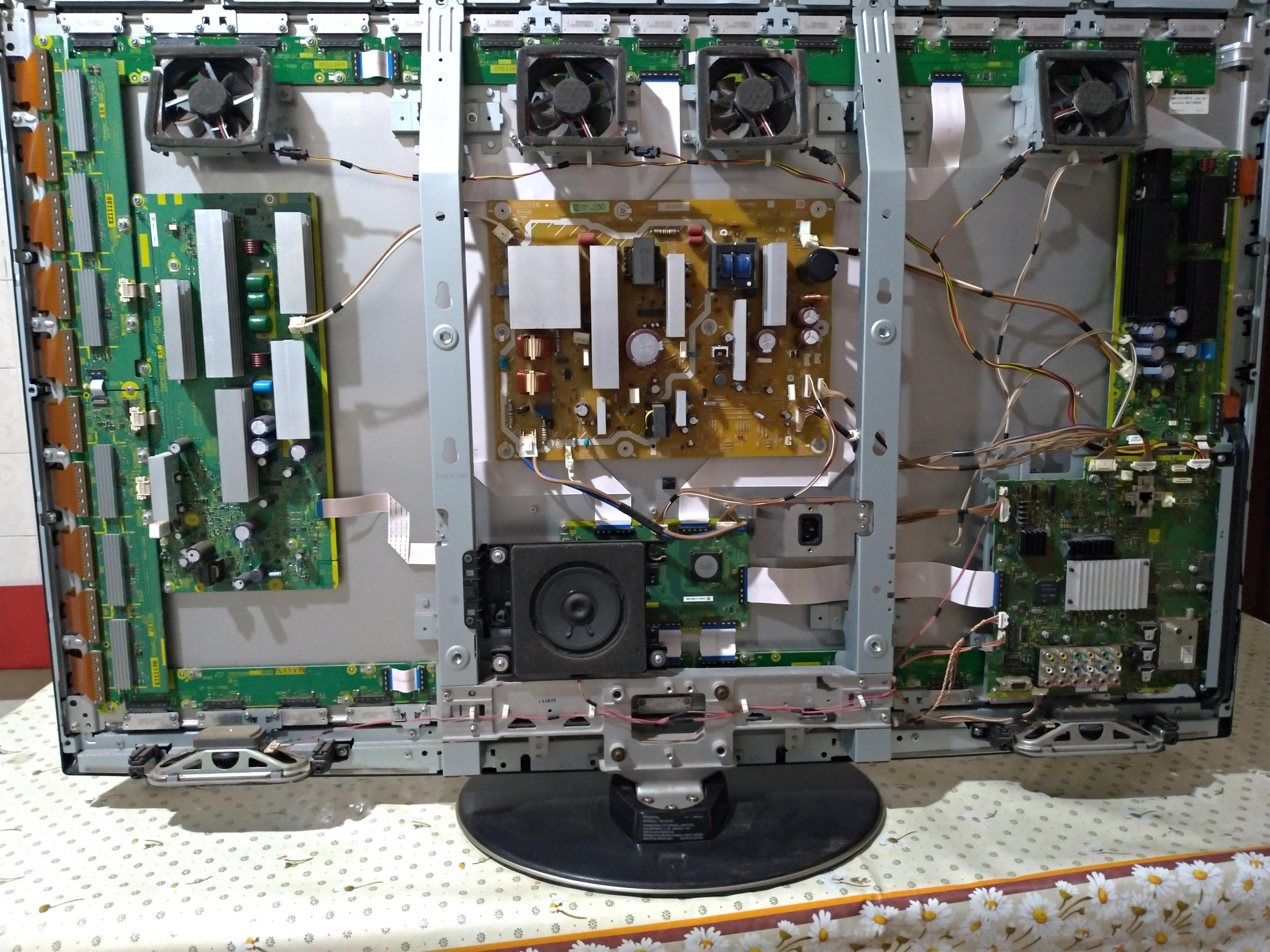

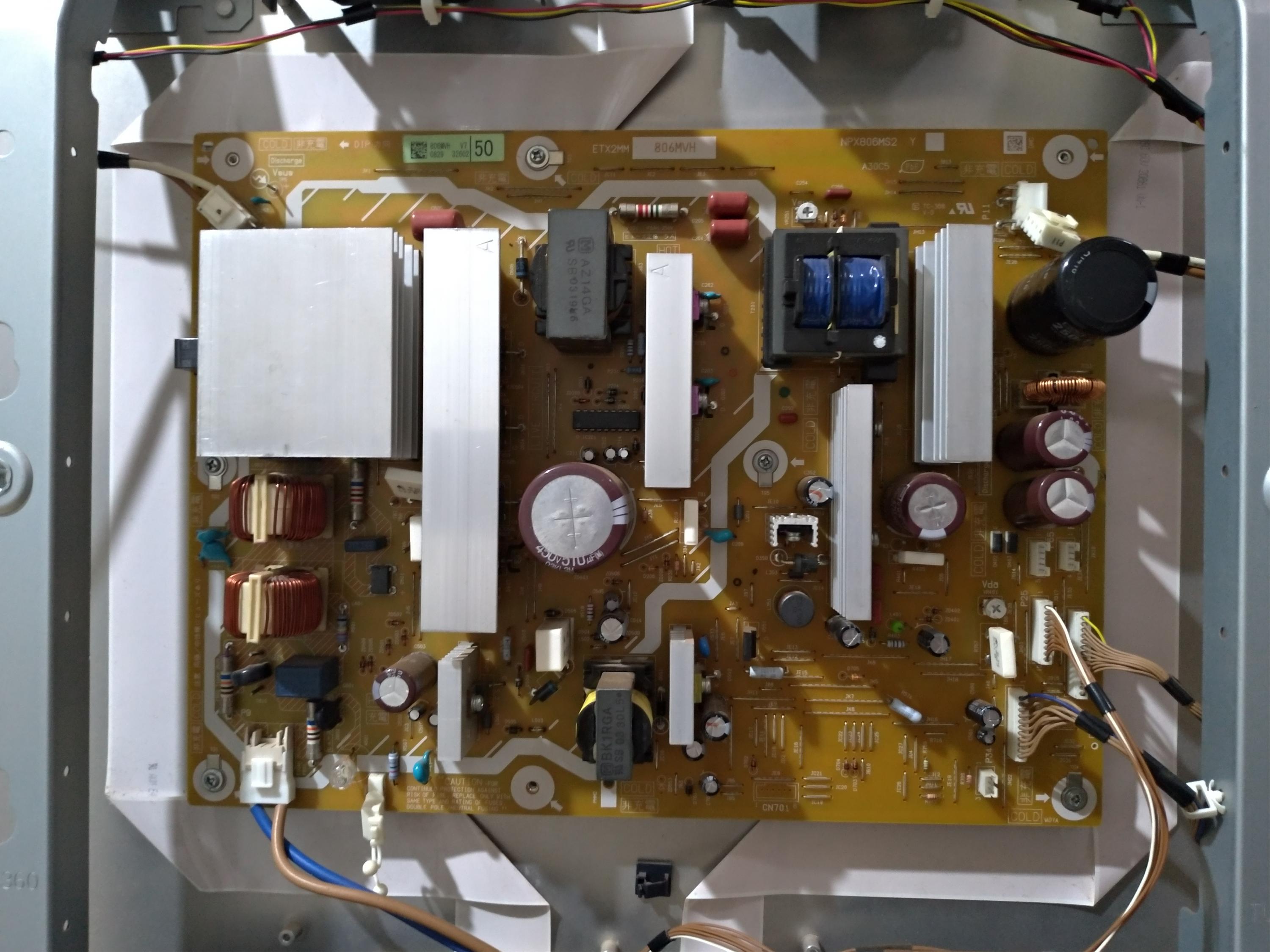

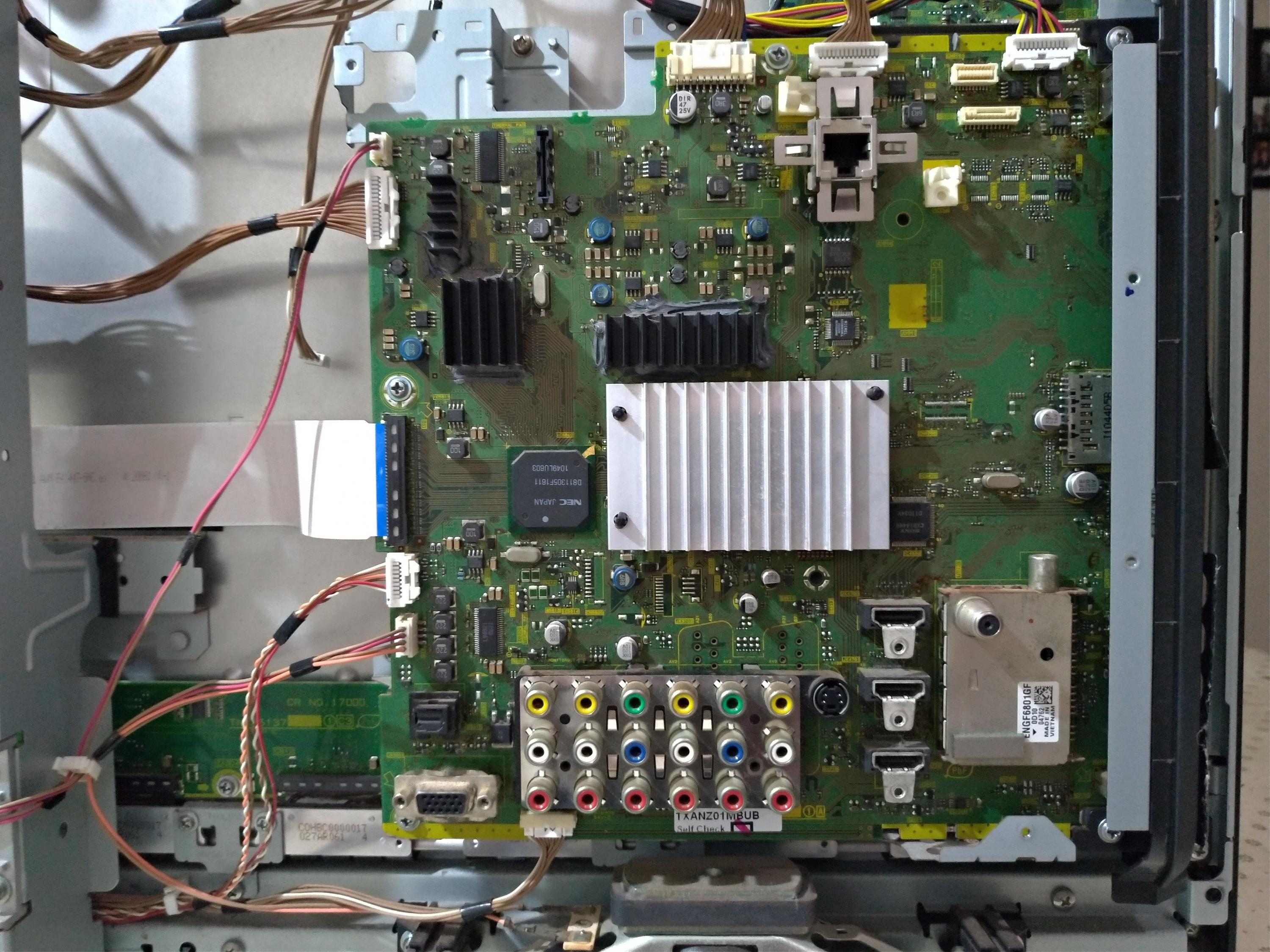

    Hello, I've had this TV for 3 years, 2 years ago it stopped working signaling 12 Blinks, SOUND_SOS according to the service manual.
    It has no VSUS or VDAT, and P15V has 1.0V instead, the same 15V goes to A board. F15V is ok and other main voltage rails.
    It seems the power supply is defective, since unplugging D20 ribbon cable that goes from D-board to SC-board makes the behavior change, the TV stays on, there's no image nor VSUS, but 15V reads 2.4V, high enough to not trip the SOS 12 blinks, so it stays on, fans do not spin but I left it 2 hours, green led lit up and didn't shut down.
    There's no shorted caps, ICs or low resistance on P15V rail that I've measured.
    Is there a way to test the power supply separatedly from A board?
    It's late now, tomorrow I'll update with P25, P6 and P7 multimeter readings.

    Measured with my crap multimeter, it's reading a voltages little less than it should
    Pin Number / Name / Power Switch OFF Voltage / ON voltage
    P6
    01 - SOUND+15V / 0V / 2.38V
    02 - SOUND+15V / 0V / 2.38V
    03 - P+15V / 0V / 2.38V
    04 - GND
    05 - GND
    06 - GND
    07 - F+15V / 0V / 14.02V
    08 - GND
    09 - F+15V / 0V / 14.02V
    10 - GND
    11 - GND
    P7
    01 - STBY+5V / 0V / 4.83V
    02 - GND
    03 - S0 / 0V / 0V
    04 - S1 / 0V / 0V
    05 - TV SUB ON / 0V / 3.06V
    06 - GND
    07 - PANEL_MAIN_ON / 0V / 0V
    08 - STB5V_ON / 4.68V / 0.17V
    09 - SOS4_PS / 0V / 0V
    10 - NC
    11 - GND
    12 - MAIN SW1 / 0V / 4.8V
    13 - NC
    14 - MAIN SW2 / 4.85V / 4.8V
    P25
    01 - P+15V / 0V / 2.38V
    02 - P+15V / 0V / 2.38V
    03 - GND
    04 - GND
    05 - GND
    06 - STB+5V / 0V / 4.83V
    07 - S0 / 0V / 0V
    08 - S1 / 0V / 0V
    09 - PANEL_MAIN_ON / 0V / 0V
    10 - SOS4_PS / 0V / 0V
    There's 0V going to the P15V mosfet Drain at P-Board, the 2.38V on P15V rail is the gate voltage leaking into the circuit, so with that it can bypass SOUND_SOS, plugging the ribbon from D20 to SC leads the SC to consume some power from the P15V rail, dropping it to 1V, so SOUND_SOS activates.
