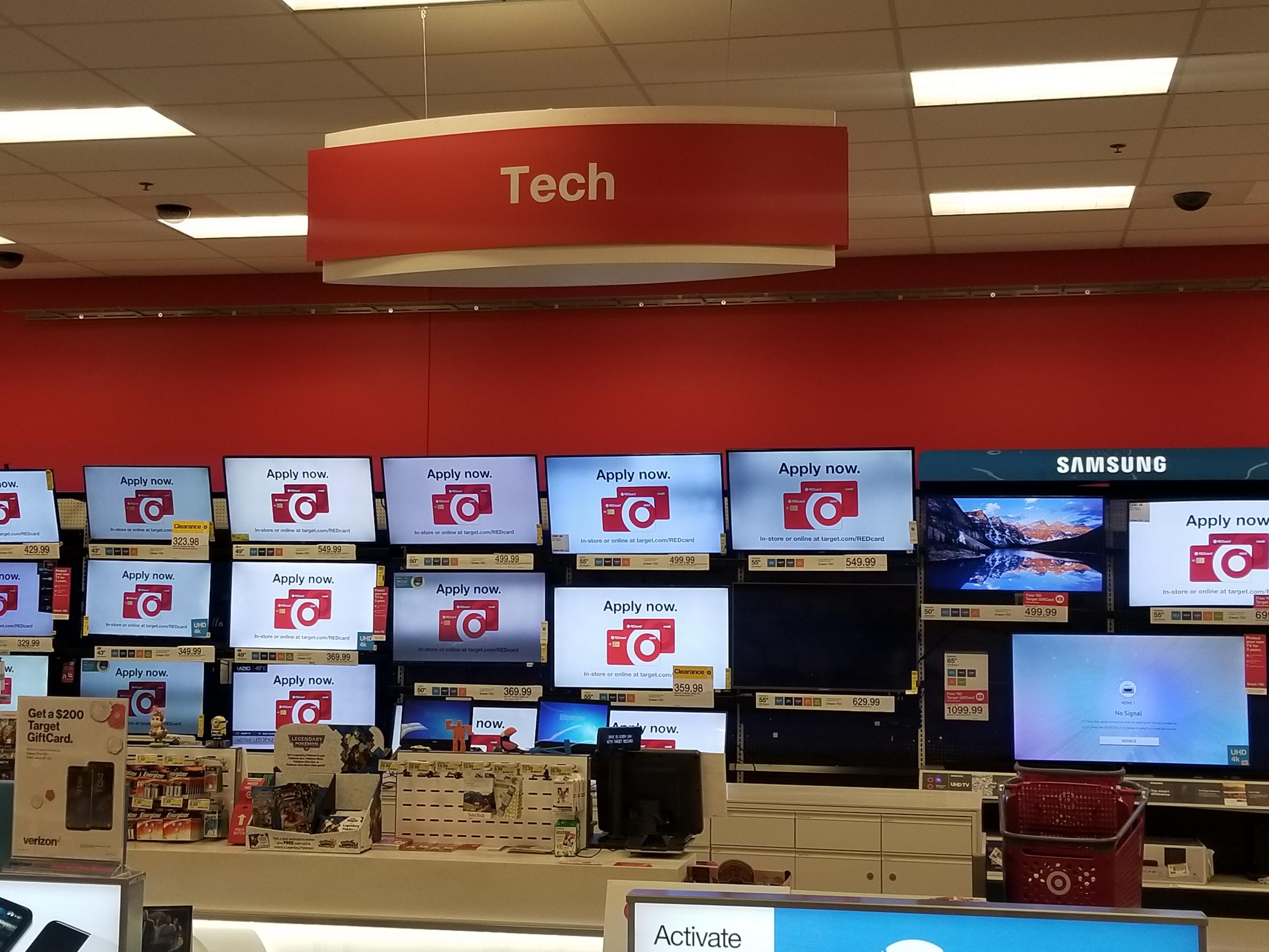

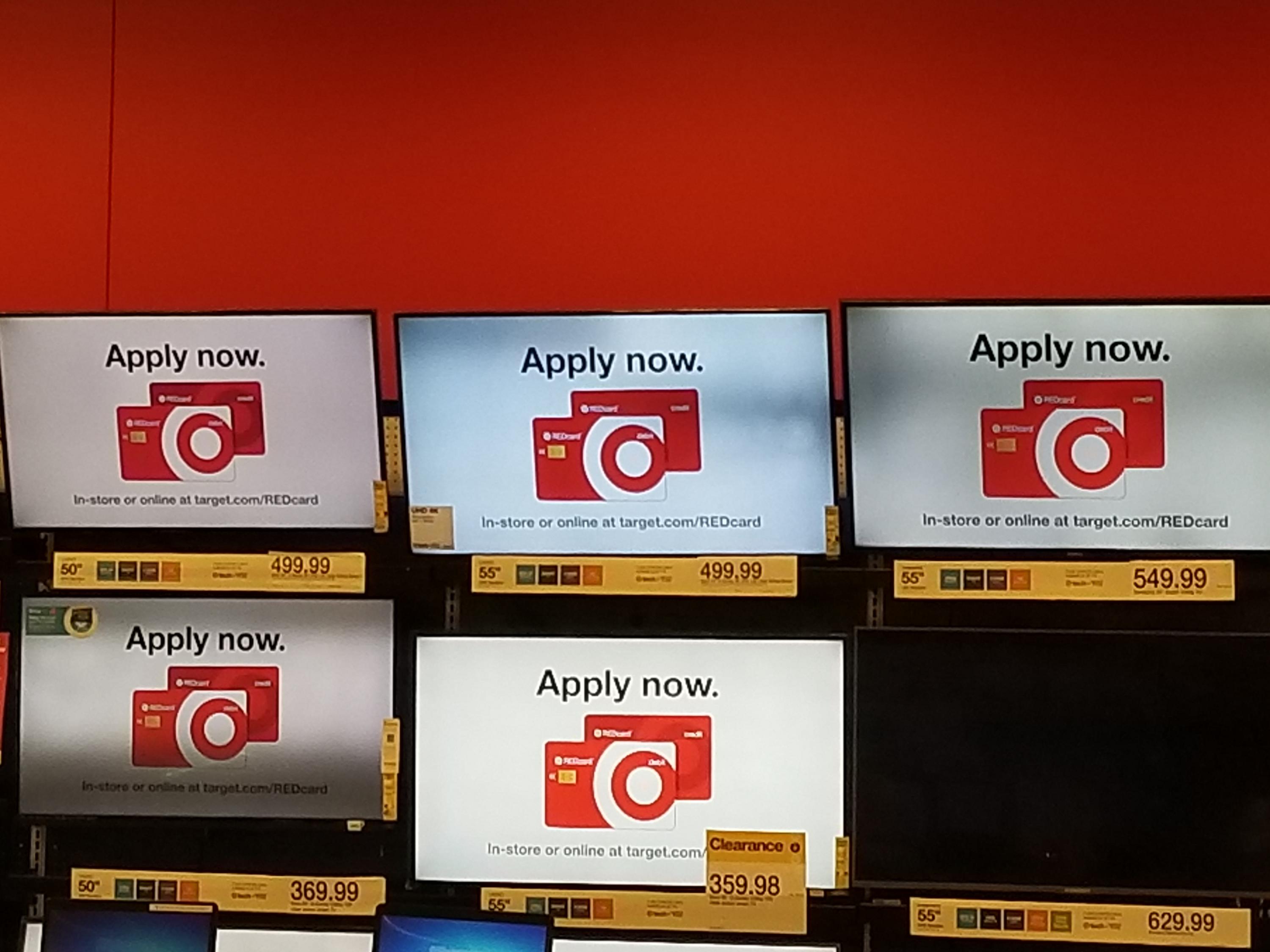

    So I was at my local Target store last night getting supplies for the kiddos and decided to walk over to the electronics department. To my surprise this is what I saw with the TV's on the wall.
    This is the crap being sold today. They can't even make it as a display unit let alone at your home. All the brands had some sort of LED failure...
    This my friends is what keeps us busy..

        Re: New TVs LED issues
        Mostly Vizio. One LG and one Samsung

                When new TVs come out of the box, they are defaulted (generally) to 100% backlight level. If you take two TVs, set one up to "retina scorch" and the other to replicate an accurate studio monitor, 100% of the people walking by will say the retina scorch model has a better picture than the accurate one. This is the same as doing an A/B listening test with stereos; set one with bass and treble cranked and people will pick that every time.
                BUT, it gets worse because some models have a "HOME" or "DEMO" mode option which is the first thing to pop up when the TV is turned on. Walmart Schmo picks demo which bangs the back lights beyond the 100% level. When some poor fool brings this demo home, it's already shot.

                    Dont forget the backlight is probably on full and turned on all the time but indeed , the leds die pretty quick.
                    LG / Panasonic is the same .....nice tv's but the leds fail to quick.

                      My friend had me come over and set up one of is TV's sense he knows me as the tv expert. Lol. Anyway it was a Vizio. Right out of the box its set to dynamic and backlights are on max. A lot of people would just leave it this way
                      • Andrew F. Ali
                        • Jan 2014
                        • 2450
                        • Trinidad & Tobago
                        You've got a wise friend....he called an expert to adjust the TV to STANDARD/NORMAL and backlights to 60%....
